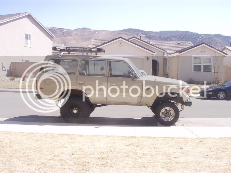

Everything's buttoned up - wheels got put on today (15" round-hole 'crawlers wrapped with 35" Pro-Comps), but I need a 1" spacer, even with the proper backspacing... rubbing on the caliper up front. :D I swear, if it isn't one thing, it's another.
All that's left to do is to fab up some seat bracket spacers, bleed the brakes, and measure for shocks...

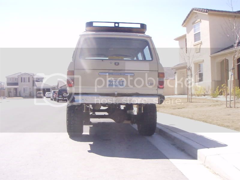

Junk in the trunk...

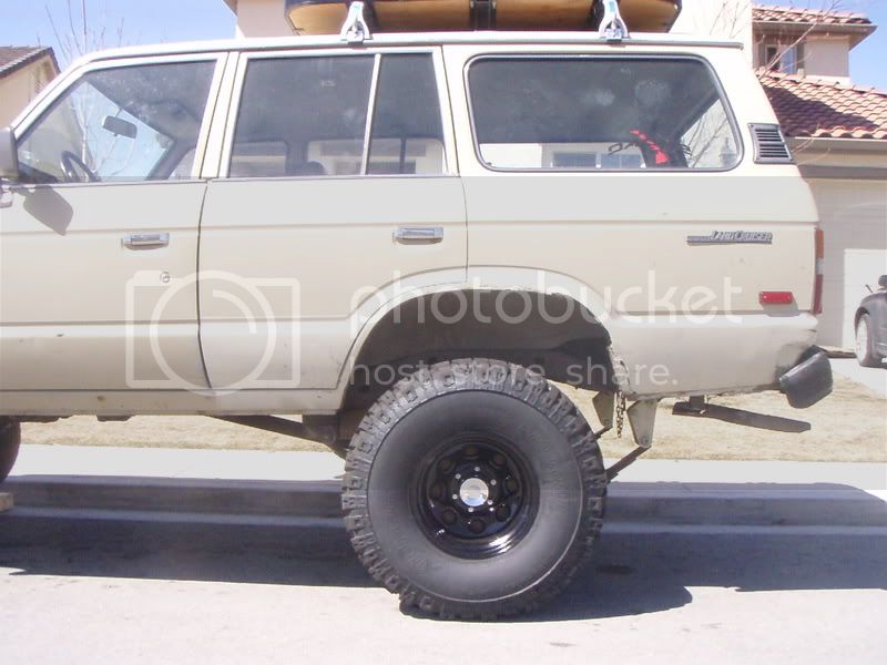

Clearance on the side (note the missing 4' of exhaust - left the tailpipe on for a laugh)... :D
And, since I still need spacers, the fronts are in the garage... :bang:

Sounds like pretty much the same setup I'm using, only with 4.5" springs. I did go with Charles' recommendation, and used 2" extended shackles - should be perfect when she's loaded down with gear and bumpers. :D
Depending on the shackles you use (I used 4+plus - beefy-ass pins), you may need to get different bushings. The Prothane bushings charles ships with the springs are VERY tight. I trashed four bushings and two pins trying to install them - I ended up drilling them out to about 18mm.
You'll need extended brake lines front and rear, and caster shims up front (I used 4 degree) to bring the front driveshaft back in line. Also, you'll have to extend the axle breathers, and measure for the shocks of your choice. :D

Thanks! Well, I'm pretty sure that the whole setup would be within 2-300 bucks of OME, plus you get to run 35"s... :D Springs were $925-ish? shipped, shackles were 4+plus 2" over, at $125/pr... bushings and U-bolts included with the springs... Add bilstein shocks (which I have yet to measure for), and you're pretty close to OME.
Is there any way you could take an overall height measurement for me? I am very nervous that I am not going to be able to get out of the garage.

Sure, tex - I'll get on it when I'm back home. I'm in Cali for my birthday right now - loadin' up on booze today! :D
FWIW, the top of my rear fender well is sitting right at about 43-44".... with the 35"s on, there's about 8-9" of clearance from the top of the tire to the fender. Does that help?
