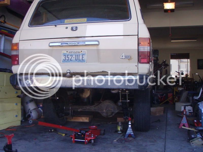

Well, this is it... My old rears are off, new ones going on, pics soon, hopefully.
I'm seriously wondering if I can get it out of my garage when I'm done.
You could always air down..... a lot.
That's the option in the lead right now. :D

So I'm 1/2way done with the lift... I think the front will go MUCH faster than the rear, since I know what the F I'm doing now! :D

hopefully your shckle angle will look alot better when you get some weight on the tires. Did you order them 1" longer in the rear like mentioned several times on the web?
look fwd to seeing front picks.
I did indeed get them made longer in both the front and the rear... Charles made them for me to accomodate a receiver hitch, bumper w/spare and full jerrycans, ARB+winch up front, and 300lbs. of gear, plus a full-time passenger. So the shackle angles (front and rear) should be much better with all of that weight in there...
