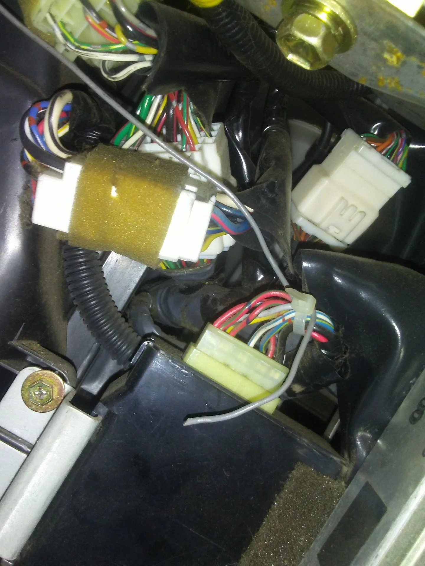

Harness portion behind glovebox is fine, but what's this gray wire for? Radio antenna? I can't find the other end of it and the antenna is gone so it seems most likely
