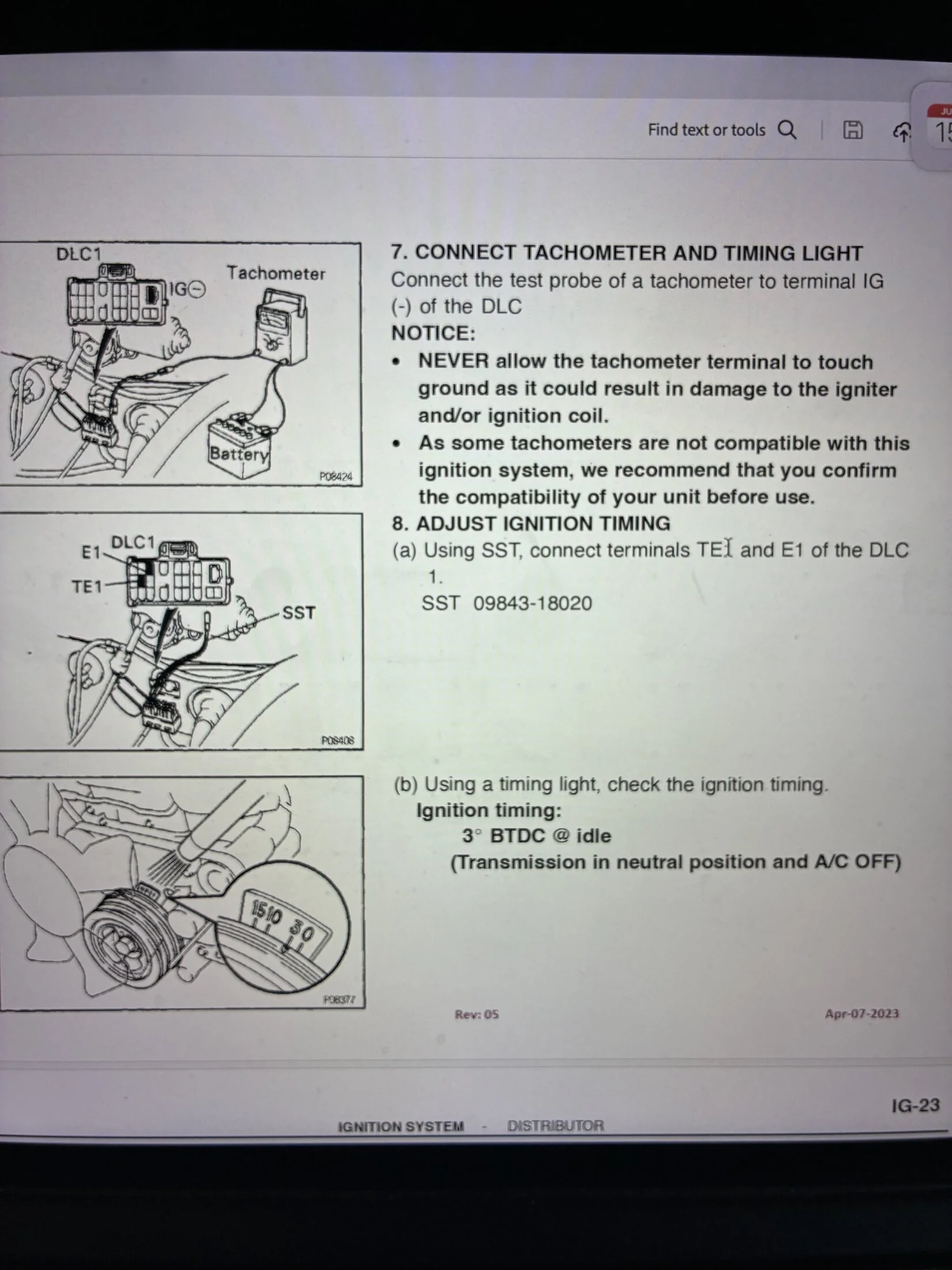

If you have a timing light, hook it up and check your timing.
I'm guessing your timing is too advanced. The throttle cable being slack and the timing being off.. I'm betting those are the causes of your stumbling and high idle.

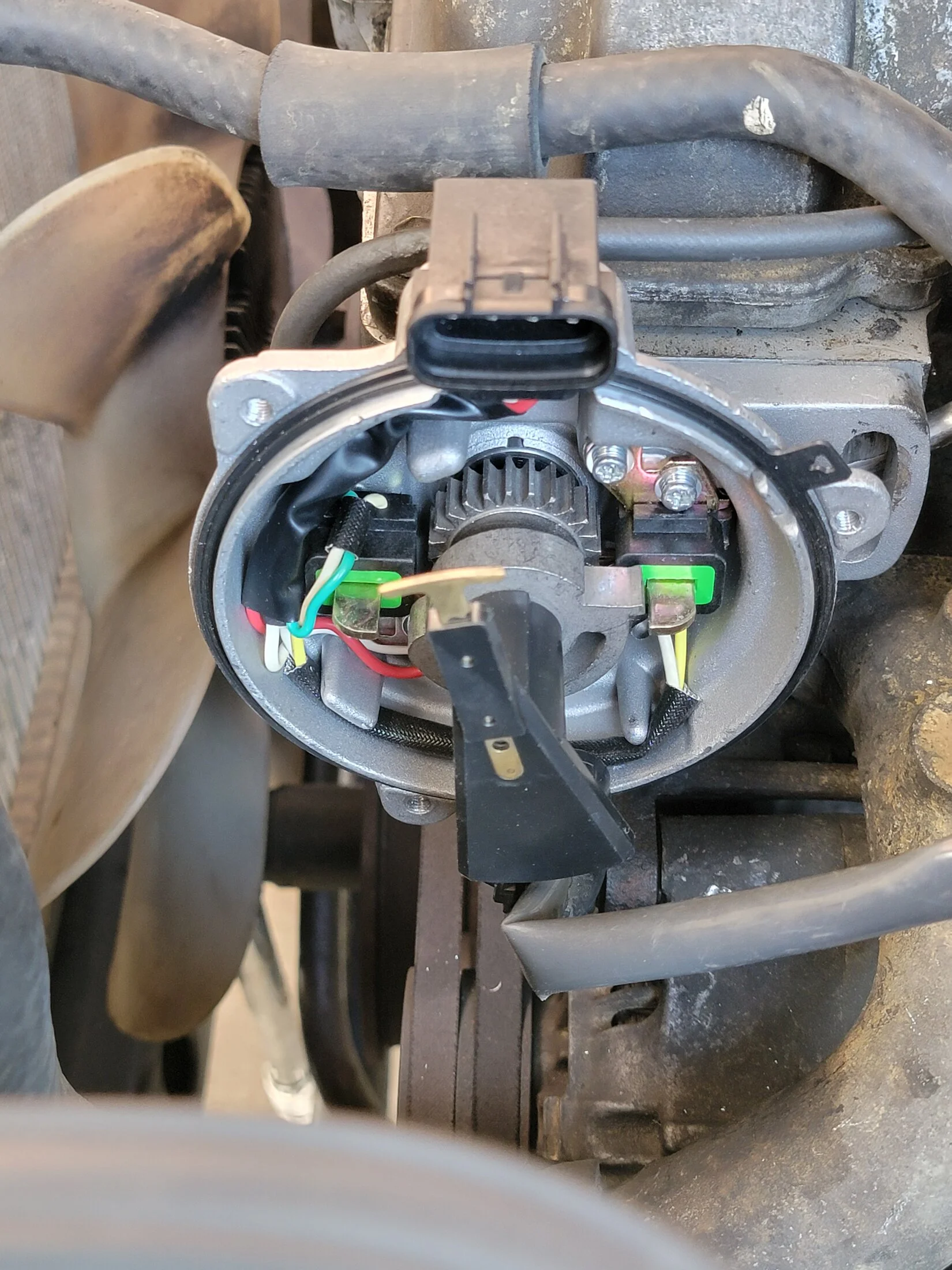

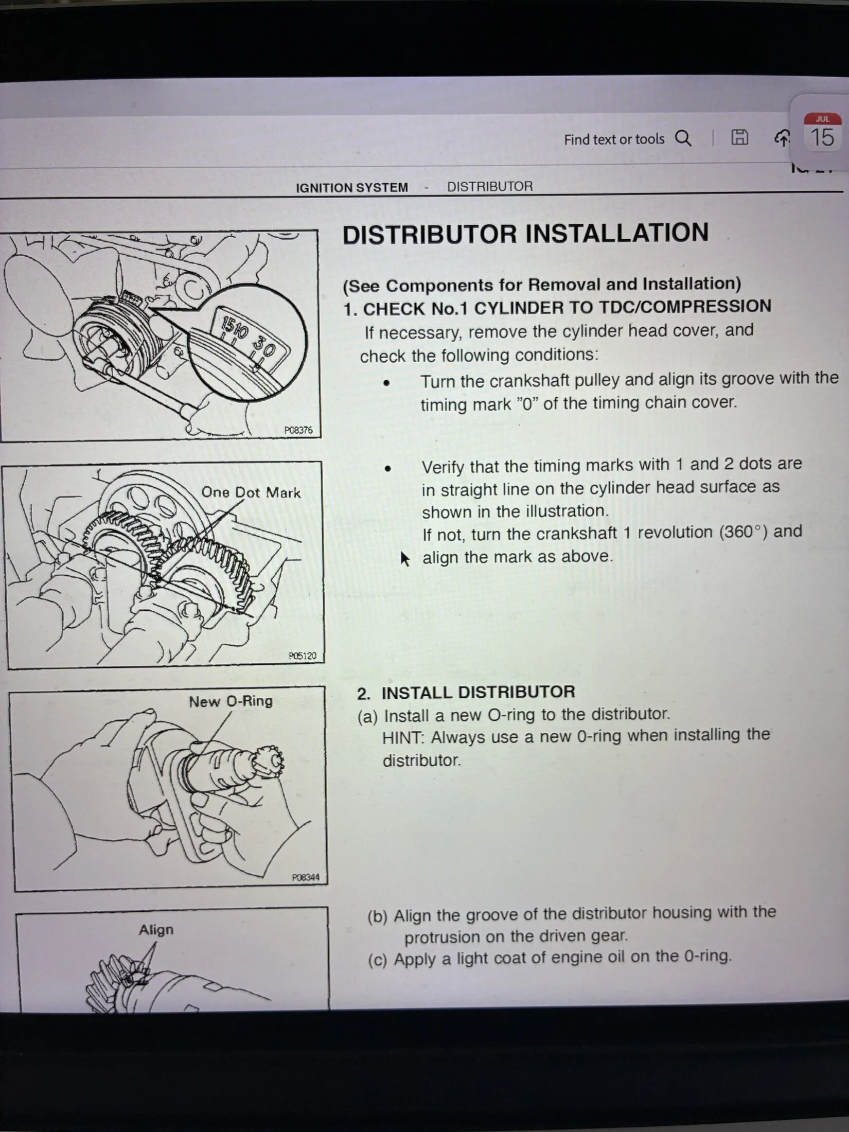

Did you pull the distributor while you were servicing your truck? If so, it could have gone back in a "tooth off", making the timing too high. If you didn't pull it, the po might have and re-installed it incorrectly.

Yes I did pull it, so I just used the distributor to set it right at 3 with timing light, the idle lowered to about 1200..., you may be onto something, i followed the photos I found online to adjust the distributor, but like you said I may still be a tooth off

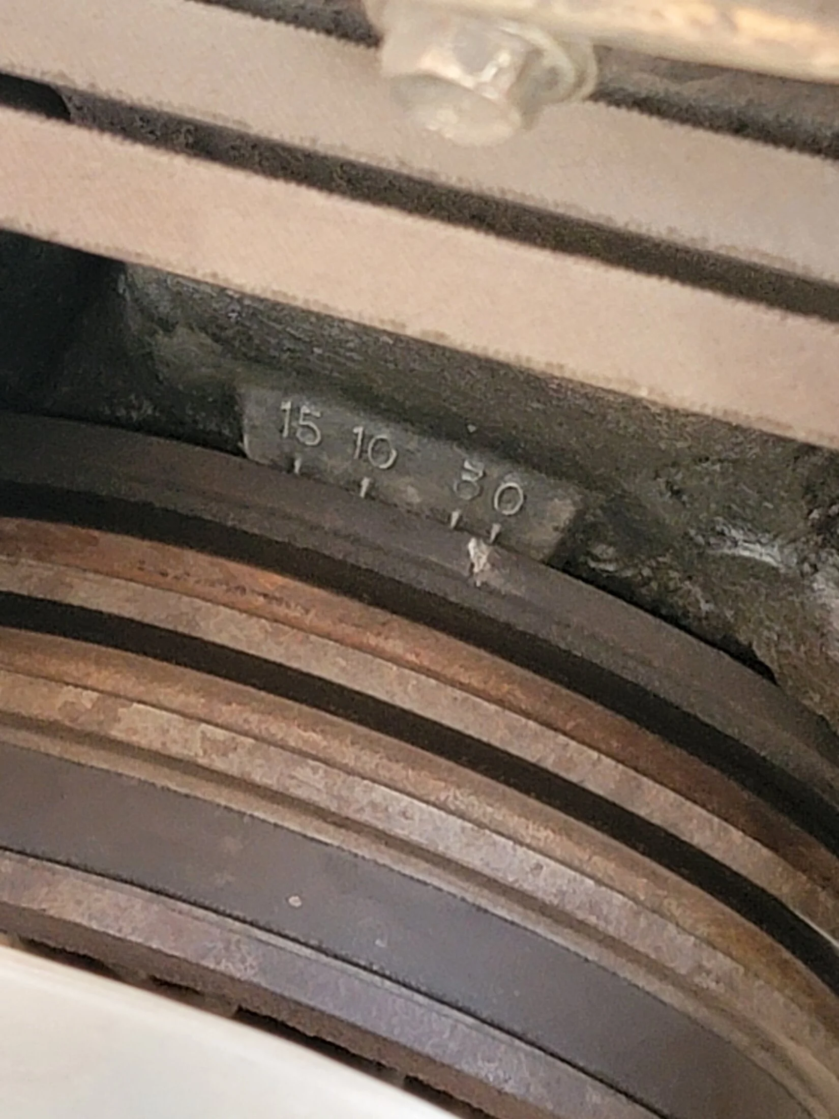

Here's what we got at tdc now
The amount of time between the piston stopping and going back down is long. Are you supposed to set the dizzy when the crank mark is at 3?
Have you downloaded the factory service manual? If not, go to the resources at the top of the page. It’s located there for free.
