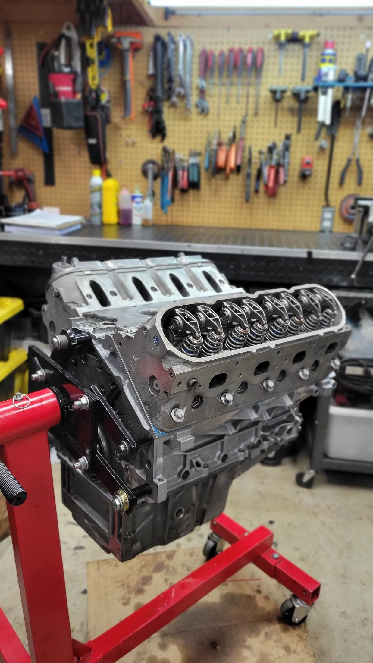

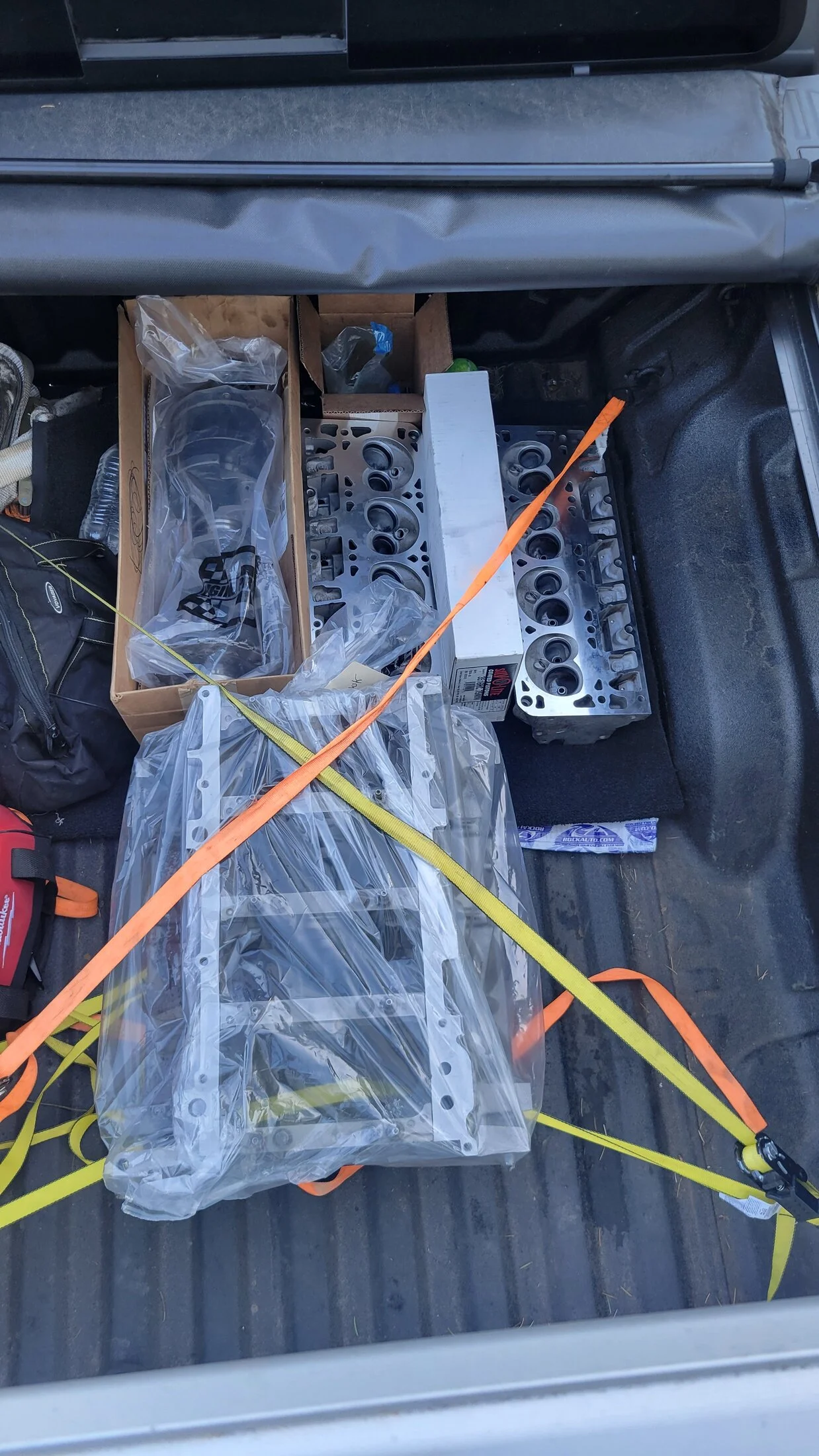

Initially I planned on using the engine as-is with a small cam/springs upgrade, but I noticed something in the #7 cylinder with the bore scope that didn’t look right. When I removed the head I found some strange damage/scoring on the thrust side. That triggered a full rebuild (block bored 0.030 over for new pistons, new rings, cam, rod and main bearings, heads resurfaced, cleaned, valves lapped, etc.) I have a new engine now and can actually call it 6.0L, and not 5.96L!
LQ4
Cylinder #7
Rebuild Completed

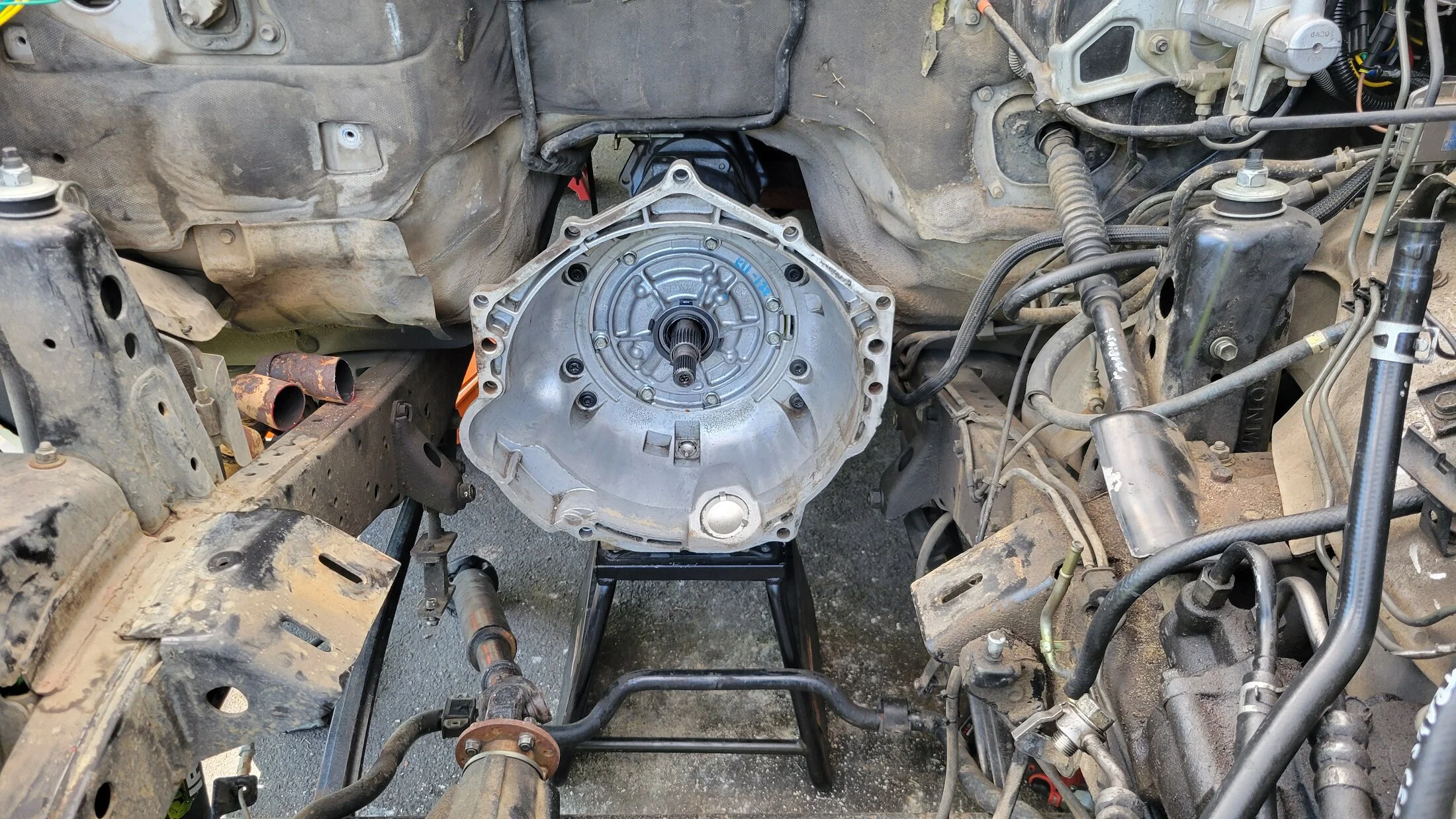

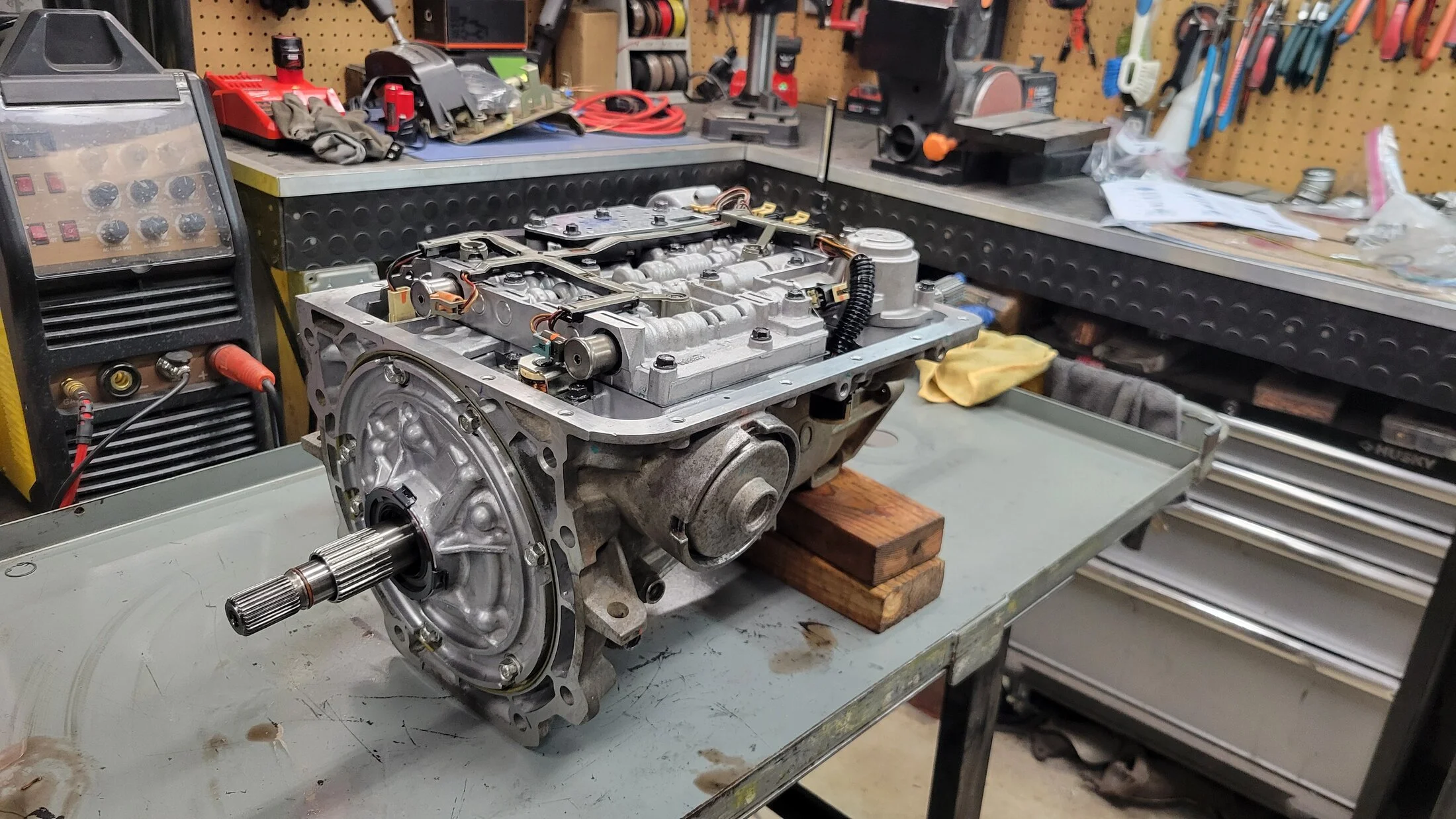

For the transmission I went with a core out of a 2008 2WD Silverado that lost 3rd gear. I rebuilt it myself with upgraded parts, shift kit. It should be good for the power I am planning to put through it.
4L60E
Almost completely assembled

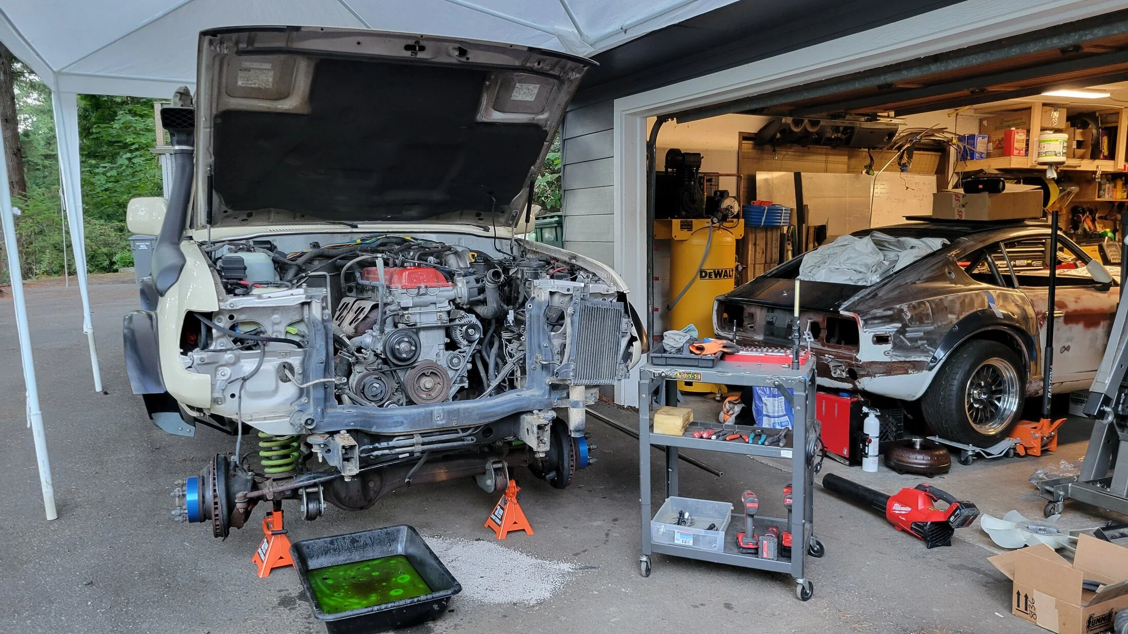

Current state of the swap
Want to pull Transfer case/transmission/engine together and needed to take the front completely apart for that. Between removing the radiator/condenser and removing wheels it should make it relatively easy to pull everything as one unit,

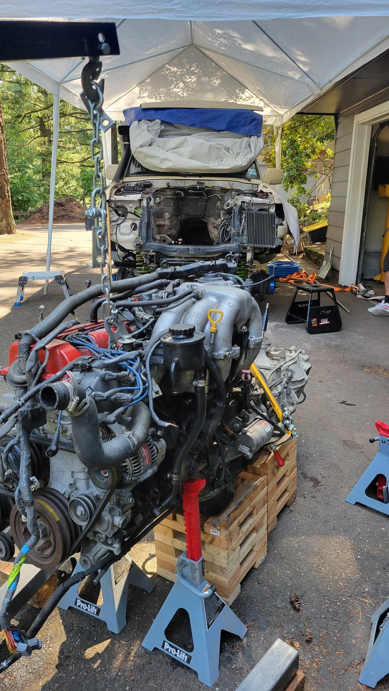

I have to say I didn't like pulling the engine with transmission and the transfer case together. So heavy, and my sloped driveway isn't helping. One of the front wheel on the hoist broke right when I was lowering the engine on to the blocks. Lucky...

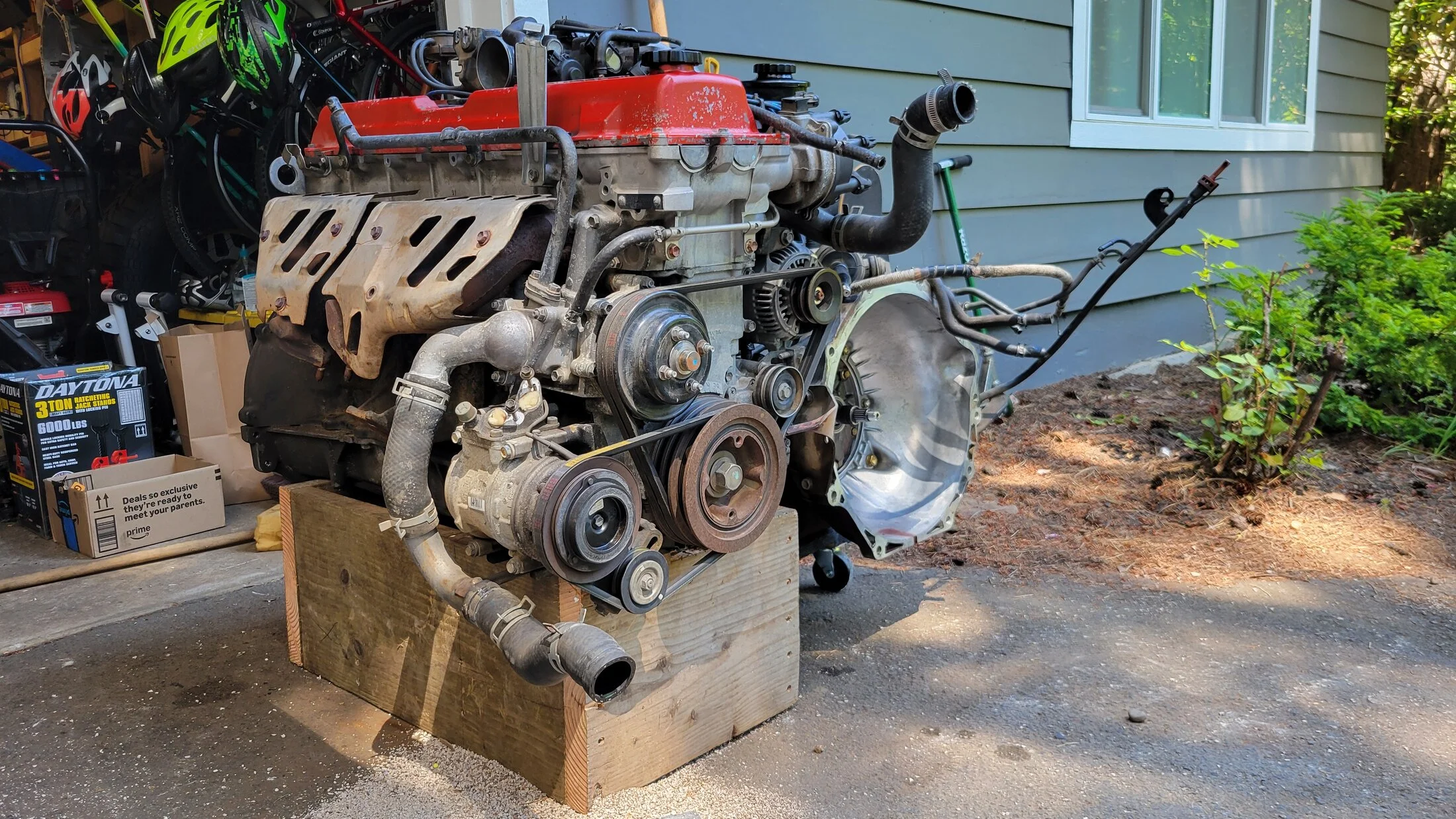

Made some more progress. Split engine, transmission and transfer case. Pulled the harness. I would LOVE to know why the harness runs through the intake manifold like that...

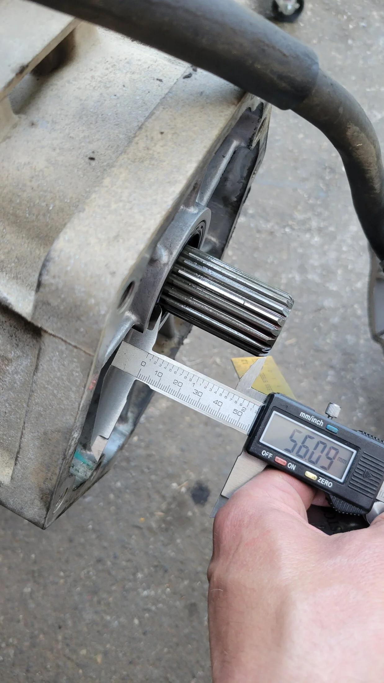

Will be cutting the output shaft and installing Marks adapter.

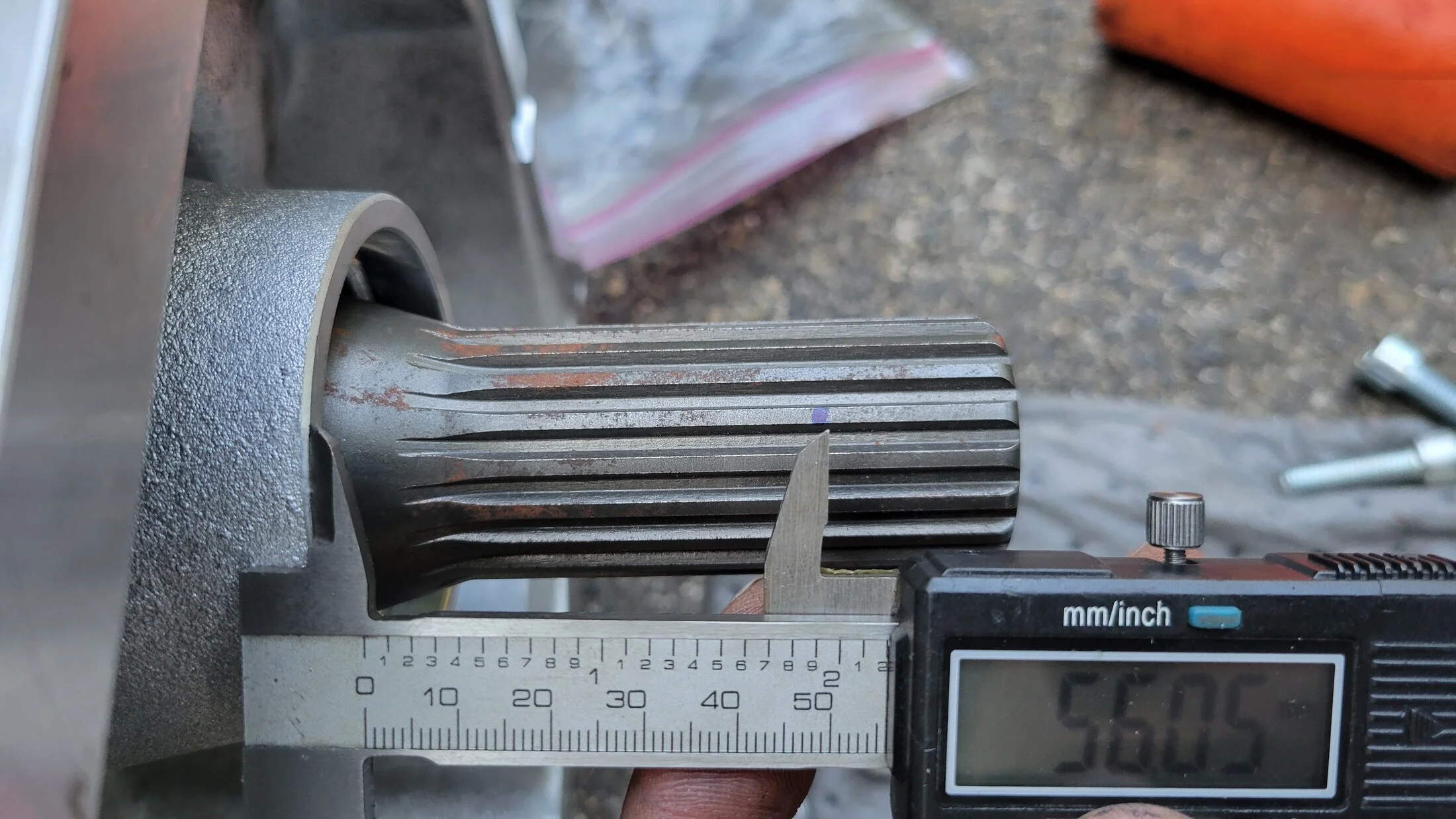

I am as confused as anyone by the instructions that came with the adapters and went a different route. I assemble everything without cutting the tail shaft. Took a measurement of the tail shaft sickout on A343F (56mm). Compared against 4L60Ewithout cut shaft (it was 81mm). Difference is what I shortened the 4L60E shaft by.
Anyone sees any problem with this logic?
Stock A343F Stickout
Measured against 4l60E tail shaft with spud shaft installed and all adapters in place.
This is how much I ended up cutting.

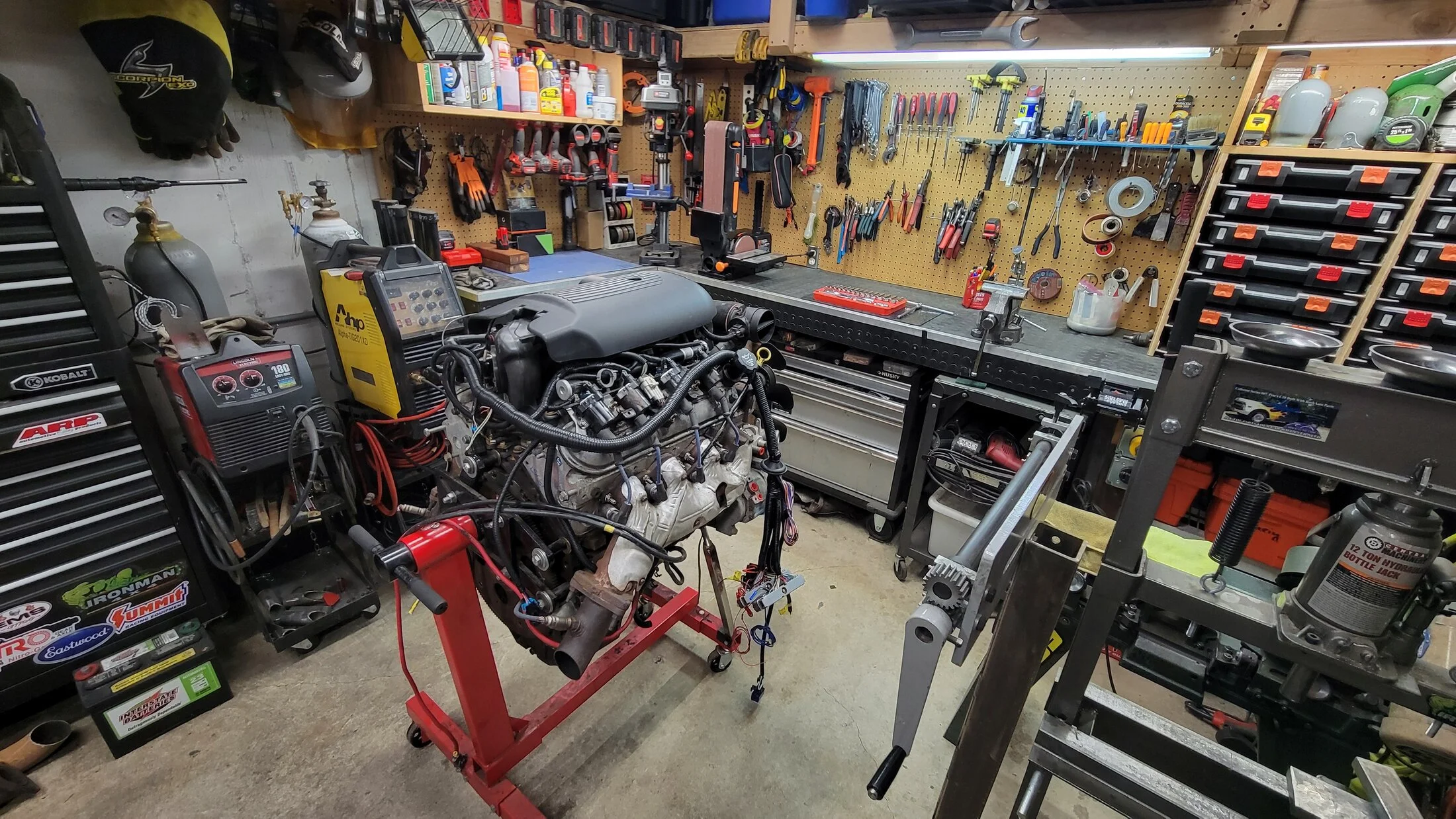

A little bit about the engine:
Initially I wanted an engine I will just clean up, replace some maintenance items, and install. Purchased (at a premium) an LQ4 from a good dismantler, reworked stock harness and had stock PCM reprogrammed. I test ran the engine on the stand, things looked good.
Somewhere along the way the plan evolved into cam and spring upgrade and Holley Terminator fuel management. During the upgrade I discovered that the engine most likely lived a pretty tough and neglected life, oil sludge was off the charts. Further investigations showed serious wear on the thrust side of cylinder #7.
The wear was bad enough to need at least 0.020 overbore to clean up. So, just like that I ended up with a full rebuild. Reused rods (with new bolts), and crank. Pistons, rings, rod and main bearings, lifters and pushrods are all new.
All machining was done my Somer's Race Engines in Vancouver, WA.

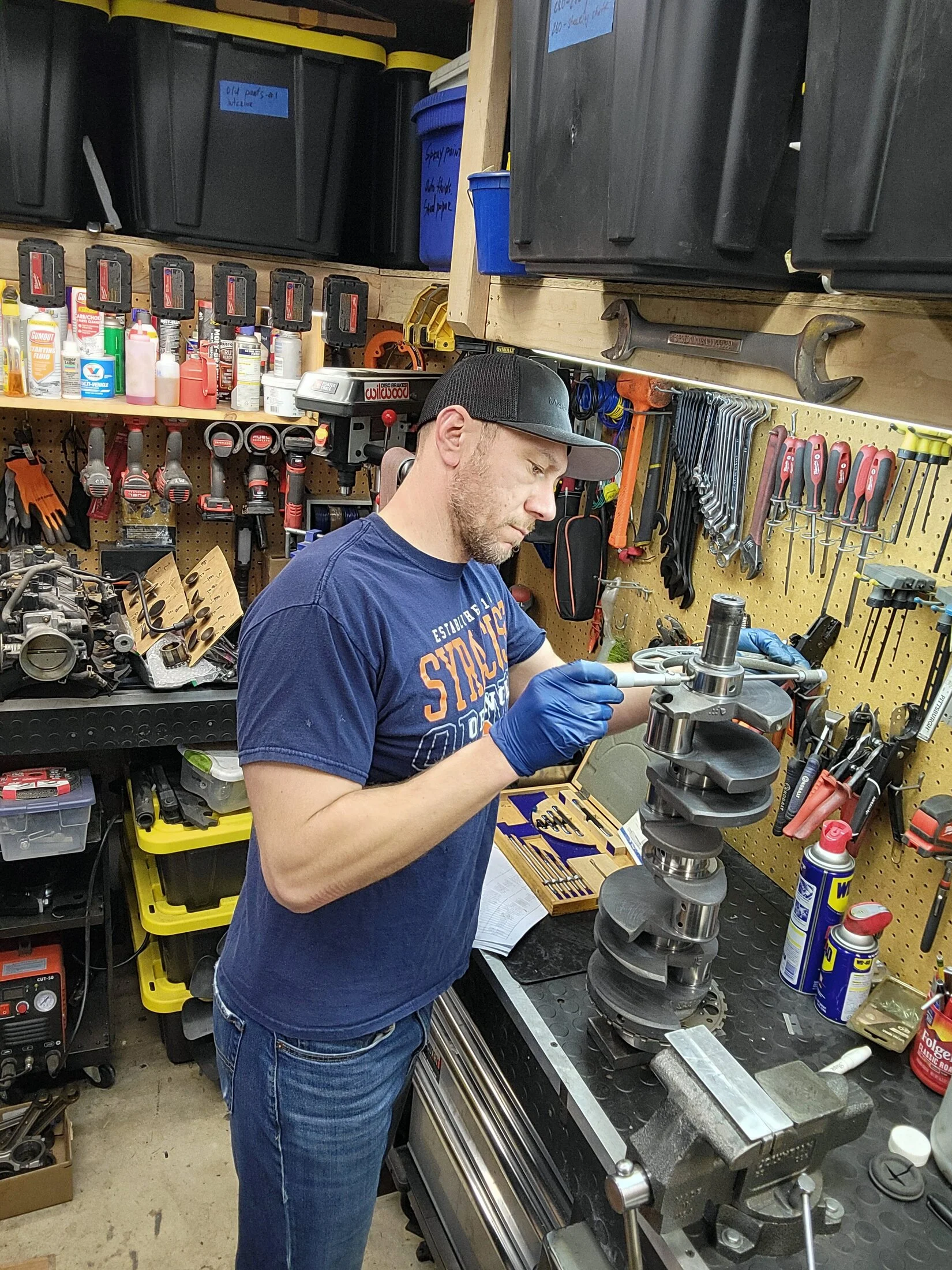

Checked all main and rod (no picture) bearing clearances
