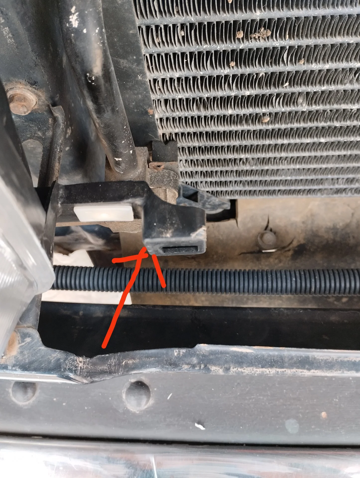

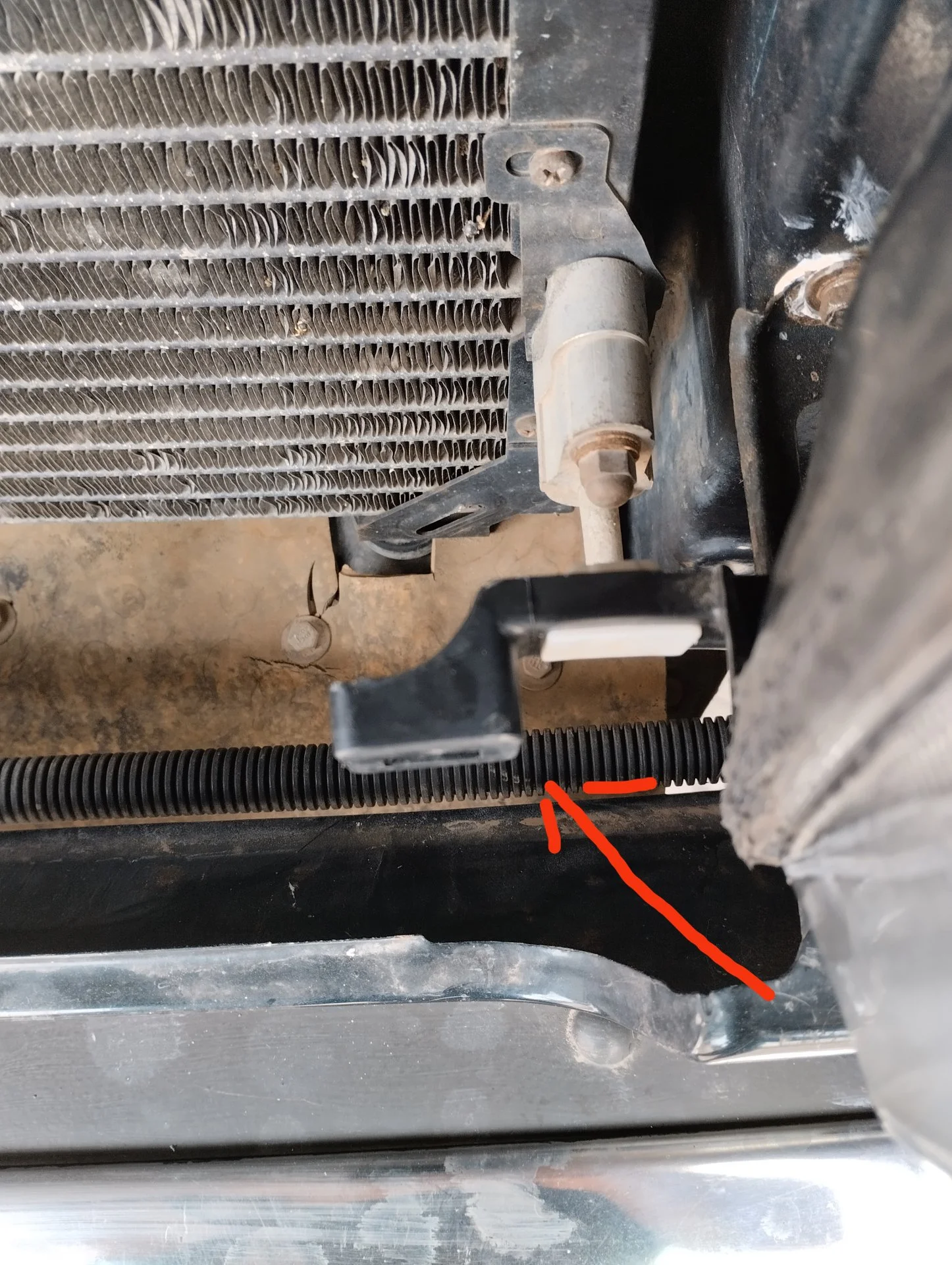

Another update as things that have been put off for so long get sorted.
With the wing/fender put on the other day and before securing the arch at the bottom near the sill/rocker panel, I gave the lower fixing bolts a good 'toshing' with black Hammerite paint, although I had used stainless speedy clips and bolts, I had used ordinary steel washers so a good flooding with the well known Hammerite should see them easy to undo the next time around.
So thinking about putting back the headlight, indicator and sidle light I hit on an idea. When I matriculated my RHD car into Spain I simply purchased two headlights for a LHD 80 and with a simple alignment job (underground car park and a piece of chalk), the car whizzed through the ITV however, when my car came from the factory it came with headlight level adjustment but the LHD version did not, back then I thought I would keep them but like the broken ariel it was another redundant button on the dashboard, and I did plan back then to see if I could swap the housings but never got around to it. So today I found the old headlights and blew off around 11 years of dust and started a comparison. The outer glass was definitely different with LHD markings and the actual glass pattern was different as well, I thought well perhaps I can simply change the glasses.......yeh right!
First removing the lenses looked like it was going to be easy, but don't let the half a dozen metal clips holding the glass to the lamp body fool you, there is a sealant that is tough......really tough. So here your friend is a hot air gun or the wife's hairdryer if your brave enough? So with the clips off I did try by using a sharp craft knife to cut the sealant made of a mixture of silicone and concrete, after cutting a slit though my little finger (still weak on my right side) I went with the hot air gun, with gentle prising and heating (or the other way around) the glass came free, I tidied up the edges of the housing by heating and using pliers held the slight buckled edges where I had been prying and once cooled off they stayed straight.....ish. So a good look at the chrome reflector and they appear to be identical, so a quick swap of glass I and have electric leveling headlights....wrong! The part of the reflector that sends the beam out is identical however the bulb mount on the inside is different, not by much but if you picture the tripod base of the headlamp bulb on the RHD headlights the larger tab of the bulb is at 12 o'clock, on the left hand reflector it is somewhere between 1 and 2 o'clock. So you need to unscrew the adjusters until the come free from the reflectors, a not here the adjusters are different in a couple of ways, the first is you would think to release them by unscrewing anticlockwise but one does and one does not, so check before you spend twenty minutes winding it the wrong way. The other difference is the adjust for the non electric adjusted is different from the electric version, I only found this out because the adjuster on my original lamps was looking a little nasty and rusty, but they cannot be swapped, there is a collar on the manual versions that does not allow it to fit on the electric version, it might be possible to remove this but it felt like it might break so I went with surrendering, I did swap the manual adjuster though as they are the same. Once the reflectors were swapped I just had to glue the glass back in. unless you have a spare few hours don't bother trying to get the old silicone out, instead run a new bead of silicone on top of the old stuff that is in the recess, then with the glass aligned correctly just press down while playing the hot air gun and the glass simply sinks down into place, with the clips replaced I left it to cool, and then fitted, not forgetting to screw the lower chrome filler in place before fitting the lamp back in otherwise it will have to come back out again, I am not owning up to forgetting it....nope not me....cough!! A quick test of the beam against the garage wall showed the motor is working and the beam does go up and down, the beam pattern is not as clear cut as the unmodified version, I think this is because whilst in there I fitted one of the higher brightness 'Philips' bulbs, they are a whiter white if you like but as mentioned the beam cut off is not as sharp. I will see what it is like when the beams are adjusted properly.
I only did the one lamp as it was the only one out, tomorrow is a bank holiday here in Spain and most other places as well I guess? I doubt I will be going anywhere so you can guess what I will be doing instead of sitting around?
