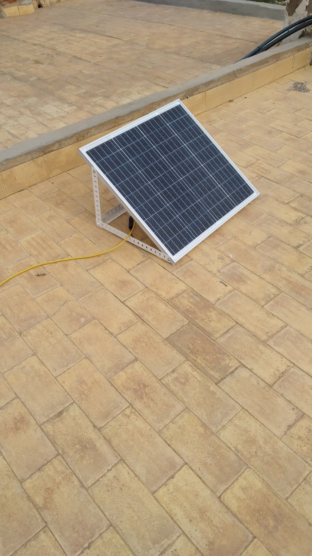

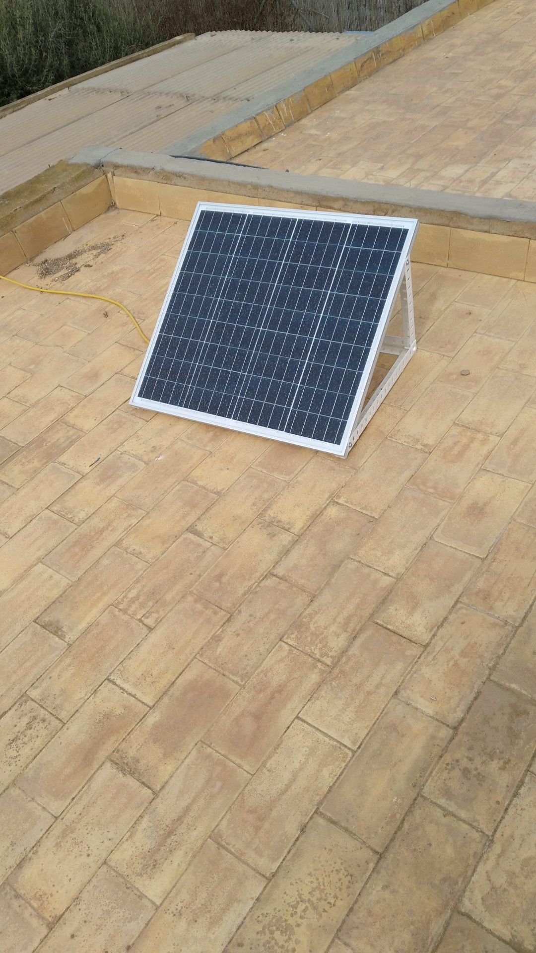

The pictures you requested, the framework is from 'Dexion' I had from some old shelves that were going rusty and were thrown out. The Dexion framework is held to the roof tiles by 'No Nails', this saves drilling holes and risking leaks, it rarely rains in this part of Spain but when it does......it really does, and it was ironic that last it 'persisted' down for some time, followed by a windstorm full of dust and then a two second downpour just to make sure the cars and terraces were filthy with dust!

Looks great! I hope this is the solution for you to keep your cruiser topped off electricity wise. Odd that you didn't find a parasitic draw.
Thanks.
Yes it is odd indeed to say the least. I am used to finding modern vehicle electronics take ages to shut down, sometimes over an hour! But the 80 is way too old to have these kind of systems.
I plugged the new solar panel in last night whilst it is dark, today it has been very overcast and no real sunlight to speak of. I went out and checked the batteries, both are showing 12.9 volts, they have of course combined as the voltage on the aux battery has reached the VSR demand voltage during the day, so testing at the moment would be pointless. I will check in the morning, as a note to anyone following this, the solar panels that are normally used do have diodes preventing the batteries discharging through night time hours, whilst the Blue Solar also has diode protection as well. The new panel has not been opened up to check for a diode but the imbalance of the batteries has been seen with the new panel disconnected.
I will check the battery voltages tomorrow morning before there is sufficient daylight to initiate the charge process.

We had around three hours of sunlight today and at five this evening I checked the charge state. 13.9 volts and on 'float'.
So it did not take long for the batteries to pass through 'bulk' and into float mode today so the system seems to be working OK. If I get a chance over the weekend I will disconnect the solar panels and look again for that discharge to see if it has returned.

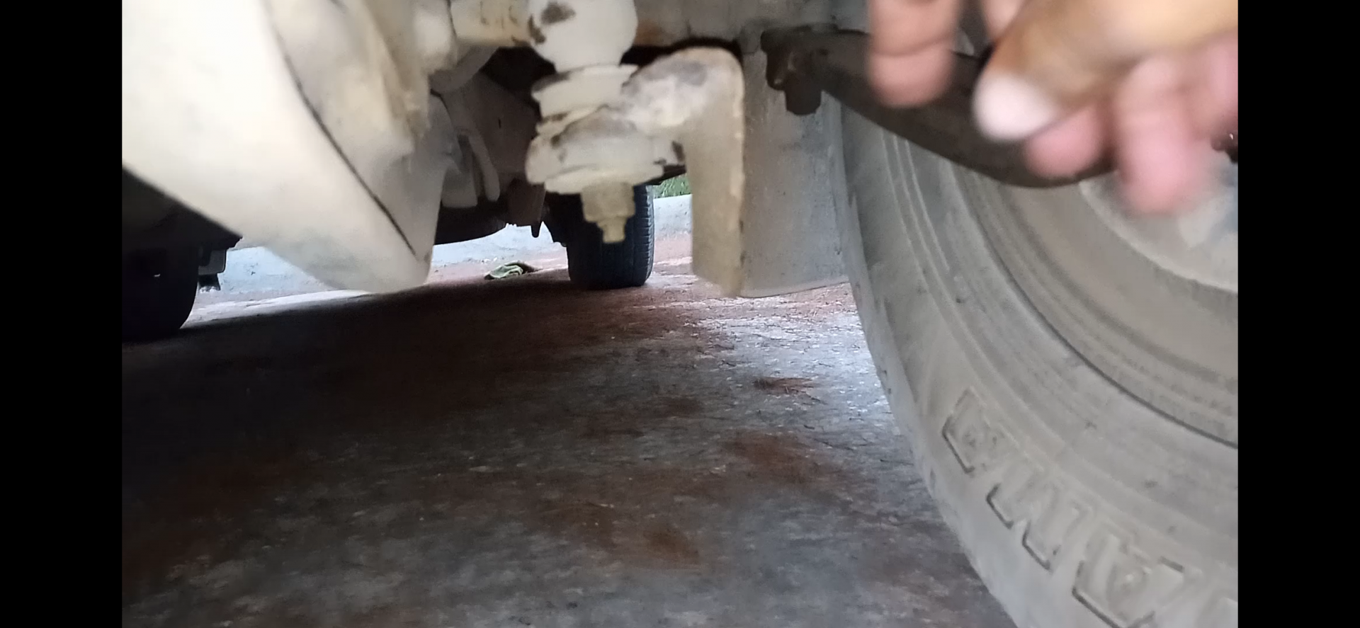

When I got the car there was the usual sloshing of water in the sills (rocker panels) and I pulled out the plastic plugs and left them out, the small slots where the panels meet get blocked so easily, and as the water from the washers appears to drain into the panels it makes sense to leave them unplugged, I guess after using the washers some of the screen wash lays in the panels waiting for a corner to be turned and it gets emptied out under the car? Either way a five minute job can easily become a two hour job.

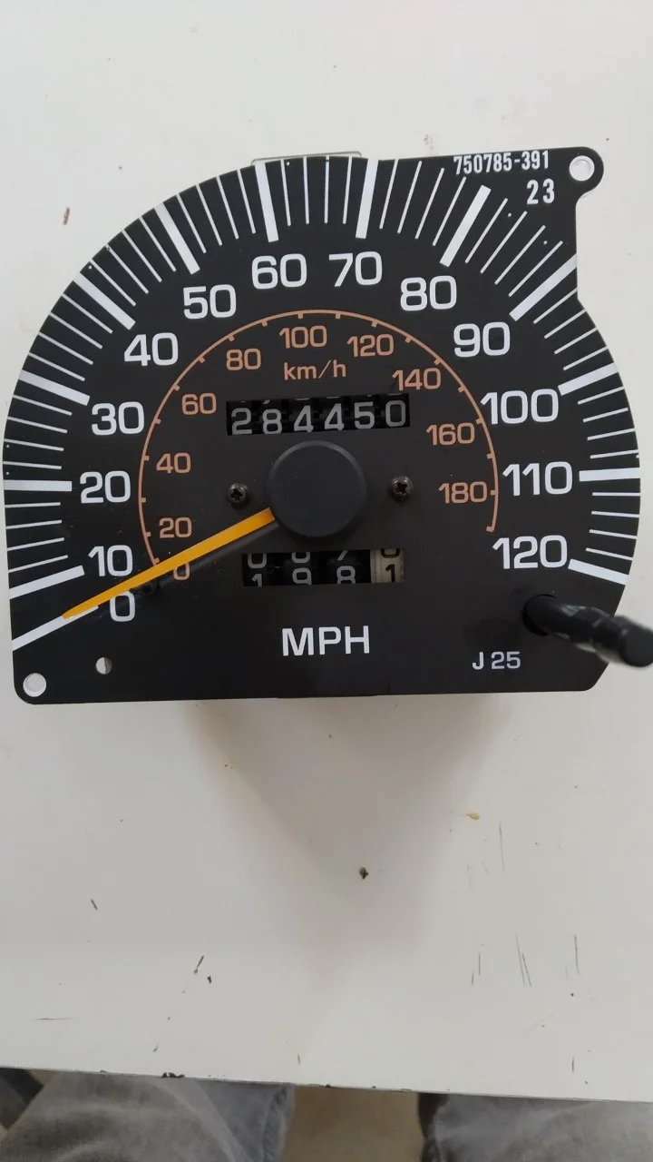

Continuing trying to keep my brain working I decided to attempt to repair the trip meter on the 80 as it broke a couple of years ago, well OK I probably broke it being such a heavy handed person. Upon taking it apart I also find the timing belt reminder reset button also broke, certainly not coincidental.....just me. FWIW the main mileage counter works perfect.
The repair is going to be difficult as the 'axle' that supports the cogs has broken at both ends, the repair to the belt reminder easy in comparison, so I am going to opt for a secondhand speedometer head. Now I am hoping someone from the UK is reading this who can supply me a replacement head (no pun intended), because the diesel is more common in the UK however, another member may have swapped one out for a KM version elsewhere in Europe?
I need to reconnect with the UK forums but have yet to recall my passwords, so it looks I need to contact admin there as I did here on MUD.
Please find attached a picture of my broken speedometer for a reference point so tracking the mileage for future owners if I am unable to recover and maintain my driving licence.
