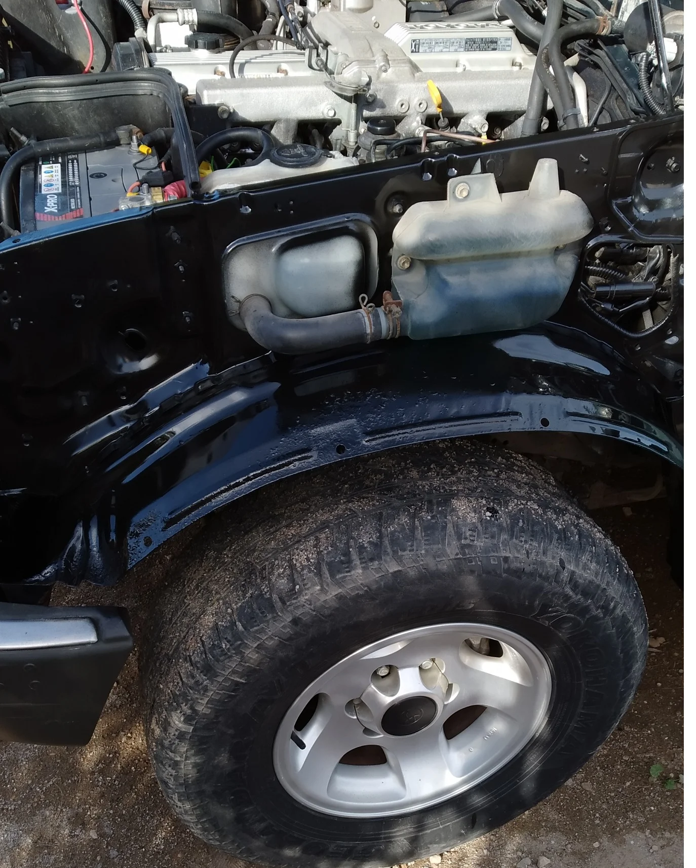

So to the 80. the wipers on high speed have become slower and slower over the last few years and I could not find a replacement that was cheap enough to consider worrying about it, I then found the motor seems to be suffering the same fate as the window motors, the armature/brush contact area gets burned up with age. So with the engine running and the wiper arms removed I left the wipers on high speed, the motor was making all sorts of noises and then it got smoother and faster, within around ten minutes the motor was going flat out, so for the moment the wiper motor search is off.
Anyway, the L/H wing was taken off to reveal surprisingly very little rust so very happy about that. I jet washed off the inner wing and it was a nice sunny day today it being the first in about three weeks! With a couple of hours of drying of I run a wire brush over the fine rusty areas and it basically left the colour of rust and only one bolt hole actually pulled through where the 'speedy clip' broke free, a new speedy clip will sort that. I had made inquiries at a paint shop in town, the guy is very helpful and once we....well I had made it clear that I did not want the tarmac or rubber like under seal, he showed me a can of black paint. He explained it is an anti rust paint that is not porous and not only kills rust bur prevents it reoccurring. I asked if he meant like 'Hammerite' paint and he said yes but better...much better and it was in a spray form. I wondered if this was like the much vaunted here on MUD POR-15? Very thin but sets rock hard? Anyway, I thought I would give it a go as my friend used it on my right rear arch after we welded in a new one. and that was long before Covid and no rust has shown up anywhere the POR-15 was used soooooo.
So with the surface rust wire brushed and dry I gave the inner wing a good coat, and it really is very 'runny' almost impossible to get it to spray without running, perhaps that's the secret of POR-15, it runs into all the nooks and crannies making sure everything is sealed up?
I drilled out the bolt that broke off in the gutter line and I will use a self tapping bolt to replace the original bolt, there is another hole to be drilled out, that is one of the pair under the sill or rocker panel to you guys and girls over the pond, so I will give another coat of this black anti rust paint on the inner wing and inside the outer wing or 'fender' tomorrow, it will be Monday before I tackle the broken bolt under the sill as no one makes a noise around here on Sunday's, it is an unwritten rule I have adopted, I mean I have five whole neighbours so it makes sense just to keep quiet and enjoy the 'day of rest'.
So all being well with the paint dried then Tuesday the new ariel gets fitted and tested, if all goes well I will lose my 'machine gun' buttons, the noise made by the ariel motor when the ariel mast gets broken.
