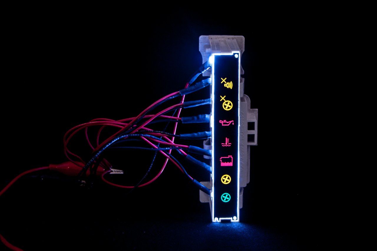

Today @ 247, 690 miles. Fitted anti rattle clips to the brake callipers, followers may recall I had purchased a new anti rattle kit and the clips were too narrow? I gave up looking for the correct size, it seems there is a huge batch of copies out there that are not the correct width? As the pads have bedded in, I noticed they rattled more when going over rough surfaces. This morning I dug out the old ones, gave them a good clean and clipped them in, so that sorts that. Whiles the wheels were off, I removed the plug in the top of the hub and pumped in some Moly. Checked wheel bearing play and a general look under there, all good. Also greased both prop shafts. Not a lot done, but too bloody hot to work at the moment.

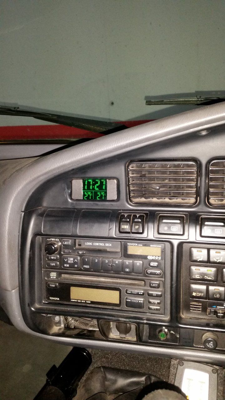

Also, I have finally taken delivery of the dashboard insert. This is the piece that holds the gear selected indicator found on automatics. After having stripped it down, I had a stateside company etch in the icons. The icons are self explanatory but feel free to post up any questions. This insert will replace the 'el cheapo' version I constructed and fitted last year. This new one mimics the 'dead fronted' material used in the original dashboard, no icons show unless illuminated from the rear.
Very professional IMO, and beats having a handful of lights cluttering the dashboard. Just waiting for a multiplug, then I can remove in the same way as the OE plugs if need be. Should be in place around the end of next week?

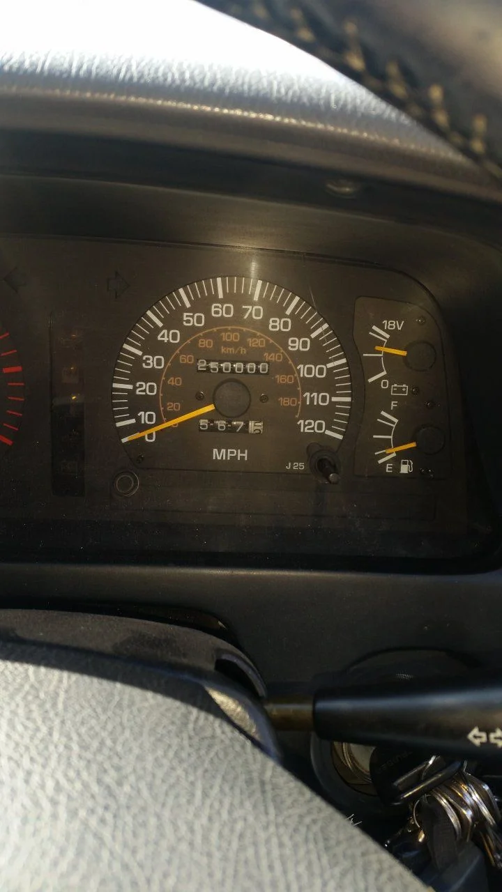

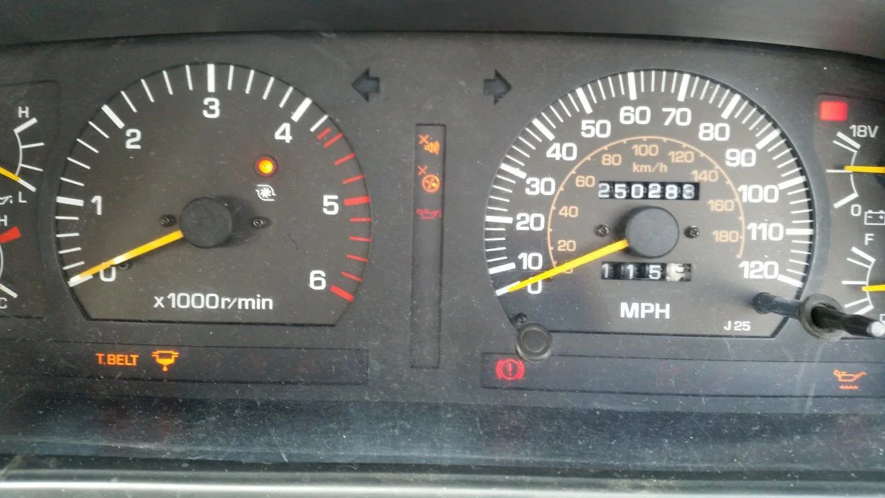

Another milestone, 250,000 miles clicked up this weekend! I knew it was coming and wanted to get a picture for reference, then went out over the weekend and completely forgot about it. By chance I had left the motorway yesterday morning and something made me check, I was four miles short. A short run down the road and took the snap.

So I spent most of this week finishing up the dashboard mods. It did not go as well as I thought it would, everything from the wrong relays being delivered to me putting the wrong male/female pins in the connector blocks, honest I do know about the birds and the bees!
The modifications were to monitor with visual warning about:
Which fan speed was being called for slow or fast.
Then to add to the visual warning with an audible buzzer to show:
If there was oil pressure.
If the coolant level was correct.
If the engine was overheating.
I also wanted to disable the buzzer for ignition on/engine off scenarios, and also disable the electric cooling fan if need be for wading, when either of these functions were being used they too would have a visual indication.
I also wanted to remove the standard digital clock and fit an aftermarket inside/outside temperature indication into the same place as the OE clock.
First the dashboard indication about what is going on under the bonnet.
My early attempts whilst working ok, they looked pretty poor. I eventually had a US company laser etch the symbols into some 'dead fronted' material for me. This is the same method as per OE, you cannot see the icons until they are lit up. I was surprised to find that this was not as hard to get done as I thought it would be, the issue is finding someone who is as OCD with his thinking as I am! I eventually got the goods and am pretty made up with the way it looks.
So I had used the area between the speedo and rev counter, normally used by auto's to indicate the gear selected. I had sent this to the guy doing the laser etching and it all came back ok, it was then up to me to illuminate the icons. My original plan was to simply fit the holder and bulbs and just solder wires on to the piece of printed circuit as per OE. Then I realised the insert with the bulbs dos not fit in the standard dashboard meant for the manual version, it looks right but it does not clip in as I had hoped for. So I went for LED's, they can be glued in place and rarely fail, I also get the flashing RED versions to go with the buzzer. Sounds great until you fit them, the LED's seem to have a focal point polished into the plastic, this means the LED is brighter when viewed 'straight on'. The problem with this is the small LED's have too narrow a beam, this makes the icons appear distorted, and the larger LED's do not fit in the holes of the dash insert. This pushed me back to small bulbs, the problem with this is that they do not have enough power to illuminate the icon bright enough. The larger bulbs are so bright the light from one icon 'bleeds' over to the neighbouring one, this makes it glow enough to be bloody irritating.
I took some pictures with my phone but they look absolute rubbish, I will try again tomorrow when I have better light, the flash bouncing all over the image can then be switched off.
Overall I am pretty pleased with the result, I did have some 'blonde' moments that's for sure. Instead of faffing around with terminal blocks for the various connections from the centre console and dashboard, I went for the connector blocks that you have to assemble. This was great but I could only get two 'nines' and one 'eight' set. The 'eight' used male and female spades and went according to plan but as I needed eleven wires I need to pull the centre console again as that has eleven connections on it.
When it came to the two nine pin plugs these had very small male and female connections, each one had to be painstakingly crimped and inserted into the block, the two blocks being identical I coloured one blue and one red. I though I had covered all the bases until I went to fit the plugs together, somehow I managed to fit one or two male/females connections into the wrong holes, and the plugs are designed that you cannot use a terminal pick to get the pins back out. All of a sudden my nice neat wiring was no longer nice and neat. The other error I made was with the wiring to the bulbs in the dashboard indicator, despite all working ok, and it looked very neat, I had made the wires too short, this made connecting them up behind the dash with the cluster in place bloody awkward.
Another thing I am not happy about is the buzzers, although the only one that buzzes when the ignition is switched on is the one for lack of oil pressure. When tested at home I selected the three loudest, I guessed that behind the dashboard they would be a little more muted, unfortunately the sound which was fine at home is more of a shrill tone when in the car! I am not so sure I will tolerate that every time I start the engine. Something else as well, I have not checked the oil yet but do not normally lose/use any, I took the car for a run over some very rough ground, and when descending a very steep hill I instinctively braked hard to miss a couple of rabbits and one of the buzzers sounded! I managed to repeat this and it was the low oil pressure warning? I am unsure how much of the 10 litres is held up in the engine when it is running but will need to check the level tomorrow, if the level is good then that was some serious surge (unlikely) or a bad connection somewhere? BTW the rabbits were fine.:D
The digital clock and inside/outside temp indication went really well, the clock is bright enough to see during the day and does not seem to be too bright at night but I will need to check that on a few journeys to be happy. This concludes my dashboard addition and I will just try some different LEDs, and the buzzers may be 'toned' down a little. It was a worthwhile mod and looks OE.
I will post up some pictures asap when I get ten minutes.
regards
Dave
So to the dashboard update.
All is working as expected and in fact better than expected. I was concerned the 'dead face' material would have a different texture to the OE offering but is identical, non see through when nothing is lit up behind and the same nice matt finish when not illuminated.
The icons you can see illuminated are buzzer disabled, fan disabled, and low oil pressure (under 21psi). The other icons would illuminate if need be, the next one down would be red and indicating engine overheating, the next down would be low engine coolant. Next would be another amber light, this would indicate second speed or fan, this is seen quite a lot in summer as it is controlled not only by engine heat, but also is activated when the car is moving under around 30 MPH, at this speed and lower AC system pressures rise, and the fan comes on to maintain effective AC condenser cooling. The final light to come on would be green, this would show the fan has come on at is first or lowest speed. This is rarely seen though, outside of summer the roads are quite clear here, and the car would have to be stationary for at least 5 - 10 minutes and possibly longer before the fan comes on. During the warmer months the AC is always on, this means the higher or second speed of the fan is on as soon as the vehicle slows, this action never allows the engine to get warm enough to trigger the first fan speed, in other words the fan's second speed airflow is so high, it is the thermostat doing the cooling control, and in fact doing what is was designed for.
I also removed the dashboard digital clock, the OE unit was great for time keeping but the alarm, and stopwatch facility were (to me) of little use. So I purchased a unit that displayed not only the time, but also inside and outside temperatures. As is always the case when you want a specific item for a custom project, it will rarely just bolt in, this unit was no different. It had a volt meter in addition to the aforementioned features. As followers will know by now I am a little....well alright well over the top with my OCD. Tests showed the volt meter to me quite a way off from being accurate. With the OE volt meter and the two I have in the centre console (courtesy of National Luna) would have meant having no less than FOUR volt meters! If I could get rid of the OE unit in the dashboard and replace it with something else I would, and yes it is on the drawing board but may not come to fruition. So back to the clock, this is a typical unit from China, mass made and indication accuracy can be poor however, the volt meter aside I found this unit quite accurate but not 'spot on', more of this later. The first limitation I found is the body size, so I stripped out the insides and found a way of gluing them to the inside of the dashboard. But not before making some other modifications.
The sensor for the outside temperature is on a long lead and is mounted towards the front of the vehicle, it must be out of the airflow of the radiator for obvious reasons. Now to the interior sensor, it is a small thermistor mounted on the PCB inside the unit housing. The problem with this is that it takes quite awhile for it to react to temperature changes, my experiments showed it could take as long as fifteen minutes to display real world temperatures. So the thermistor must be unsoldered and put on a cable so it could be placed in a more realistic position within the car. Given my OCD way of thinking I needed to ensure that this sensor would remain as accurate when placed in a remote location. s mentioned earlier I found the sensors quite close, I also discovered the resistance of the interior thermistor was the same as the exterior one, so I purchased some more units.......well.....er.......five more to be more precise! I soldered one of the extra external sensors to the inside sensor contacts, and laid them side by side, i.e. looking for exactly the same temperatures. This would make inside/outside comparison more accurate and meaningful. I also employed my home AC and 'weather station' features for comparison to ensure the readings are now as accurate as possible. The volt meter is covered by one of the plastic panels in the clock housing, if I had tried to cut the LED panel I may have lost functionality of the rest of the display.
Now this brings us to the clock. The clocks on all of the units are very accurate indeed however, the clock 'memory' would be lost when you switch off the ignition, this also turns of the Green LED backlight. The unit designers combat this with the usual use of a couple of 'button' cells, these are fitted under a cover on the back of the unit, the cell life put at about eighteen months. When the ignition is switched on the cells are disabled and all power comes rom the cars own battery, the cells come into use when the engine is switched off. I did not use the body of the unit so that facility was lost, I also did not fancy taking out the dashboard every time the batteries went flat. So delving in a little further, I found the two button cells are in fact in series, so three volts. I then looked for a single cell battery of three volts most are one and a half volts. Eventually I found a good quality (Varta) three volt battery that is designed for camera's, this with the correct holder was soldered in place of the button cells, the wires long enough to clip the unit just under the dashboard, easily accessed. I guess if the vehicle is used on a daily basis the cell life would be quite long, if in my case where the car often is not used for a week at a time, I might get three or four years out of the Varta?
The appearance of 7's in each of the displays is purely coincidental, it also shows how accurate I have the sensors set, doors are open and they both display the same in/out temperature. To get the accuracy I needed, I cannibalised three out of the six units I purchased, so I have three left for spares etc. I apologise for the dust, I will blame the carpenter for that when he was fitting one of the side panels covering the shower water bladder in the rear wing.
