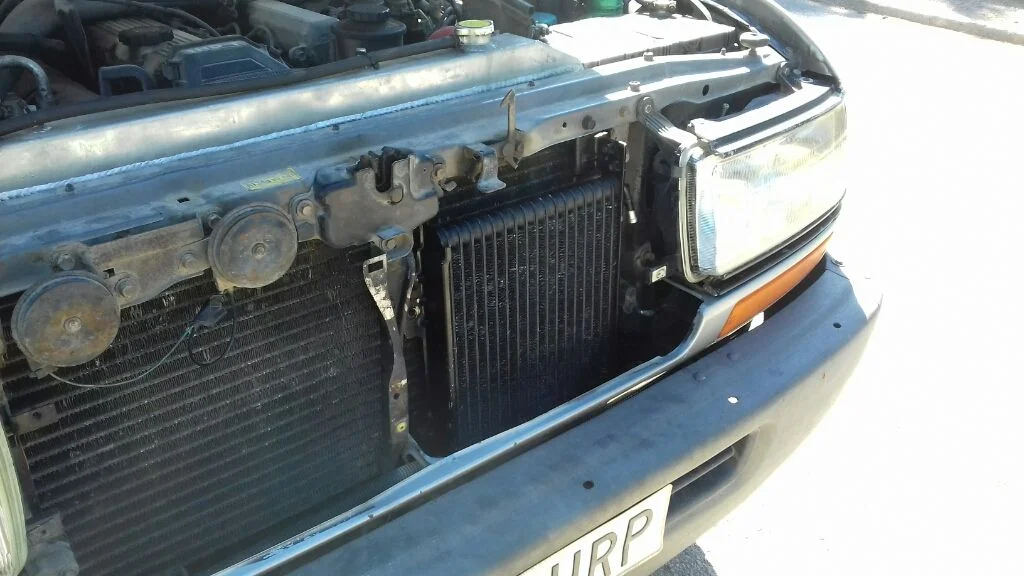

BTW what's your opinion on this? I am thinking that with a years driving dirt on it, my ITV station would have no clue that's not how it came out of the factory.. :)
also in Red anodized, for anybody wanting to make it stand out, rather than fade in :)

Hi Dave. sorry for super slow response, have been just using it and not working on it last couple of months..
the intercooler is something I only saw pics of on the UK LC Facebook group, and he just doesnt get back to me about prices :( Im thinking the guy made one or two test ones and has probably been swamped by "me, me me" requests lol.

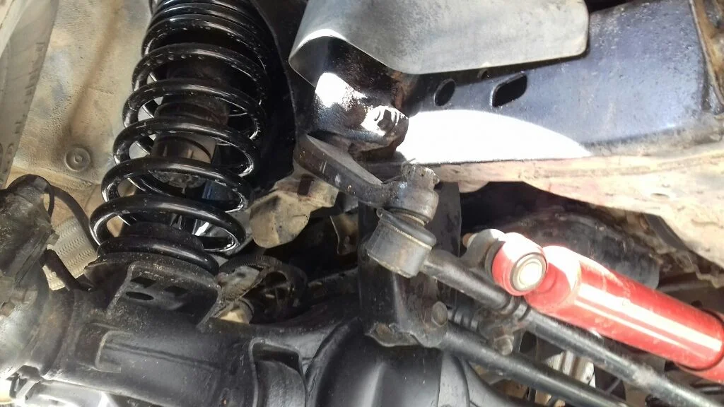

OME 2861 / 2862 coils fitted, with 15mm (rear) and 20mm (front) spacers, new Tokico shocks at rear, the front are 3 years old.

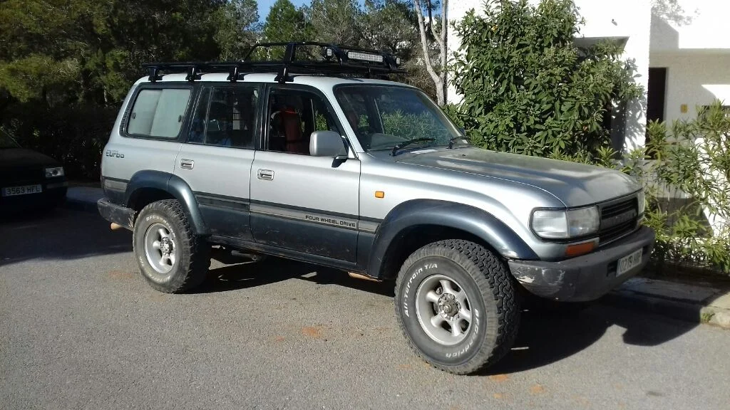

from this
upload_-1-50-jpg.1414275
to this
upload_-1-49-jpg.1414274
I also have these to go on at a later date, Pedders Foam Cell Front & Rear Shock Absorber Kit 0-2"
but lets get her through the next ITV first, the OME coils are black, and with OEM Toyota shocks on, shouldn't really look too "modified", with any luck, the lift is quite subtle, about 1.25 inches, and back to a very slight stinkbug look with the extra 200kg onboard.
but the difference to drive is just unbelievable, from sagged and beaten, to firm, solid and strong over bumps, and offroad (took her rock crawling last night) is a whole different world to how she was before. very very very happy :)

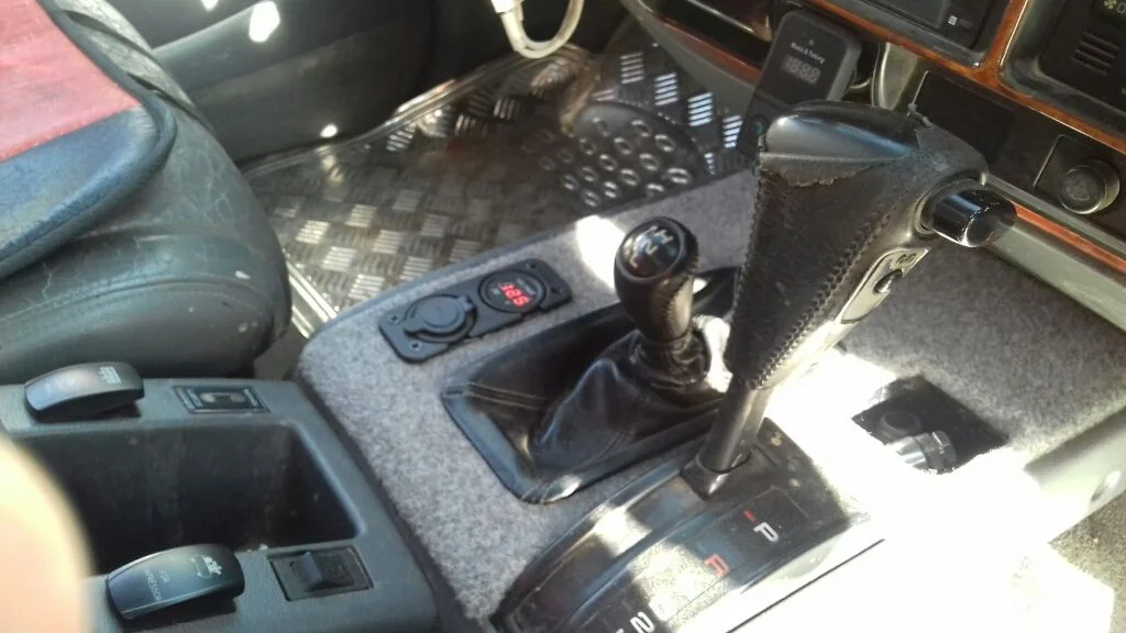

and some interior stuff and comforts too. (engine side, same as the one for the utility battery at rear)) voltmeter and phone charge socket on console.

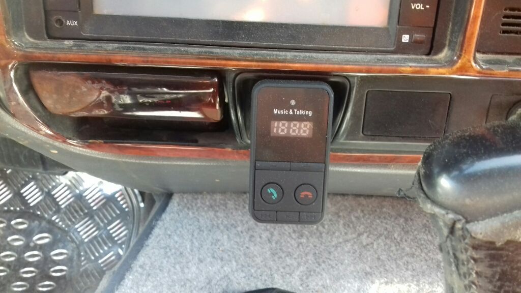

a great little device that plugs in the cigarette lighter, bluetooths into a phone, and re-transmits the signal as FM that you tune your radio into. cheap and works extremely well.

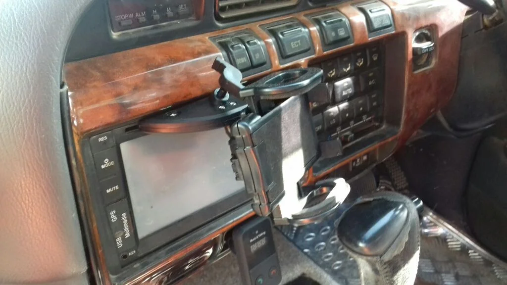

Plus a phone holder that fits into the never-used DVD slot on the stereo, and allows you to angle the phone nicely towards you (for Google Maps GPS obviously, not Youtube documentaries while on the move.. :)

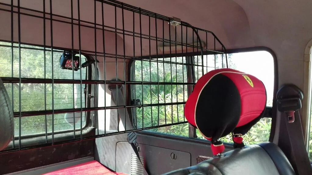

and I fitted a dog guard, from eBay, that Im not super happy with, but will do. returning it from here is too much hassle. basically it's just too small, it was supposed to be for an 80 series, but Im not convinced. On the plus side it is fairly sturdy compared to some of those cheap ones, the fixings are all decent metal and it doesn't flex or vibrate, so I can live with it.
I think Im going to support it at the top corners with some wire rope to the rear grab handles too though, as the full weight of 2 big dogs on only the headrest supports in an accident wouldnt work out well.
