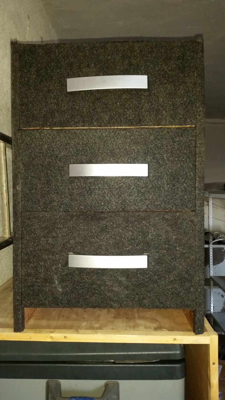

Drawer set.

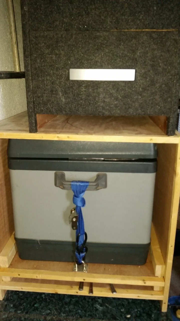

Fridge holder/slide. My carpenter friend made the simple slide using a strip of Formica, on the recent trip to Tabernas desert I left the tailgate down and was parked point slightly uphill. Good job a fellow traveller saw the fridge making an escape attempt, I could have lost the lot! I will put a chain behind it to limit how far it can come out. Needs covering at the moment.

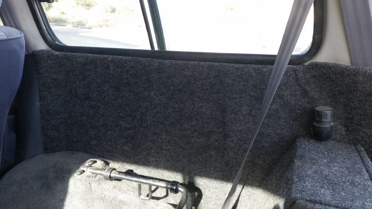

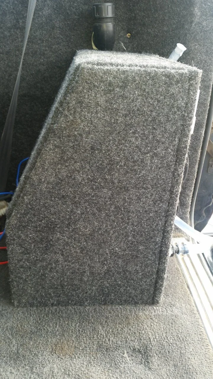

The water bladder behind the right rear panel, a 'MUD' member warned of the bladder making the plastic side panel bulge and distort. I removed the plastic panel and replaced it with some ply. Then where the panel curves out to the body front and rear, I cut the plastic curved area off and then screwed them to the wood, the covering nearly hides the join, I will put another cover over that later, it has to come out as I need some tin worm cut out and new metal welded in.

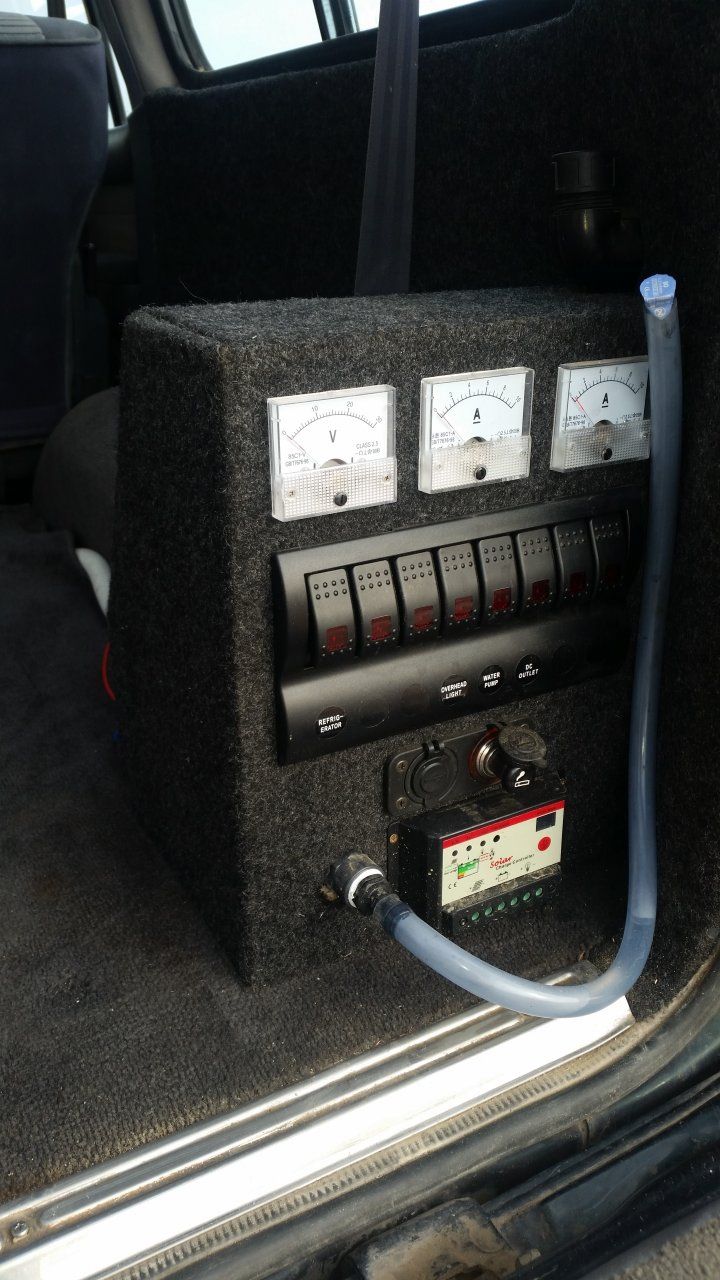

The next pictures are of the water pump box, this also houses the wiring for the gauges/solar controller and power distribution points. Above the box is the fill point for the water bladder, have to be careful not to overfill, I put a piece of plastic there when filling just in case. The lid of the box is held in place by magnetic catches and simply lifts off. As the box is a permanent fixture whether camping or not, the slope at the rear allows me to use the rearmost seats, this keeps the inspection people happy.

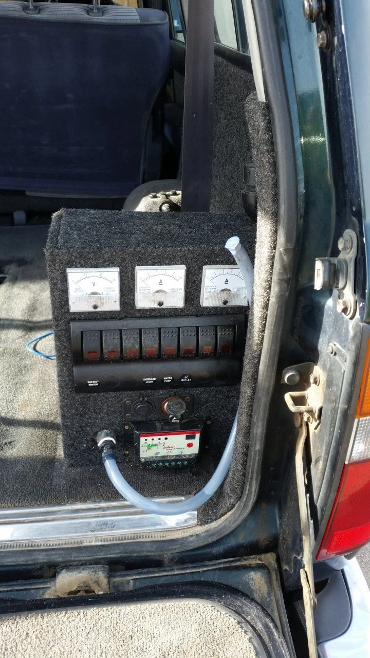

The control panel from the front. The water pipe at this point is just pushed on the pump connector, I do need to find a quick release connector. The pump has a 'no drip' valve so will not leak, just in case thought there is another tap inside the pump housing, this can be used to isolate the water bladder from the pump if anything needs maintenance.
Another front view of the control panel, I was asked as to why I use the analogue gauges, simple really, the LED and LCD are not so easy to see when the sunlight is on them.

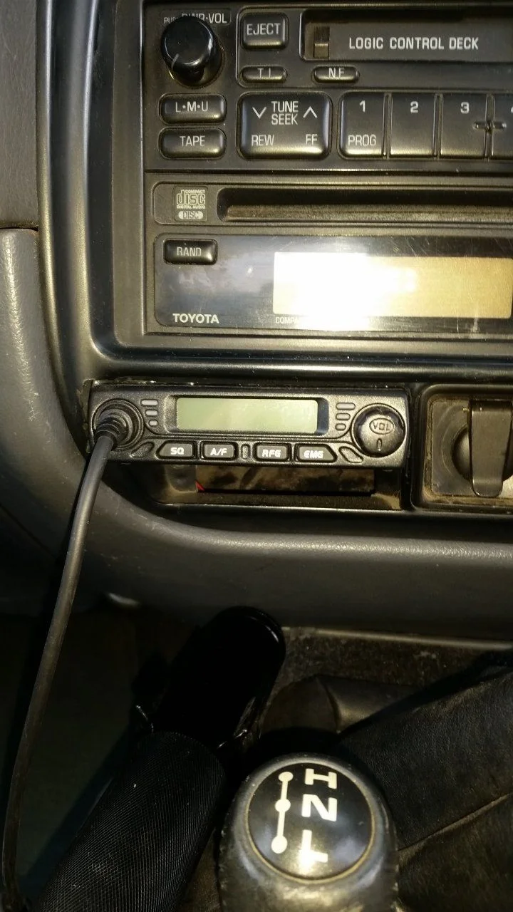

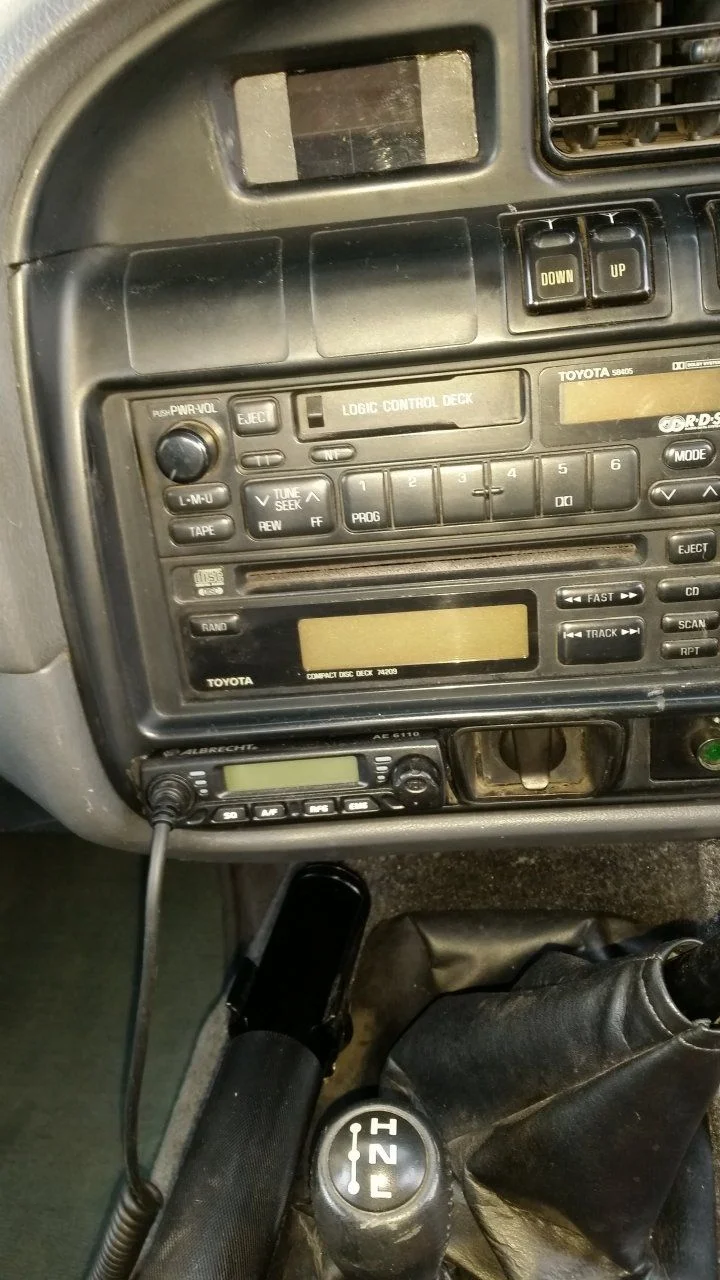

This final couple of pictures are of the mega small CB, just a little widening around the ashtray opening and it fits like a glove.
The CB is an 'Albrecht' unit model number AE 6110, no bells and whistles, just simply does what it says on the box, plugged it in, set the SWR and away you go. I have two criticisms, the microphone does not unscrew when not needed, and when you do put the microphone down it is way to easy to change the channels, the buttons being on the mic and are very sensitive, you can lock the buttons, but if you need to alter the squelch or gain on the quick, you have to unlock them again. Given you are in a convoy with little distance between you then you can wind the squelch up and lock the buttons and leave it there, so a minor issue really. The gap under the unit is perfect for sound, the speaker is in the bottom of the unit, so no external speaker needed.

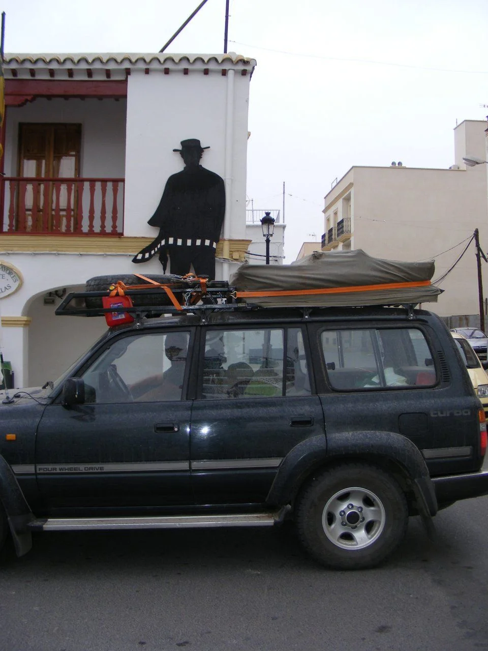

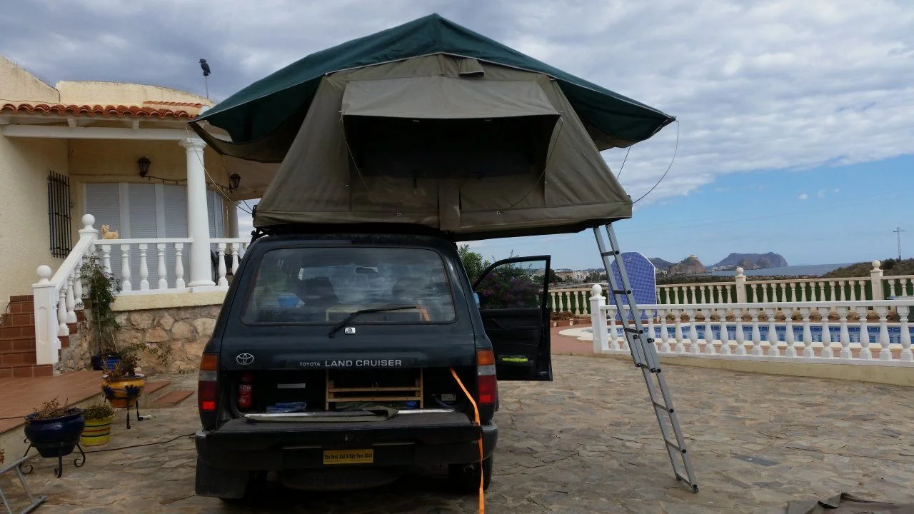

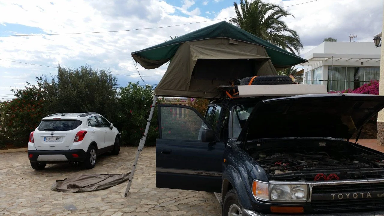

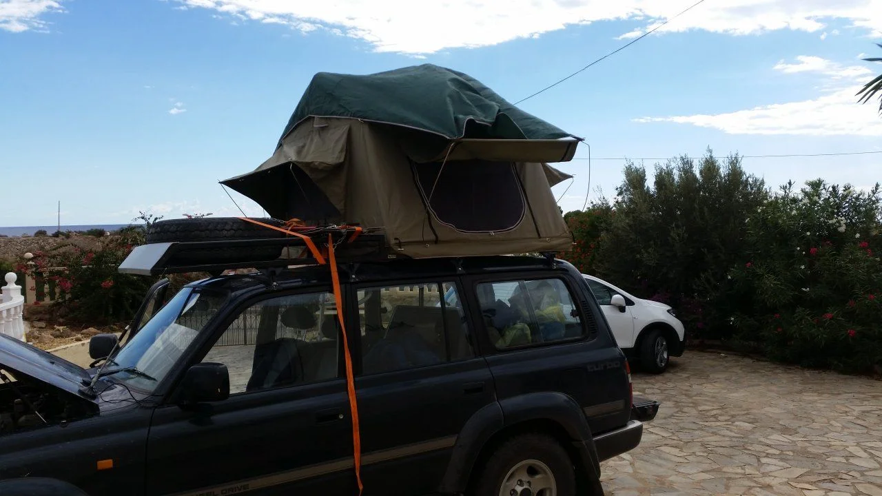

The rack and tent pictures you asked for @kevsta, one is in the village of Tabernas and the others during strip down after returning.
The full length rack holds the tent (obviously), a second spare wheel, sand ladders, a 48" hi lift, (60" only goes when I am on my own), there is 10 litres of diesel up there in this pic, in the garage now are two 40 litre jerry cans for future use, and a 3 piece ladder for climbing onto the rack. I do not rely on ratchet straps to keep everything safe, the sand ladders for example are sharp enough to fray and cut at the straps. Everything is chained up (down) and held in place by small 'U' shaped versions of bow shackles. The shackles can be replaced with padlocks if in areas where this may be needed and the vehicle is left unattended. The advantage of using the shackles is they do not get screwed up with fine dust like padlocks do. The orange ratchet strap is simply pulled tight over the accessories and stops a lot of rattles that would otherwise drive you (me) barmy.
If I had a brain Kev then I would have dropped the tailgate and you would have seen the drawer system installed, it is there but not really visible.
