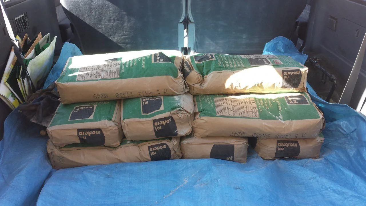

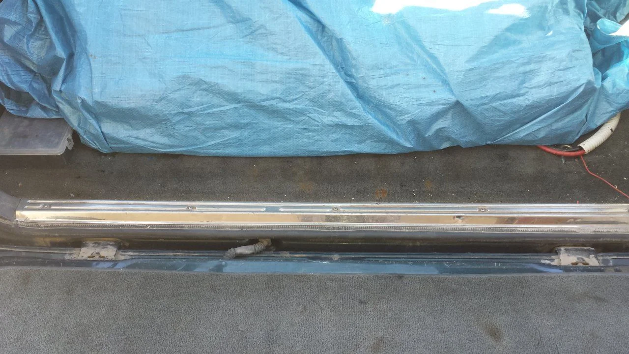

Today I had to move some bags of cement in the LC, I decided to measure the suspension movement before and after the bags were loaded. My car is totally stock in the suspension/wheel areas. If in the near future if I were to replace/upgrade anything I have a good reference point.
Before
Top of wheel rim to lowest point of wheel arch so tyre crush is not in the equation, figures in cm,
Right rear 31.5
Left rear 30.5
Right front 26.5
Left front 26.0
Loaded 250 kg across the space where the rear seats would normally be (removed at the moment), I have added a couple of pictures so the position of the load can be seen, I added some other fun pictures I mean you did not expect me to carry the bags up the steps did you? :lol:
Right rear 27.5
Left rear 26.5
Front right 26.5
Front left 26.0
I thought the 1 cm difference was for the driver (RHD) and then remembered the fuel tank was close to empty. Later in the afternoon I filled to the brim and it took 80.66 litres
Right rear 30
Left rear 30
Right front 26
Left front 26
