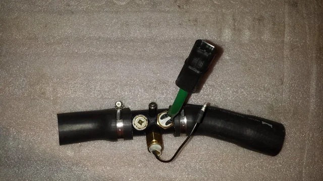

A quick update as to the electric cooling fan install progress.
The 'switch tube' has been assembled with the fan and warning switches. The tube has an earth tag welded on, this will be connected to the body earth in the normal way. The overheat switch has two cables these will be fed direct to the dashboard, I am trying to cover my ar*e from overheating damage from a simple earth cable failure, hence the independent earth to the warning system. The temp switches (3) are all new from Facet, a variety of temperatures control the first/second speed and the 'potential' for overheating warning. The temp choices are all 'suck it and see' at the moment, so will alter if need be later, this is a little more complicated than normal as the fan switches are in the bottom hose and not the normal top.
The relays are mounted as can be seen on the side of the air filter container, the relay holders clip together but were too rigid to wrap and mount neatly so I split them in two. Power cable/earth runs are kept as short as humanly possibly to prevent any loss of voltage, the fan motor should see full battery potential.

Whilst waiting for the new switch tube to arrive I decided to 'Araldite Rapid' the hole from inside the tube. You could feel the small hole where the earth tag was welded on. The supplier was as good as gold and sent a new one within 24 hours, just checked tracking and it is well on it's way, so I have to be happy with that. So with the hole blocked I fitted the tube I refilled the rad and bled out the air, all I need now is the engine to get hot enough to bring the switches into action. Despite being 25+ it would not get hot enough, I took the car for a blast around the block and with the bonnet shut and the car in the sun after about 20 minutes the slow speed fan came on. The dashboard temperature gauge showed midway between cold and hot, the fan run for 30 seconds (yeh how anal am I for timing it?), this brought the temp down to just about where it sits during normal driving. I let this repeat three times, and give or take a few seconds it was fan on 30 seconds and then off for 12 minutes and then repeat. The times it took for the engine to heat up enough to bring the fan on did reduce by about two minutes from the first to the third.
Whilst leaving the engine running I disabled the slow speed and waited for the second speed to kick in, this took around 5 minutes after the expected slow speed to come on and the fan run for just 13 seconds! I quickly reconnected the slow speed sensor and checked the temp gauge, it showed about a third from the top, not very scientific but the thermal sensor is at the other garage. Then it switched down to the slow speed and that carried on for around 40 seconds. I guess the extra time came from the additional heat soak? I did not continue to the overheat warning as I had other stuff to get on with (drive up the beach through the river beds up to the mountains), so far so good. I watched the gauge like a hawk for the next couple of hours driving, in particular when in low range i.e. high revs low road speed, and stopped a couple of times to check for leaks and all good for the moment.
Keeping in mind the cooling system of the 80 is designed to cope with a gross vehicle weight around 7 tons stock, it is not surprising the cooling system has so much reserve.
I noted that leaving the bonnet up would allow enough heat to escape that the fan never came on at all, there was a slight breeze today and that no doubt helped. Keeping in mind I had been running around with NO fan and even after fitting the electric never actually needed it and also this mod (at the moment) suits my particular driving environment, rarely in traffic, steady 90 KPH on the coast roads between towns etc. It's worth will be during the mountain climbs/excursions like we were on today where it performed thus far perfectly, will it work in the 40 degree C summer with the AC on, who knows?

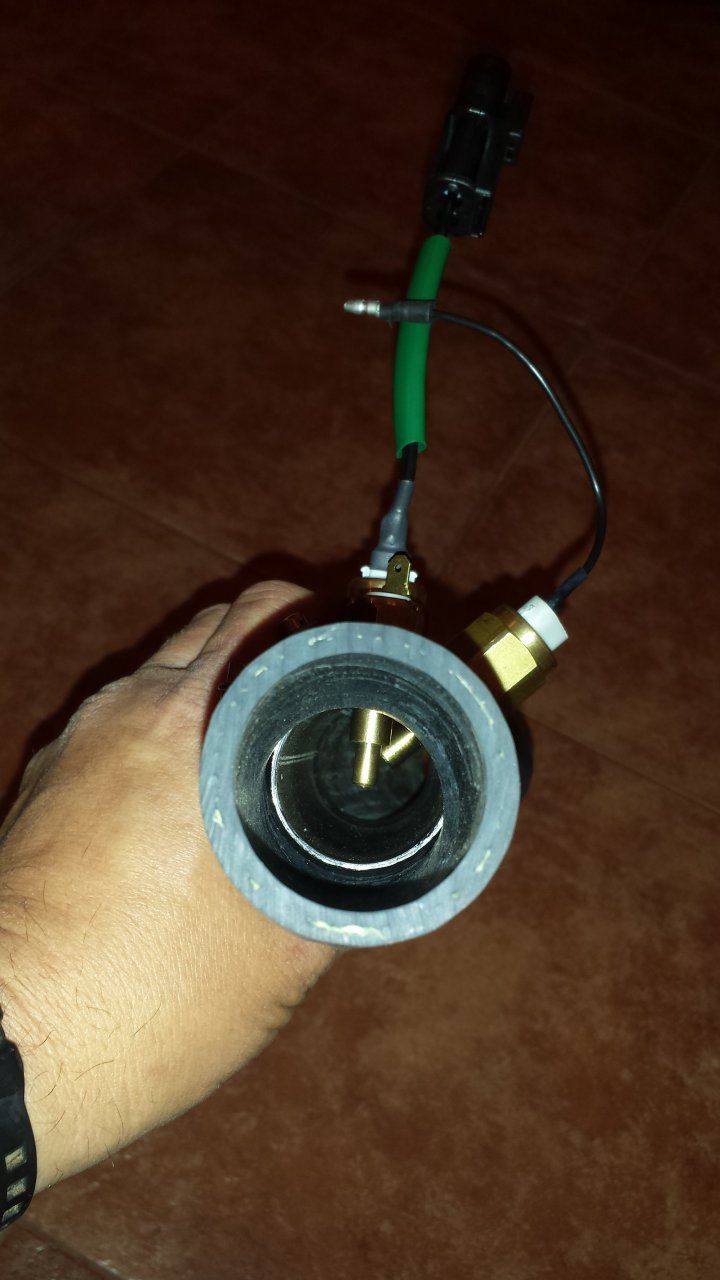

Well Houston we have a problem. Today I took the 80 out for a drive inland, just myself and a couple of friends no other weight on board. Getting inland from the coast where I live involves a run up my favourite hill which I did at around 70 MPH, initially no temp gauge movement and then at around 150-200 metres it started to climb, and slow but sure by the time I had reached the 500 metre mark the gauge was showing higher than I have ever seen it, definitely very near the 3/4 mark. I would have guessed the electric fan would have been on but still no indicator lights so cannot confirm that. I was waiting for some dash parts from the UK but the supplier has been busy and I did not want to take the dash out twice to fit the fan status lights, well tough I will have to go ahead and do it as a means to help find out just what is going on.
The last few days we have had some sudden crazy outside temps and this morning during the hill climb it was around 28c (83.4 F), this afternoon it hit 35c (95f) so summer is well on it's way. But then that does not explain the higher than average temperatures (see previous post) shown on the way back from the airport last week. So back to today, the moment I reached the brow of the hill and started going back down the temperature was where it normally is in under a mile. So what is going on with my temps? There is no apparent water loss, right at the top of the filler neck and expansion tank between the marks, the coolant was new at the last fitment of the switch tube so the mix could be different but TBH I am grasping at straws there IME.
The thermostat was new about three years ago...ish, it was IIRC an OE unit and up until now I have had no reason to doubt it's function, of course it will not be dismissed. Something that did bother me was the intrusion of the switches in the metal tube fitted in the lower hose, they are an obvious obstruction to water flow but I gauged the amount of space around them, should equate to more than that of a fully open thermostat. There is a possibility they are causing some form of turbulence.
Without doubt they do obstruct the flow to some degree (no pun intended) but if it is enough to cause this problem I am unsure? To get a better idea of the obstruction which is not clear in the pic, I suggest you cut and paste and then zoom in and you can see there really is a lot of space, the appearance that two switches are touching is an optical illusion. Why have I not seen these temps changes before, is it because the flow was sufficient when the temps were cooler? When I fitted the switch tube I installed it with a new rubber lower hose which was cut, I plan to pull the switch tube and hose and replace with the old stock one which I kept as a spare. I will need to do this soon and will try for Tuesday am (30c expected in the pm) then if the temps go up I will be prepared to take her for a run and see if I can duplicate the running temps.
I am open to any thoughts on this,
regards
Dave
Update. Removed the switch tube and replaced with standard hose, refilled the rad and hit the aforementioned 'test' hill and the same result, even though today is a little cooler the gauge definitely more active than usual. After some testing at allegedly illegal speeds I stopped in the garage and put some diesel in. After picking up my account ticket I opened the bonnet and gave the hoses a squeeze and found no excessive pressure, opened the filler cap and level was correct. Started the engine to head off to the spares shop, I noticed straight away the gauge was slightly higher than norm within seconds, knowing full well there was no indication the engine was that hot when I opened the cap? I popped in the local spares shop and have ordered a new thermostat but, if that had been playing up i.e. not opening correctly then the engine would have been very hot, the ability to open the radiator cap three or four minutes after flying up and down the motorway would indicate that this is not the case. So, am I being led up the path by a faulty temperature sender or, the fact that ambient temps have climbed by nearly ten degrees in two weeks, or...............?
Fit the stat when it arrives, I will refit the switch tube as well as that theory has been thrown out of the window, get back to you.
Regards
Dave
EDIT: I have ordered a new temperature gauge sender as well but will fit them at different times to ensure continuity of the test results.
