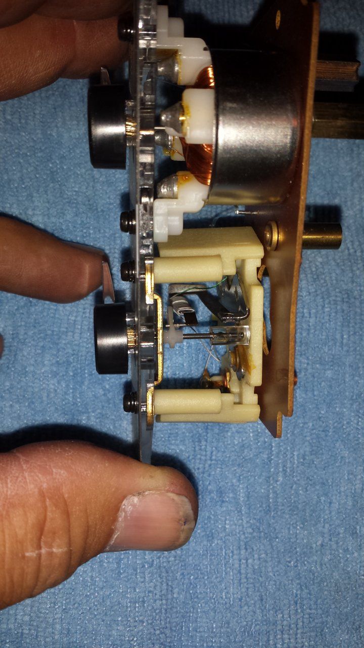

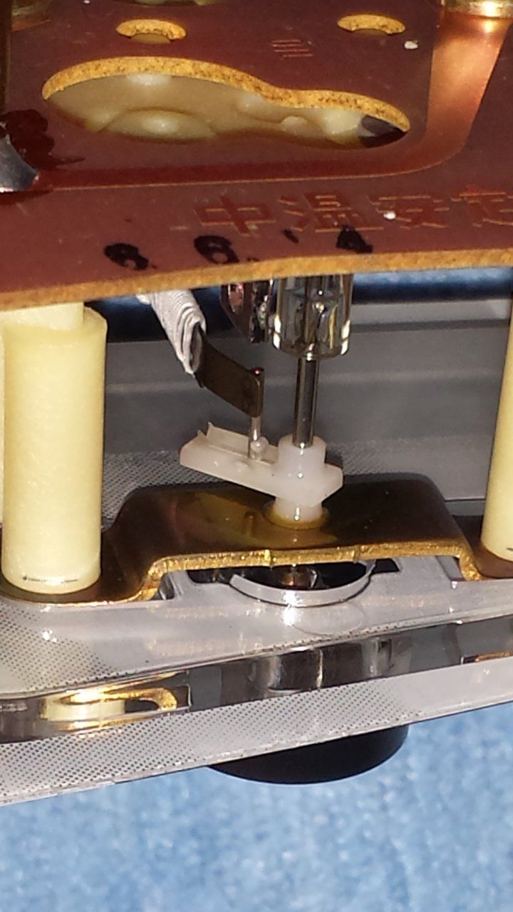

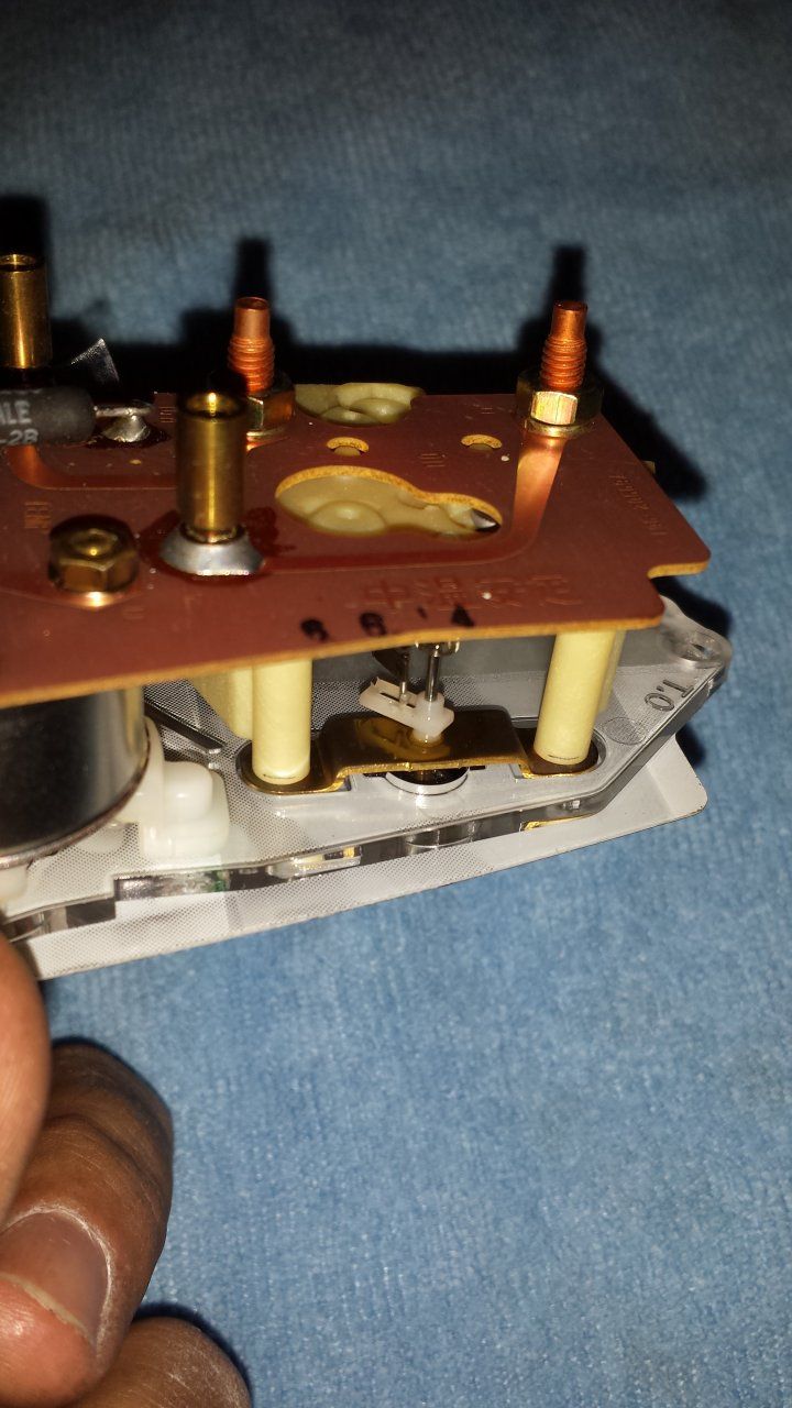

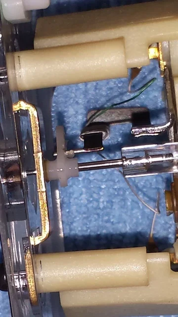

Oil pressure gauge update. Still up the mountains but did get the dashboard apart and the oil pressure gauge out. I had followed the schematic and had power where I should have power and resistance where I should have resistance and yet it still did not work :confused:
I noticed there was more resistance (finger pressure) from the needle in one direction and not the other but could not see any form of wound spring to force the needle back to rest i.e. no volts no reading. My eyes are not great close up but eventually noticed the pin that was applying the pressure against the needle should actually be in a tiny slot in the base of the needle, this was not obvious to me, the small size of the components and aforementioned dodgy 'lamps' did not help.
I carefully manoeuvred the pin back into the slot and I am thinking this is the fix, the gauge fuse had not blown but, I reckon the bimetallic strip got so hot it buckled enough to pull the pin out of the needle base? In one of the pictures you can see one of the windings has some discolouring, this may or may not be cause by the direct current?
I will put the dash back in tomorrow morning and put the oil pressure sensor back together and see what occurs, have a glance at the pictures in thumbnail view, that is pretty much what I could see, it is only when the pictures are zoomed in the problem was obvious.
For some reason the site is rotating the pictures so copy and paste to your screen and rotate/zoom to suit your yourself.
Dave
Gauge update:
So the problem was as follows:
The wire from the sender that had come off was the earth return to the gauge. It would receive an earth signal from the gauge and the needle would rise and fall accordingly. The dead short to earth had pulled the pin on the bimetallic strip as per my previous post and pictures. Once I put it all back together the gauge was not reading as high as it used to. So I removed the sender and recalibrated it to the gauge so it now reads correctly. The sender has been apart so many times it is looking a little worse for wear, one thing I have noticed is the new ones are calibrated as near as the guy thought 'would do', of course if you like your gauge to read correctly then you should calibrate the sender to your individual gauge. TBH precision is not really called for but as long as the 'sweep' is reasonable enough then most would be happy with that, IMO a light and buzzer would get your attention a damn sight faster than a gauge slowly falling as your oil emptied out of the sump.
So that can be put to bed, I have kept the centre part of the dash out (the part that the auto has to show gear selected), on the manual this is a simple black moulding, it would be easy enough to drill a few holes for the cooling fan status LED's but it would look a bit 'mickey mouse' for me so, I have ordered some transfers and am now looking for a piece of Perspex or acrylic to put the transfers on.

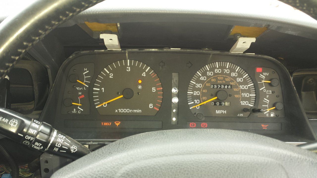

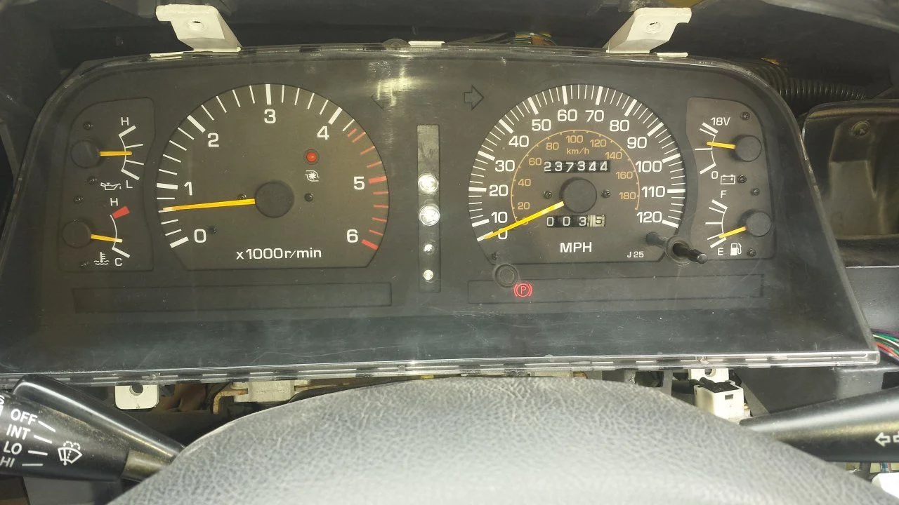

Update.
The dashboard fan status LED's have been fitted in the centre bar normally used for gear selection indicator on the automatics. On the manual this is an unused panel that can be unplugged and switched for an auto version at will. At the moment the clear LED's don't look great but there is a reason for using the clear high brightness versions. I am waiting for a set of decals to arrive from the UK, depending on how it looks the decals will either be glued on the front or rear of a piece of dark Perspex, the LED's will be expected to shine through..........hopefully.
From bottom upwards the first lights up Green to indicate the fan is on slow speed, the one above lights Amber, this shows the fans second speed, next is the 1st of the larger LED's this flashes Red if the fans fail to control the engine temperature, the final large LED also flashes Red but is paralleled to a buzzer, this indicates oil pressure lower than 15psi, I set it at that, I figured that in the event of a sudden loss of oil pressure the 15psi would give me a few extra seconds to shut down the engine... The oil pressure buzzer and LED self test when the ignition is switched on, cranking the engine brings about the self test for the three temperature LED's, starting the engine they all go out and the buzzer stops.....hopefully :lol:....no seriously they do work fine.
I have also posted a couple of pictures of the dashboard, the intention is to show not only the LED's but also the position of the oil pressure gauge needle mentioned in an earlier post after calibrating the sender, this is with the ignition on and the engine off, the second shows the gauge position at idle when hot. Mobile phone pictures since some bastard stole my camera/passport and other personal 'stuff'.
I will post up the pictures when I have found the right colour/density Perspex and fitted the decals, I would love to have the icons etched out of the same Black material Toyota use at the bottom of the display, i.e. nothing shows unless it lights up, that is a bit of a tall order I think?
