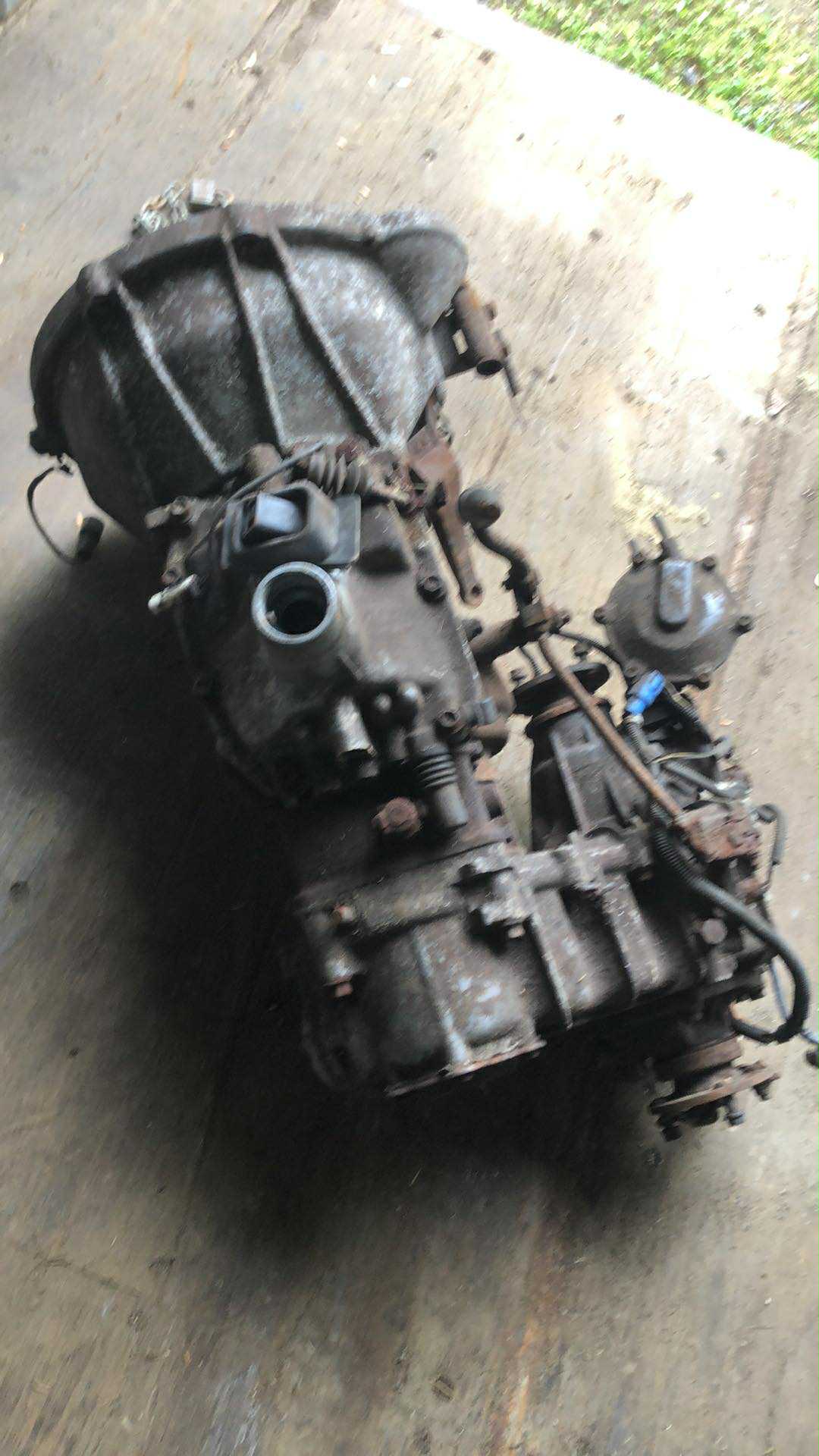

Bought a 5 speed ! Hoping the part truck will have what's missing ( except the flywheel obviously) at least it's a 2h Bell housing and front shaft.
View attachment 3932061View attachment 3932062View attachment 3932063

You need a 5 speed shifter. Might as well get the new nylon bushing while you’re at it. The 4 speed won’t work.
