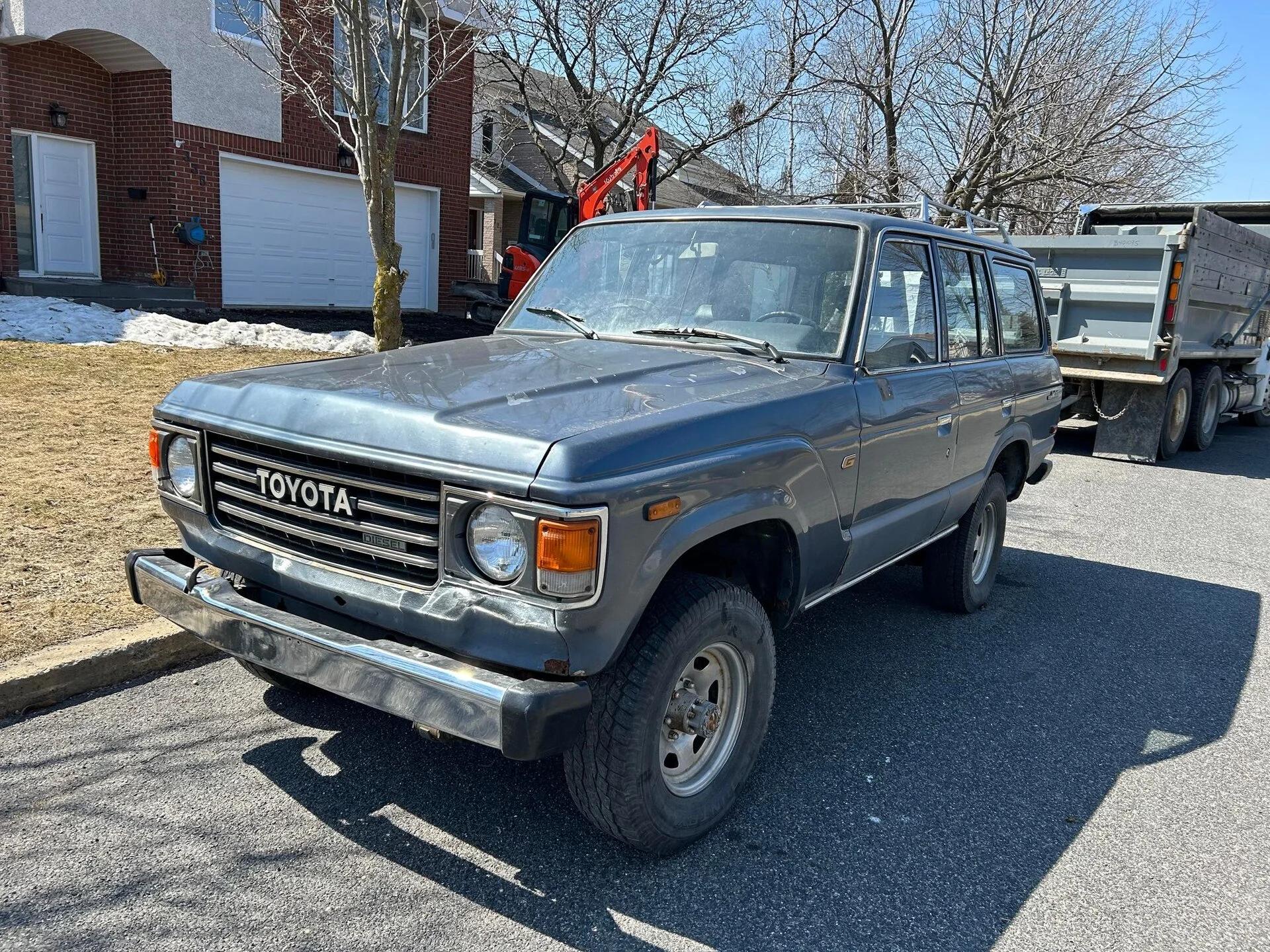

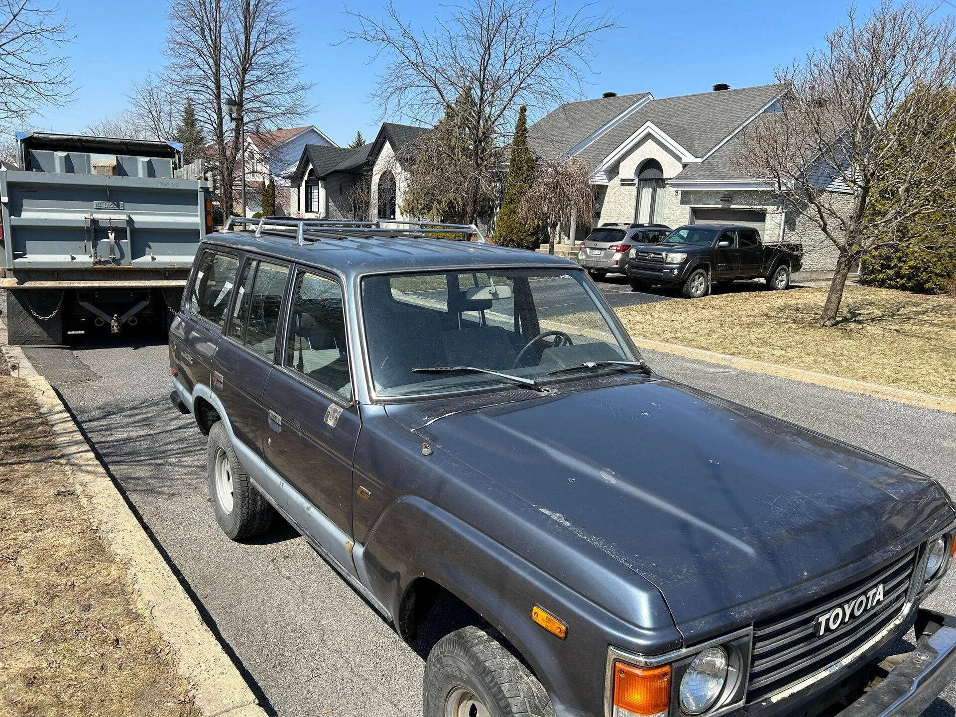

My name is Matt im from Canada (Quebec :poop:) And I just got my 2nd Land Cruiser witch is a 1987 HJ60. Currently not running ,need a few things to be in shape... the plan is to change the 2h motor for a....2H motor ;) and make a quick and clean paint job.
My first Diesel that I will have to tear apart and I think this forum is a good source of information as it always come up first in my google searches.
here is the monster :
need a few parts that im gonna get this week end with the replacement 2H (that I hope is better than mine) Engine is already out and Will be opened later to see why it failed :) Will let you know !

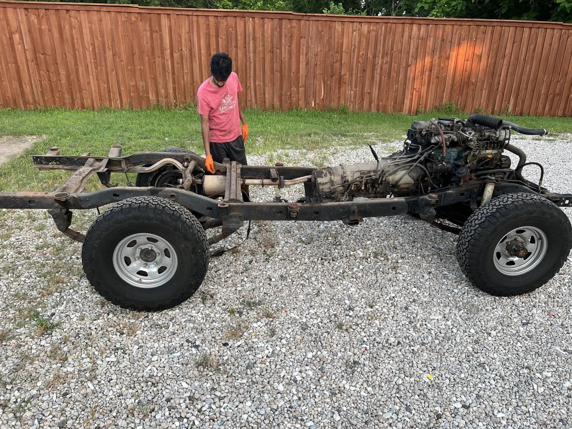

I have a working 2H motor on a rolling chassis if you are looking for one. I have three more 2H’s in the shop that are in working order as well.

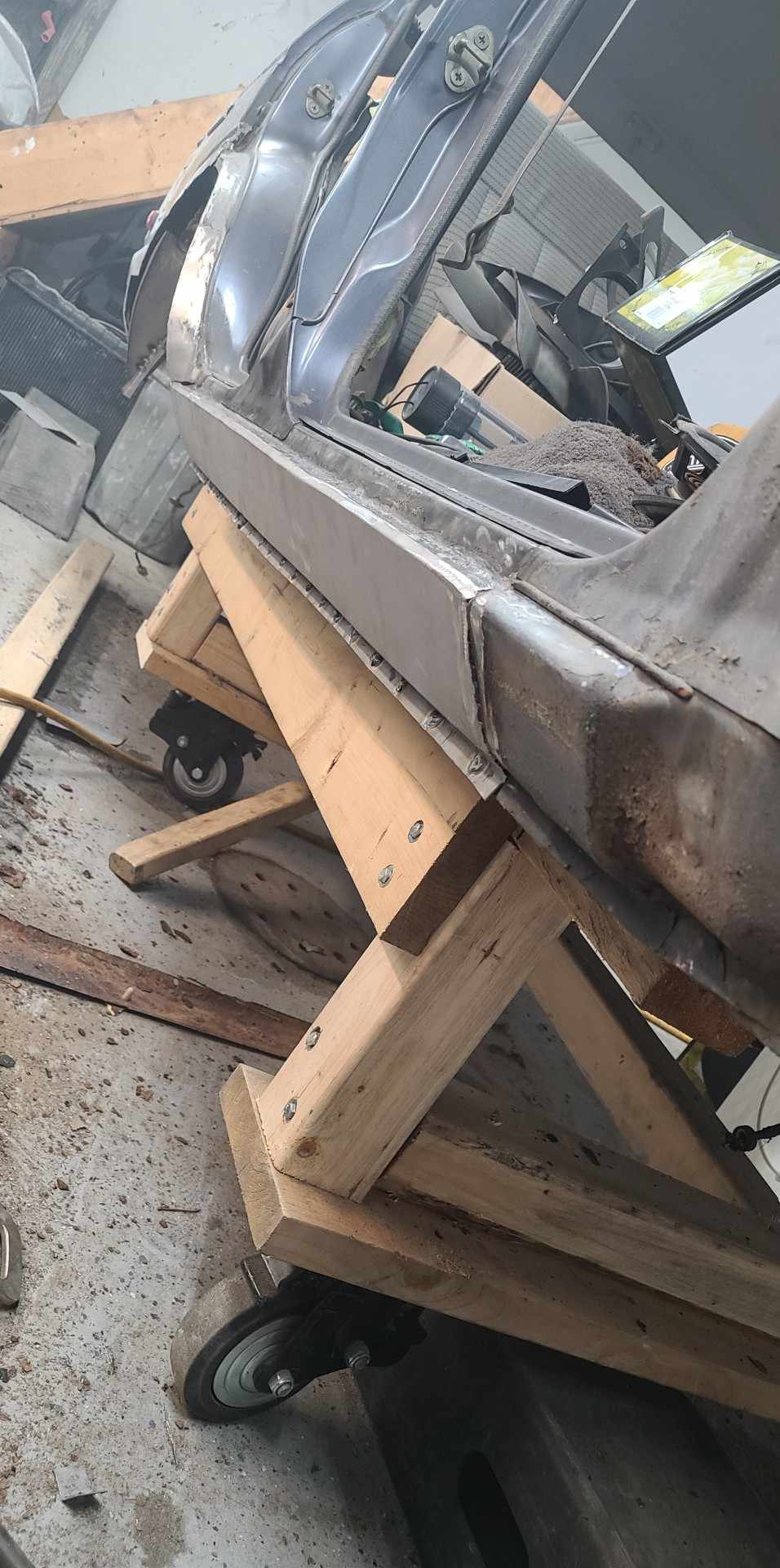

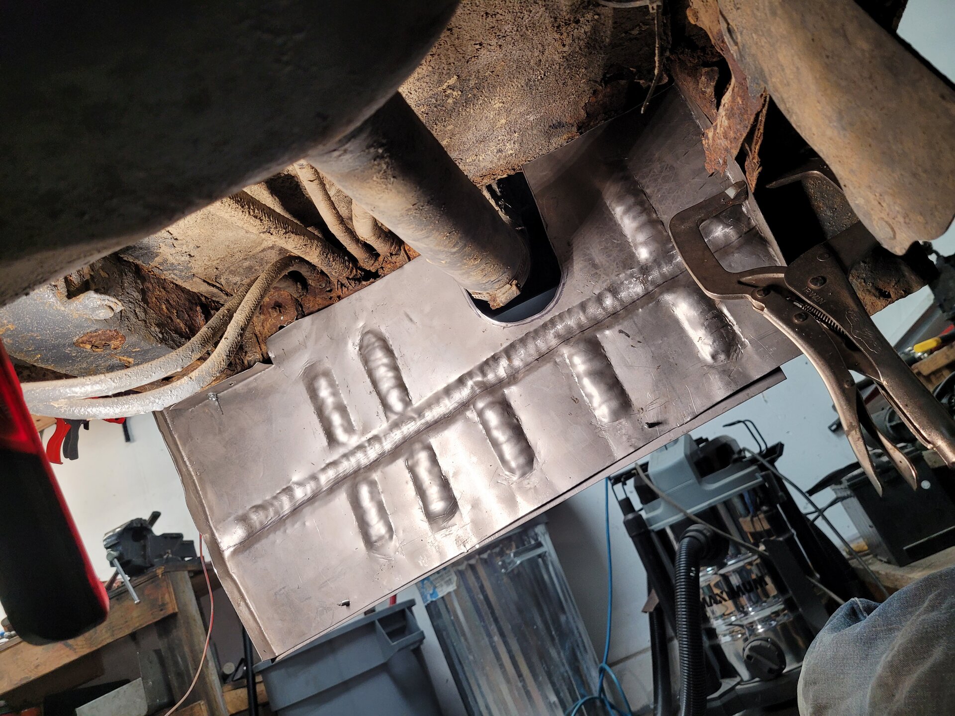

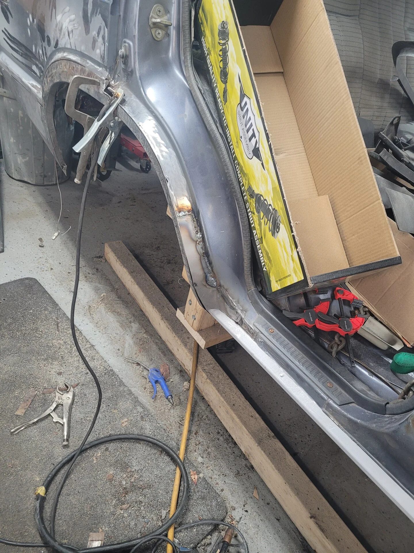

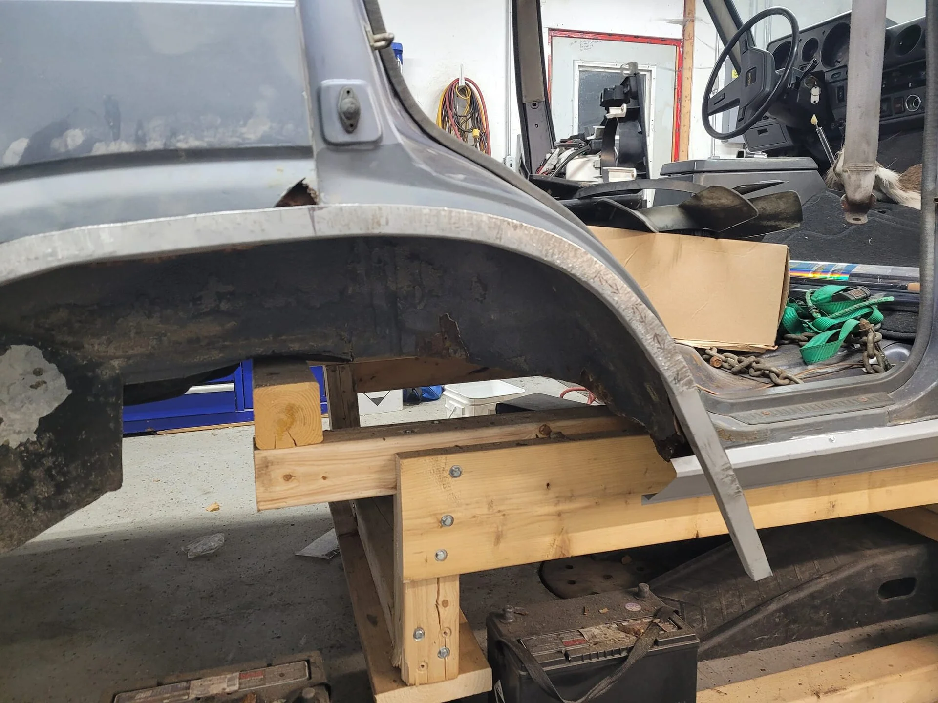

a little more progress on the passenger side :) , not oem looking but should hold. need to bush the rust out around it to get some meat to weld on.
Also need to find a kind of grommet for the filler neck and think what im doing with the vaccum /evap hoses aside it ... once done its gonna be blast and POR15.

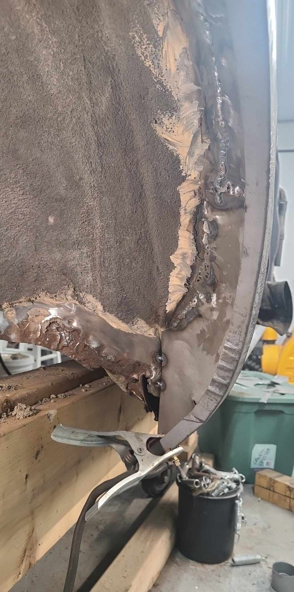

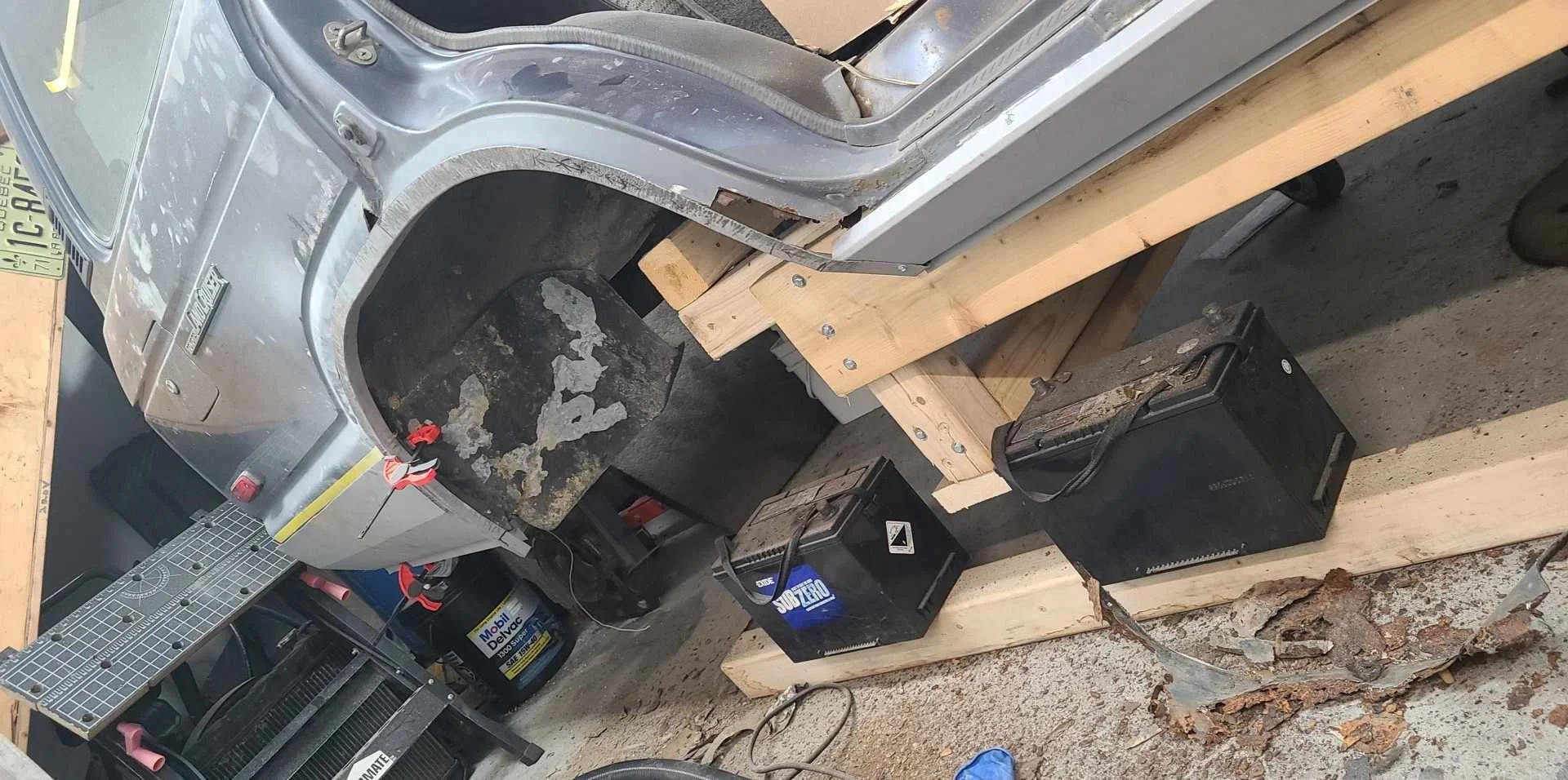

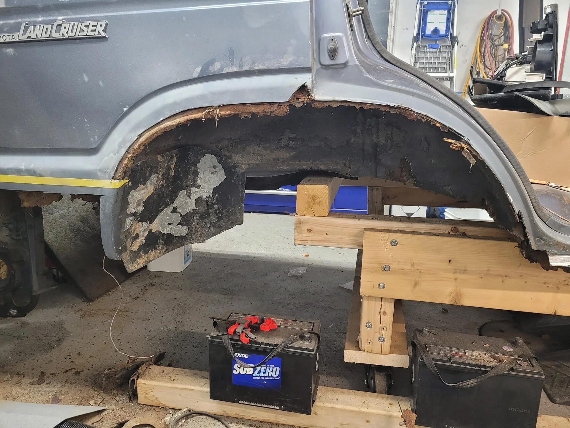

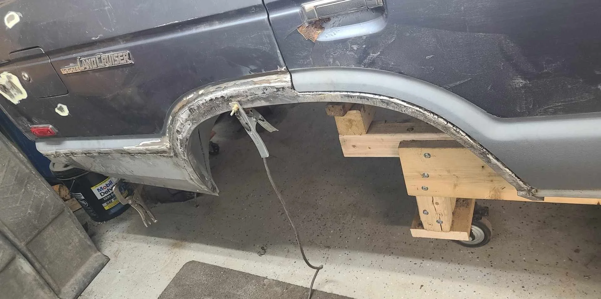

Did a lot of grinding / brushing ... damn that sealer is thicko_O got to the clean metal at least so I will be able to weld

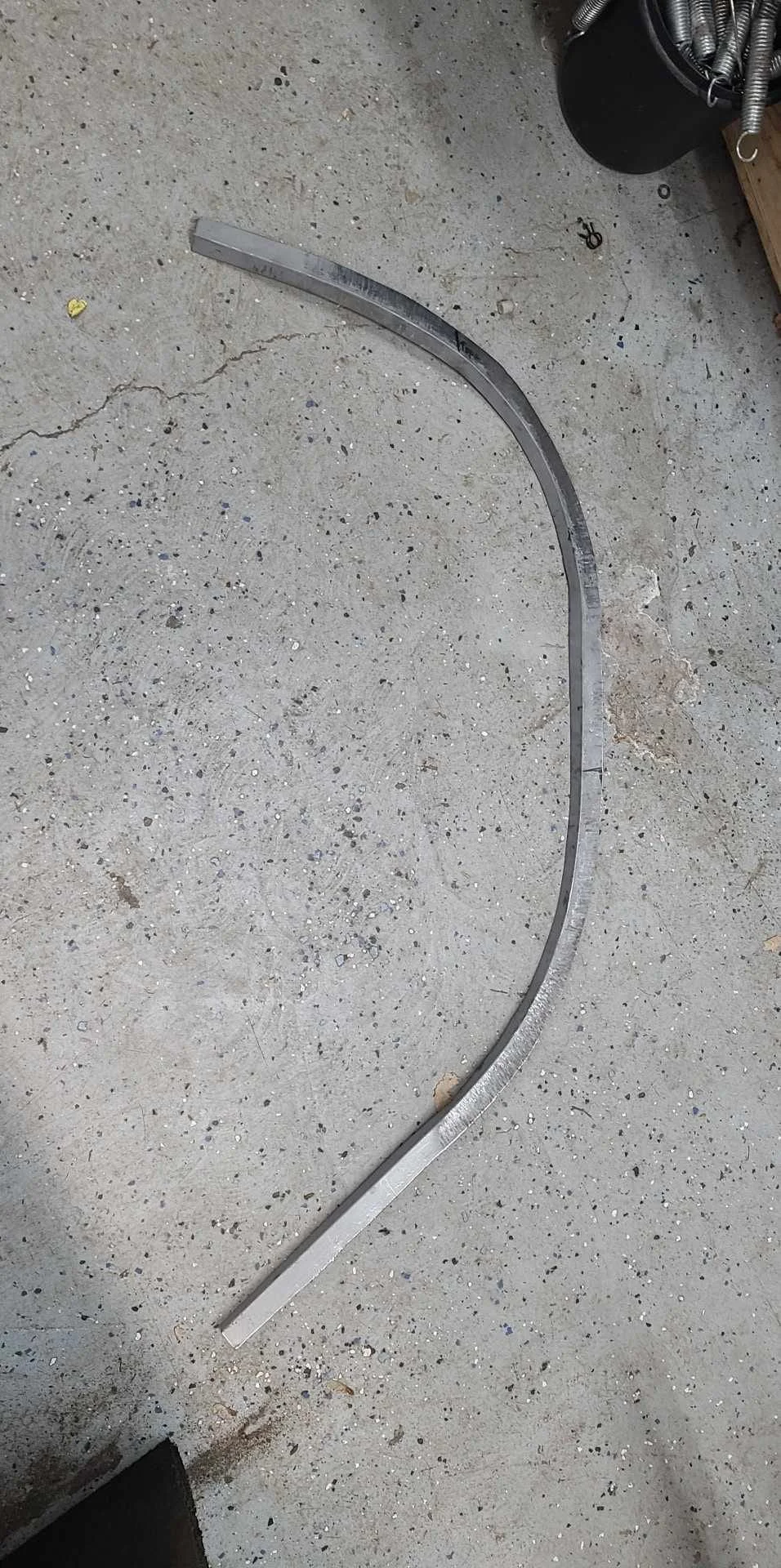

Then I finalized the wheel arch prep for the patch I made .. still have to shape the wheel well patches but its coming along.

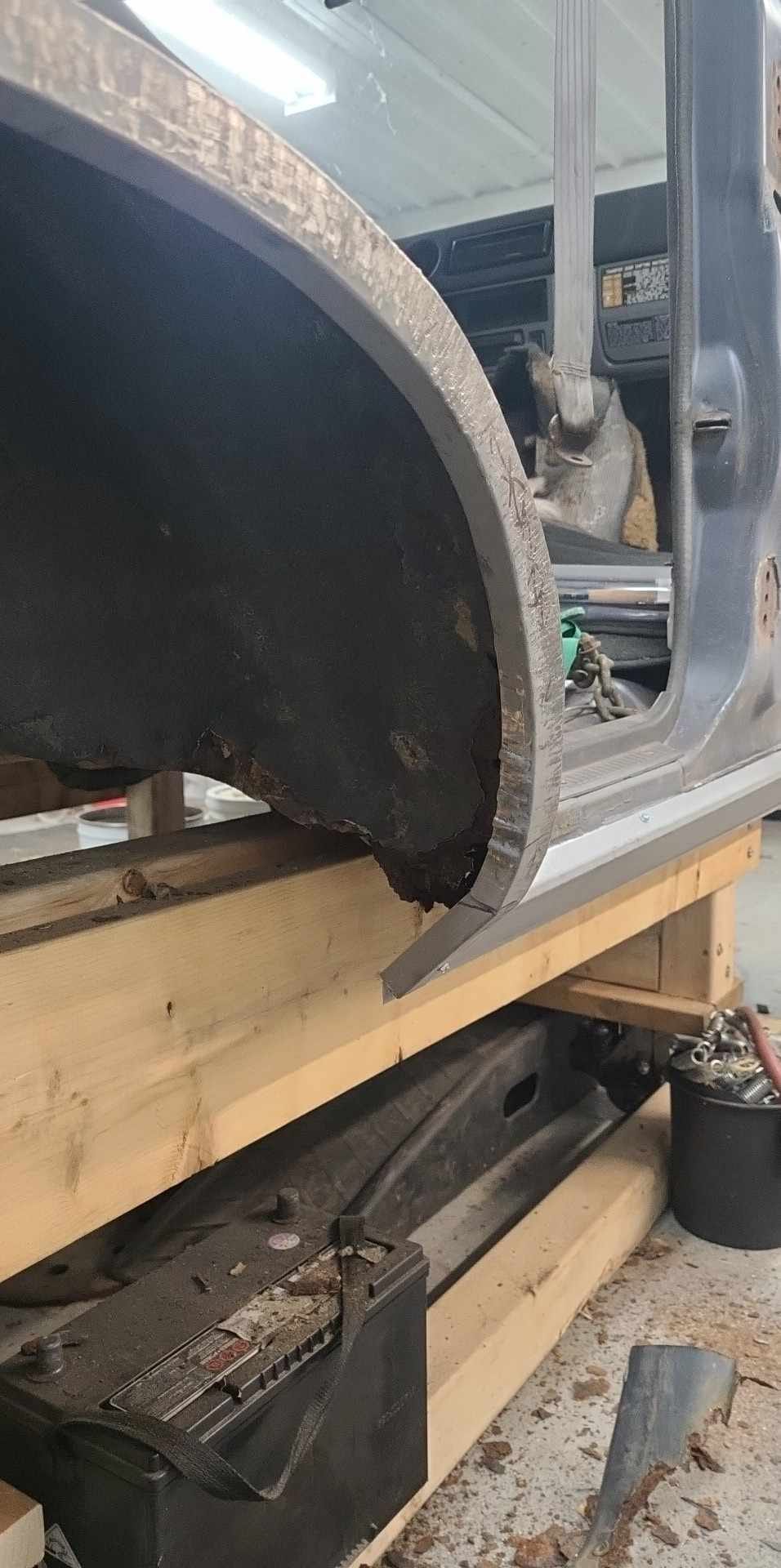

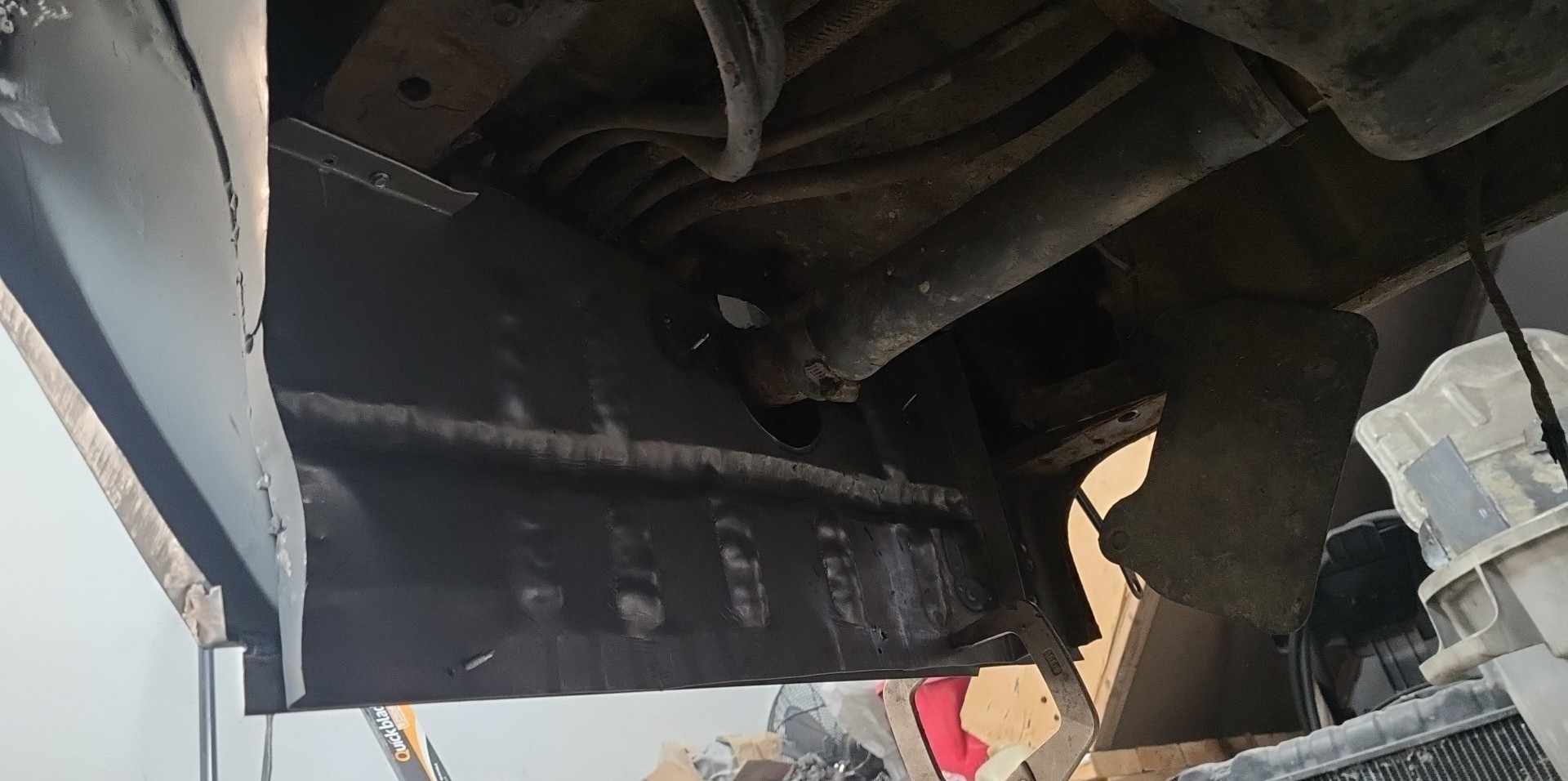

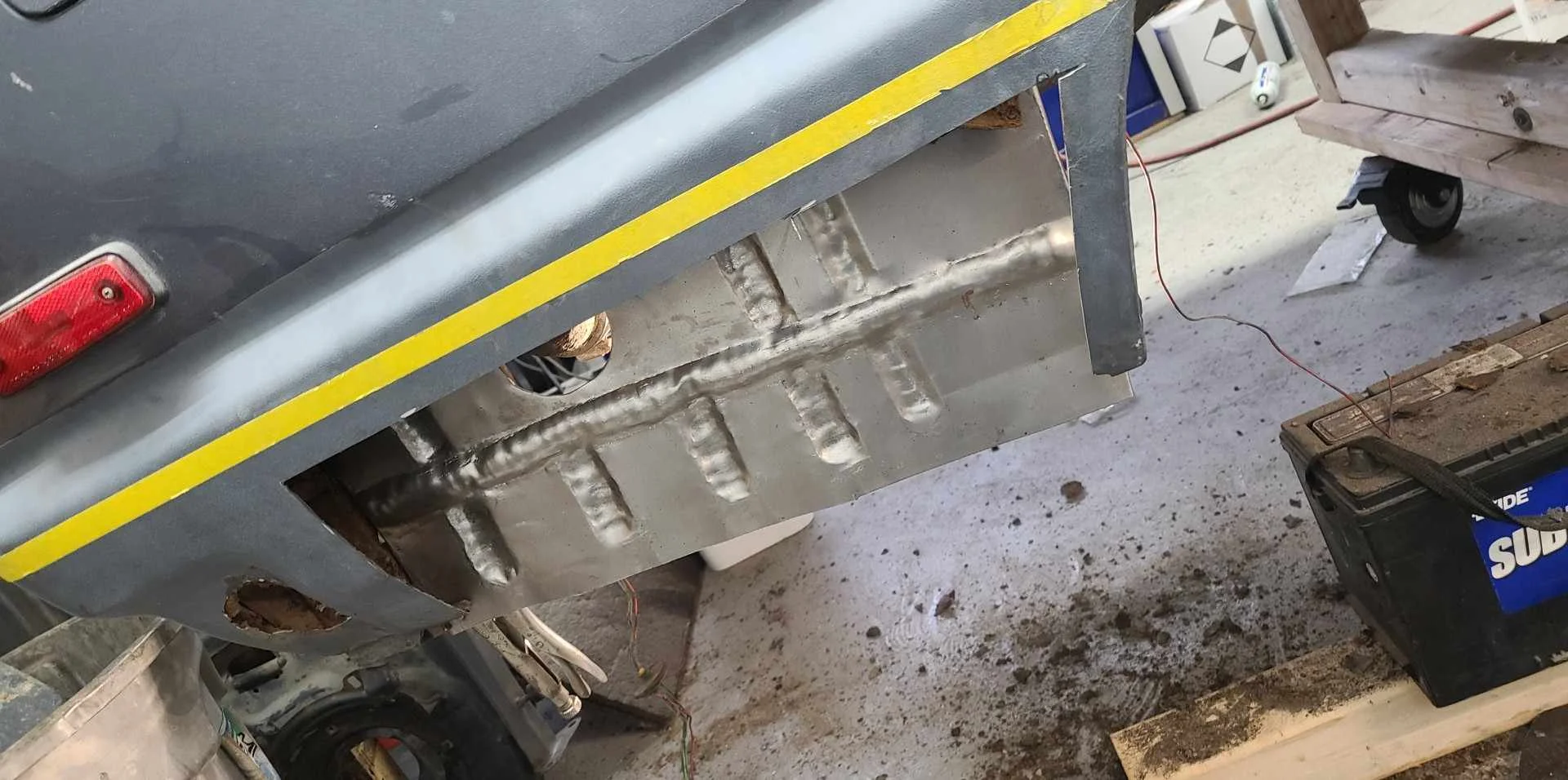

A bit more progress... passenger side rocker done. Maybe gonna be able to finish what's left on this side next week. Then make my way to the driver side fixing the rear 😅

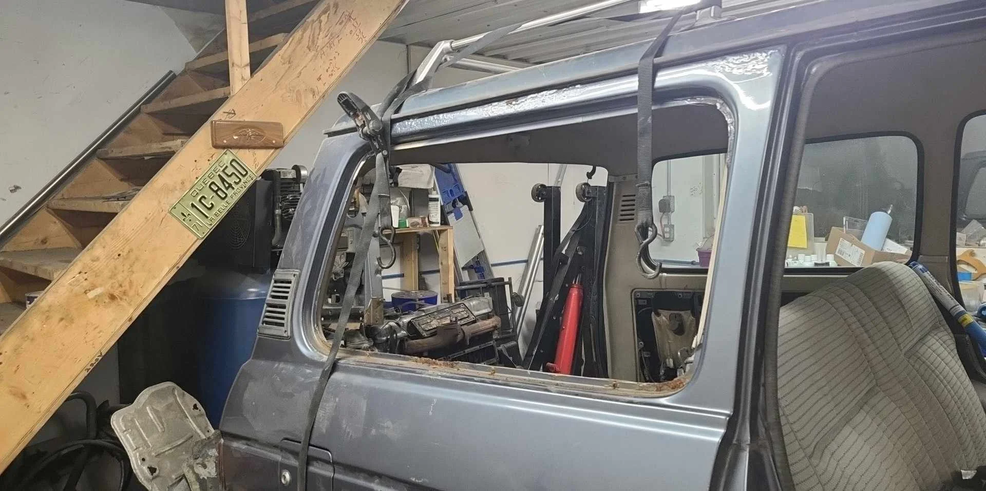

Removed the quarter window , not much to fix there but still....
A bit more hammer game and finally got that lower section closed . Still need cleaning primer and sealer .... Also have to figure what kind of grommet I will put around the filler neck:(
the small hose aside witch seem to be mostly evap ? will probablu be drowned in POR15 and sealer ....

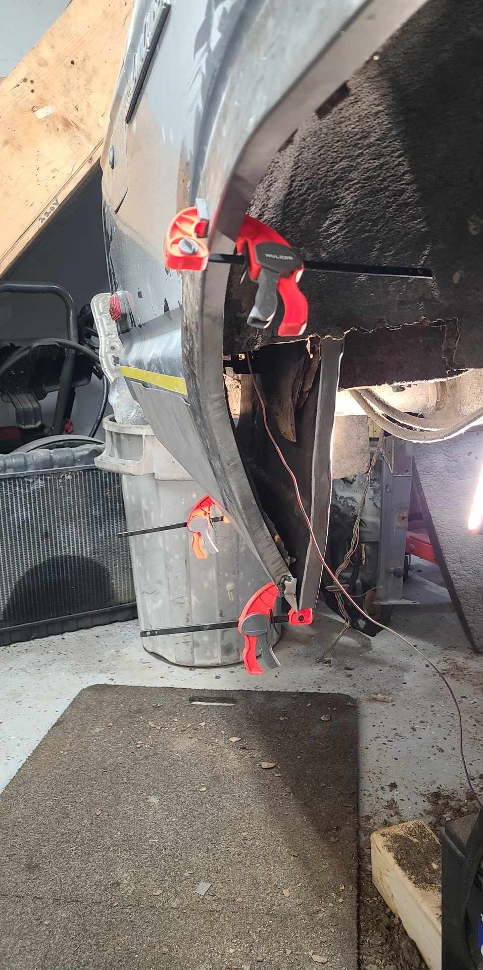

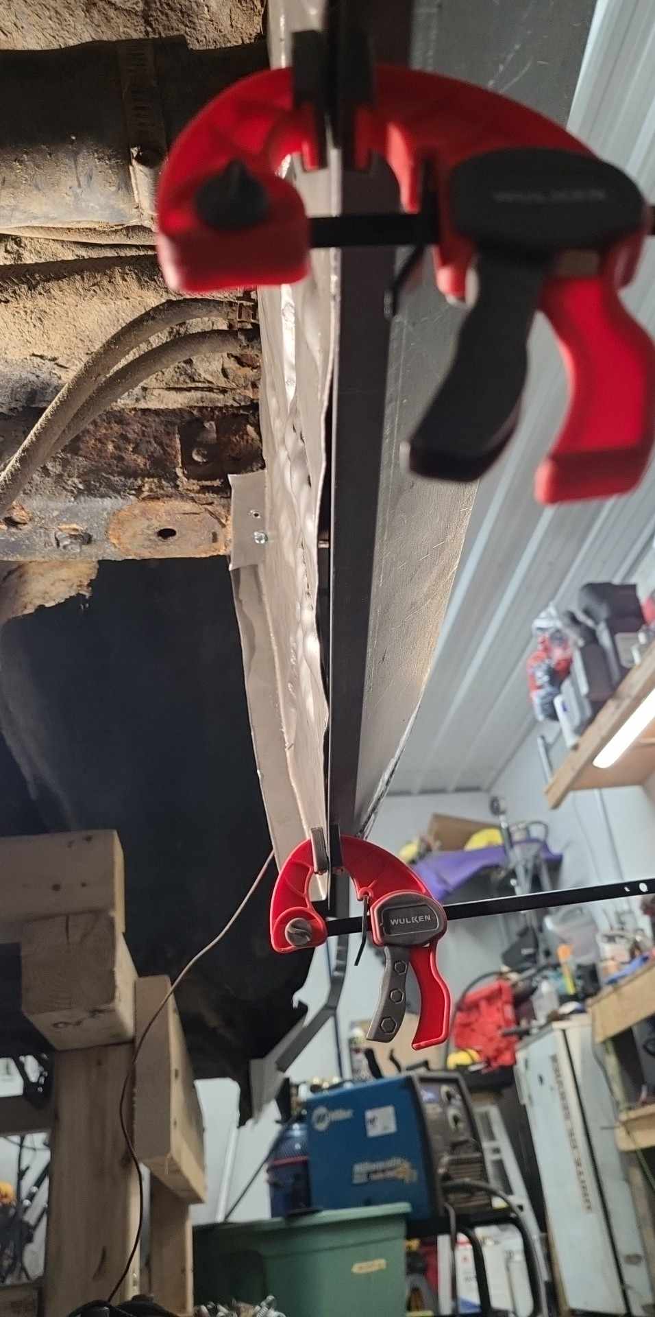

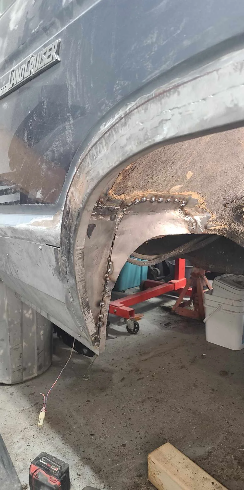

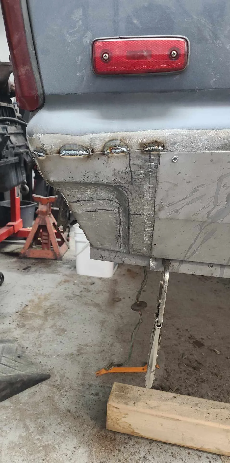

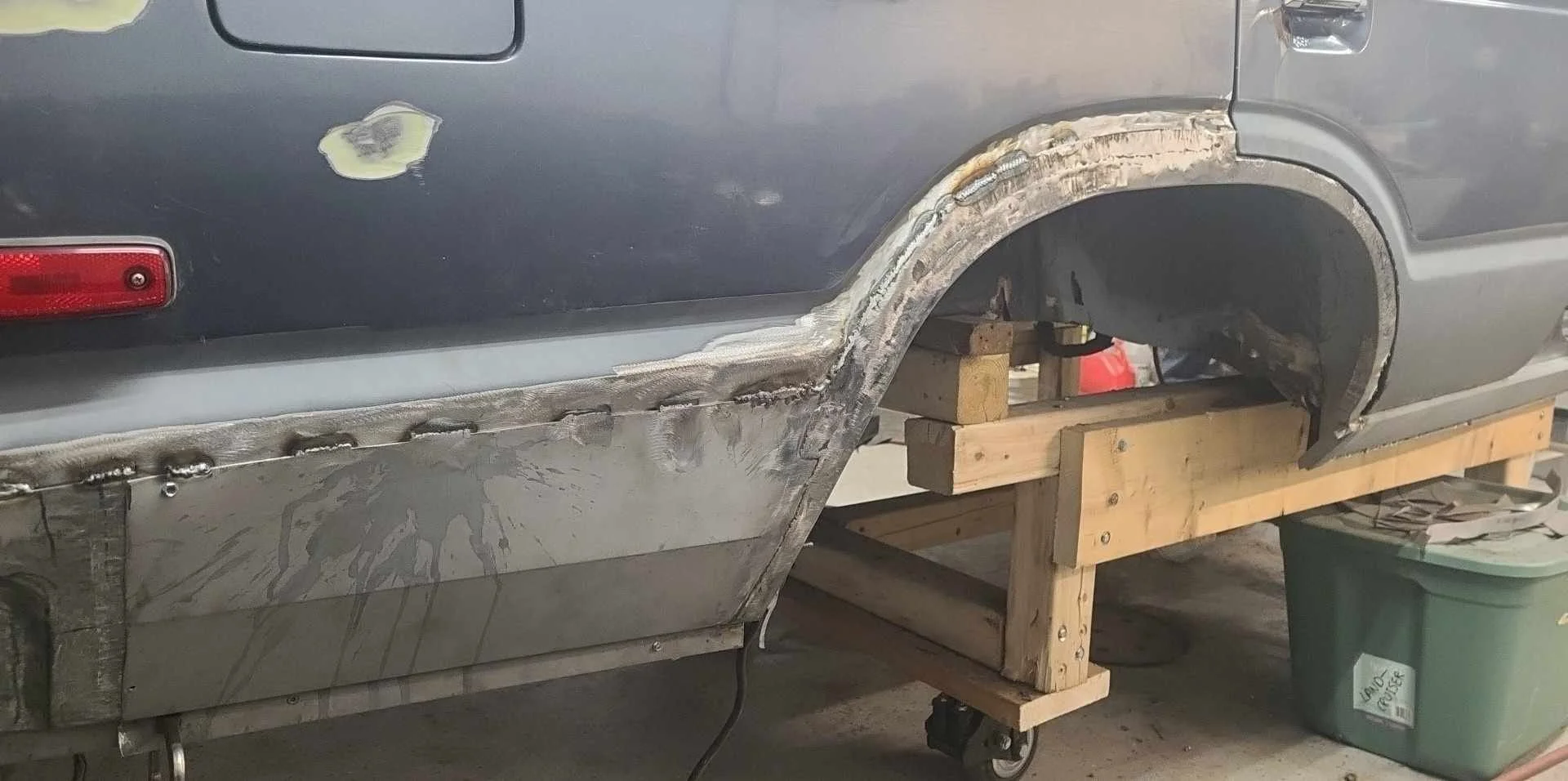

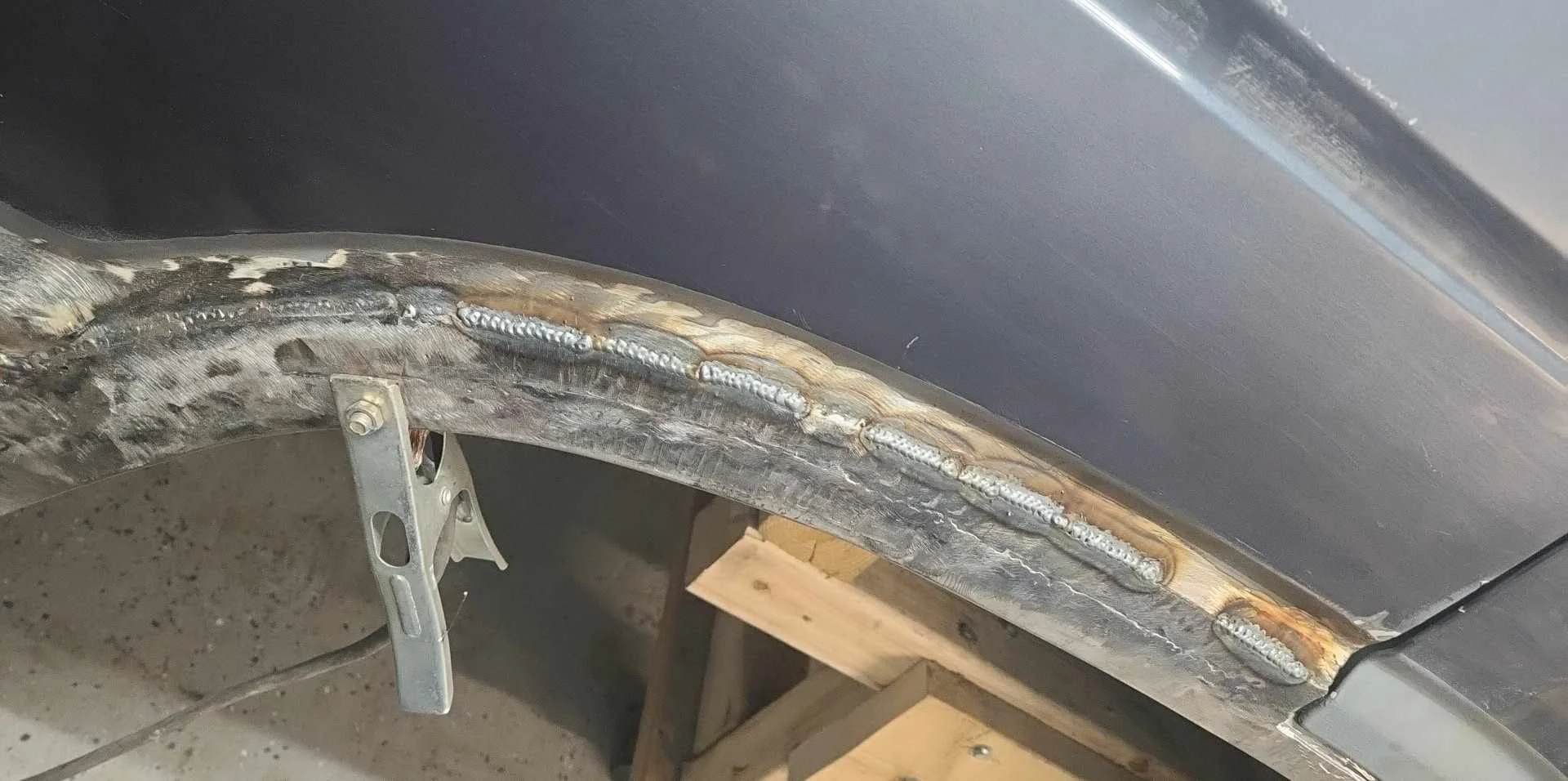

Time for a bit of cleaning tonight , might finish welding the wheel arch making sure the door will fit right too :p
FINALLY welded the wheel arch :) will begin the other side soon , once the side window frame will be repaired.

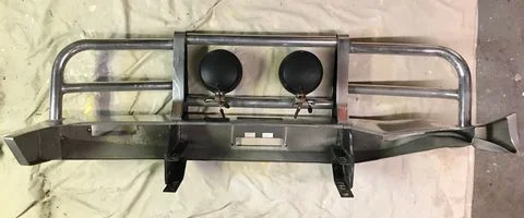

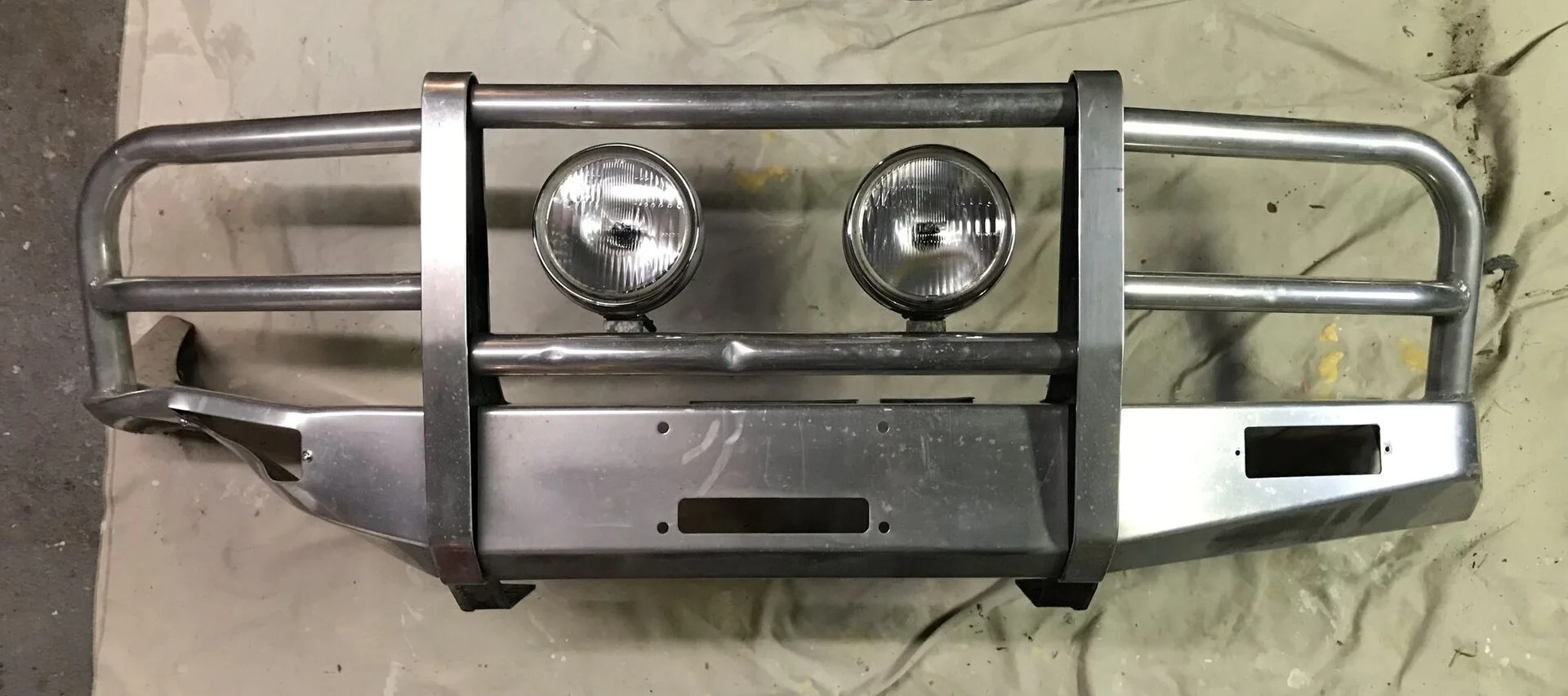

Also found a nice alloy front bumper from a 80 series ... will cut and mod it to have it fitting right it has a bent corner anyway and need work as you can see

Unreal! Right into the metal work. Looking forward to buying a welder to get after some of the rust in mine, albeit not nearly as involved as this!
Kudos.
Ill be keeping an eye on this for welding inspiration.
Thx !! :) Had to remember a lot from my trade school to do that ahah :p Hood went up while runing too on this truck ... fixed that yesterday but didnt picture it .
