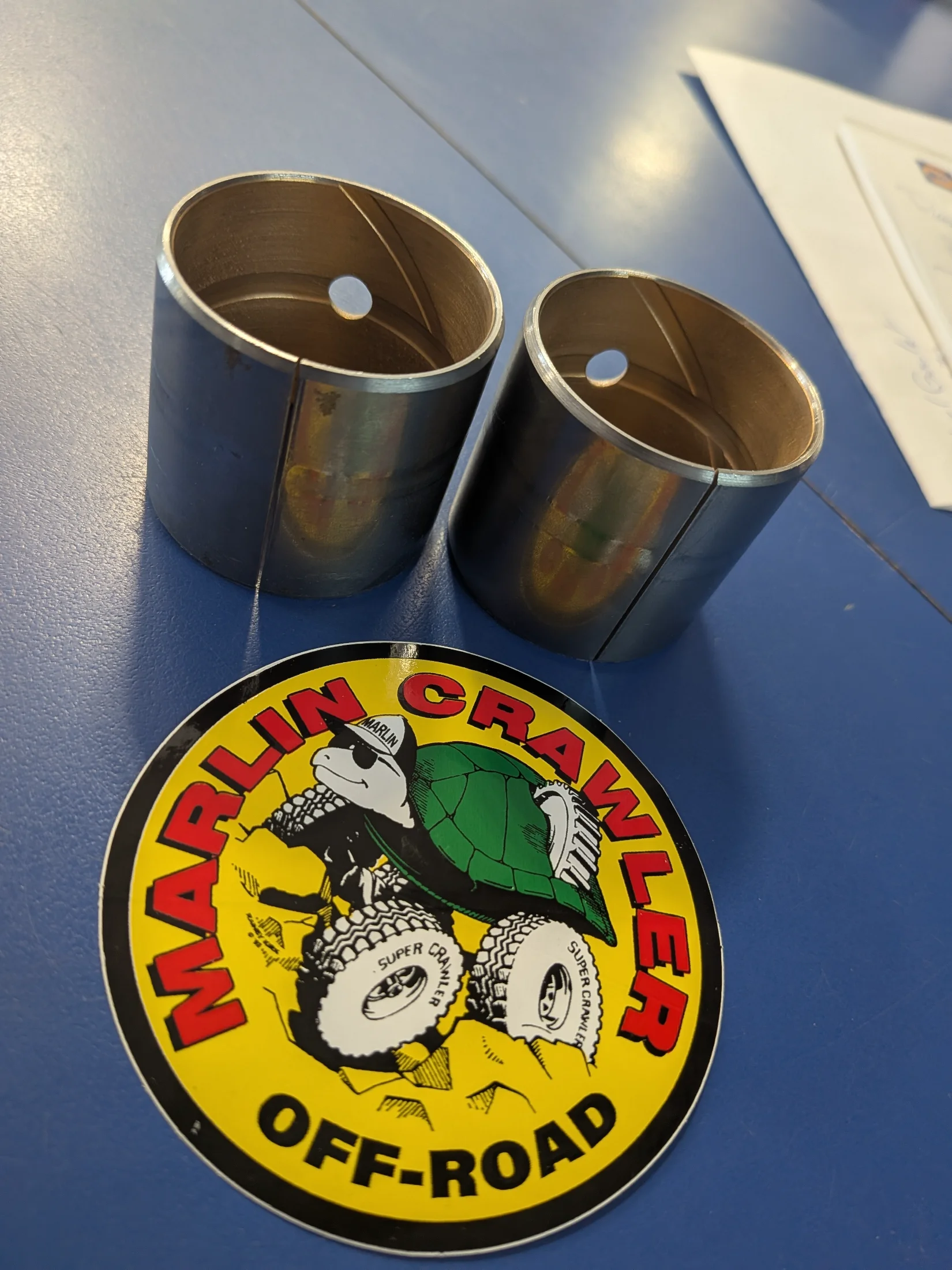

Which gear is that where the bushing is worn out? Guessing an output gear. If it is one of the output gears, my parts lookup tool says they're nla.
Now that's progress! Nice work.
Yeah thats the one , found em on Marlin Crawlers :) . Order placed !

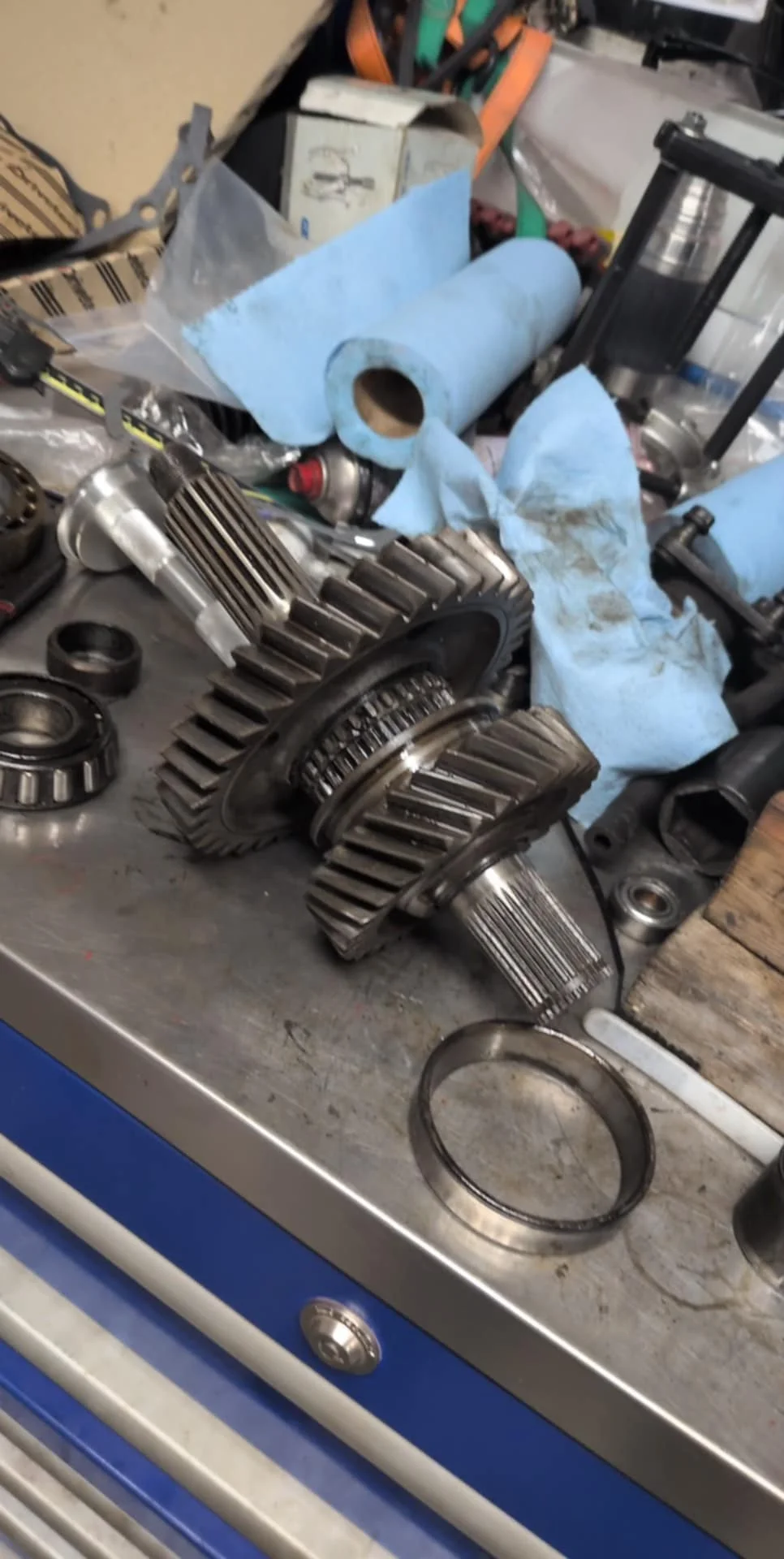

Finally .... Sorry didn't take much pictures....
Polished the shaft where both bushing goes .. the big gear bushings was better but very corroded too changed both anyway.
Closed the t case , after pressing the 2 last bearings on the output shaft and changing the seal of the selector fork. Greased every paper seal too.
The 4wd synchro ring was a bit beaten ...but it still engage and work. Also, since I'm supposed to shift it when the truck is not moving it shouldn't be a problem at all.
For the rest, the gears were not bad , a bit of wear but nothing bad for a 40years old transmission. The worst was the brass bushings 🤷

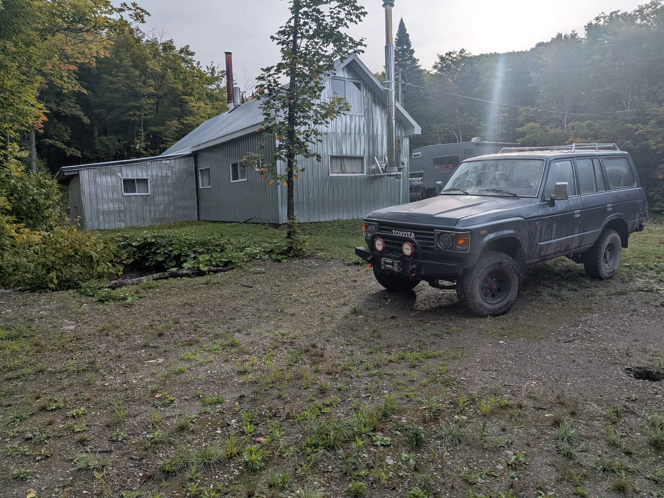

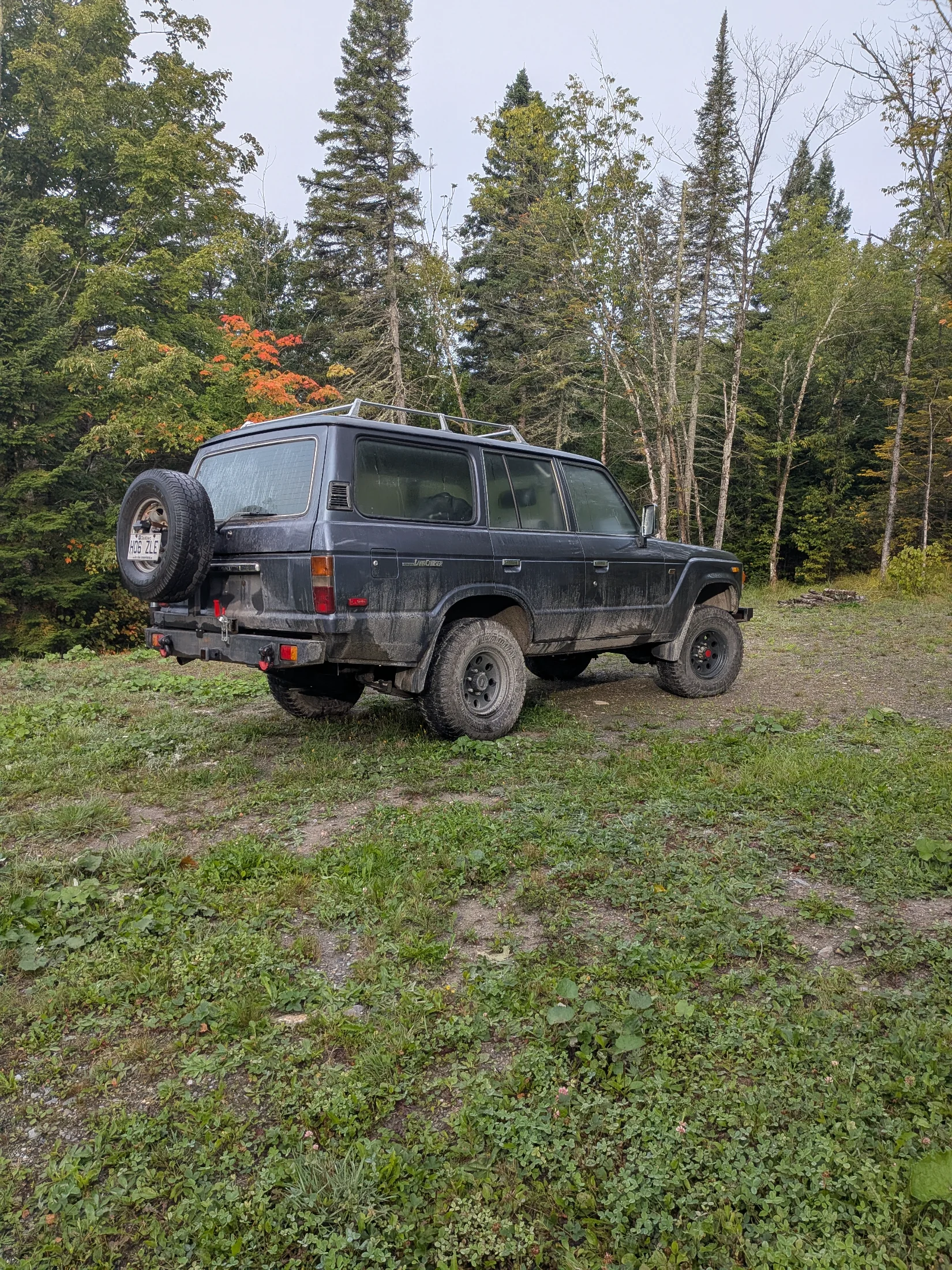

Went camping with the kids at my father's sugar cabin. Went through the whole land with the truck , we used ATV before to do that ahah . Had to clear a tree but it went well!
We had a little fire late at night , was nice.

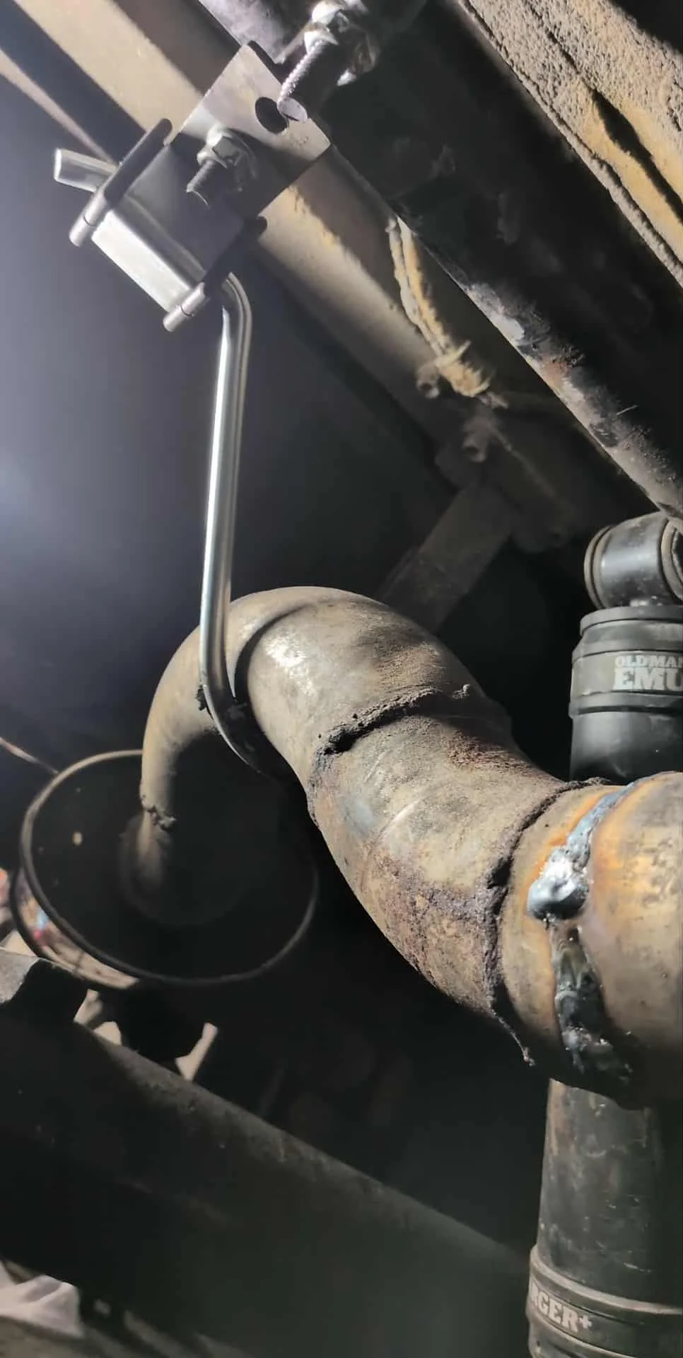

The exhaust drone drove me crazy tho on the return .... Tried to reduce it by adding a braided flex pipe . It's better but there is still something vibrating on throttle ... Engine mount maybe ? Will have to look it up.

Opened the exhaust can and welded the tubes to the baffles to eliminate a rattle and it worked fine. Also replaced the strap exhaust hanger for something better and it also silenced a bit more.

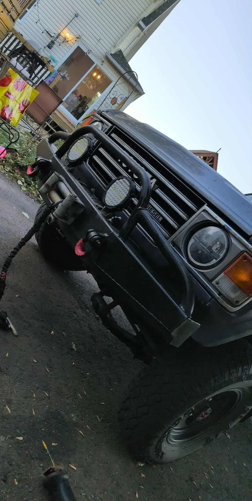

Did the rest of the front bumper in between two chores...
Really happy with the final result. Still have to remove it to sandblast and paint with better products .

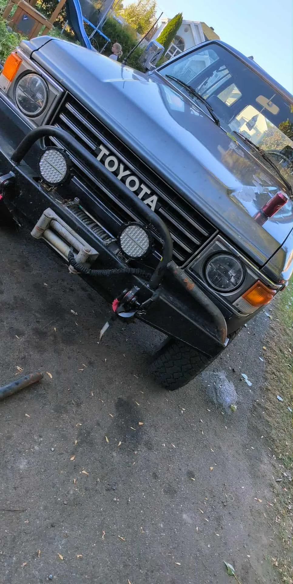

One of the Red fog lights was not working anymore... So I got black replacement . I think they look better too.
