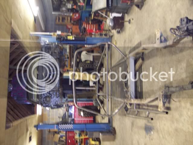

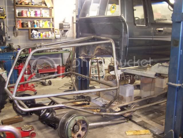

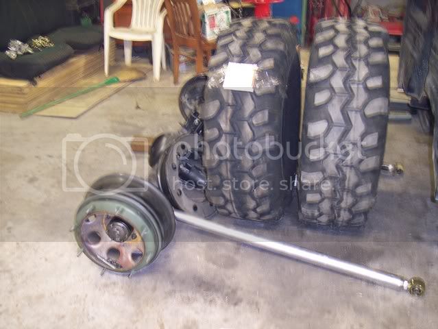

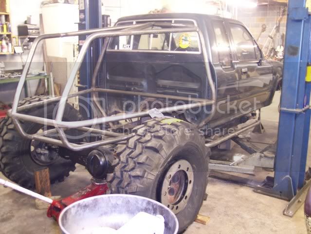

SHE HAS MOVED! I finally got around to moving my truck from the corner onto the lift! I mounted 2 of the tires on wheels and bolted them up to the rear axle and it will roll as long as the front is supported.
Here she sits on the lift now

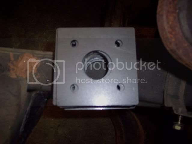

I also assembled a dummy set of cases to mate to my R151F.
I also went ahead and put the new bearing on my MC 23spline input gear

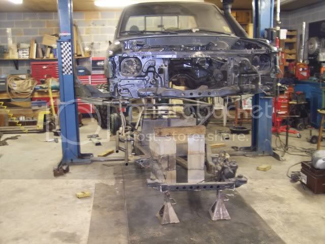

MORE PROGRESS! First I removed the old engine mounts(7MGTE) and ground off the slag from it and the old shock hoops. Next I removed the cab from the frame. I did this b/c it'll make the engine,trans and cases swap go easier. I AM GOING TOMORROW TO GET MY 3.4L!
Once I had the cab and frame seperated I pulled the frame to the front of the shop and set it up on jackstands

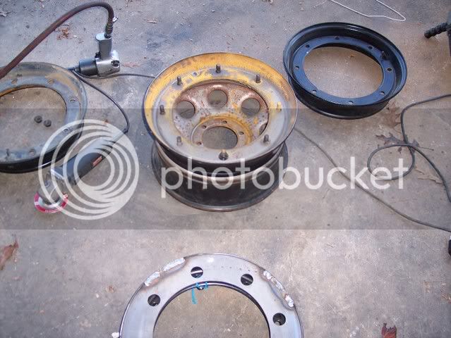

H1's make it so easy to remove a tire from the wheel

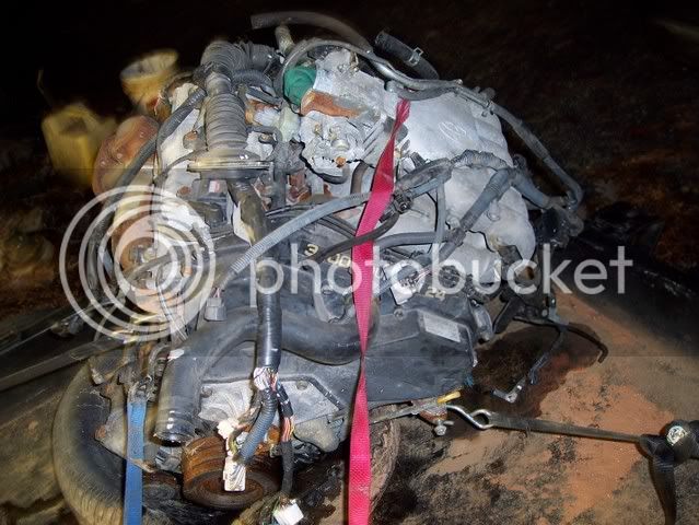

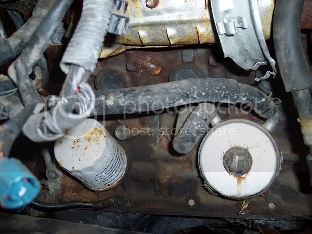

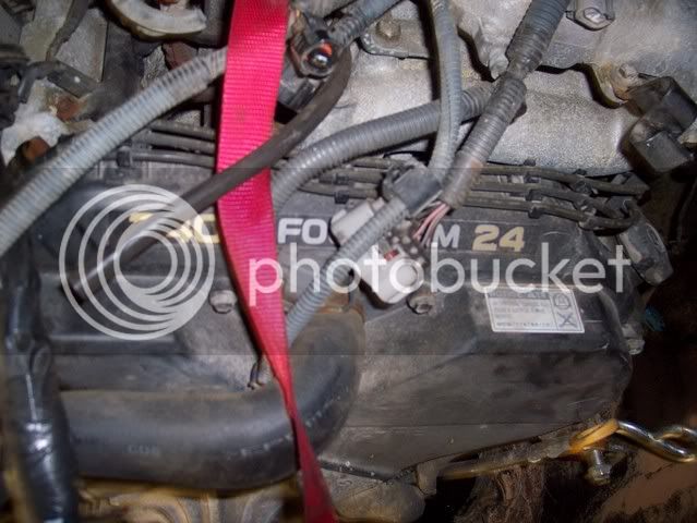

I got an engine today! 68K miles...2000 Model Tacoma V-6 3400. I also picked up a R150F bellhousing so I can mate my R151f to it.

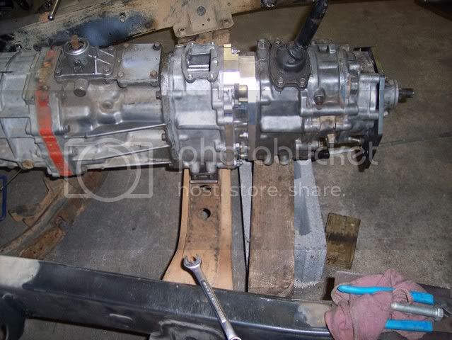

BLING! R151F Attached to dual cases with a clocked adapter!
And here they are in all their glory! 3.4L, R151F, Dual clocked cases. I already found them a home too!
Damn! Thats what i call a drivetrain, that is long as hell! Are your driveshafts gonna be about equal length or what?

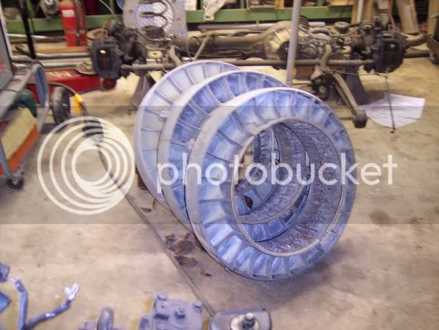

This past weekend I picked up my runflats for my H1's(I forgot them in Charlotte about 4 months ago)
They take up quite a bit of space and I needed to put them somewhere where they take up less of it. So, what better place to put them besides where they go.
Inside the tires

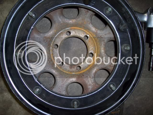

The next daunting task was to grind the slag out of my wheels from where I removed the 8-lug centers. I am gonna get them sandblasted this week so I can assemble the whole wheel and get that out of my way
After
In order to get a nice clean edge it took this
A s***-ton of grinder discs and flap discs
The pile of dust that was left behind

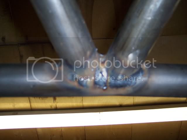

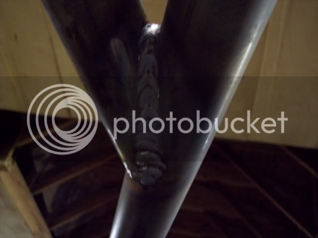

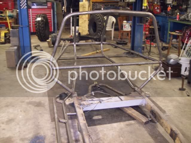

I also got around to do some welding on the bedcage in places I couldn't get to with the cab on
I am going to get some 1 1/4 DOM in a day or two to make some pieces in the bed. I also have to get some 1 1/2 DOM for the cage and another project.
The plates for my interior cage are here so I guess I can start on that soon

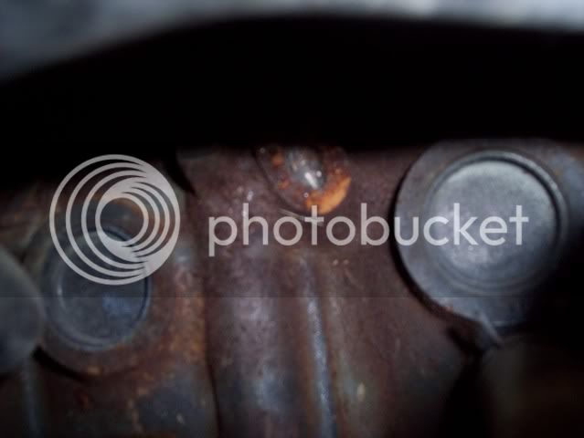

I also started trying to locate where my engine goes in relation to the frame: PITA(pain in the ass)
I've got to fix this ear on my engine...it was busted when I got it and it is where the motor mount goes...I'm going to weld a stud in there
