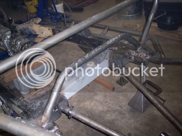

I bent a piece of tube tonight. :) I also took some measurements for a fuel cell. I wonder how much that is gonna cost me.
Just a little crossbar...I still need to cut the piece of BIG stuff out and add a x-member in there
I'm going to tie it in to the piece above it with some smaller diameter tubing.
I'm going to mount the gas tank here above the upper link...(It'll be bumpstopped and guarded from the link)

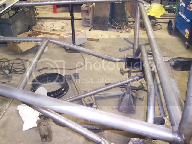

I built a "mocked fuel cell" tonight. I also took dimensions on my cage.
