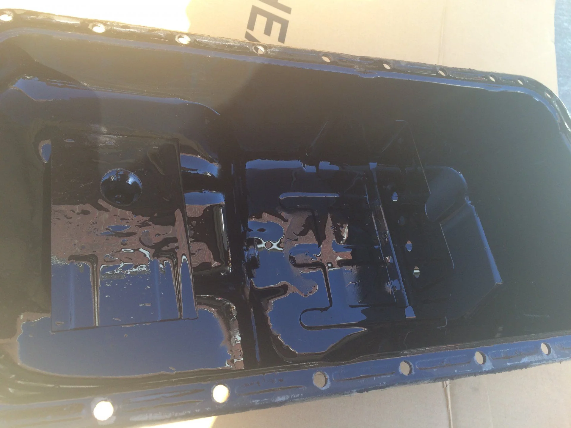

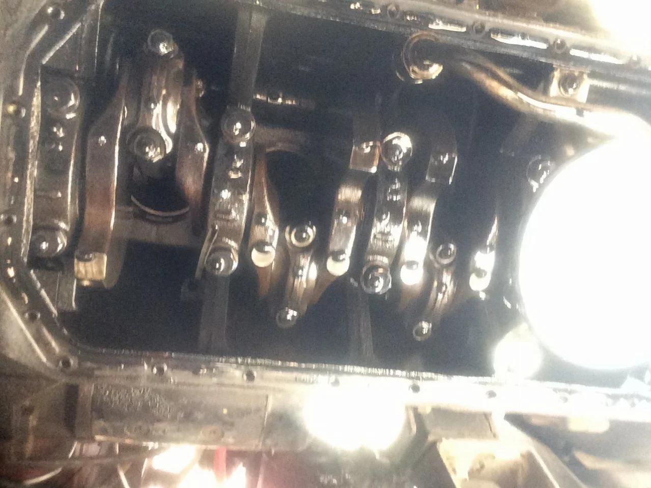

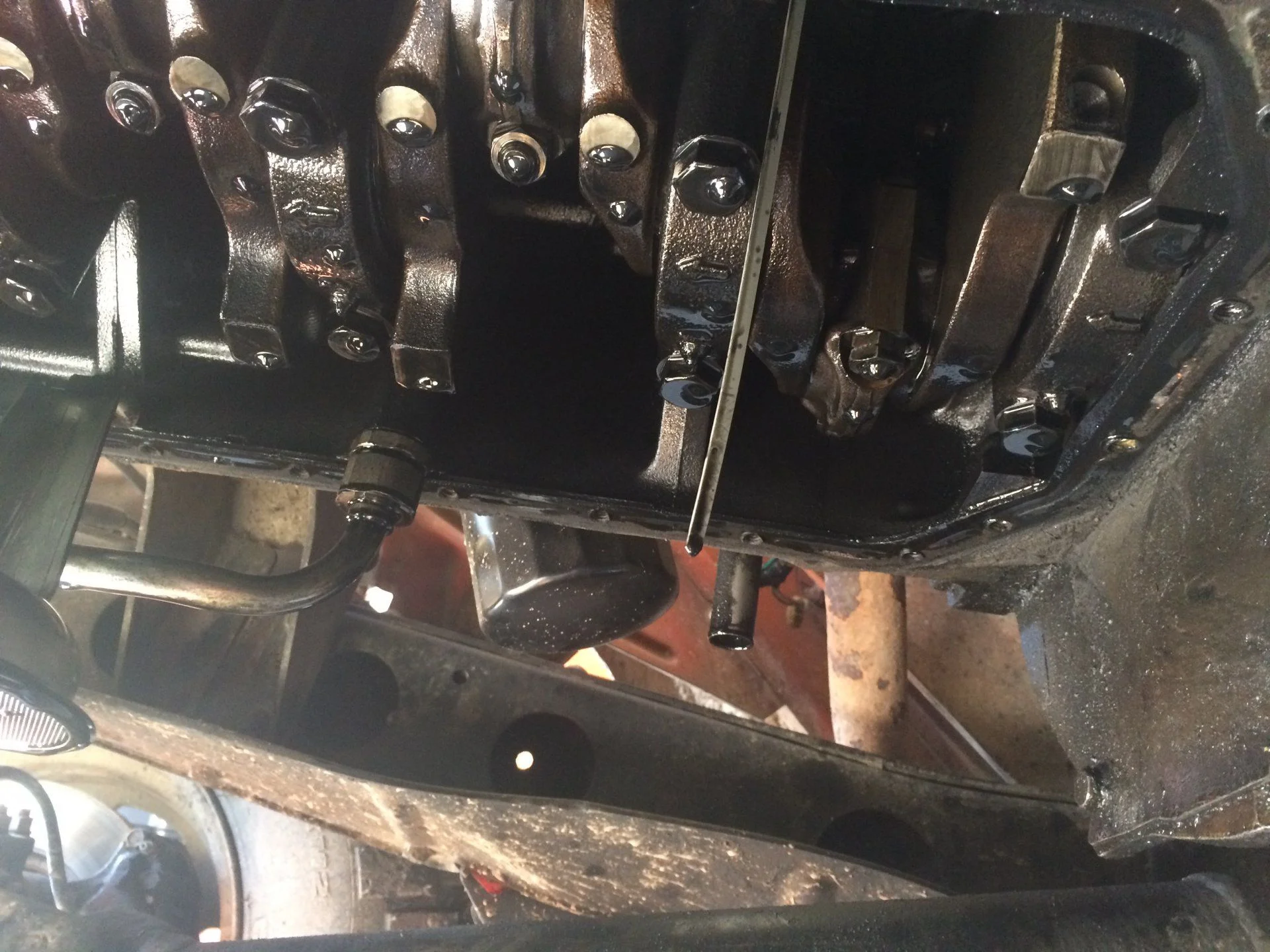

Well... I'm a idiot. The hole in the oil pan was a result of my modified oil dip stick. The hole is right where it hits the pan. Everything else looked good. I should have done a better job of rounding the edges. I'm guessing when I checked the oil before leaving roundup I stabbed it in and that was the end of that.
No foreign objects in the pan so that was good.
You can see where the dip stick measures the level in the cone shaped hole. That's where the pin hole is.
Nothing looked odd with my amateur inspection of the bottom end. You can also see the pointy s***ty dip stick I made.
Pan fixed. I brought it work to have it tig welded. I'm doing an overnight leak test with some old oil before I install it.

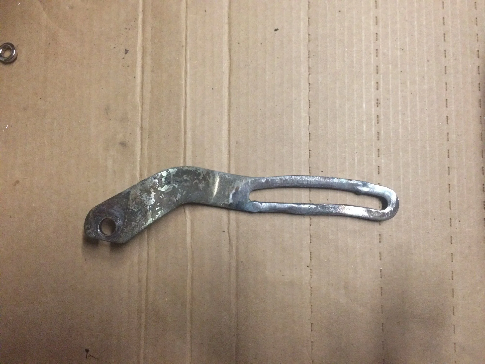

I also had to weld up the alternator tension bracket. I believe it has been rewelded at least four times. Round up did a number on it.

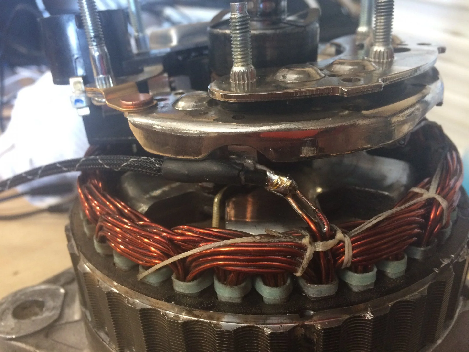

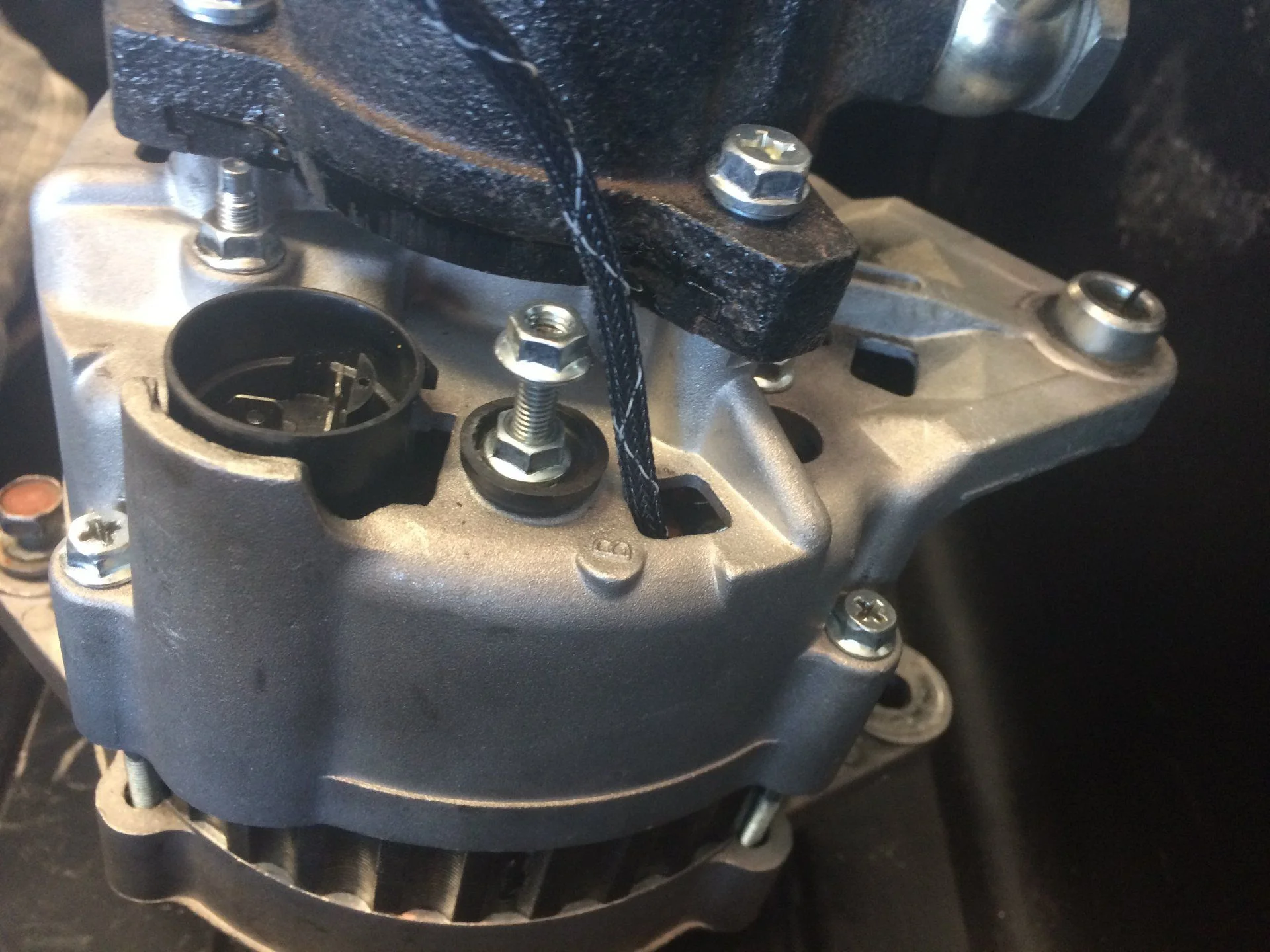

It was also a good time to add a "W" wire to my NPR alternator to run my DD tach while the truck is down.

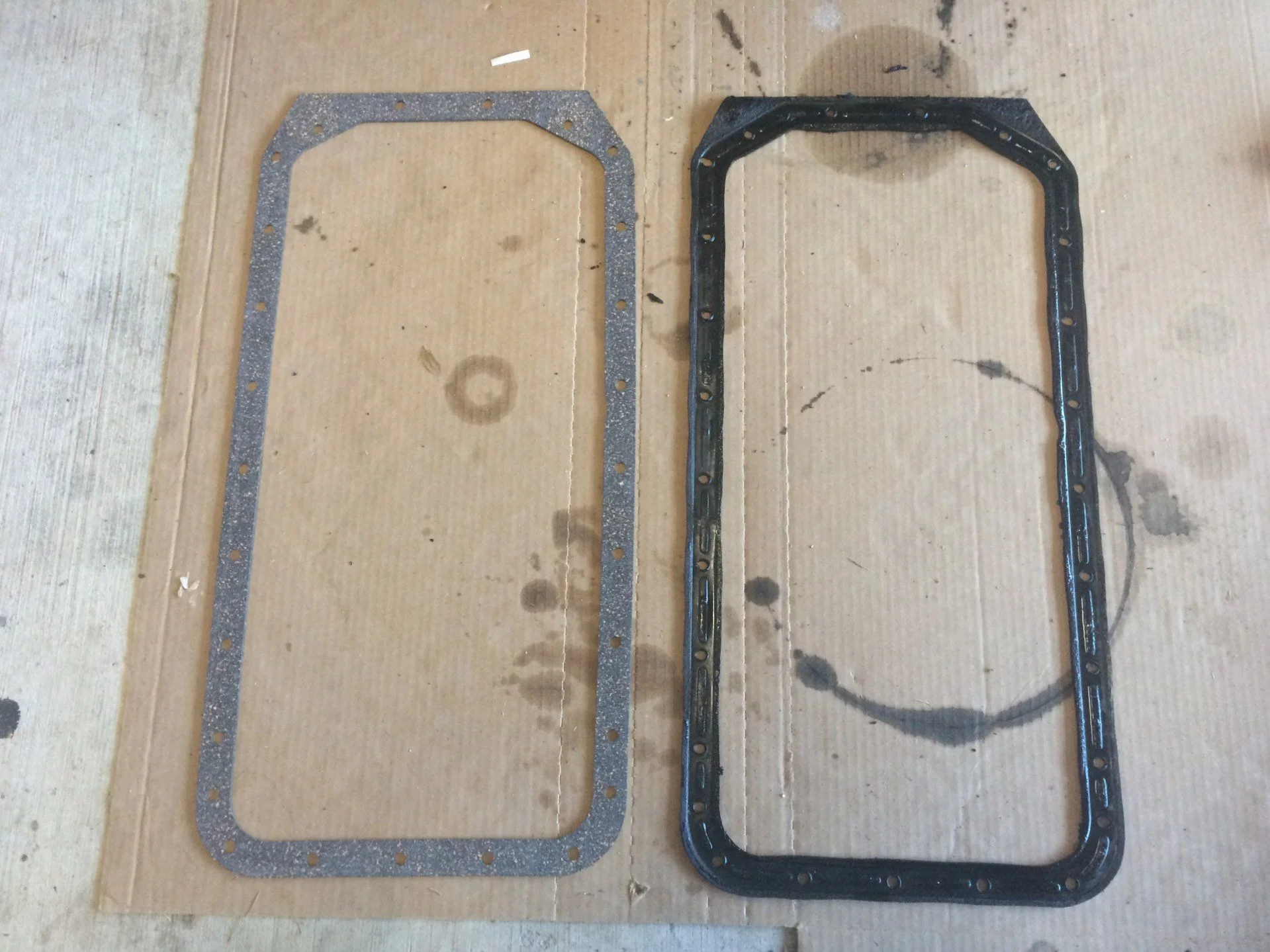

The oil pan gasket I pulled off was in great shape. It was oil soaked but I had no leaks. However I used a new OEM one from my engine gasket kit to put the pan back on.

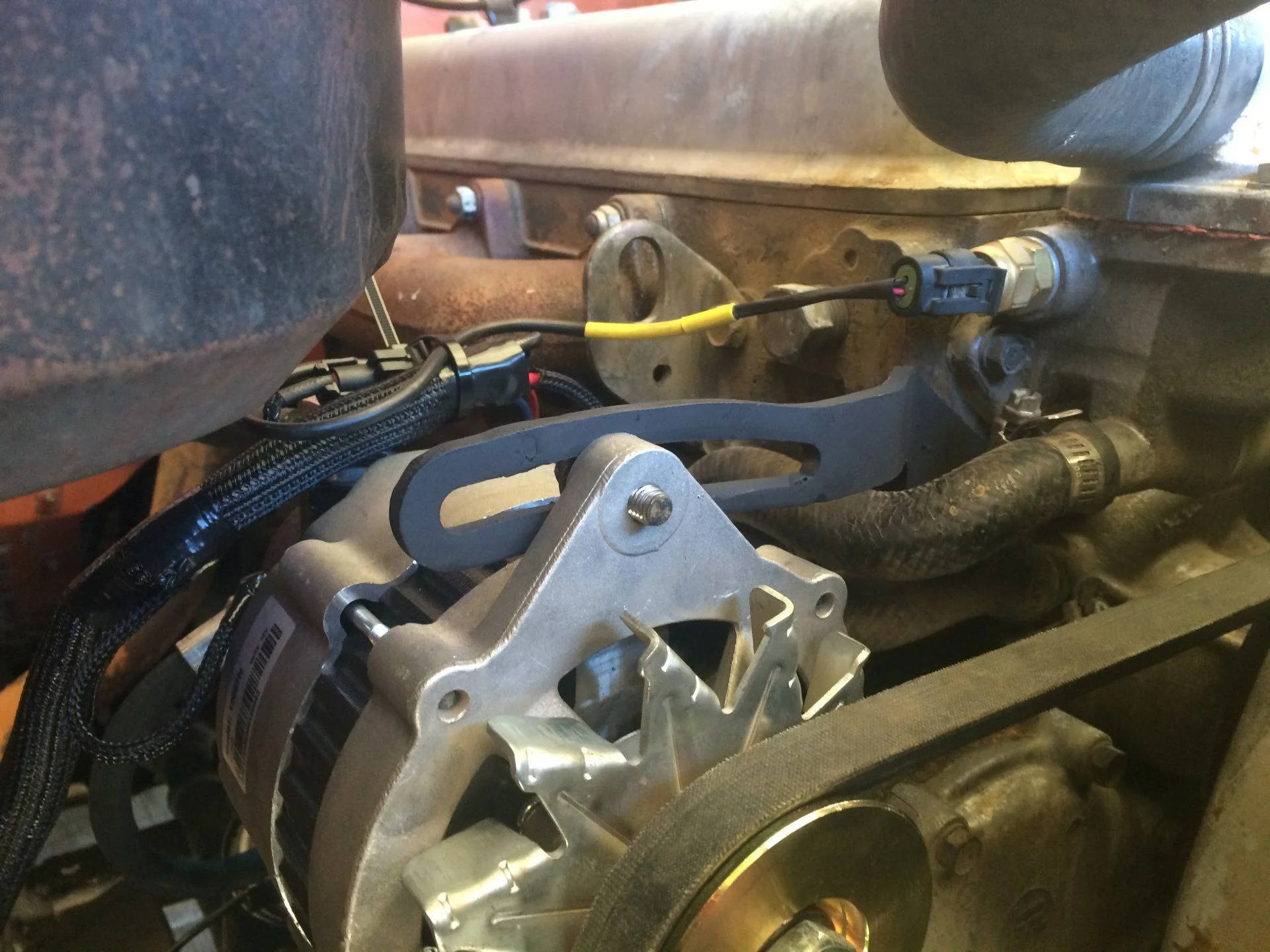

Alternator back in but I still need to setup tach. All the wiring is done. I used some different wire loom stuff I noticed on @davegonz truck that I really liked. It's much better than the plastic crap. I will start using it now on all electrical modifications in the future.
The tach is now functional. Installed the Dakota Digital DSL-1E diesel tach interface which uses either alternator, which I am using, or a flywheel pickup. You do not have to have the DD gauge cluster to use the DSL-1E. I am using the older version on my 80 to send signal to my OEM cluster. It was real easy to calibrate using the Tiny Tach. On my 80 I had to use math skills to figure it out which involved tranny and diff gears and a set speed as I didn't have the Tiny Tach to use.

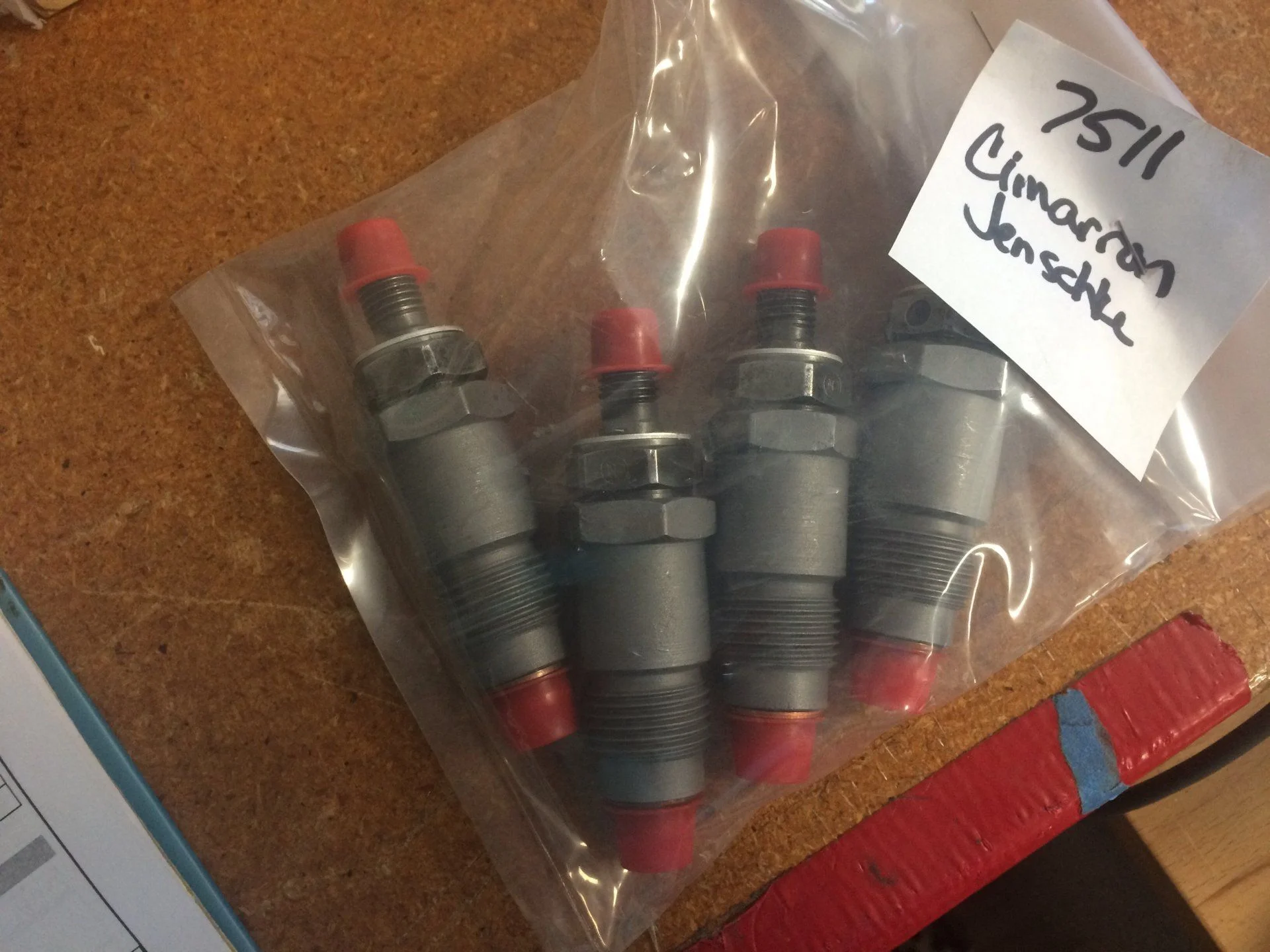

A few things came up while installing injectors. Honestly I didn't do much research on the topic prior to pulling the old to replace with the rebuild ones. Once I pulled the old I relized that the supplied washers were not the same thickness as what came out. Also new nozzle seats were listed in the FSM. Only two of the injectors that came out had seats so that tells me they had been out for some reason before. I went to dig out my engine gasket kit and found some seats but only found three of the four. My home office is a disaster as the moment so finding the one that fell out of the bag at some point in he past year is impossible. I ended up reusing one nozzle seat and all four copper/brass washers.

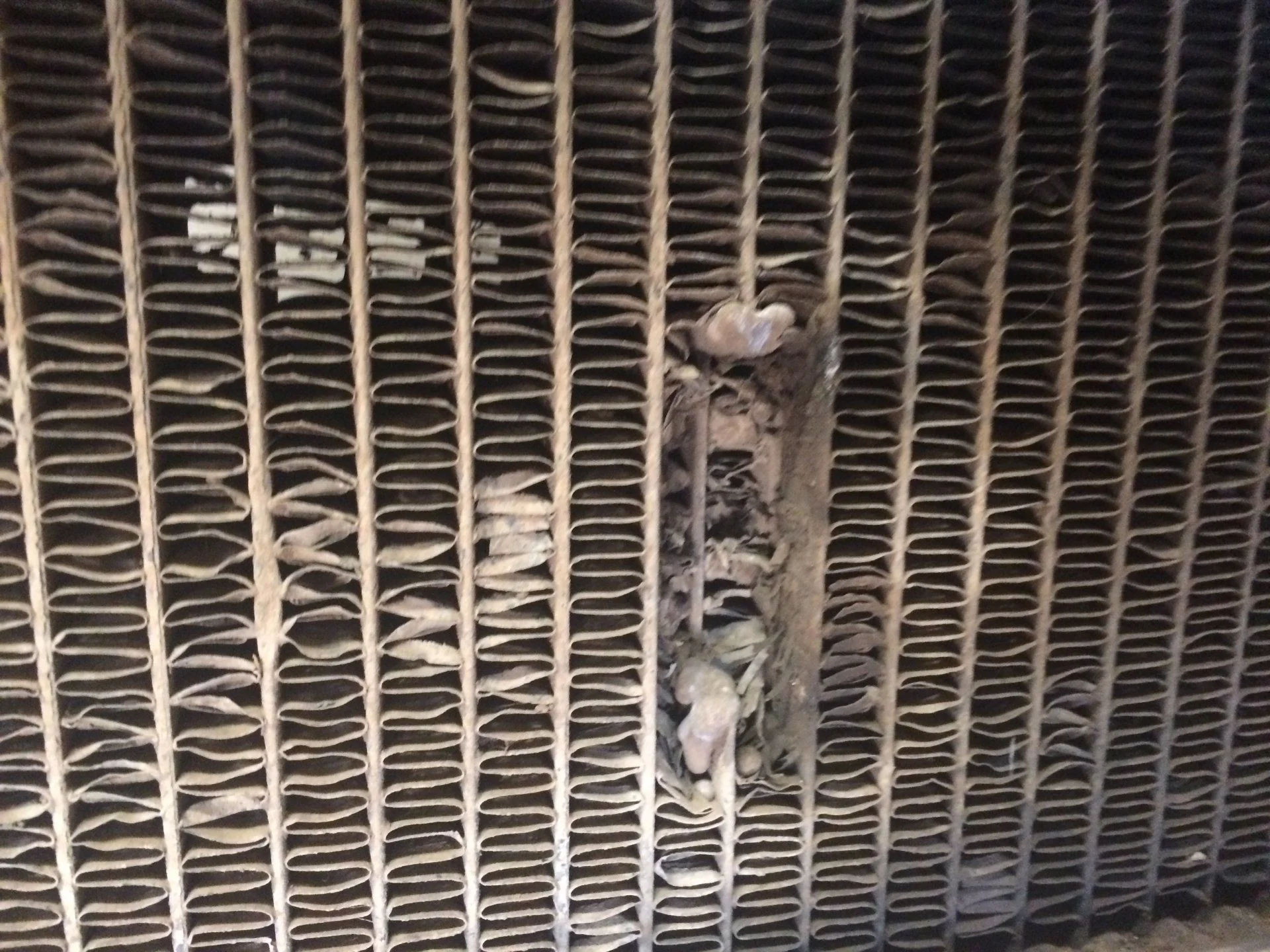

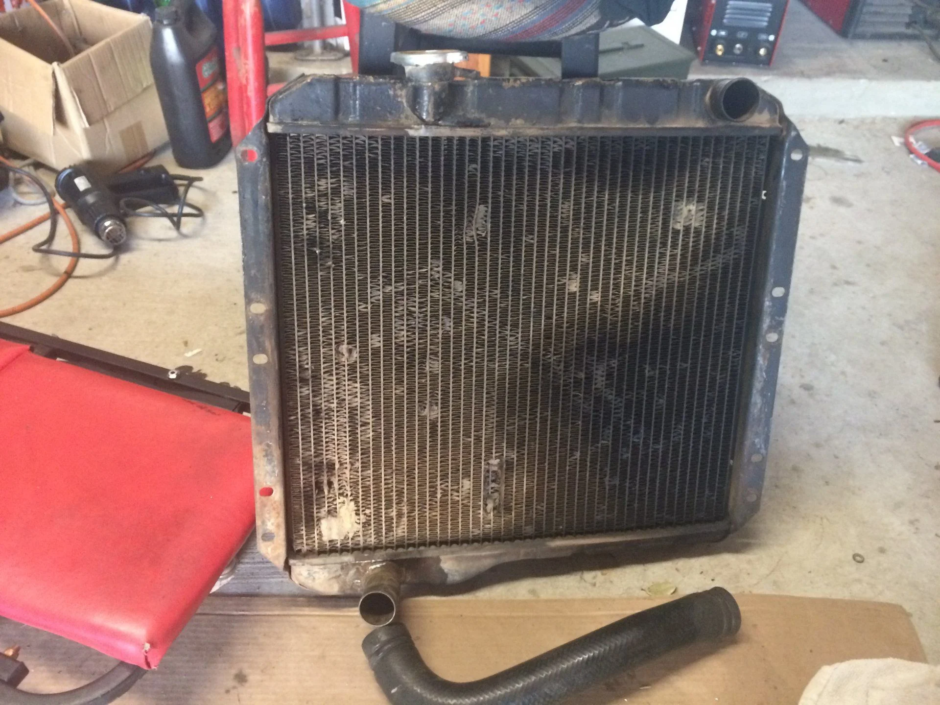

I didn't purge and try to start yet because I need install radiator. I had it out to get a small leak fixed. I also bought an all aluminum aftermarket radiator, arriving Monday, in case the original springs another leak. Still debating which one to reinstall. It's to the point of I really don't know how the original holds coolant but it does its job of cooling. It's got all kinds of Costa Rican patch jobs all over it. Anyway I think I need to find new washers and another nozzle seat or it's going to bug the hell out of me.

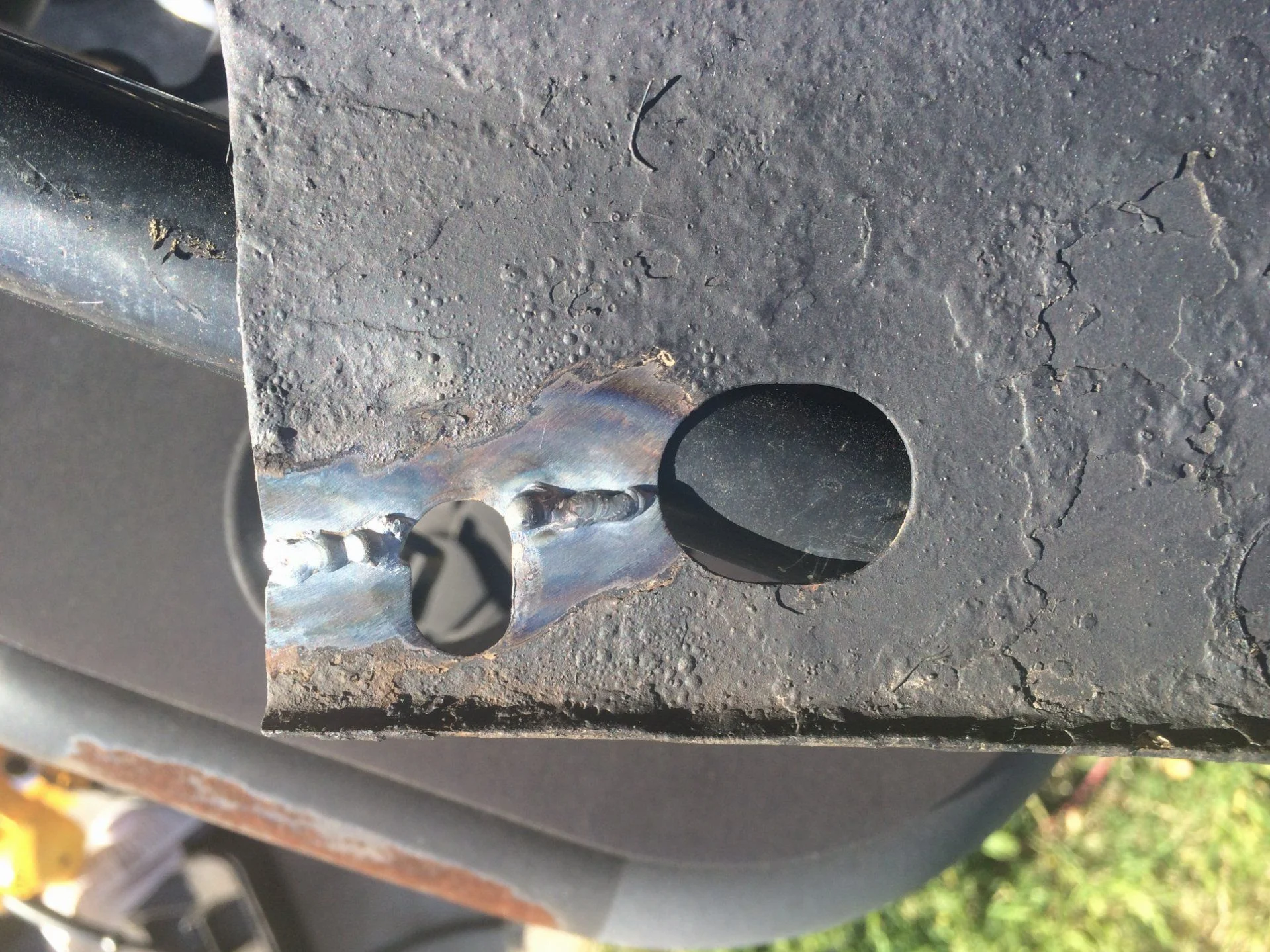

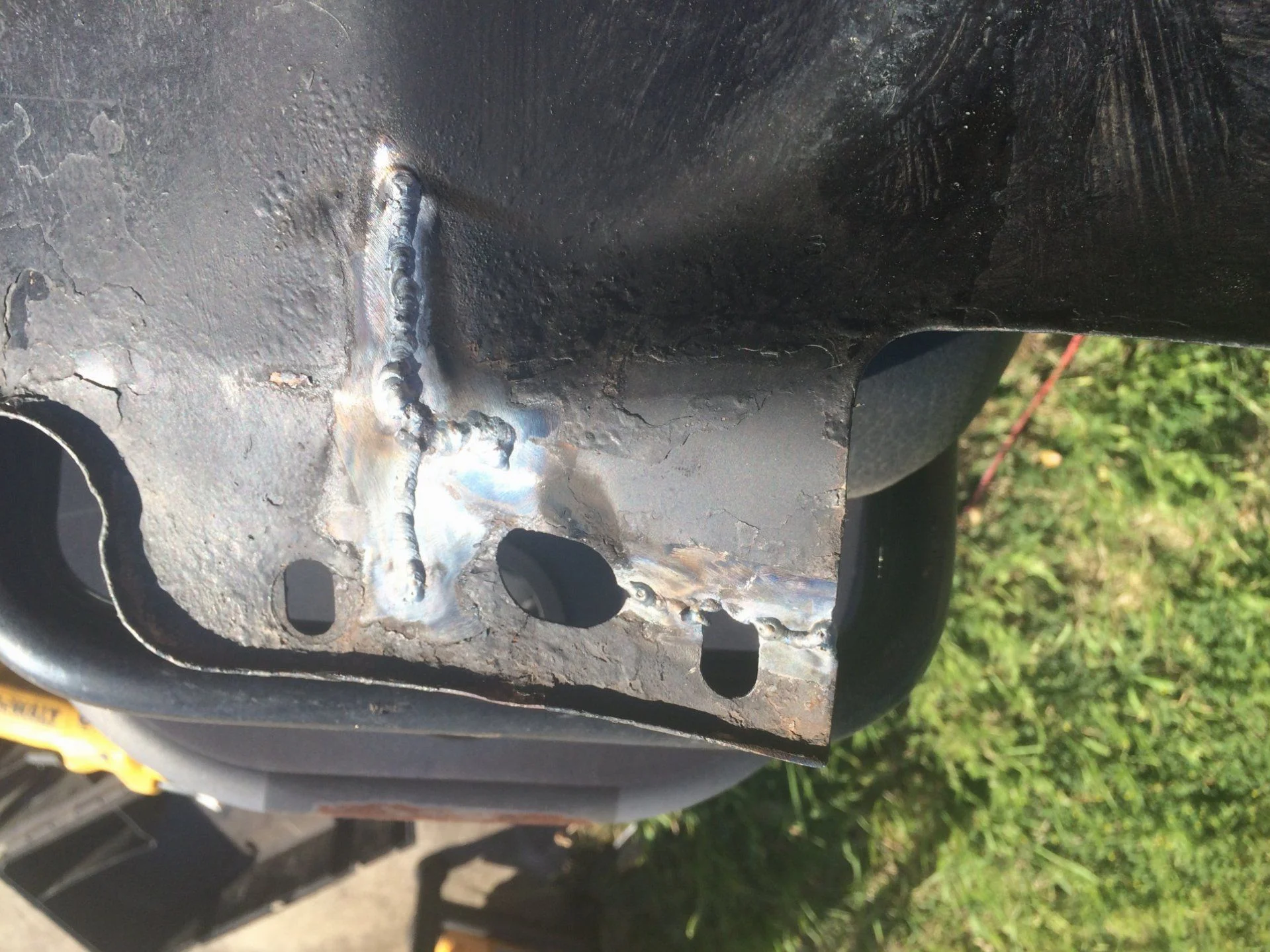

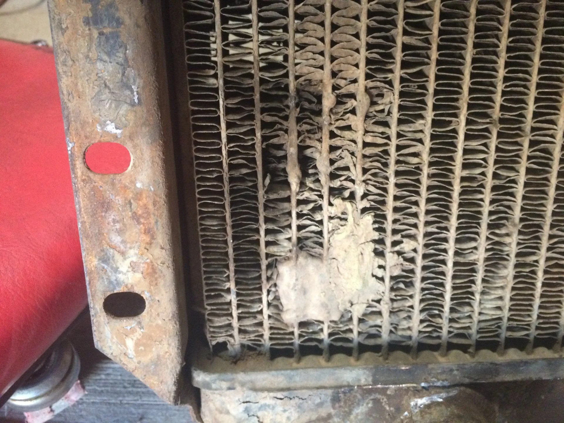

Since I had the radiator out and pulled the bottom plate I noticed some cracks in it. I had my fellow co worker weld up them up. I love that he leaves his TIG welder as work.
The photos are pre sanding and paint. I didn't get a photo of where I sanded it before painting but has some pitting on the front section but should hold up well for years to come. Once I got has much of the rust dust off I sprayed with rust reformer. I don't know if the stuff works but it got the propane guys off my back when I used it to get rid of a rust spot on my propane tank for the house.
Radiator prior to going to shop. Surprisingly the only leak the shop found was from the drain which was soldered shut.

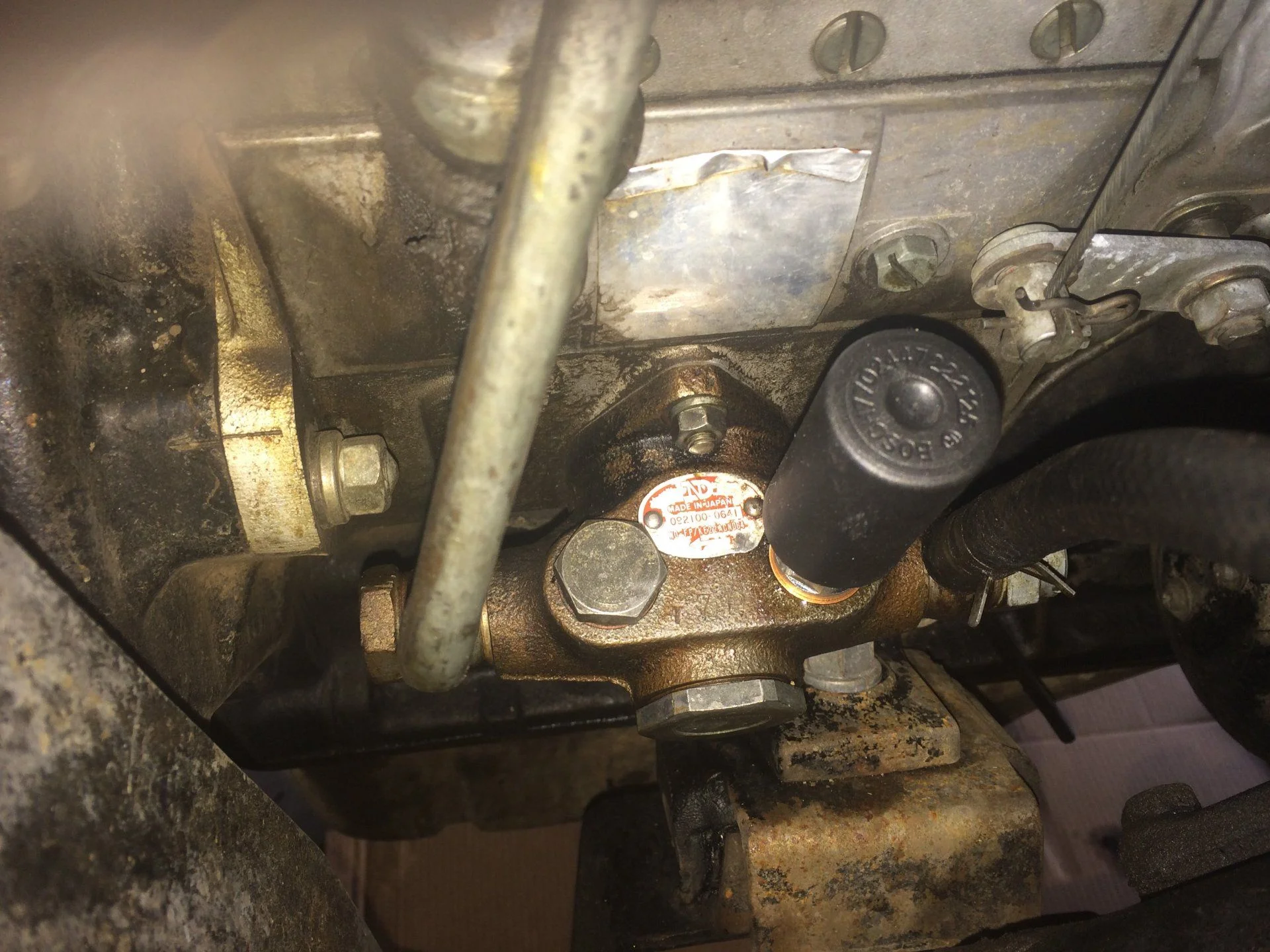

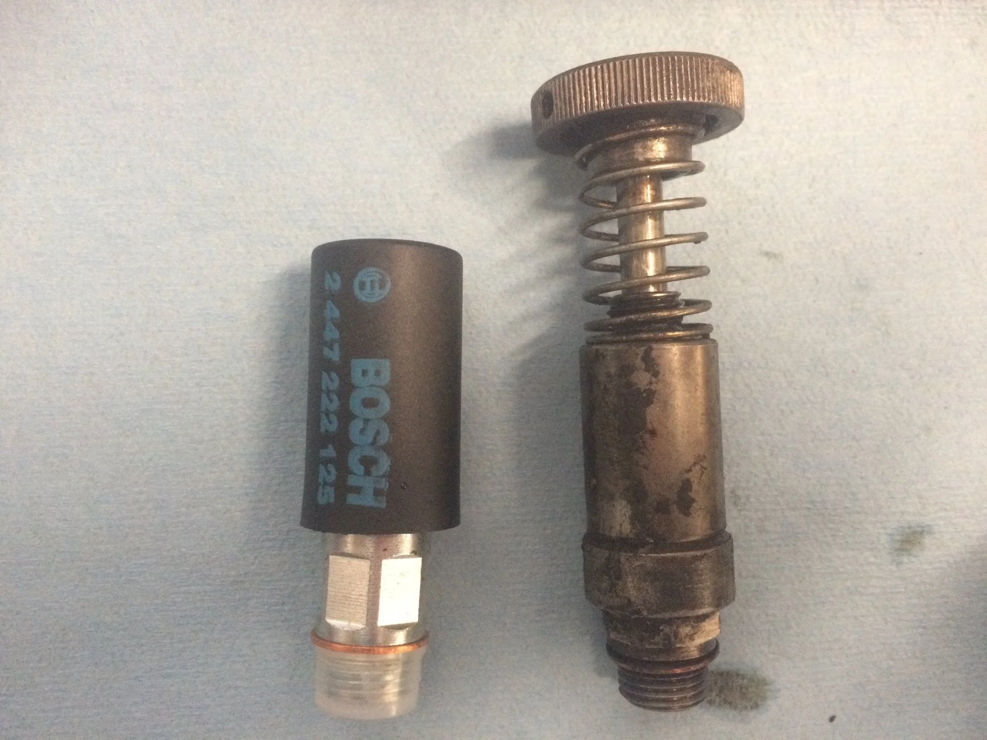

-I now have a bunk primer plunger. I attempted to prime it before starting and it got stuck out after unscrewing it. In order to screw it back down I had to remove it from the pump using a cut down 19mm wrench. Need to find the Bosch replacement now. It leaked anyway.

Took the 40 to work today. No leaks at the injectors but the stupid primer pump is still leaking. Ordered a new Bosch unit off Amazon for $18. The Cummins in my 80 had the same problem which I replaced the lift pump/primer this evening. Not as cheap. Since the Cummins is a "B" engine as well I have started to call it "Big B" and the BJ is "Lil' B" as people I talk with are alway asking which one I am taking about.
You have a link to the primer pump you bought for it?
I swapped primer pumps this weekend. The Bosch unit came with a 244722125 part number on it but threaded right in. No more leaking while priming.
