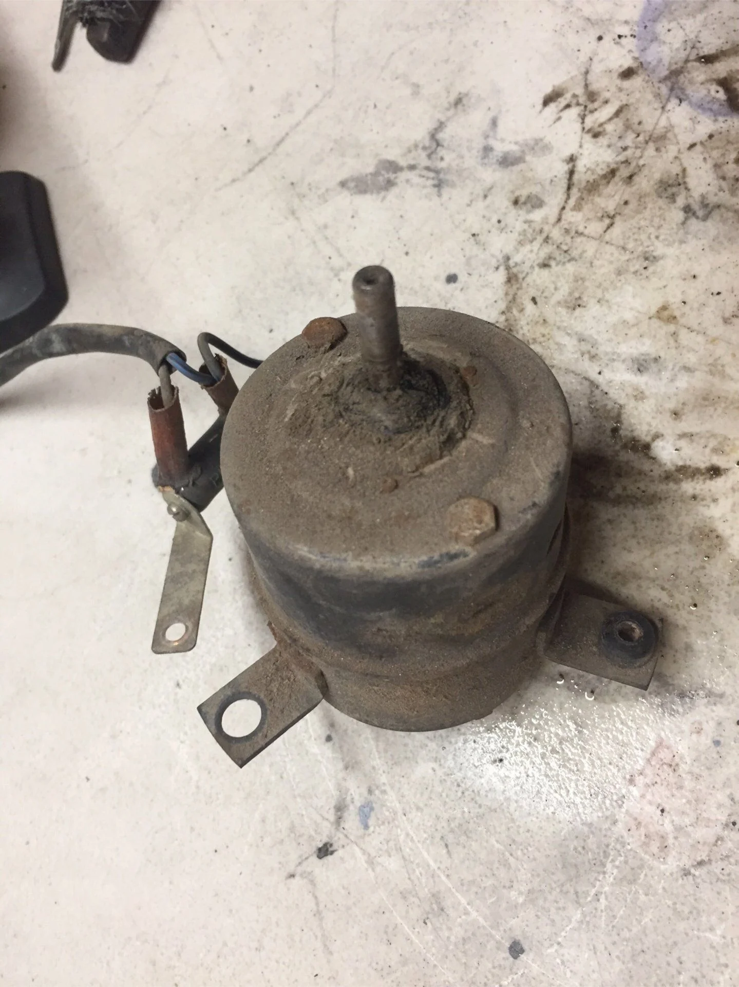

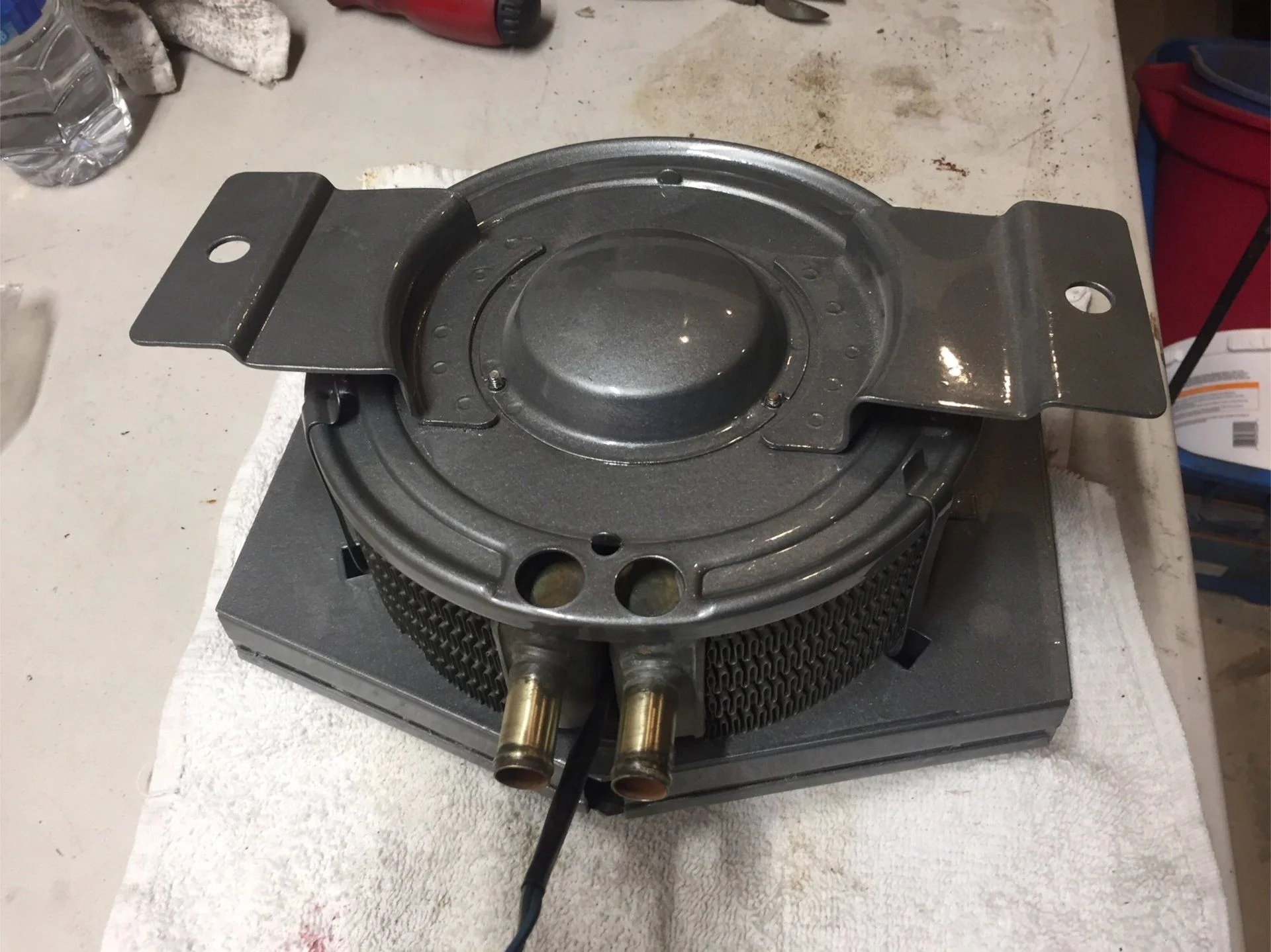

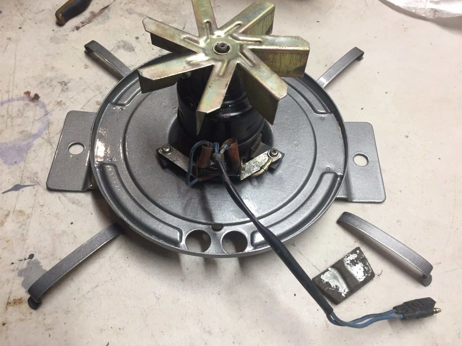

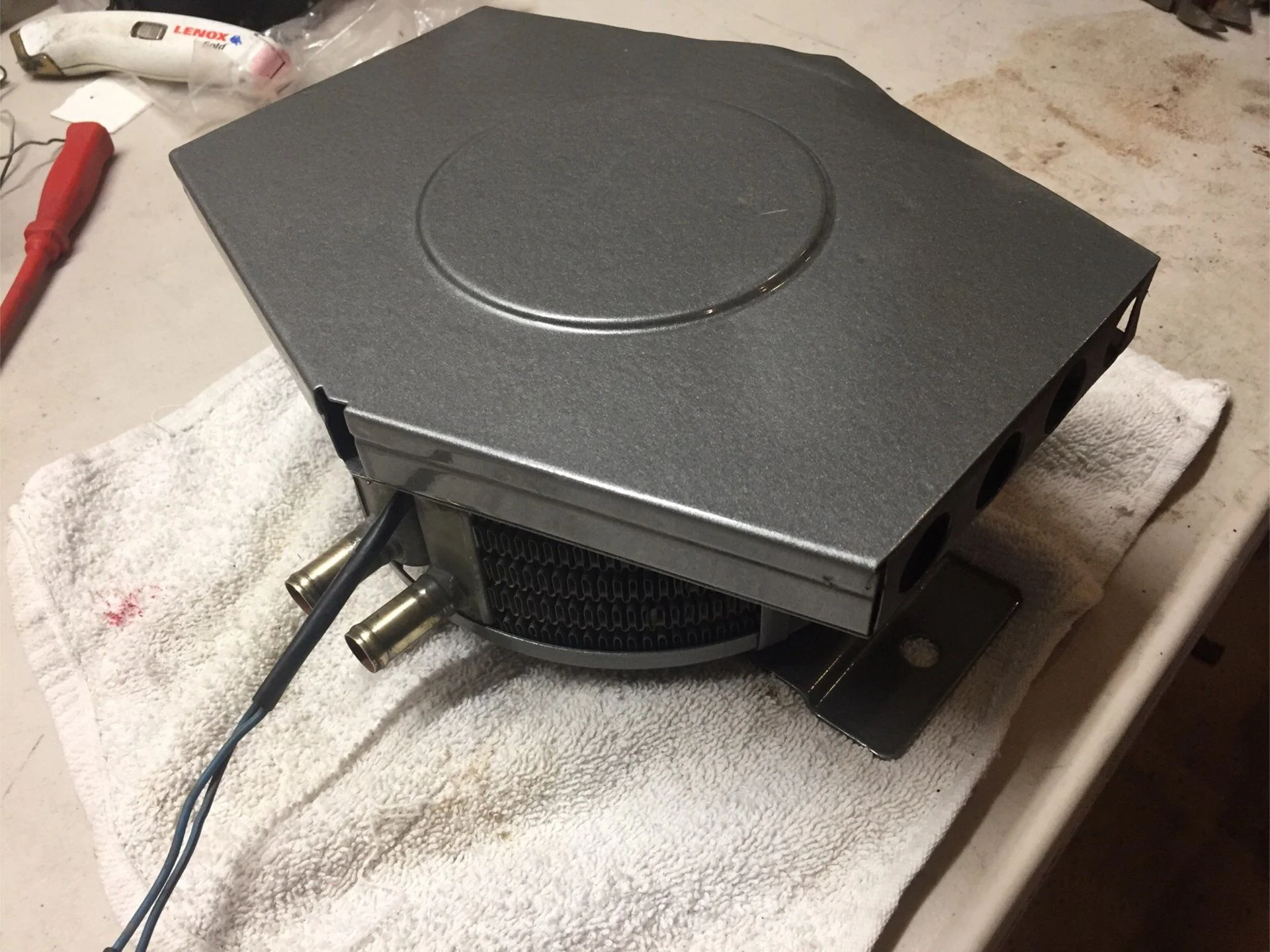

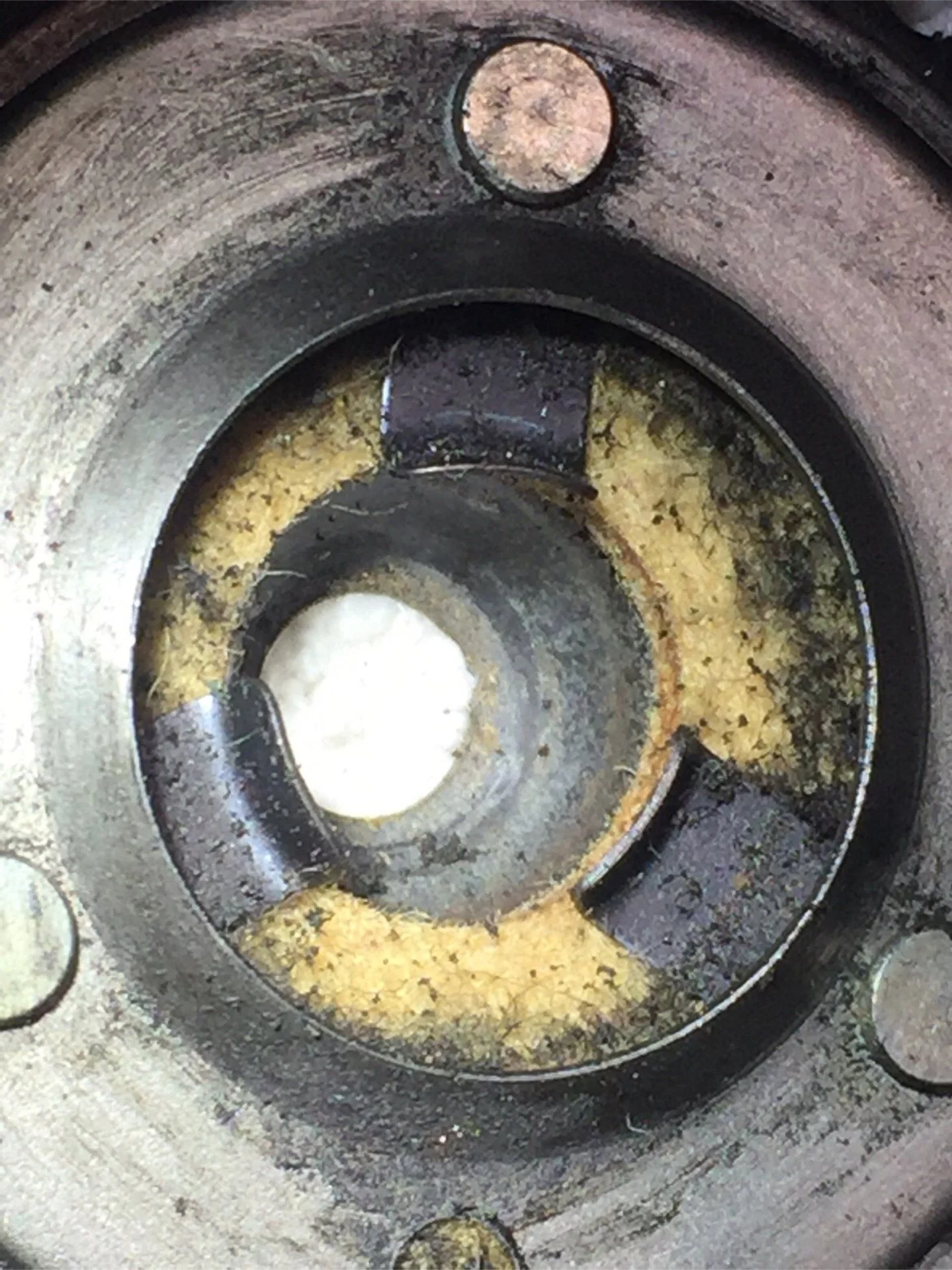

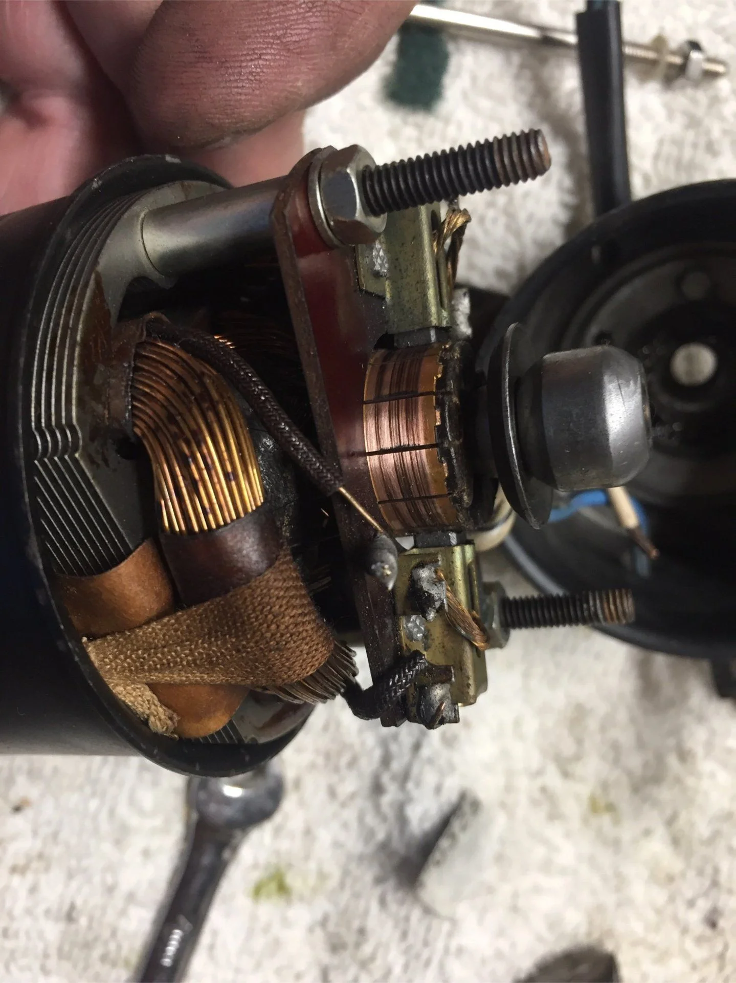

I stripped and painted the ol’ girl’s rear heater awhile ago. The painted heater parts got hung with other parts that need attention above my workbench. I’ve probably banged my head on the heater cover 25 times.:hillbilly: Tonight was the night to wrap it up. Fan motor didn’t budge when I hooked it up to a battery, so cleaned the crud off and pulled it apart.

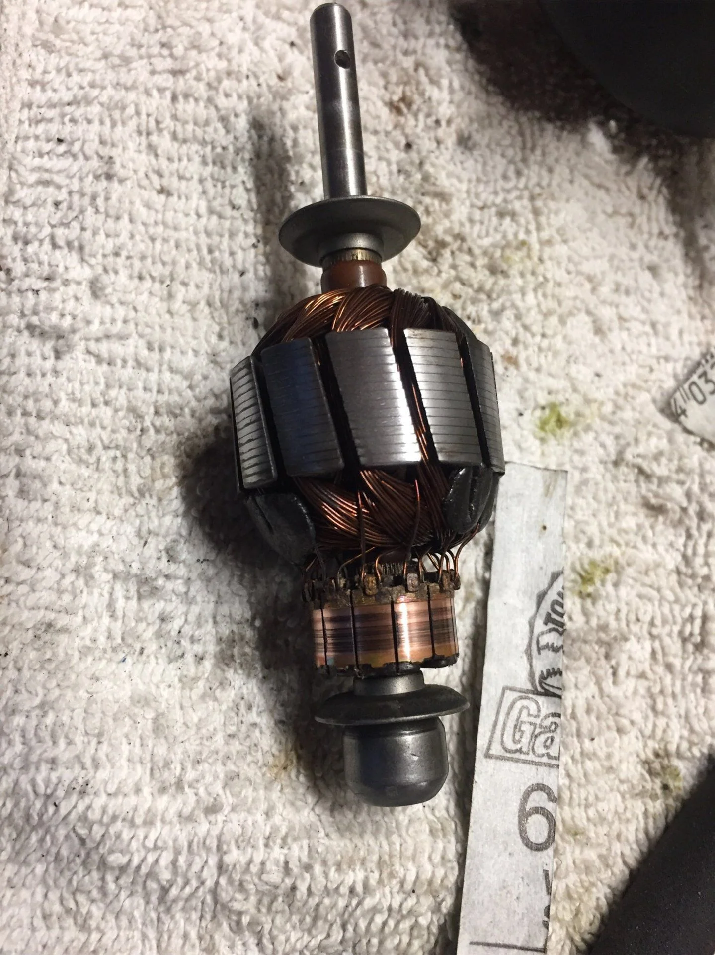

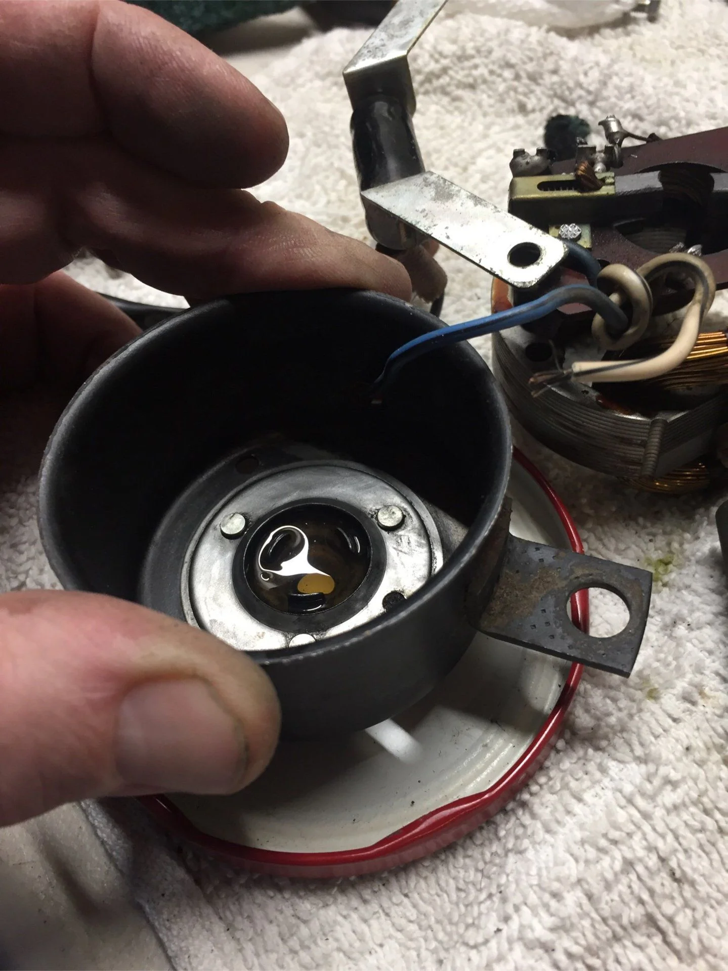

Felt was dry.
Used a small peice of Scotchbrite and a screwdriver to clean the gummed up socket. Then used a small strip of fine grip waterproof sandpaper and a long screw to smooth it out, guessing the motor spins in the socket.
Soaked the felt with oil. Used Polaris SCL chaincase oil because it’s for snowmobiles and cold weather:hillbilly:
Polished this up

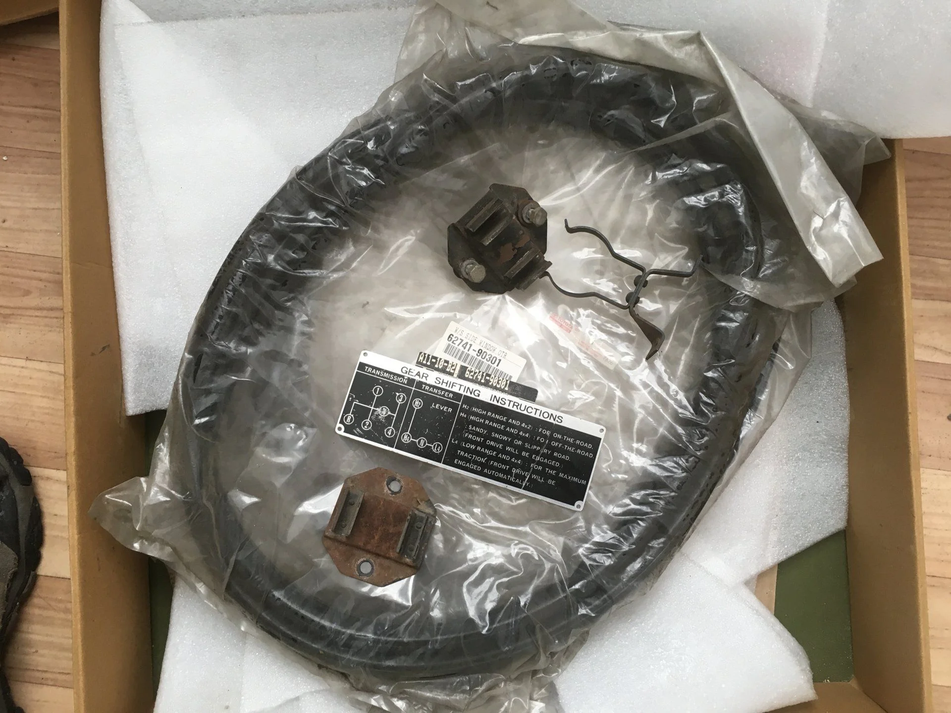

Started packing your order a little while ago. Here’s a teaser shot

On low the fan doesn’t spin. It will spin on high now, but is quite noisy. Fan blade does spin much, much, more freely by hand.
In order to insert the bulbous end of the armature shaft into the fan housing base socket(pivot) I bent 3 tabs that appear to hold the felt. So, I wonder if the saucer looking thingy is resting/riding on the three metal tabs. The steel tabs seem to have some spring. Might use some gear tooth paint on the saucer to verify whether the tabs are causing drag. Also wondering if new brushes would help.

Super stoked you hooked me up with a bunch of parts “the ol’ girl” is missing. It just feels RIGHT to install genuine Japanese parts on this rig. I really appreciate the help and encouragement you’ve given me.

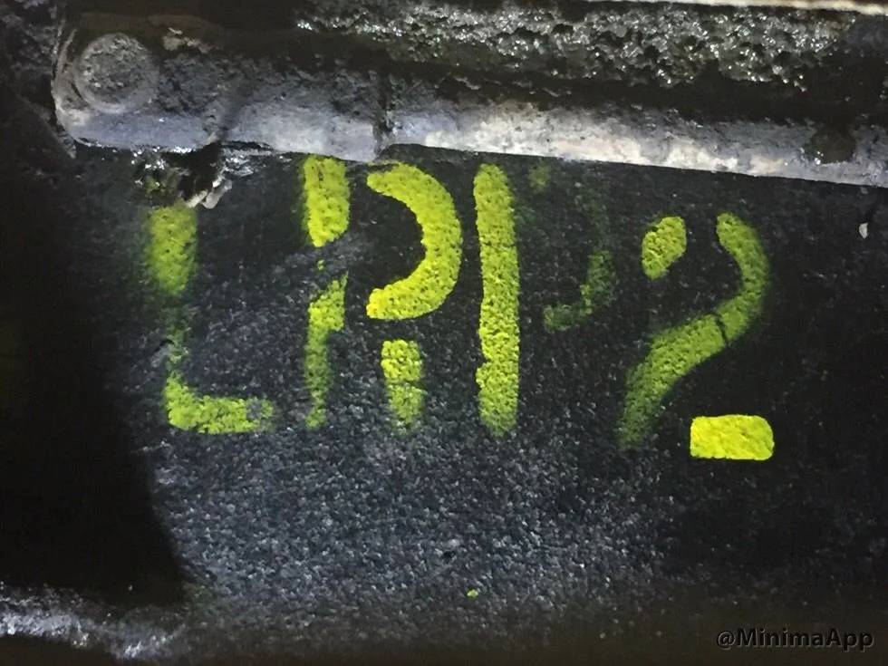

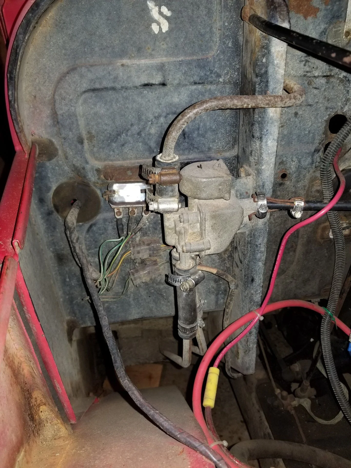

@JohnnyC did OEM 3 speeds come with a spray painted code. Or is the mark from a rebuilder?View attachment 1280919
I have a spray painted "S" on my firewall. Any idea what these mean?
I’m not sure. I’ve since seen other threads where people have posted pictures of codes sprayed on the tranny. Do you have a picture?

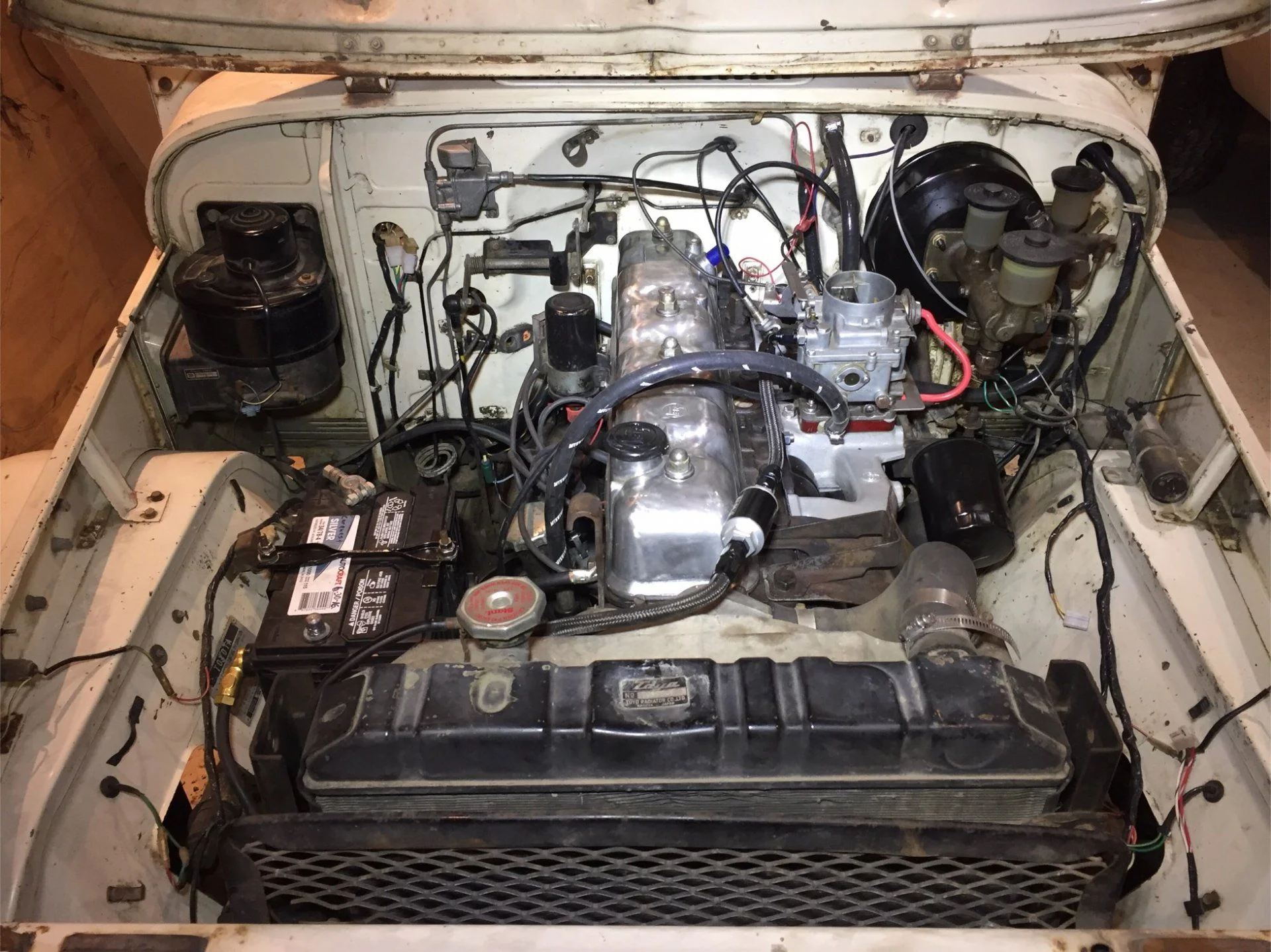

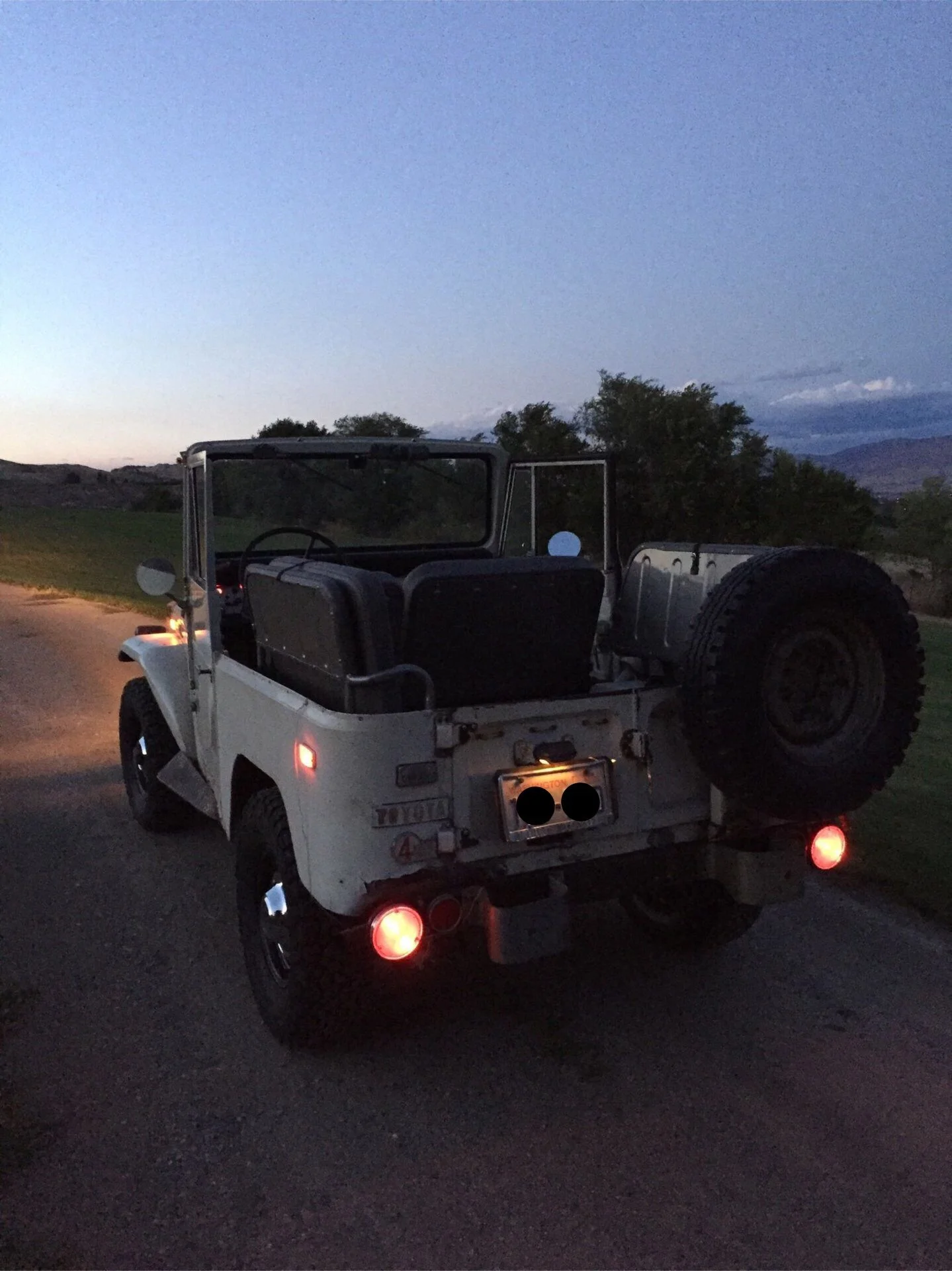

My attempt at bringing another cruiser back to life gained some promise late last night. I bolted the newly surfaced manifolds back up and she ran nicely. I probably still need to do some fine tuning though. I am optimistic I'll soon have enough confidence in this rig to take it for a long drive. Right now, it idles at 650rpm and 18 inches of mercury. I backed it out of the garage at midnight and the acceleration stumble seems to be gone. What a relief! I did pull my carb apart again to give it another cleaning prior to my much anticipated test fire. While inside the Aisan I bumped my main jet from a 112 to a 120. Also switched the rubber accel plunger in favor of a leather plunger.
Thanks to @woody for creating a cruiser forum, where someone like myself with zero knowlege can learn how to make a cruiser go again.
I really want to remove that air cleaner bracket and clean it up. Don't want to open a can of worms though(breaking a head bolt) If anyone has experience with head bolts breaking, feel free to reassure me leaving it alone is wise.

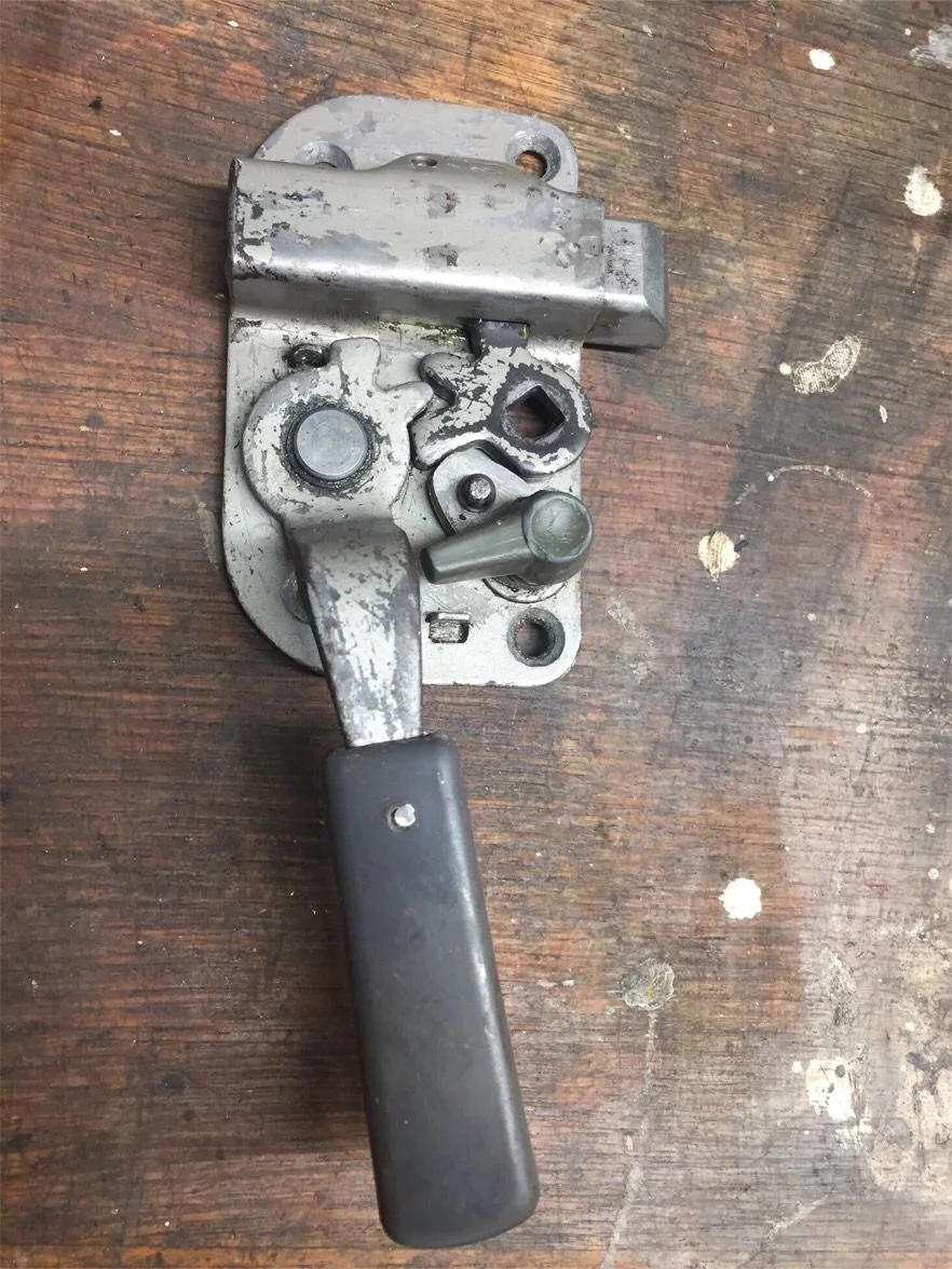

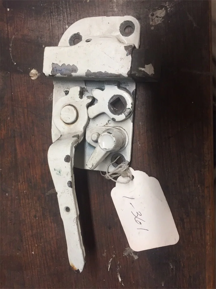

Found a passengers side paddle handle that works. Now my daughters can exit the cruiser without help from me:idea:
Stripped it and left it used looking for now. Even added an online auction site grip:steer:

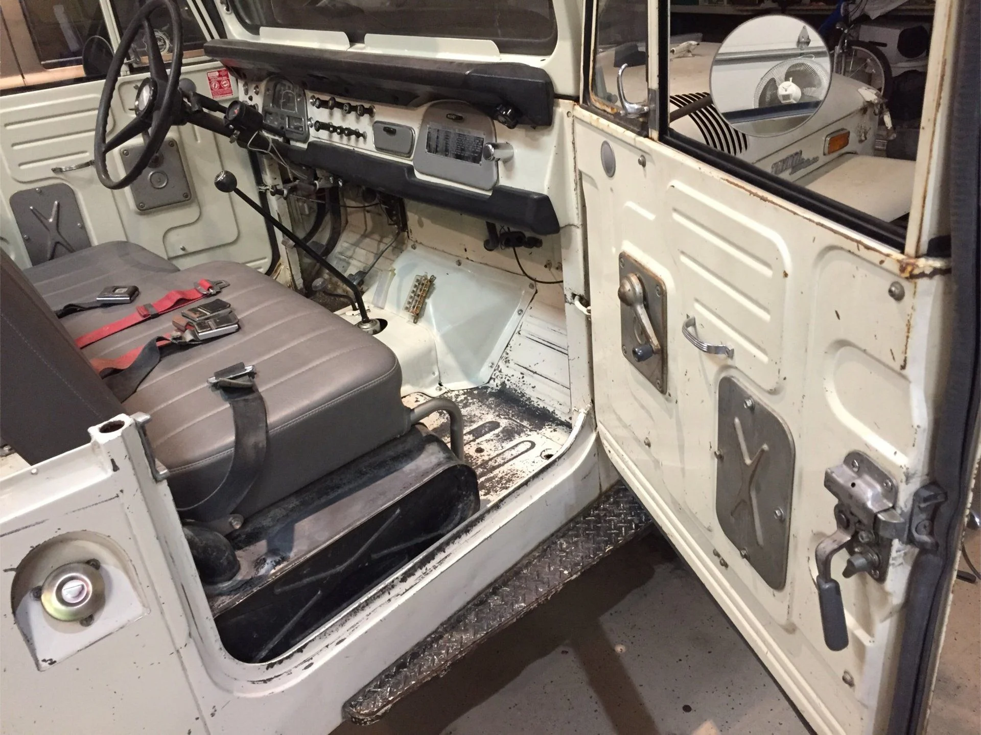

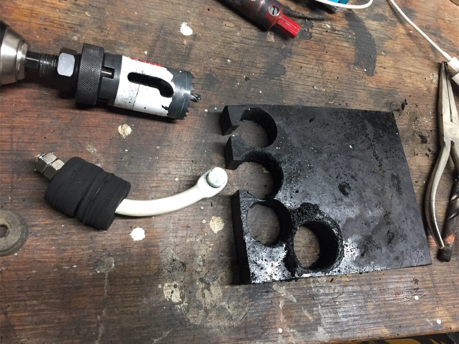

Finally installed door limiters. Made rubber pucks from a chunk of horse trailer mat.
Picture of the newly installed limiters and NOS gas cap(Mark’s Off Road in SoCal)

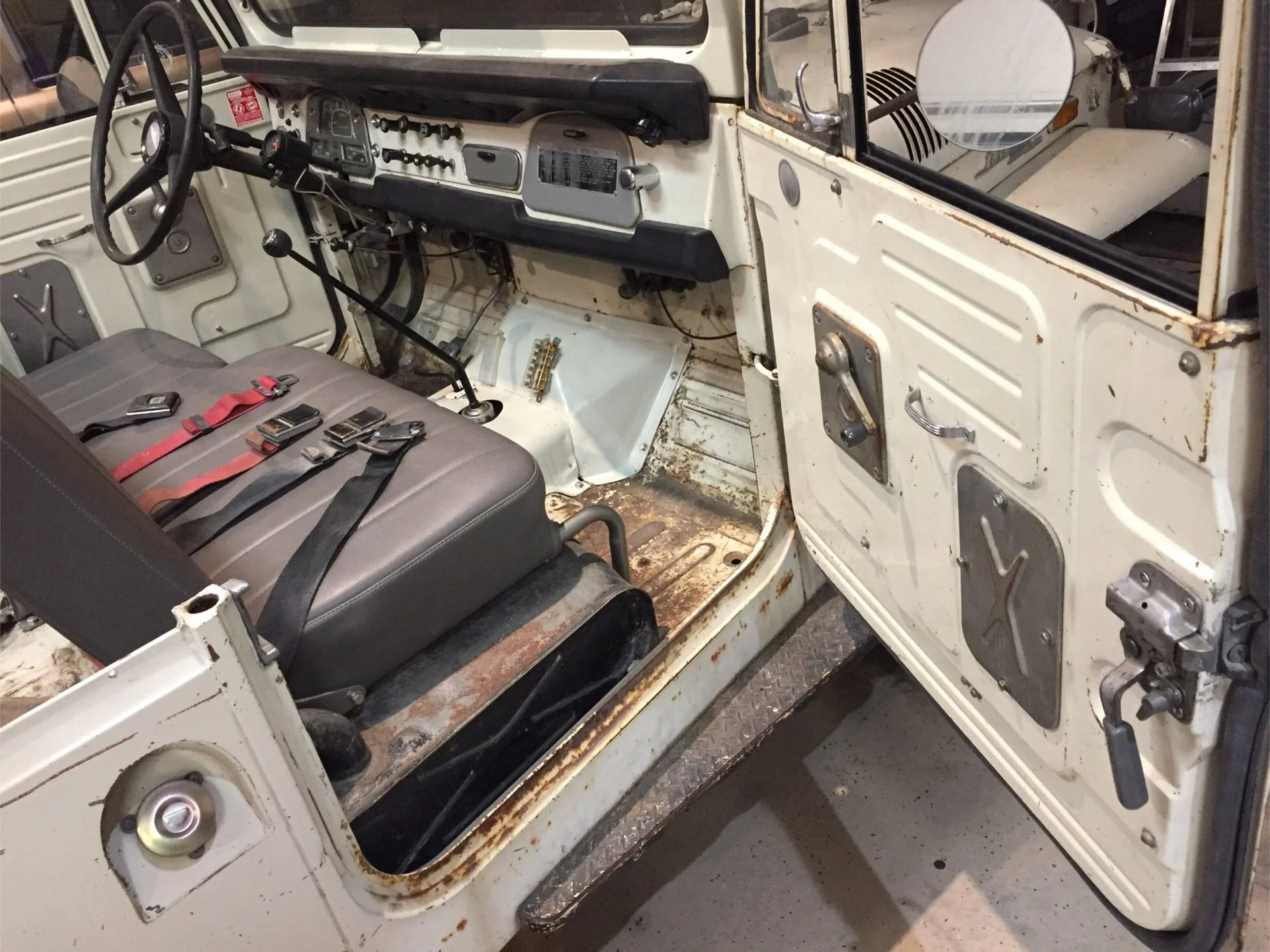

Decided break out the Naval Jelly to reduce some passenger side rust.
Hmm I like the naval jelly work. I have some rust on my '71 that I could hit with it. You brush it on and then wipe it off or...? Are you going to paint it now or oil the bare metal? How does the naval jelly compare to using POR-15? I was thinking of hitting mine with that stuff...POR-15. I suppose it's a lot pricier...
