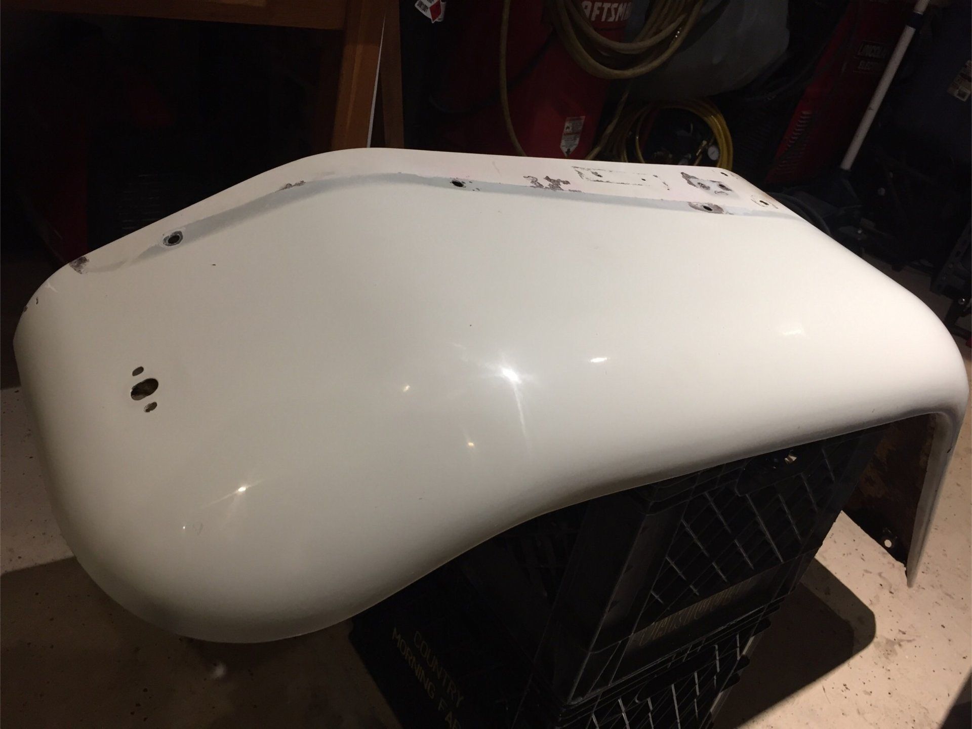

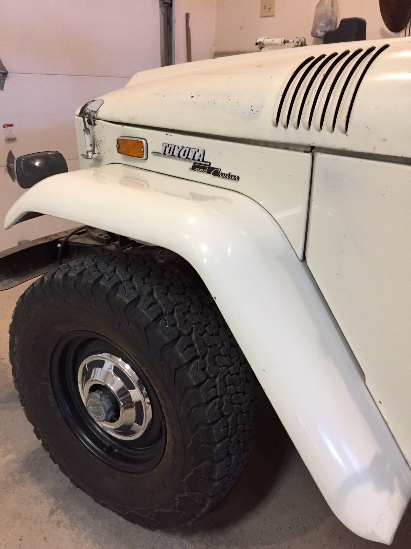

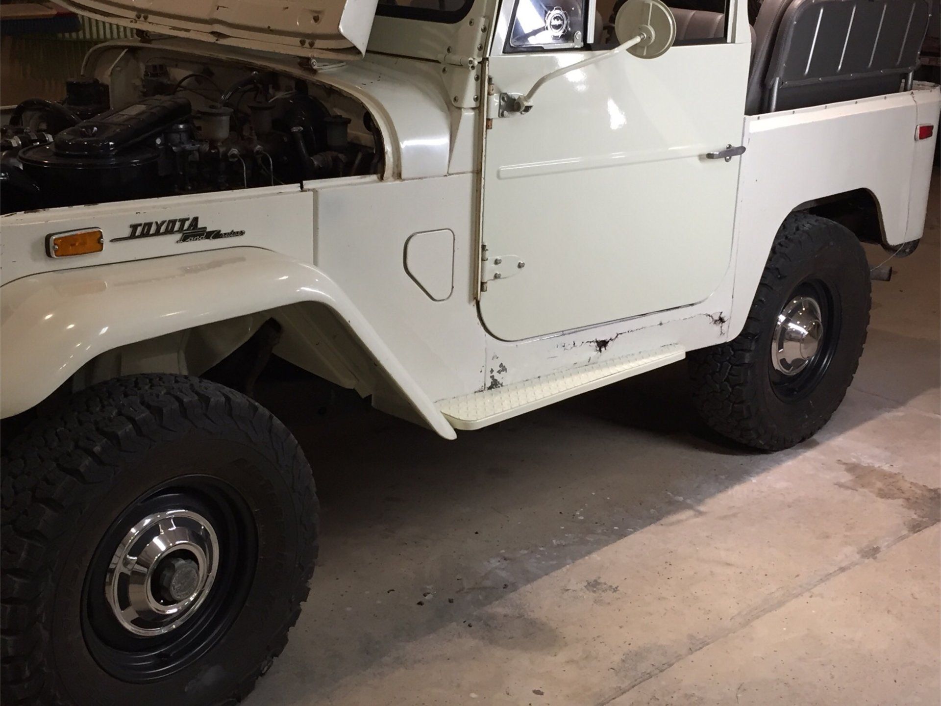

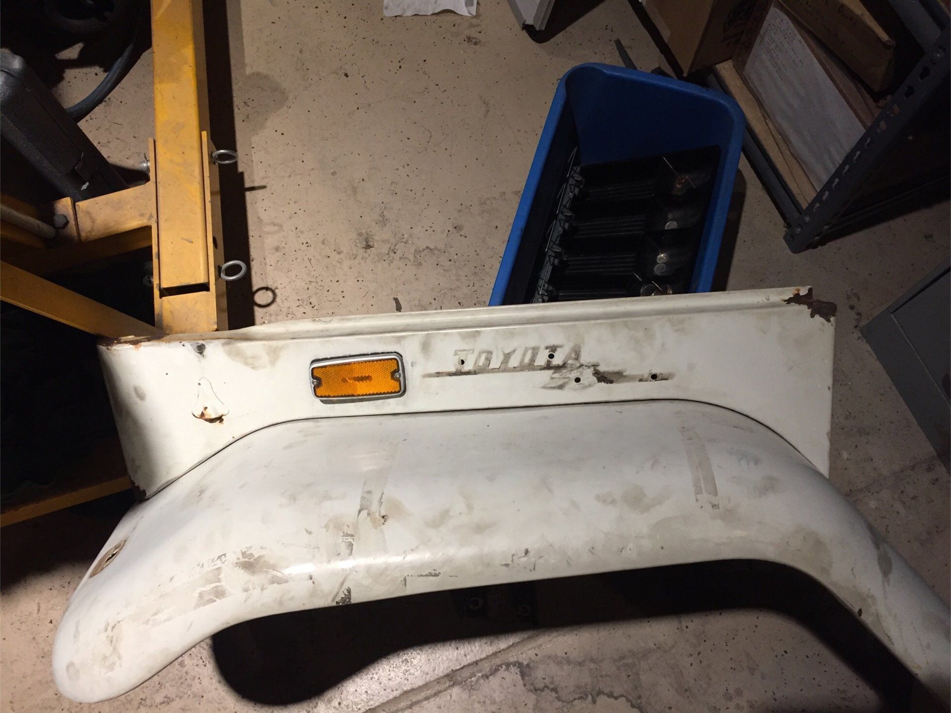

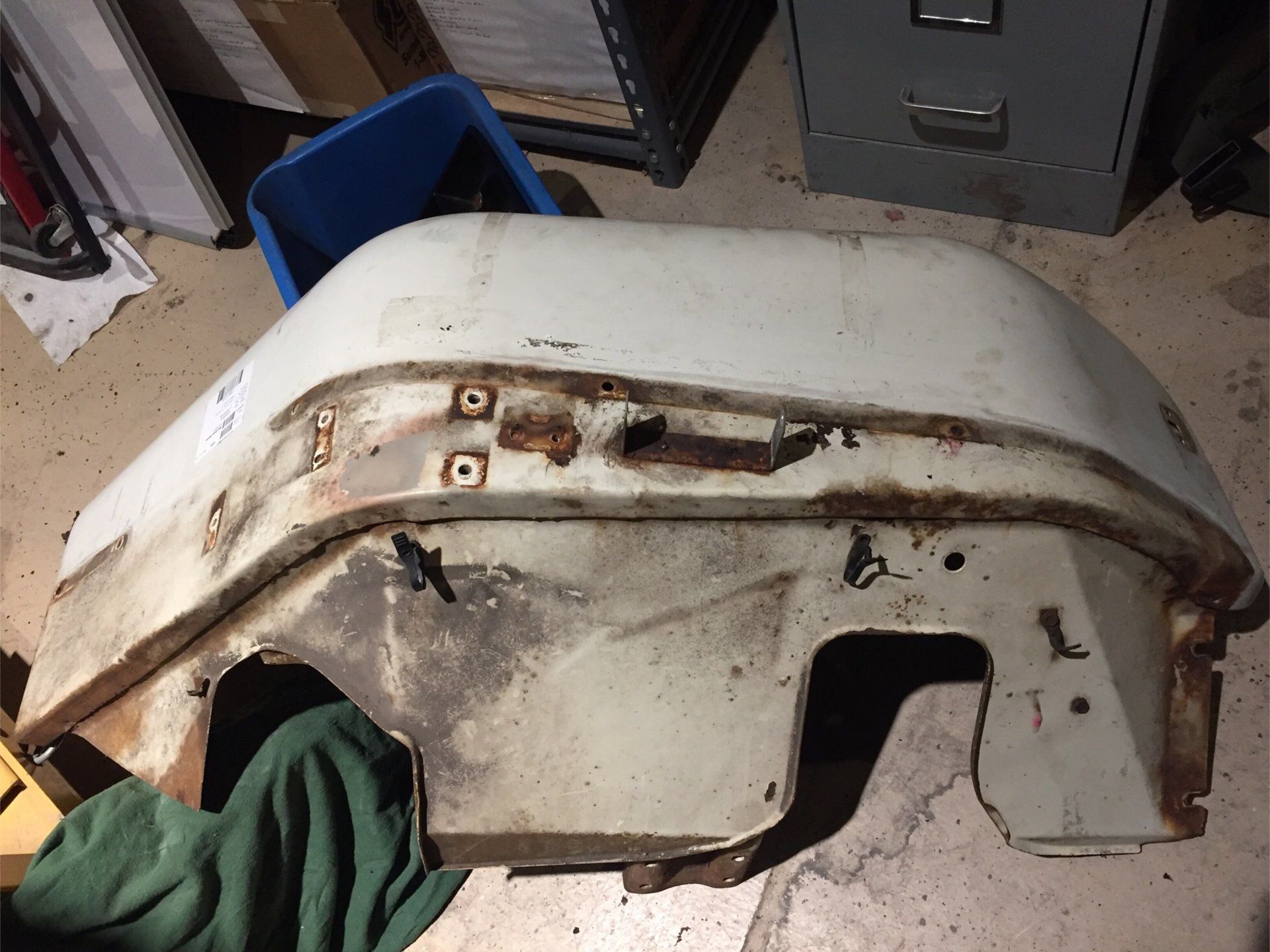

Finally found a nice used Cygnus fender. @cruiserjunktion hooked me up. Appreciate it Deo:cheers:
Before cleaning
After
Before
After

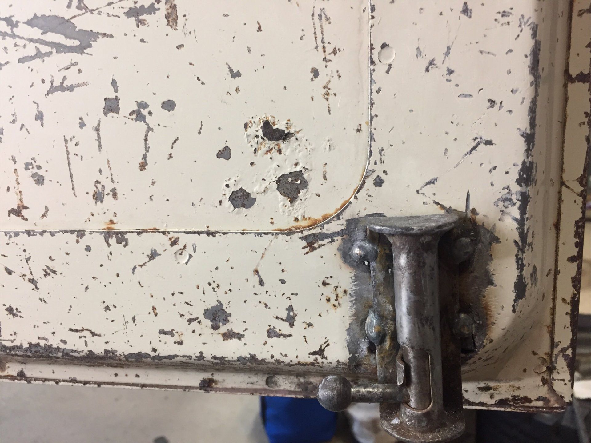

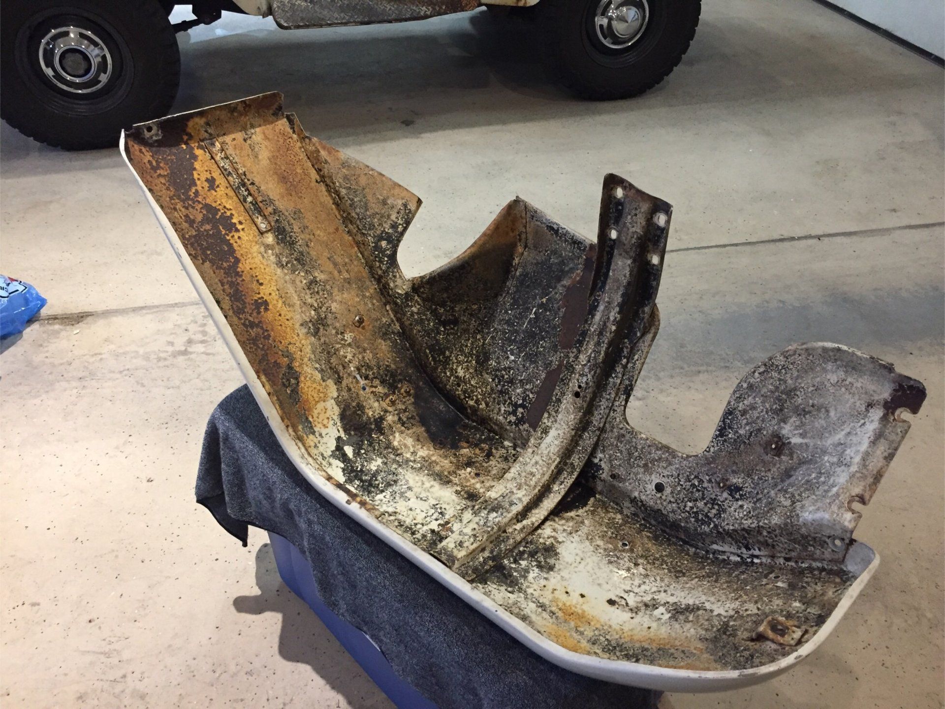

Degreased, used goo gone to remove leftover adhesive, then Navel Jelly on the rust, quick wetsand with P3000 & P5000 and Viola:hillbilly:

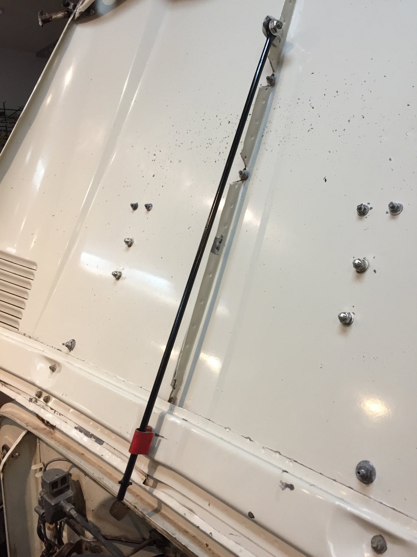

Sprayed some epoxy primer then single stage Cygnus white. Last time I shot the PPG Omni Cygnus, it was a bit green to my eye. So I experimented with adding some Lily White. Ended up using 4 parts Cygnus to 1 part Lily.
The paint exposed to the engine bay was blistered, almost like it had witnessed an engine fire. Figured now is the time to scrape it and paint

Had somehow missed this build. Very nice! Amazing what the naval jelly has done for the panels. This is giving me an itch to sell my current 40 and find a fixer upper...

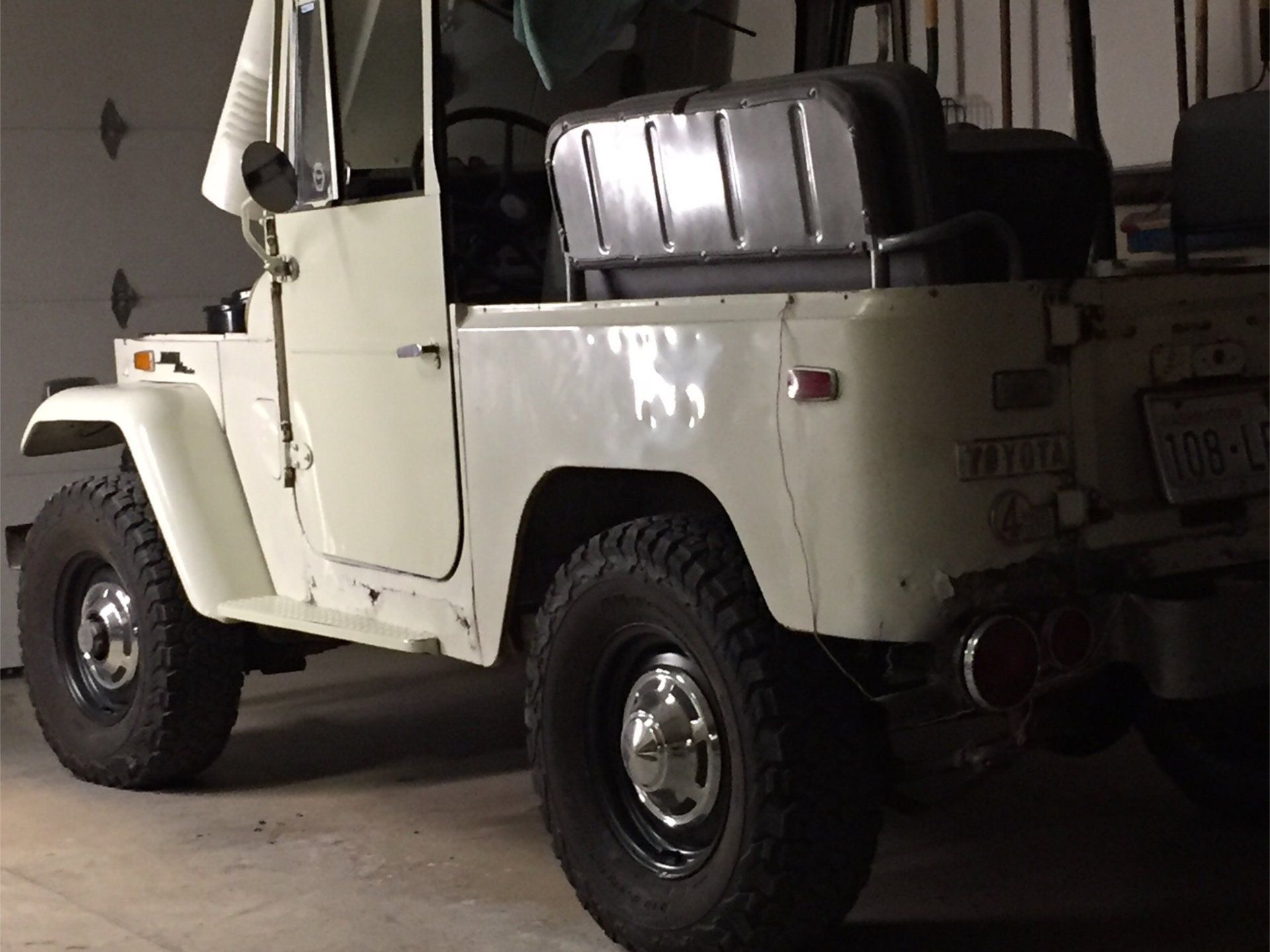

Finally got Cruiserjunktion's fender mounted
Freshly painted fender well.

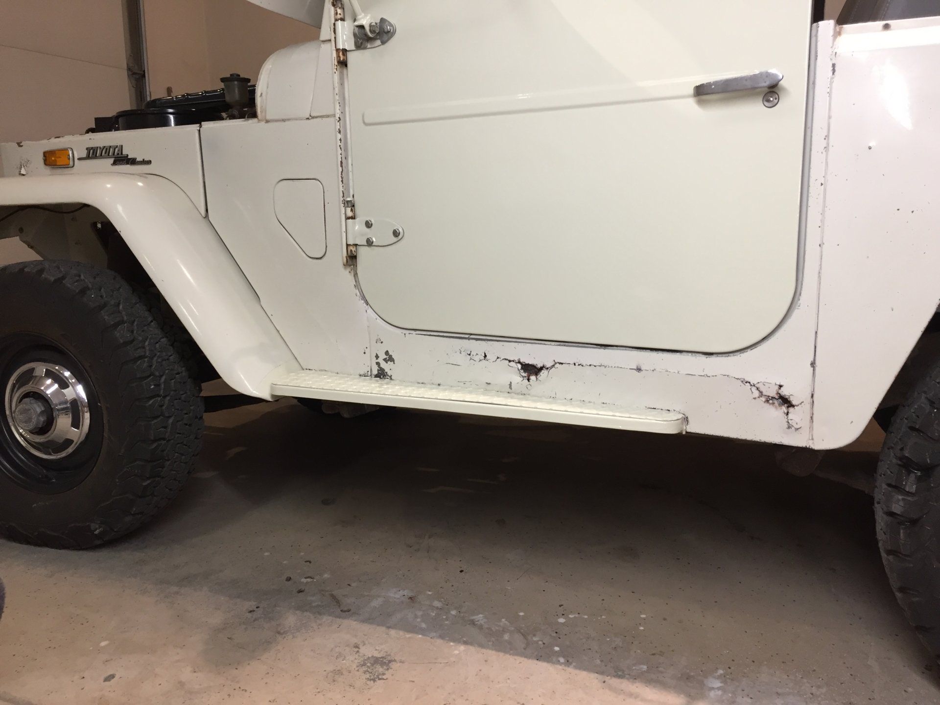

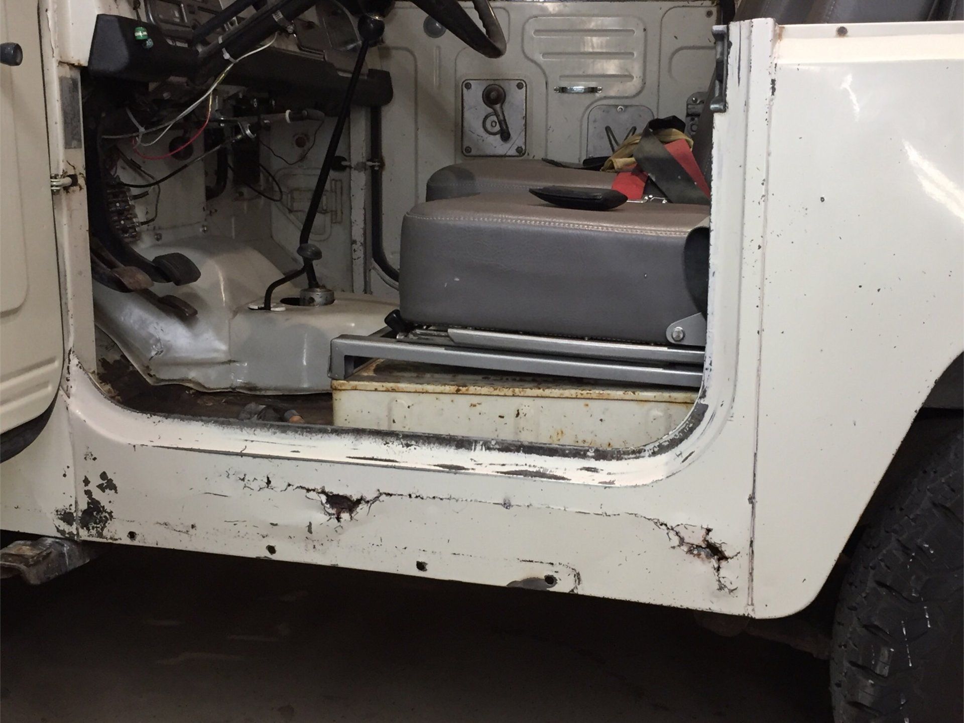

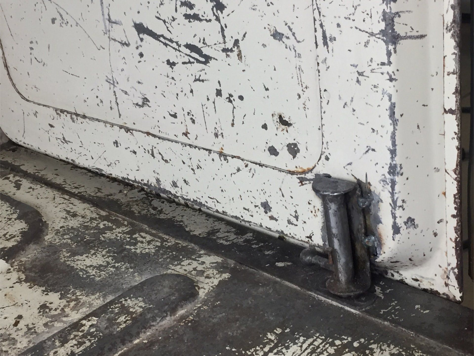

Rust cleanup before running boards go on
Needed to save the rubber pad and my lungs. So I sliced the carriage bolt.

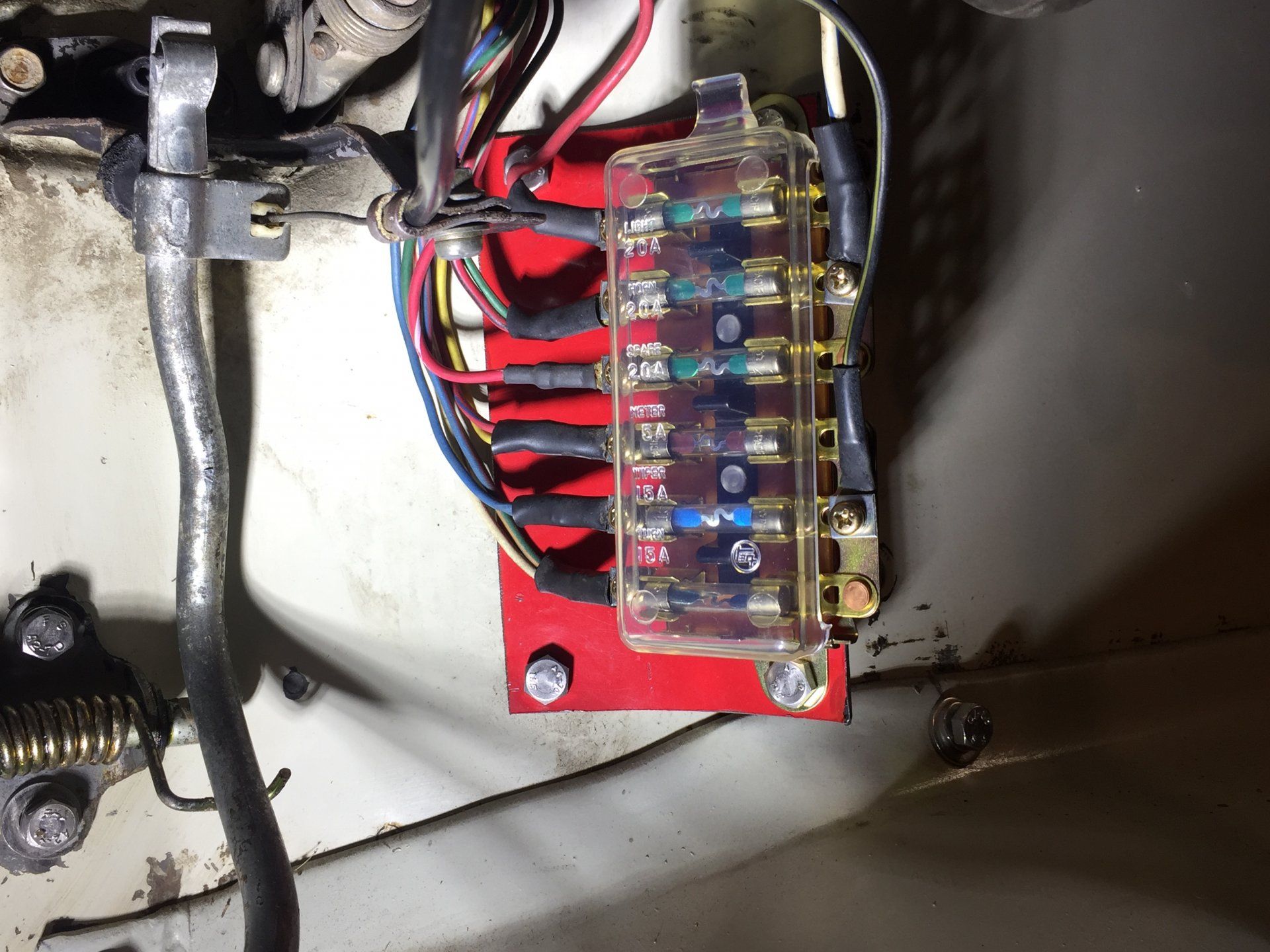

Been awhile since I've made improvements to the 71. The old fuse panel was too close to the hand throttle bracket for my liking. Cut and bent a relocation plate. Will paint it white someday:) Ended up using a NOS fuse box I've been hoarding. Also bent the accelerator pedal a bit lower and to the left. Right side of pedal was contacting tranny hump. Adjusted the Pedal and throttle cable so just as pedal meets metal, butterflies are exactly WOT.
Nice work. Has the loctite naval jelly affected the paint at all? I have used several rust converter products on some spots. They always leave the paint stained. That doesn’t seem to be the case in the photos that you posted above

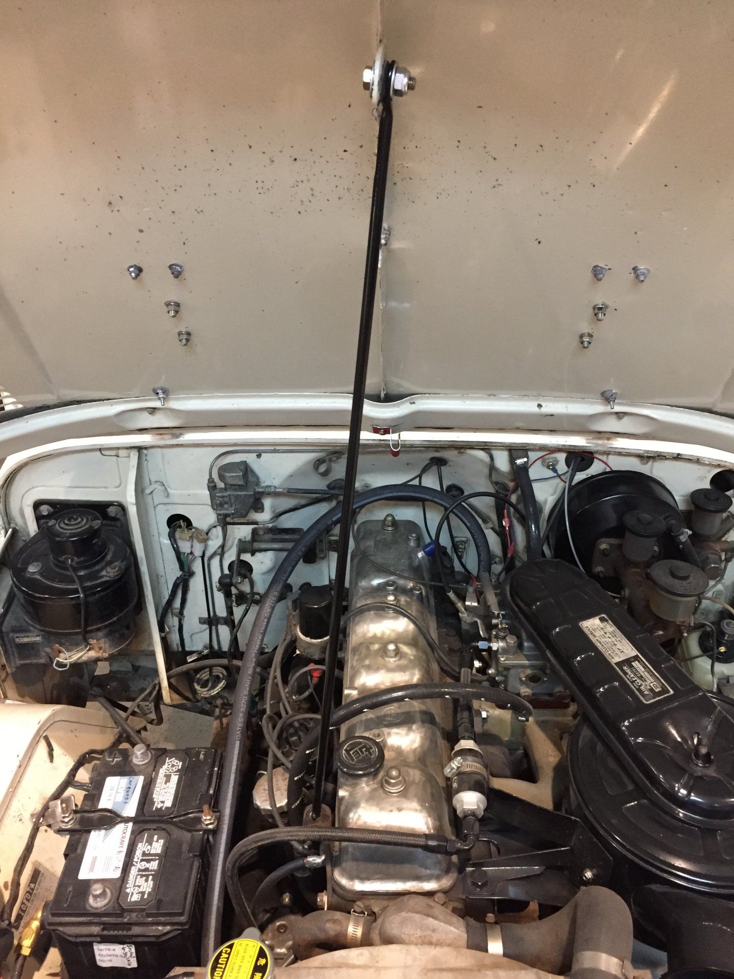

Hole in engine lift hook=like!!
#IMAGONNADOTHATTOO
It seems like almost any spot is better than the one the factory picked.o_O
Have practically marinated OEM cygnus parts in Naval Jelly, no staining noted. I buy the "dissolver", but did accidentally grab a jar of "converter" one time. Labels looks almost identical. Have used both Loctite and Permatex branded dissolver, both work great.
