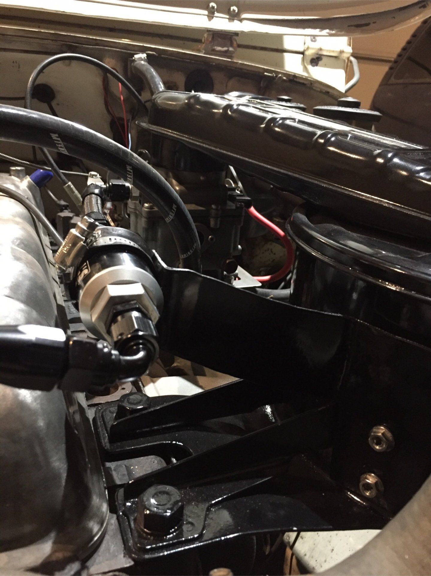

Finally made a little bracket to hold my 10 micron fuel filter. Wanted to use something more fancy than a pipe clamp, this will do for now.
Still need to re-route my PCV hose (I made it too short) so I can pop my valve cover without removing the hose.
Nice work with the AN lines and fittings, great stuff
Yeah I just never put forth the effort to learn how to build my own hardlines lines. I know it's probably something I could learn. I did kinda feel it wasn't right to use modern plumbing, but I had a bunch of leftover Fragola supplies from my first project. I guess I went with what I know how to do. So far, I like the servicable AN filters. I've got a 40 micron stainless mesh filter pre fuel pump and the 10 micron (cellulose) pre carburetor.

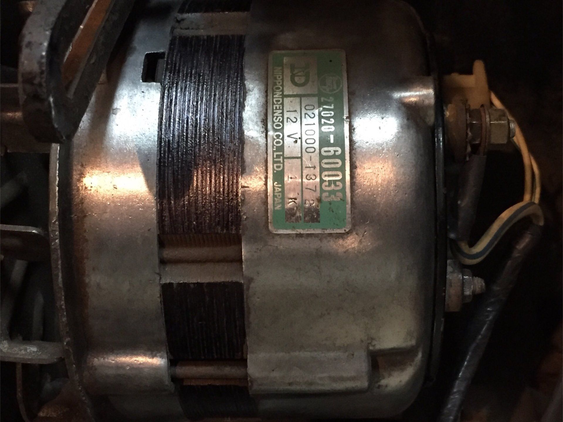

Been needing a wider alternator pulley to fit a newly installed 17mm Toyota belt. Bought a nice old NIPPONDENSO that popped up in classifieds. Cleaned it up, scuffed the pulley with a Scotchbrite. Works great and I was glad to find another good old Made in Japan part.

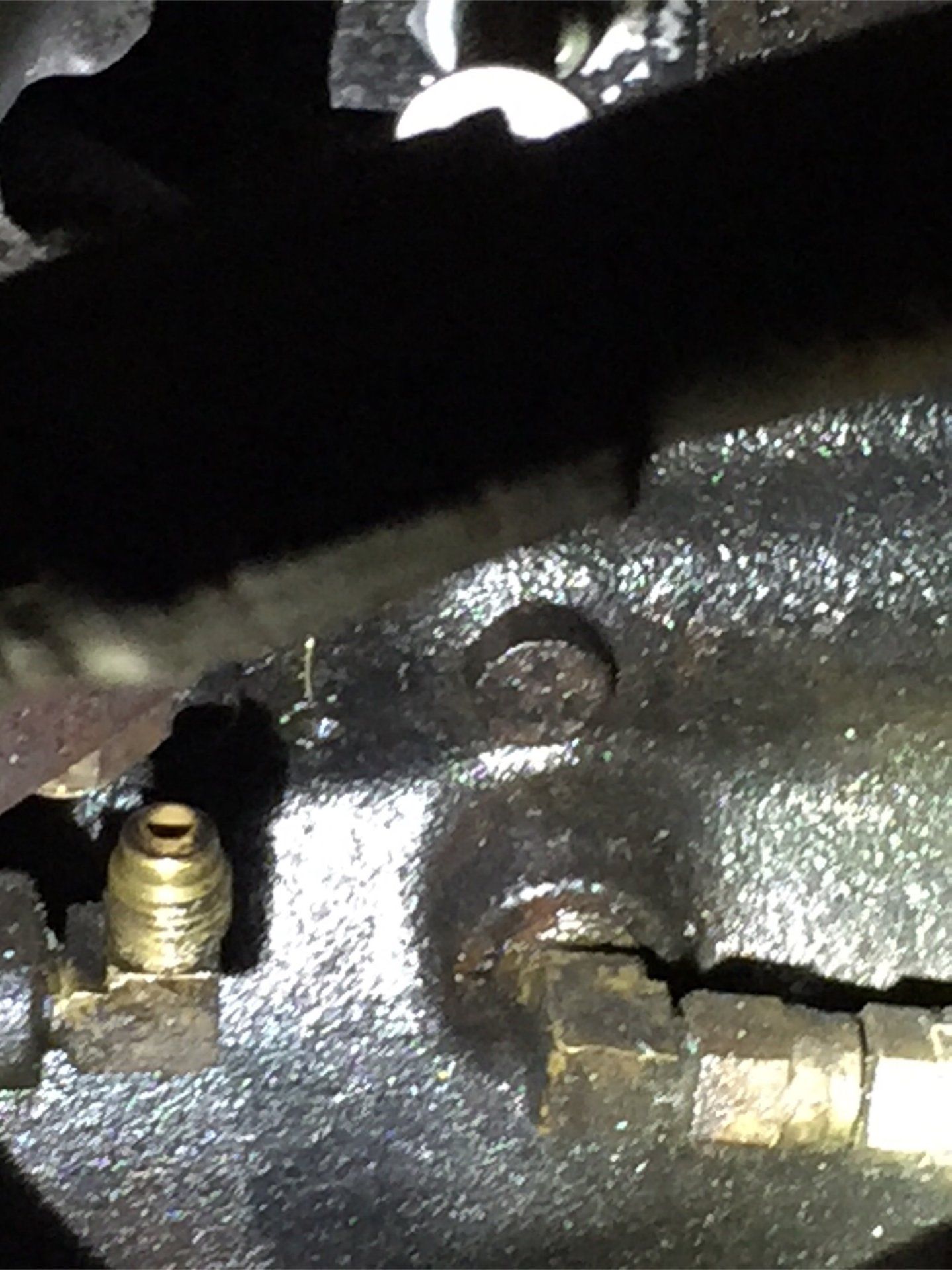

Before the 71 went to winter storage she blew an oil line. Luckily the oil squirted on the exhaust, causing smoke. Probably drove 200 yards before pulling over. Luckily my cousin was in town, he towed the ol’ girl home. Oil even made it through the trans hump.
Looks like the PO added -4 AN or JIC fittings. I imagine the other end is 1/4 NPT. Made a temporary hose using a chunk of braided fuel line and some Army/Navy fittings that were laying around. Thinking I’ll just leave the fitting as is and build some hydraulic hoses next year. Had to add a couple quarts of oil. Was surprised how quickly oil was pumped out of the tiny crack.
