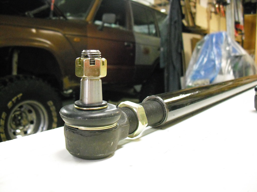

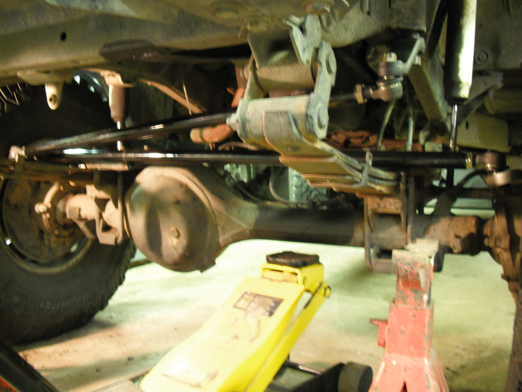

This looks a bit stronger than the stock steering system.
.250 DOM tie rods, 80 series tie rod ends, beefier pitman arm and knuckle arms. And to make it even better the tie rod is brought above the leafs.

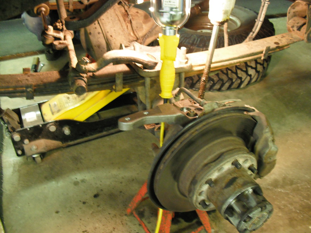

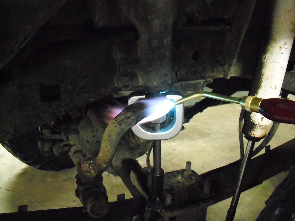

I bought a cheap pitman arm puller from Princess Auto, and not to my surprise it exploded under the tension and the pitman arm didn't even move. I then went out to a local industrial supplier and bought a professional forged puller. I've been WD'ing the pitman for the past week, and sat there with heat on it for almost 5 minutes before trying the new puller. I had a 4 foot snipe on the ratchet and I could hardly move it anymore, I figured at this point if I went any further either the ratchet or puller was going to break, it wasn't going to be the arm. While it was under tension I put the acetylene torch to it for some more heat.
BANG!!
I prepared myself for it to let buck, but it still scared the s*** outta me! After pulling the puller off it turned out the threads were all damaged from the tension on the puller. I'll be returning this tomorrow. I cleaned all the threads up on the steering box output shaft, and coated the new pitman arm in grease before slipping it on.
