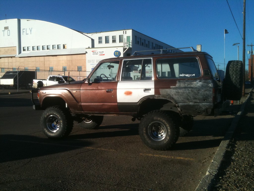

My 84 BJ60, the Nipperwagon. SOA, 35''s, Locked.
but im pretty sure its closer to 82 hp. with turbo 120+

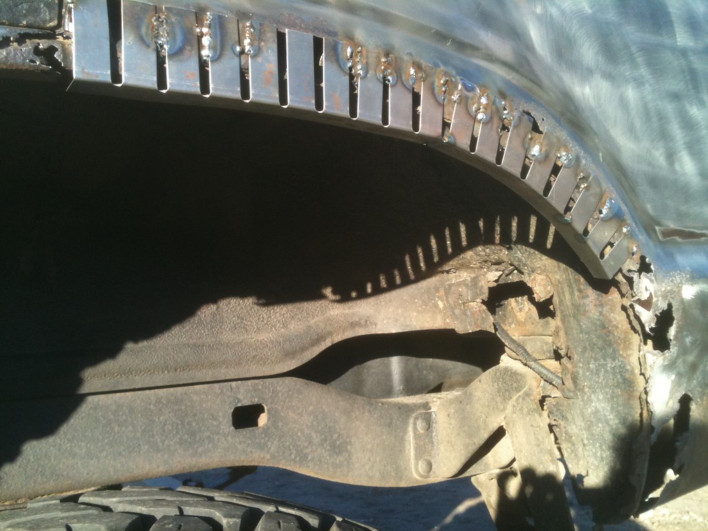

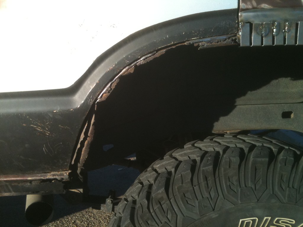

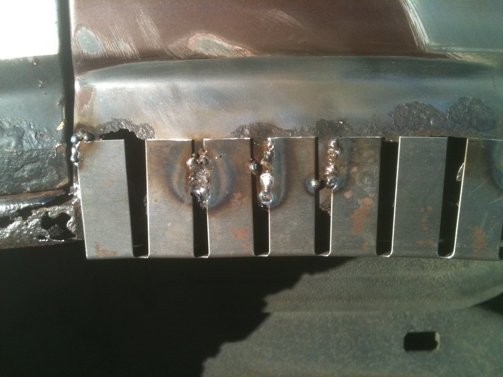

Hey man, just wondering what your source was for the fender work. Mine are not as bad but your solution was what I was thinking of doing to restore the line to the fender arch. Where did you get the metal that you welded up? thanks
Define source. Are you asking where I got my materials, or who did the work? I'll answer both; I bought the Flex-a-Arch at Canadian Tire, and I welded it on the truck myself. Finding good metal to weld to was next to impossible with the amount of rust the arch has.

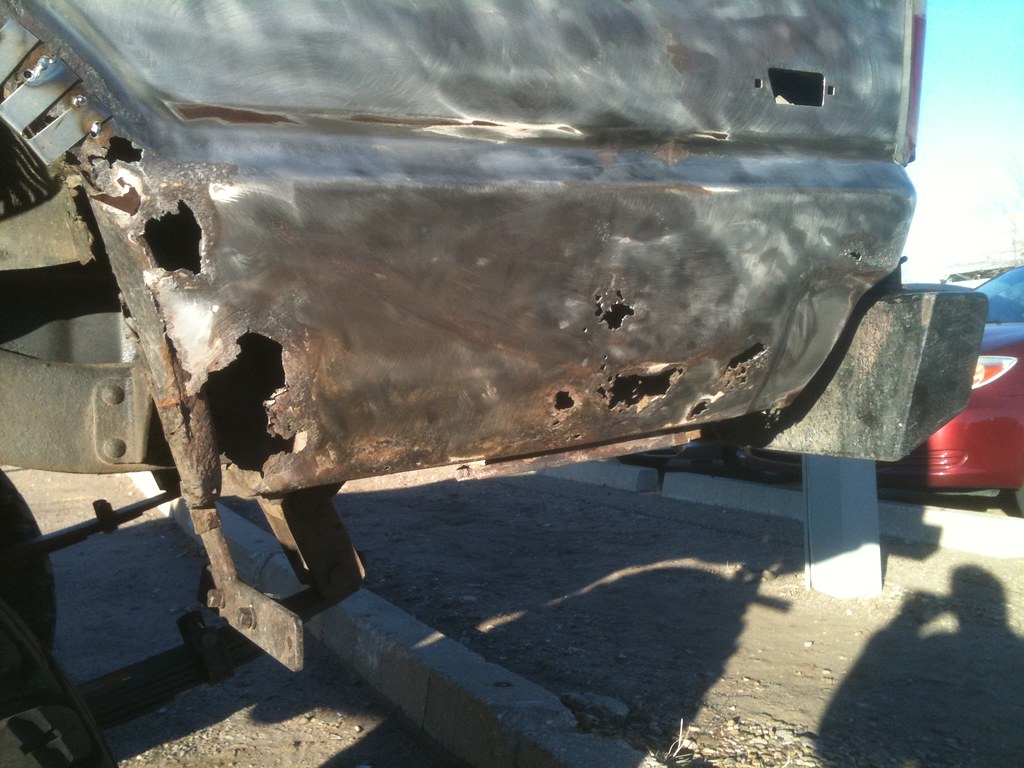

I'm back. I've been doing so much work lately I figured I would document at least some of it. The rust fixing is coming along really well, I figured some of you would want some ideas on how to fix yours.

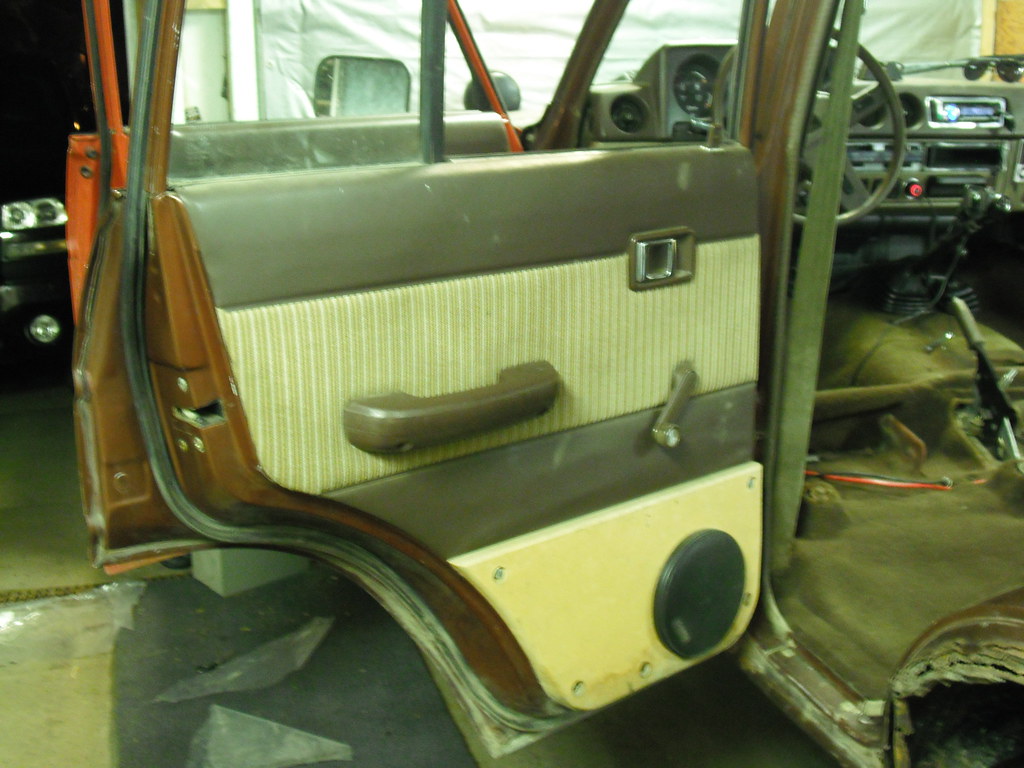

Old crap:
New crap, with new speakers:
Cool!

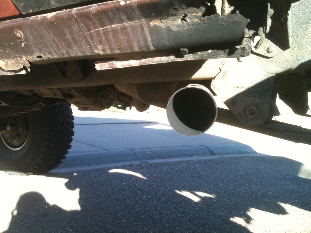

Basically, I cut where the exhaust heads of the driveshaft behind the t-case, adjusted the angle a bit, and mounted the Flowmaster 40 at about a 45 degree angle to the truck, as close to the floorboards as possible. It fits like a beauty, sits higher than the frame rails. doesn't interfere with the driveshaft, and leaves enough room to work with the outlet piping. After utilizing a few bends from the 7.3L exhaust, I managed to snug it up close the the rear leaf mount and the frame. I was able to use all the stock exhaust hangers, it sits super close to the frame and leaf mount, and is tucked up high enough to keep from getting ripped off in the bush (if I haven't ripped it off in the bush, nobody will).
Here are a few pictures and sound clips. The videos were taken from an iPhone, so sound quality could be better, it muffles on video #2. It also has a deeper sound when under load. Tell me what you think!
Videos are from 750rpm-2700rpm.
YouTube - BJ60 Land Cruiser 3B 3.5 inch side exit exhaust.
YouTube - BJ60 Land Cruiser 3B diesel 3.5 inch side exit exhaust.

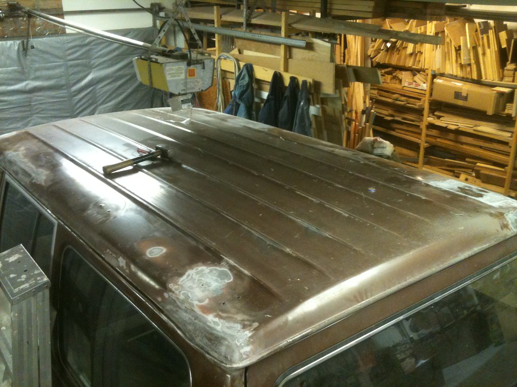

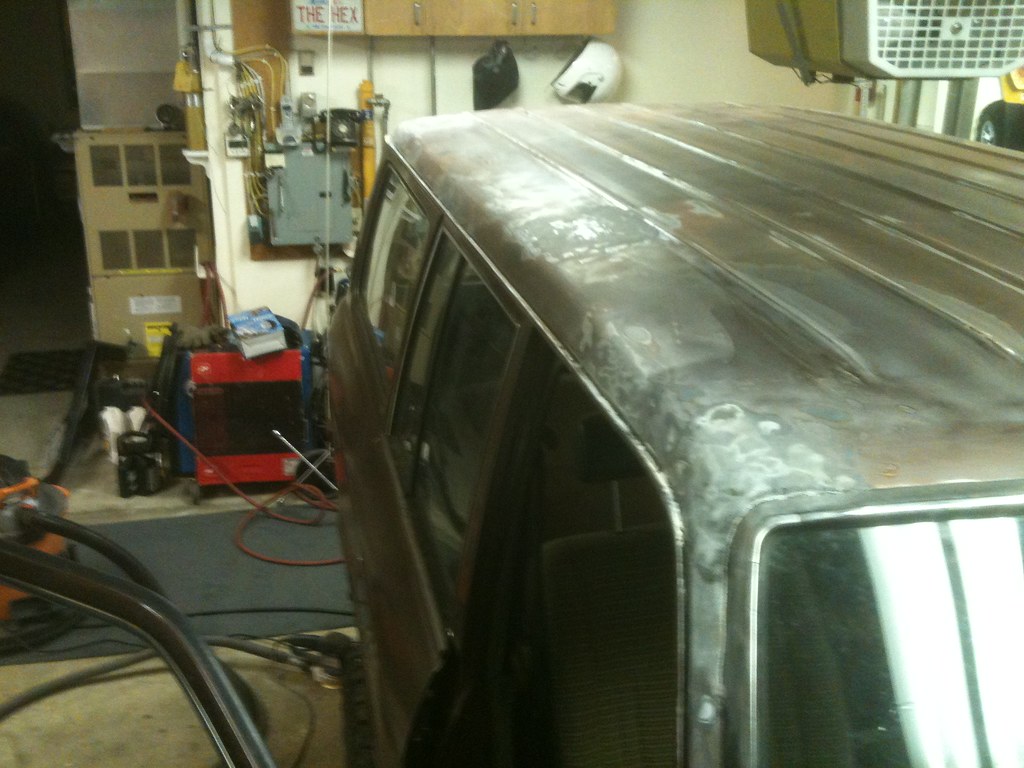

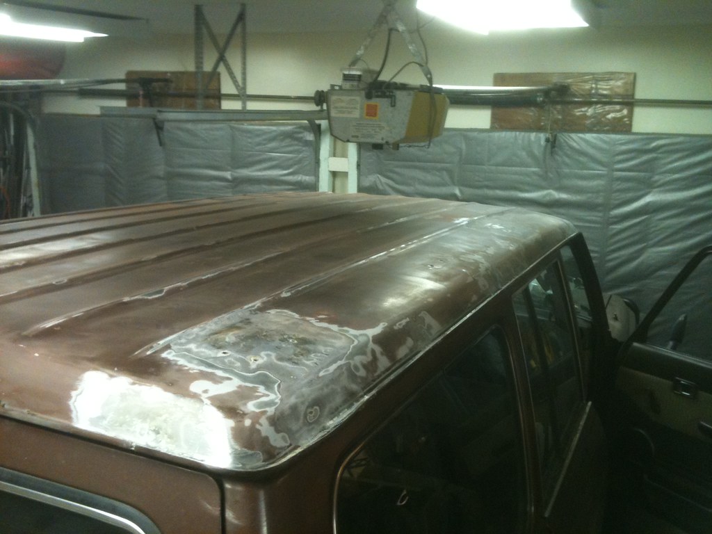

The weather was nice for a few days, so I had the oportunity to work on the driveway. I took this to my advantage so that I could keep the dust down in the garage, and have some headroom being the roof is so high.
42 holes. A much bigger job than anticipated. This was after the first layer of fiberglass. I was blown away how easily the roof rack bolts came out, probably due to the silicone sealing them from the factory. I was also surprised with the condition of the rubber gaskets under the roof rack feet, you think after 25 years they would be dried out and cracked, but they look and feel like new.

The rain gutters had some rust in them, directly under the drip rail above the passenger rear window it is rusted though, but other than that it was just rusted around all the roof rack mounting points and the A pillars on the top corners of the windshield. Then random holes all the way along the sides of the roof above the rain gutters.
You can see the rust above the window in this picture. the truck was parked on an uphill slope for just over 1.5 years, all the snow and water sat in the rain gutters and rusted em out. Sad really.

Finally got some paint on the roof. Since these photos have been taken the rough spots in the bodywork have been fixed with bondo. I initially didn't even use any bondo thinking that it would look fine, but once the gloss paint went down all the imperfections cam out. I know it's the roof and nobody is going to see it, but I might as well make it look half decent.
These were taken with my phone in my garage, so it's pretty crappy quality; it looks pretty damn good in the sun though. I will try to get some good picture with a real camera tomorrow. What do you guys think of the new color so far?
