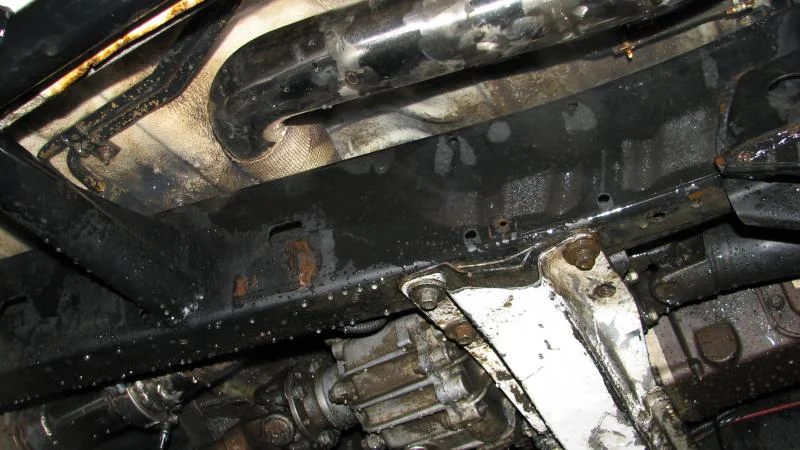

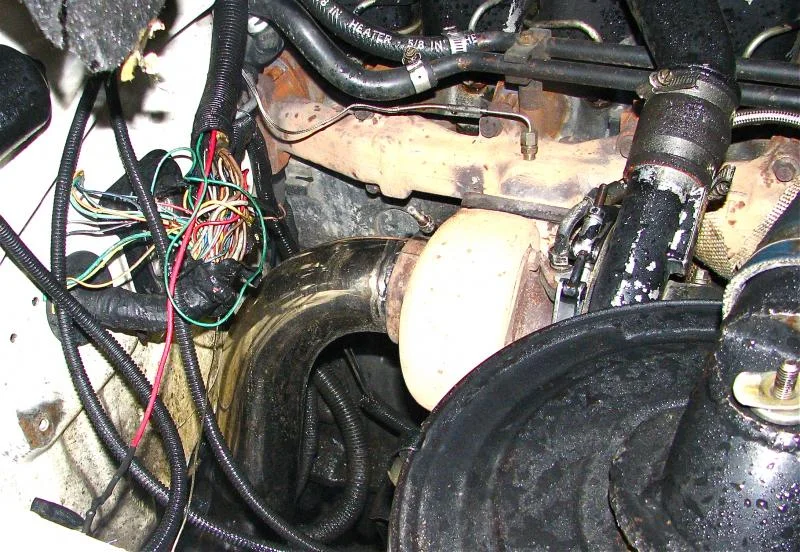

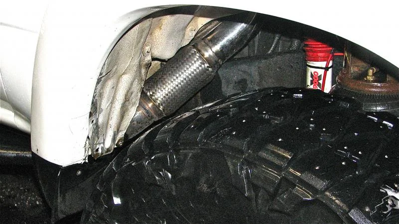

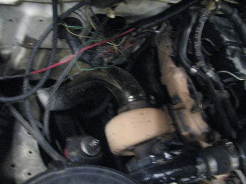

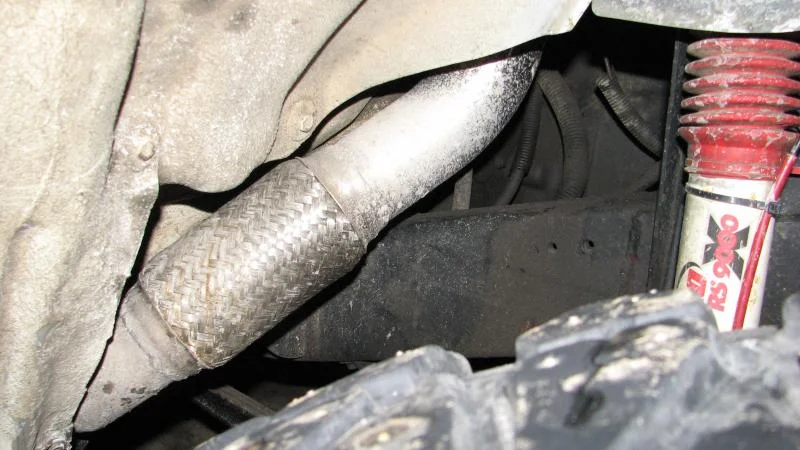

Anyone know the best way to upload a photo from an iPhone to a desktop? It's not showing up in "My Computer", I'm confused how to transfer it to my home desktop. I want to show these intercooler photos!
this things real dirty, im gunna blast it off and post some better ones
gave it a lil bath.
in the last photo you can kinda see the weld seams where Ive ground it down and taken a flap disk to it. Im sure you could polish it up a bit better and make it look better, but it went with SS to avoid corrosion more than cosmetics, so good enough for me.

Nice stainless exh.
