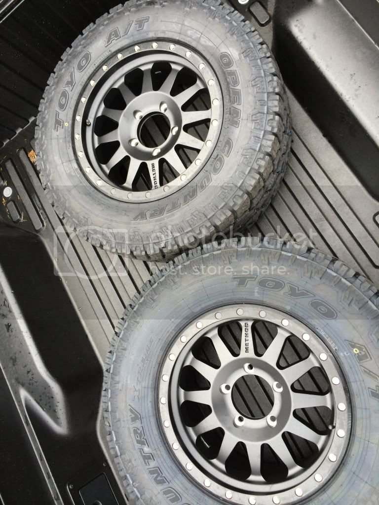

-325/60/18 Toyo AT2 Xtreme (aka streamrollers)
-18x9 Method Double Standards 25+ offset

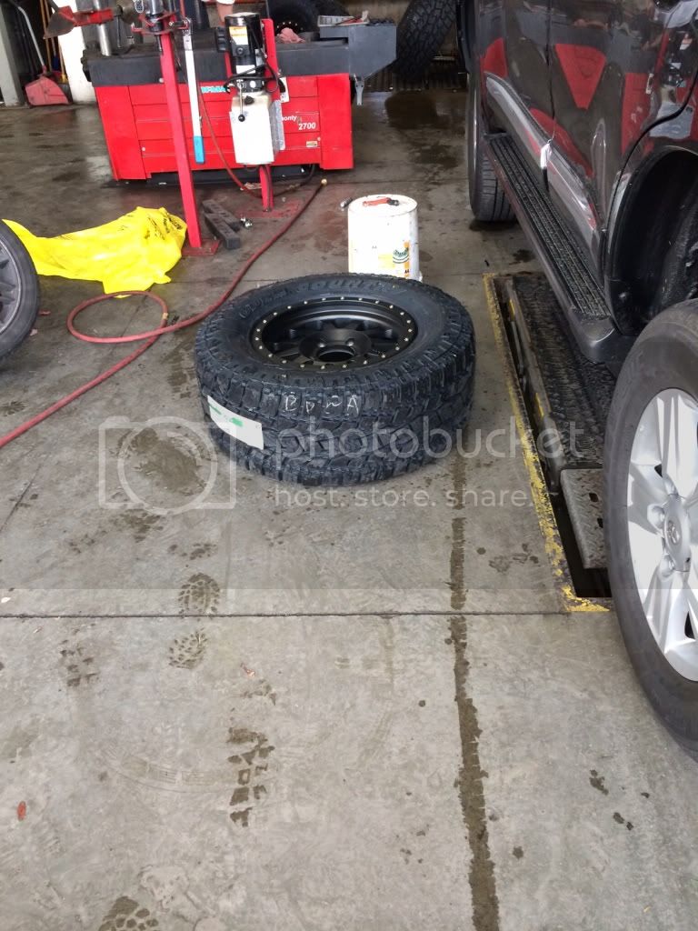

325s require more than trimming plastic. Need to concede. Have some feedback on a southern Cali vendor to avoid. More to come.
Hey. Chim
18 x 9
25+
33.3
13" section width
325/60
Icon front 2.5"
Ome rears shocks springs
Did you install the wheels? If so, where was the rub, this size seems quite close (as in may work, but with some concessions).
The wheel and tire combo is probably too close to the UCA, which will cause rub. The other issue is the tire rubbing the front quarter panel behind the front wheel (nothing you can do as far as trimming in that area once the mudflap is off, it would look ugly and butchered).
They should be ok in the front given you trim up the inner splash guard. I had to with the following:
18x9, -12offset with BFG ATs 285/65/18
Unfortunately these rigs with the IFS aren't really compatible with wide tires. The biggest I ever had on were General Grabbers in the 33" size on 17" wheels. They were about 12.5" wide on TRD rims. Nice set-up, but about as much as you could squeeze under the front with a 2" lift. Great tires...until the snow fell.

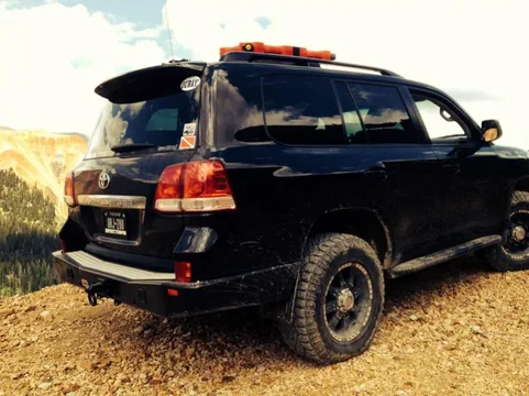

The following link to an image is for the Lexus Baja truck...he has either 34s or 35s on and has done some significant trimming for them to fit in the front. Unfortunately there is no other way. Have a look closely at his front quarter panel and specifically in front and behind the front wheel.
http://www.houseofjapan.com/auto-moto/building-joe-bacal-lexus-lx-race-truck
By the way...love the Method rims!
I wonder if those method rims will fit a 100 series. They are great looking.
They are at their aesthetic best wrapped with bacon
In all seriousness, so long as the 100s have the same bolt pattern (5x150) you should be fine.
Honestly, if I didn't use such wide tires, I'd want a bit less offset as I like a bit of poke for a bit of aggression. Else with 285s I'd be sitting pretty flush. 18+ would probably be max I'd go for on a 9" wheel on the 200 series. Anything less is too narrow in my eyes. Not sure how spacing goes on the 100s. Sorry!
The methods balanced nicely. One of the fronts required zero weights.
