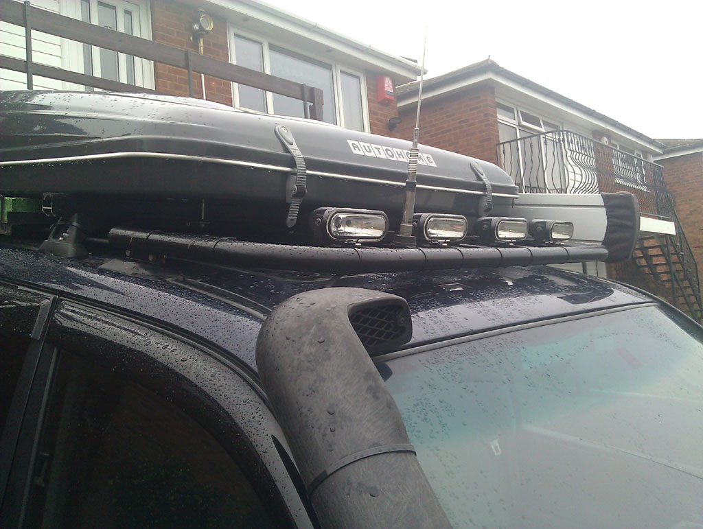

I wouldn't mount the lights too far forward or they'll light up the top of your dash and make it hard to see! Hella make some nice slim rectangular lights, FF-75 I think is the model number I'm using.
My wiring goes up the A pillar alongside the snorkel and I just used bullet connectors so it's possible to remove the light bar without cutting but I don't expect to be doing that very often, not until the next time I change my mind about what to have up there :)
Edited to add a couple of pictures:

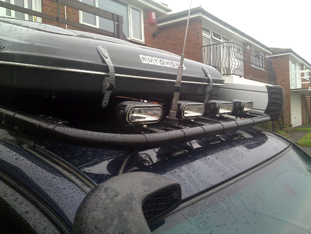

Set back quite a way from the screen to minimise lighting up the dash and bonnet.
I don't have OEM rails as you can see but this light bar mounts to the forward OEM mounting point.
The yellow arrow is where it mounts, migh make it easier to compare to yours like this:
From what I remember of the OEM rails the front foot has the bolts quite accessible once the cover is off. I wonder if you could make a bracket to pick up on those and fix your light bar to there?

Not through the snorkel, just zip tied to it and positioned between the snorkel and A pillar. I drilled a hole in the plastic panel that sits between the windscreen and the hood with the wire passing through that into the engine bay.
It's just some 1.5" tube bent and some legs I made. There's black gaffer tape surrounding the foot where it goes into the channel to bolt to the roof, that might be making it look more smoothly profiled than it really is ? Cuts out a surprising amount of noise having that bit smoothed out by the tape. The mounts rearward of that are Rhino feet with Rhino bars for the RT to sit on.
