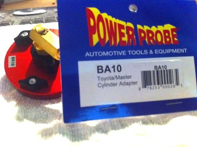

Good day. I have a 1999 Land Cruiser and wish to know if anyone out there knows the proper fitment model number for the Motive Power bleeder. What size should fit my application. I tried getting info from company website but its all over the place.
Any help with your experience with this product is appreciated.

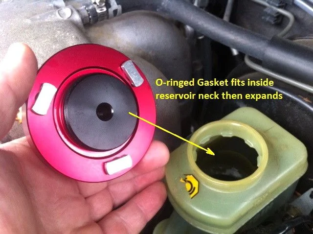

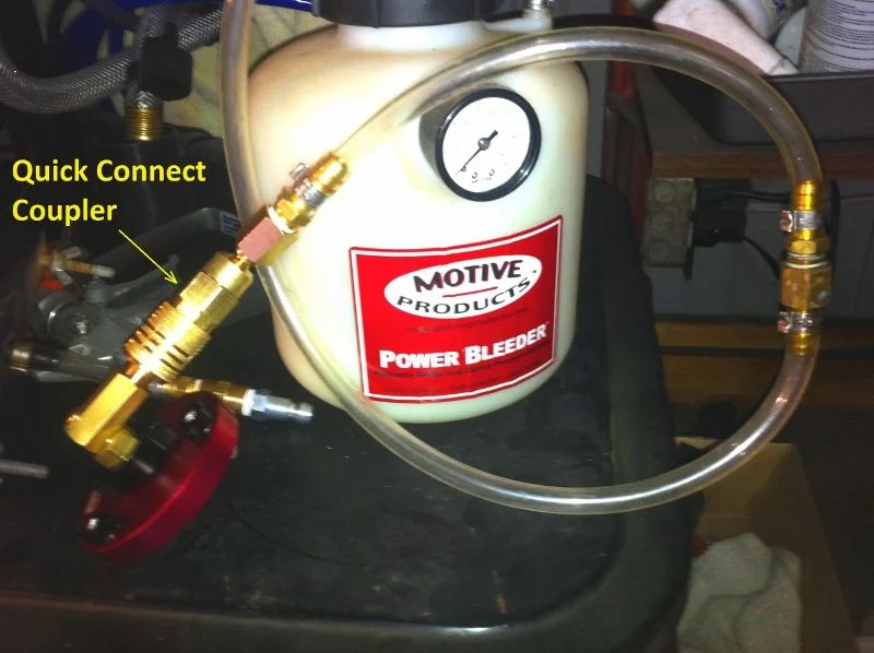

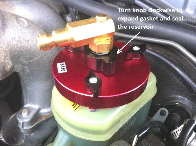

Will fit the reservoir of either the 80 series or 100 series.
