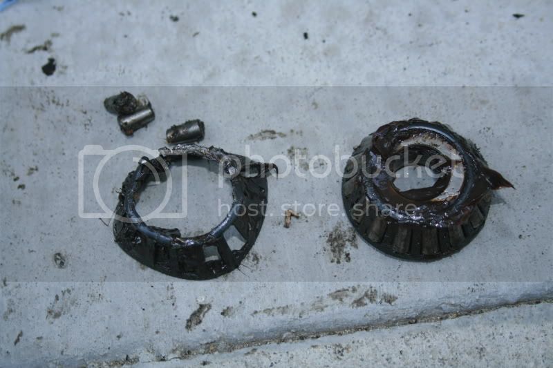

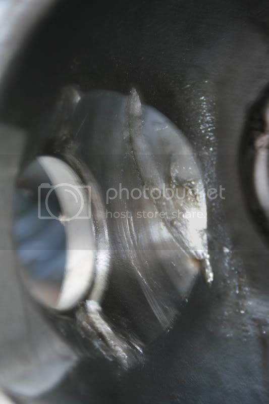

The knuckle was pretty torn up inside with gouging on the top and bottom where the bearings meet the bowl. If the bearings were eaten up on the top and bottom of the knuckle does that tell me something I should be aware of like improper alignment which may affect seal and bearing longevity? Maybe I need the SST to make sure the shims are doing their job correctly?

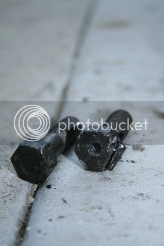

I talked to a guy at work here today and he said I should buy an extra socket and turn it down a little to get it to fit between the caliper housing. I’m going to try that before doing anything more destructive like welding a bolt to it to get it out. Worst situation is a broken socket and wasted time.

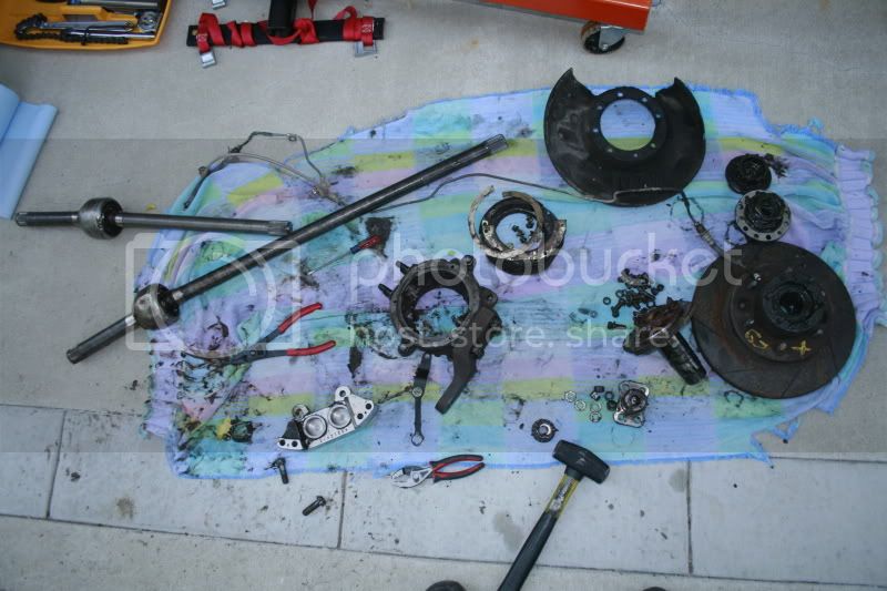

Rear axle disassembled

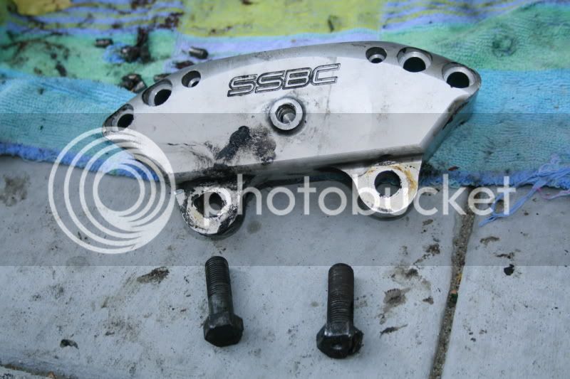

The SOB caliper that was impossible to get off due to an oversize hex head.
As you can see I prevailed with barbarian tactics

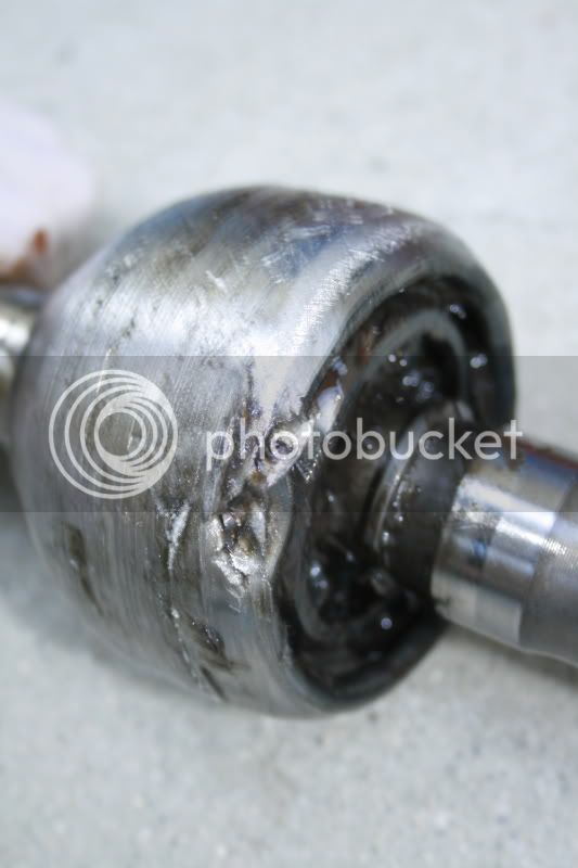

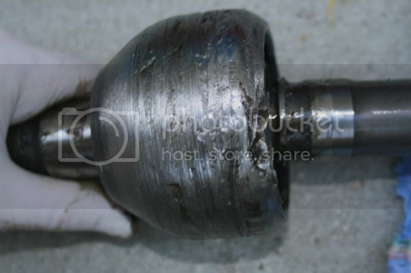

questionable birfield
comparison
long side looks good
short side has some gouges
good side vs bad side bearings

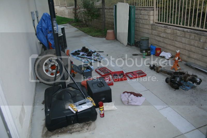

the teardown
not sure how to get these apart without whacking them yet:

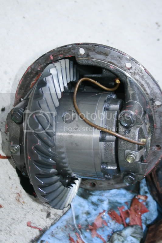

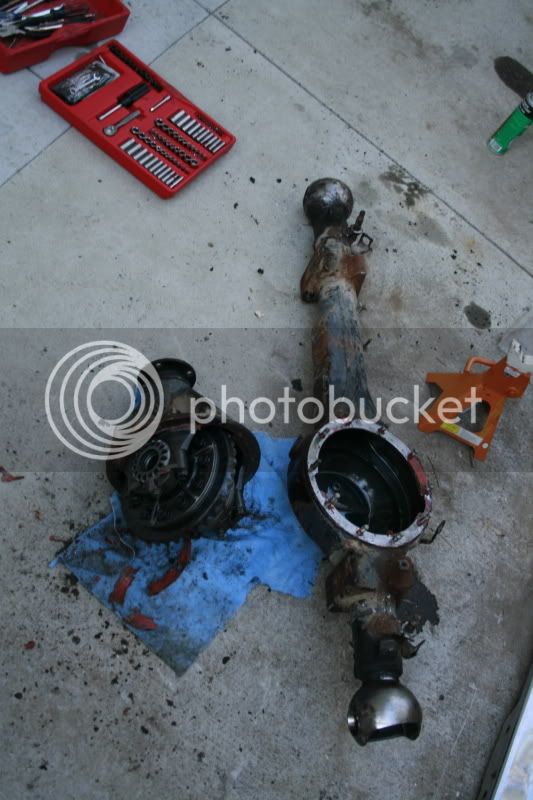

front ARB diff looks good compared to the rear
rear

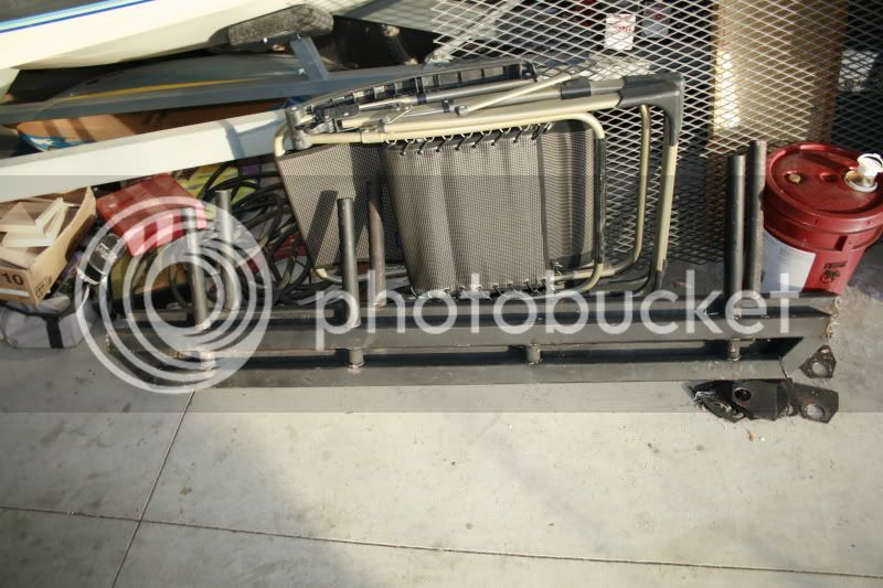

sliders waiting to go on after SOA
my humble workshop

What I have read of doing (in mini-truck circles), but have never actually done is to use a piece of tube or pipe that fits over the axle shaft and supports the inner race of the Birf. Slide the axle down into the tube/pipe and holding the tube/pipe in one hand and the stub of the Birf in the other whack the assembly against a piece of wood laying on the ground. Keep the web of your hand out of the intersection of the Birf and the tube/pipe. That hurts like a sumbeach!!!!
Wow those birfs are toast!
Looks like you might be able to run an allen bolt on there instead of the hex head?

you mean one birfield is toast. Not both right?!
Yes sorry just the one.

To remove the birf from the shaft:
Take a piece of 1.75" or similar tubing. Then insert the inner shaft into it and drop it on a piece of wood.
Does it wreck the spring loaded clip in there? I'm assuming that's the only way?

What prep can I do to the axle housings while waiting for the regear and parts? Other than trim off old perches. I don’t want to paint it yet as I need to weld perches and do CnT.

Not exciting but you can always clean stuff up so the paint sticks when you do spray it.
You could also separate your spring packs and repaint them. That would be good anyways to see if any of the leafs are broken.
You could grind off the old shock towers up front.

You could get scab plates ready for your sliders
