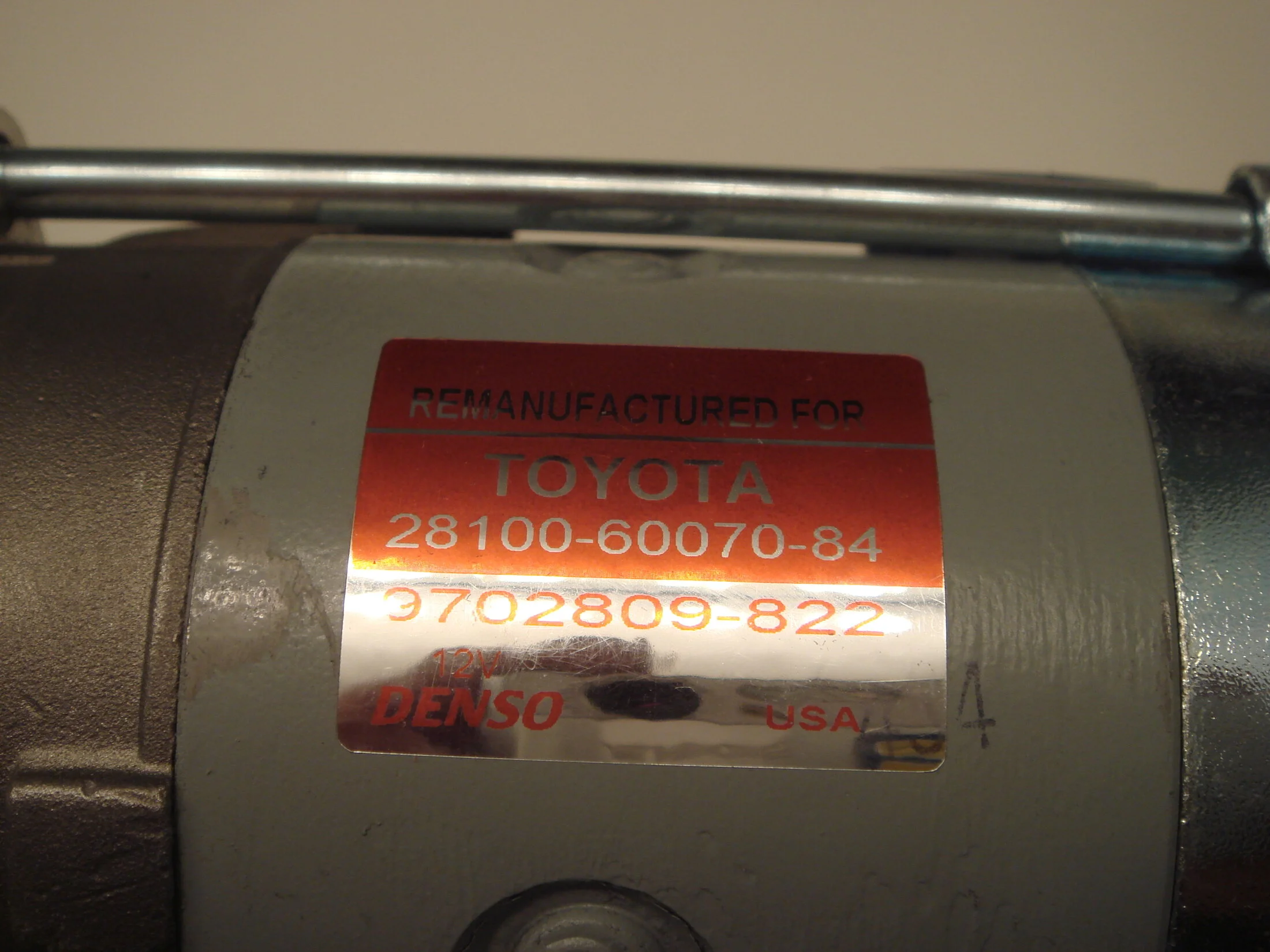

I've got the same issue. Replaced the starter with a remanufactured one from Toyota and no change. Replaced the grounds, positive lead from battery to starter, and battery clamps; no change. Convinced myself that maybe I got a bad starter out of the box, so replaced the starter a second time; no change. All that's left is the ignition switch and the signal wire... Will troubleshoot that next once it warms up a bit here in the northeast.

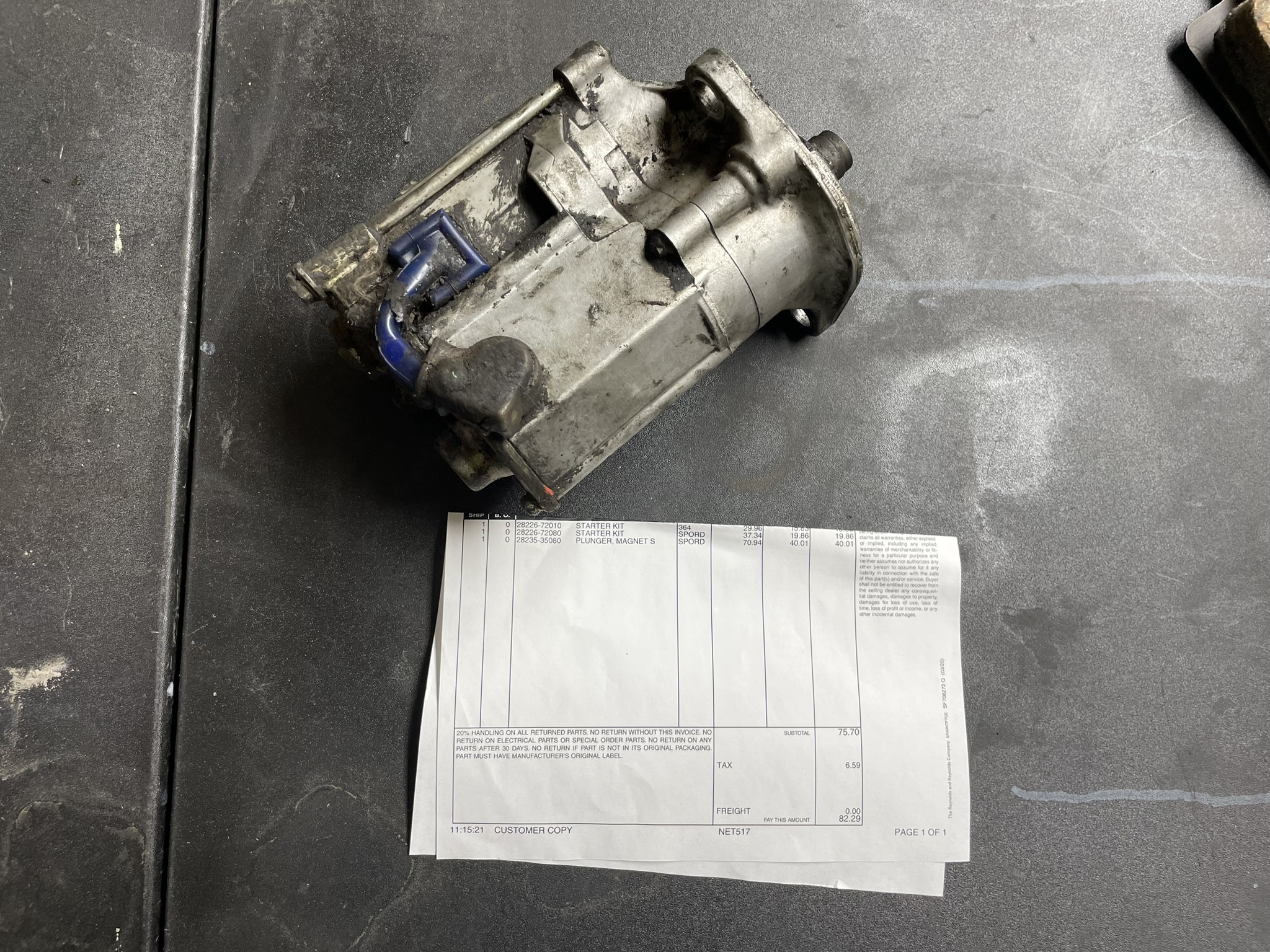

update: had a chance to test the starter this morning. unplugged the starter terminal wire and connected a long wire with the same connector (a female spade) to it. then touched the other end directly to the battery positive. it clicks about 75-80% of the times i tired, the other ~20% is turns over once and then stops turning. this has to be a bad starter.
planning to order a gear reduction starter replacement, i have read that the wiring is slightly different for those? any tips or recommendations for a different starter?
My vote is to get a Toyota remanufactured starter
Rebuild your starter and you already have a gear reduction starter; GR starter is OEM on the 60 series.
