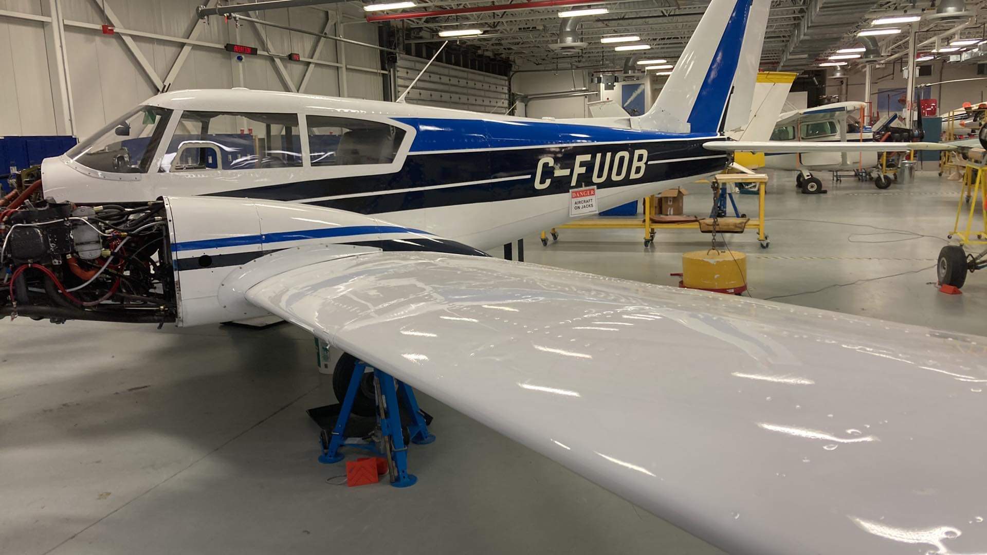

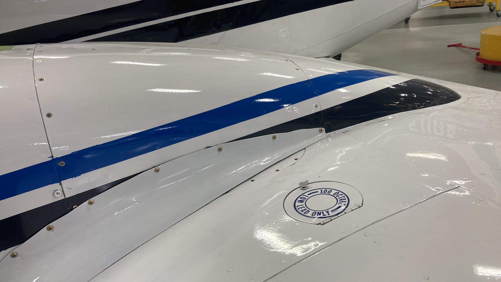

If protection from further deterioration of the truck is your requirement then you can roll a 2 part paint and if done correctly will yield amazing results!
This aircraft was painted with Interlux Perfection. Rolled on with 6” foam rollers, 2 coats with a light sanding in between coats.
The whole process is pretty straightforward and easily accomplished.
After removing necessary trim, lights etc a thorough cleaning is required.
Step one is washing the truck with 1 part liquid tide to 8 parts warm water. Use medium Scotchbrite as a rag to wash and scuff truck. This will remove grease wax etc. Thoroughly rinse and don’t let the tide/water solution dry. Wash/scuff complete truck 2 times.
Next is to feather any really bad areas and if necessary prime with appropriate Interlux compatible primer for the Perfection.
Finest grit required before application of paint is the burgundy Scotchbrite.
Thoroughly dry truck. Wash with a surface prep from Interlux with the wet rag dry rag process.
Apply paint with roller, go lightly, do not try and get a super heavy coat. Do not roll back into the paint after it has been on the surface for more than a minute.
Let dry overnight. Wet sand with 320 grit paper to remove surface dust contaminates. Dry and apply second coat.
If your not happy with the finish apply third coat after wet sanding with the 320 grit.
Enjoy an extremely tough finish 🍻
