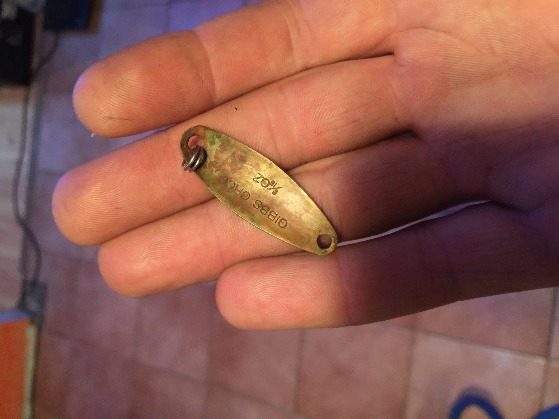

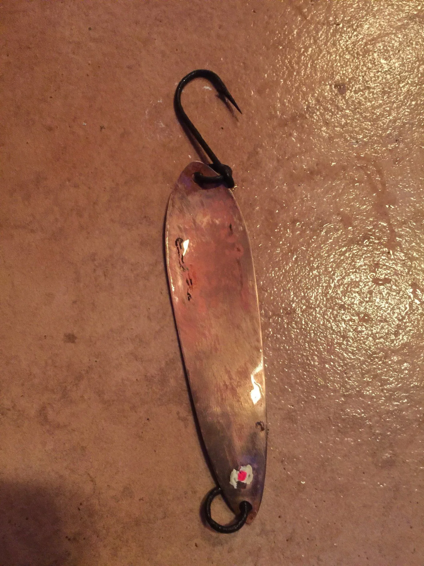

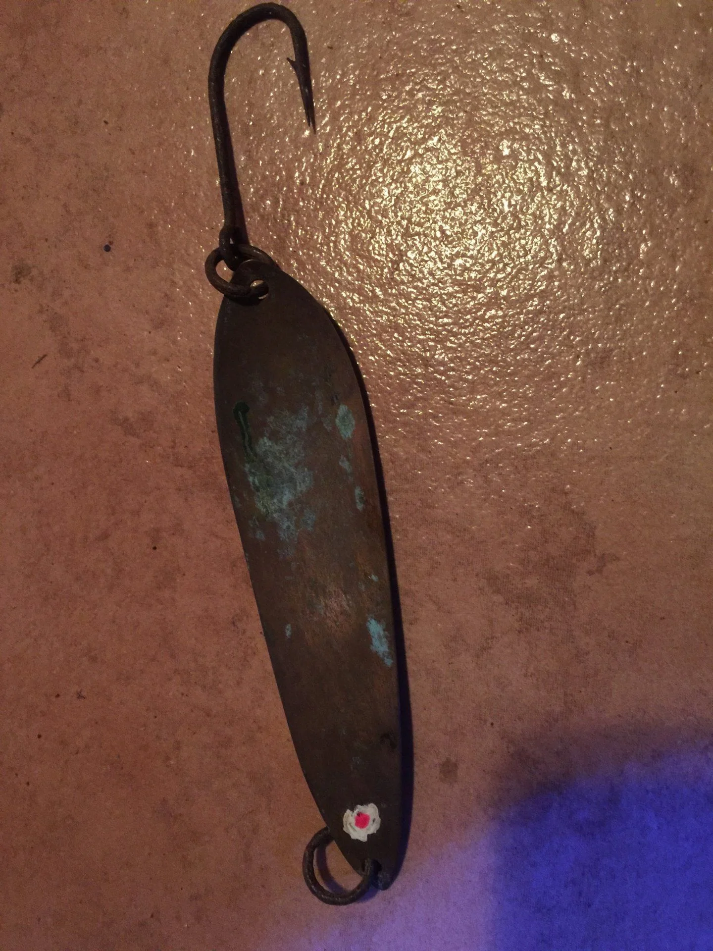

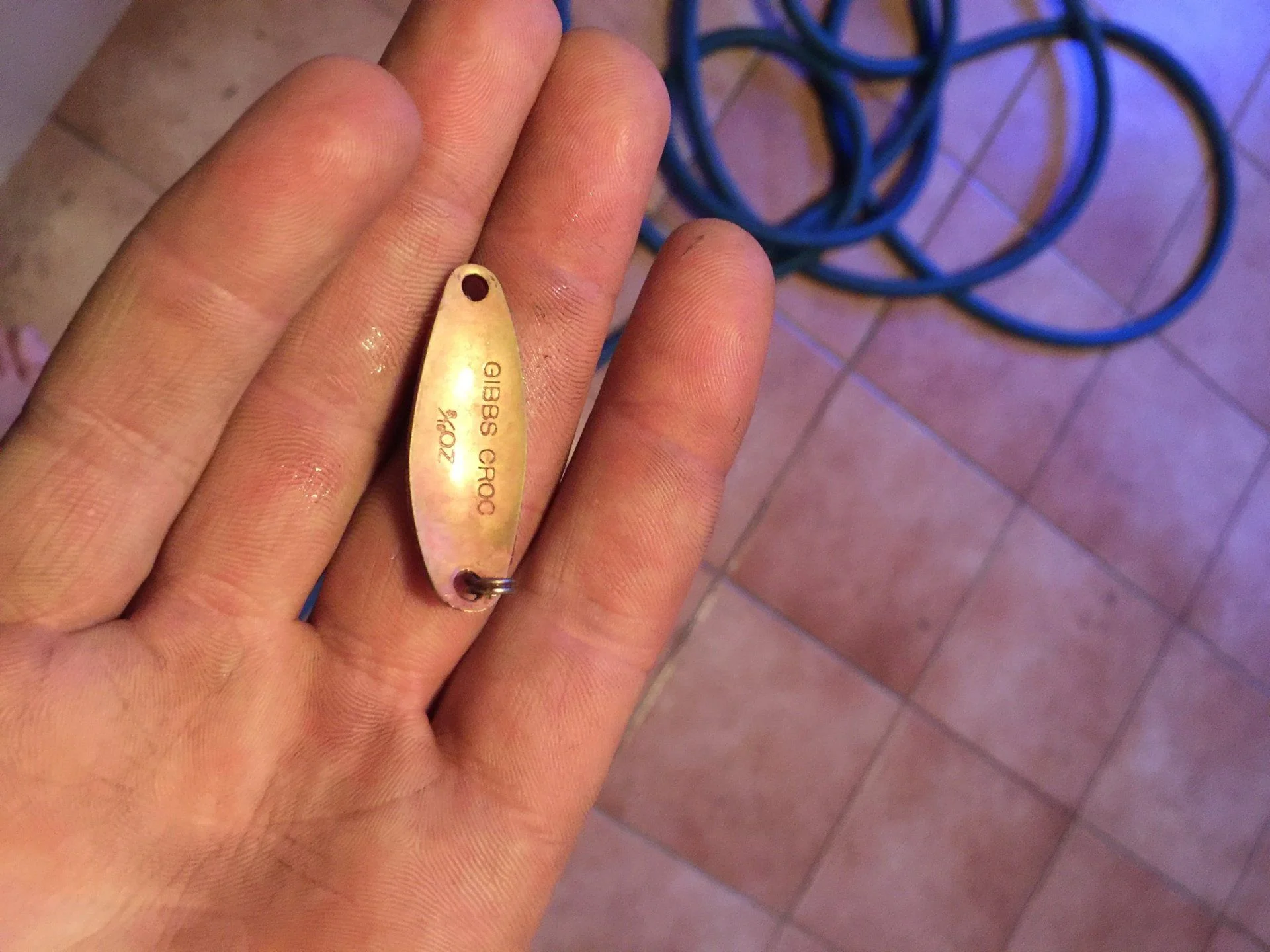

here is some copper i experimented on and what it looked like after two weeks with no scrubbing

View attachment 2255323View attachment 2255325View attachment 2255322View attachment 2255324
