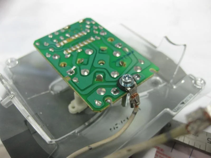

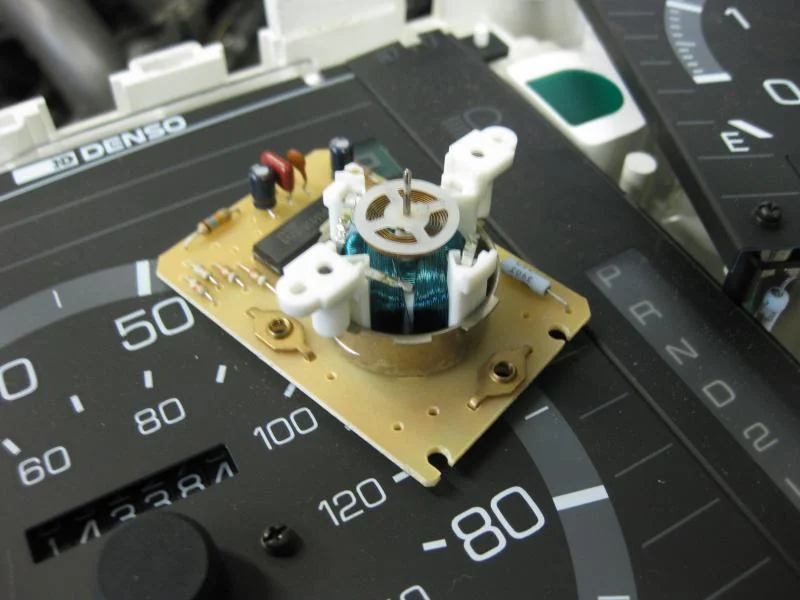

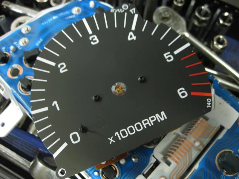

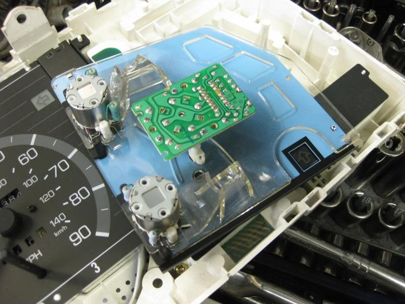

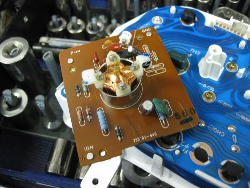

First I disassebled the stock Fuco Tach. The needle slides right off the front. Then I removed the two screws holding the face onto the tach electronics. Basically separating the guts of the tach from the face. The tach only needs three things to operate. +12V power, +12V tach signal from ECU, and -GND from ECU.

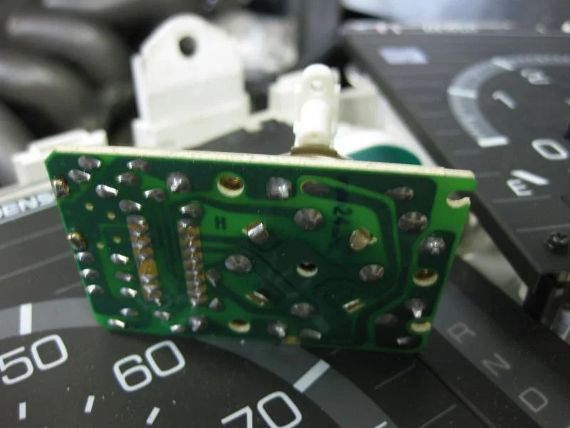

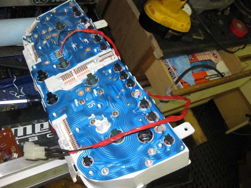

Another picture of the circuit board, and a rear shot of the Fuso cluster where the three holes pass through that hold the tach assebly into the cluster and transfer the signals from the curcuit paper on the back of the cluster in to the actual tach electronics. You can see that they're labeled. TA+, TA-, IG+
I then attached the Fuso tach electronics to the LC face. The holes almost lined up perfectly. Used a small drill bit and ovalized the holes a hair, then screwed it together.

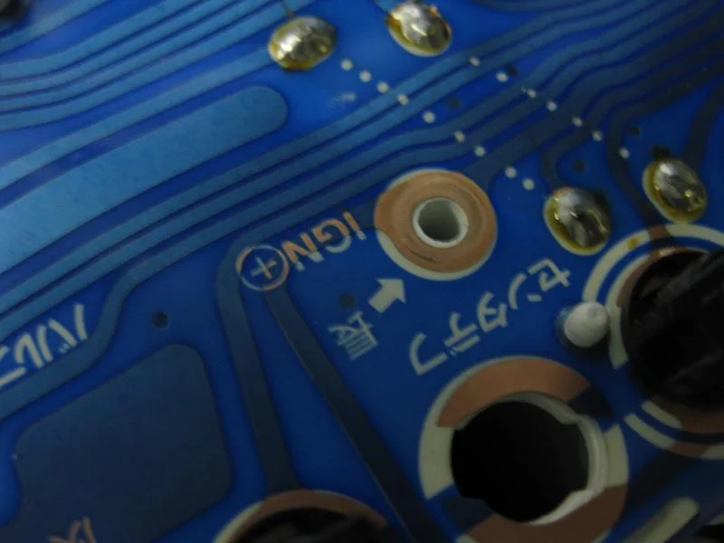

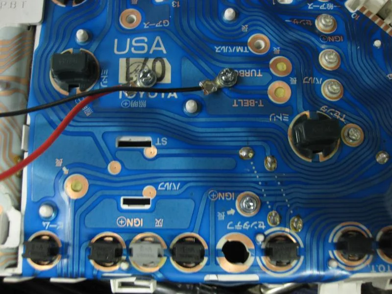

The bottom mounting point on the LC cluster is +12V, so I used a small lead of wire to connect it to the Fuso tach circuit board.

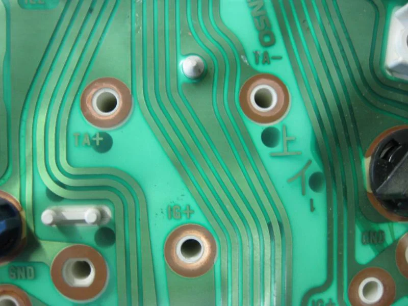

I then took some measurements and drilled two holes striaght through the circuit paper and cluster plastic on the LC cluster. Fortunately one landed where there were no traces, and the other came through where the turbo diesel's timing belt light trace would be. I screwed straight through the cluster into the Fuso tach circuit board just like the OEM setup. The screws cary the signals straight through. I used some crimp eyes to attach wires where the screws went through.
These got hooked to the Fuso ECU's TA+ and TA- connections.

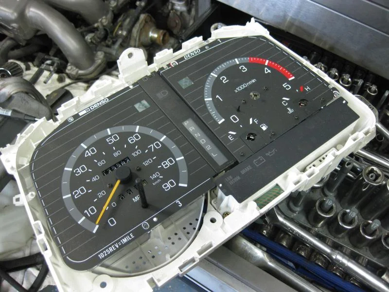

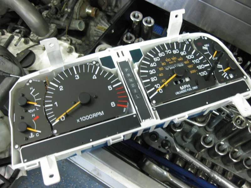

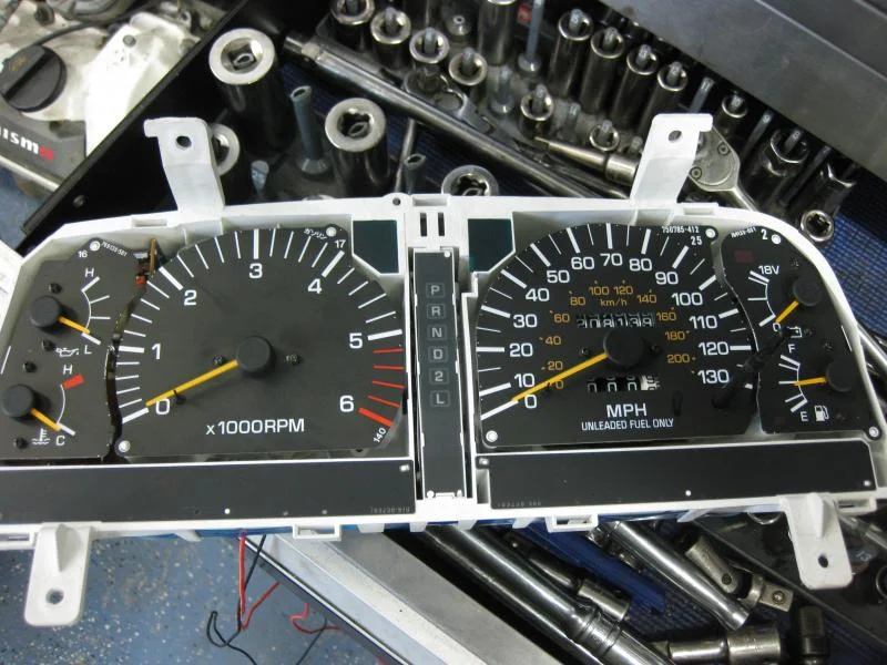

Finished product, works perfectly!!! Even the radial alignment of the RPM values are spaced nearly identical. So while it is not 100% accurate, it is pretty darn close. Doesn't get much easier than this, and it was free since I had all the parts from the donor truck.

UPDATE!!! (11/29/11) Needle Installation
You MUST install the cluster and put the key in the "ON" position BEFORE installing the needle. The tach will "zero" itself when power is applied, failure to do this will result in improper needle placement. In my case, I installed the needle at "0" and installed the cluster. When I powered on the truck, the needle shot to 1600RPM with the truck off. Obviously this wasn't right. So I removed the cluster cover, needle, and then put the key in the "ON" position before installing the needle in the "0" position.
I then ran into the following problem:
This is fairly important. The 0-1k RPM section of the LC tachometer uses smaller increments than the rest of the tach. The Fuso tachometer is even spacing for all increments. So installing the needle at "0" results in the tach reading 300RPM high everywhere above 1000RPM. This was verified by doing the math for appropriate RPM readings for indicated speeds while the converter is locked.
How did I fix this? I installed the needle at what looked like 300RPM BELOW the "0" (Yes, UNDER the stop pin). The needle has enough flex to allow it to be "convinced" over the stop pin to the zero position after installation. The result? The tach is almost 100% accurate above 1000RPM, and reads a little low at idle (shows 700RPM at idle, where the dealers MUT-II tool showed 750RPM). I still feel this was the best possible approach to solving the tach issue in the 80 with this conversion. It has been working flawlessly for 1000+ miles.
