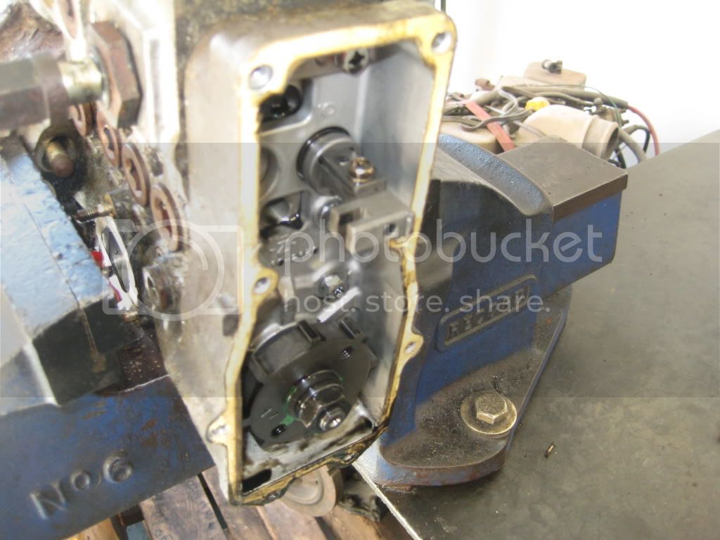

From the pictures it looks like the ECU only has control over engine fuel, not injection timing. So power is certainly controlled by the ECU but economy not so much.
Look again there Dougal...
The MD-TICS pumps control timing by moving the control sleeves up and down, effectively altering the point at which the injection event happens. So the governor moves them side to side and the prestroke actuator on the front of the pump moves them up and down, changing not only the injection time, but also duration.
Pretty difficult to see, but I'll take your word for it. Does this pump have a timing device on the drive gear or does the electronic adjustment have enough range to not need that?
Pretty difficult to see, but I'll take your word for it. Does this pump have a timing device on the drive gear?
define timing device..
Springs, flyweights and cams inside the drive gear which retard timing during startup and advance with increasing rpm. 4BD1T's and 4BD2T's have them.
I just remembered your post of a slotted drive gear for timing adjustment. Definitely no timing device in there.
