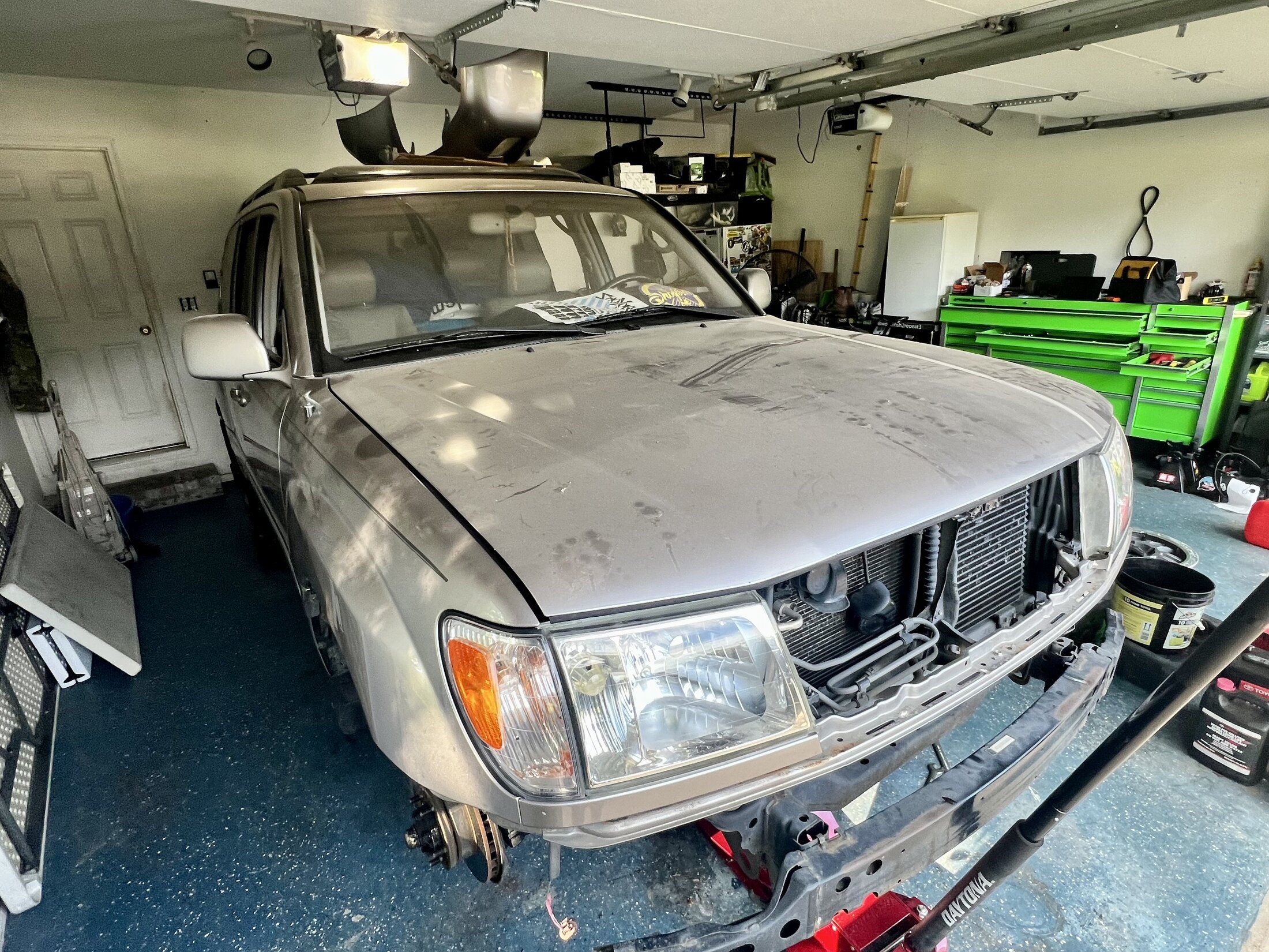

Added a pretty cherry older 200 series to our driveway. The wife’s diggin’ her new ride, so everything is all good.

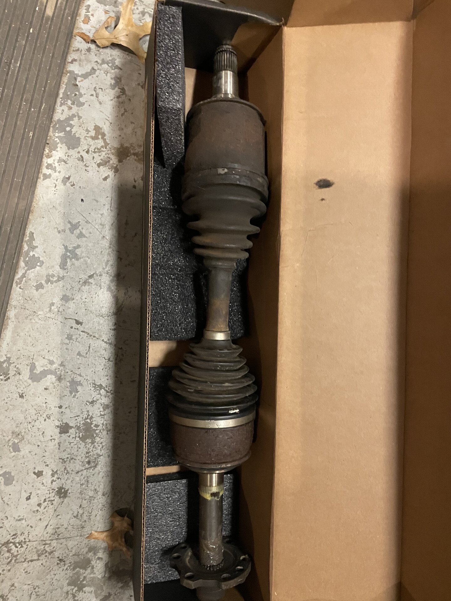

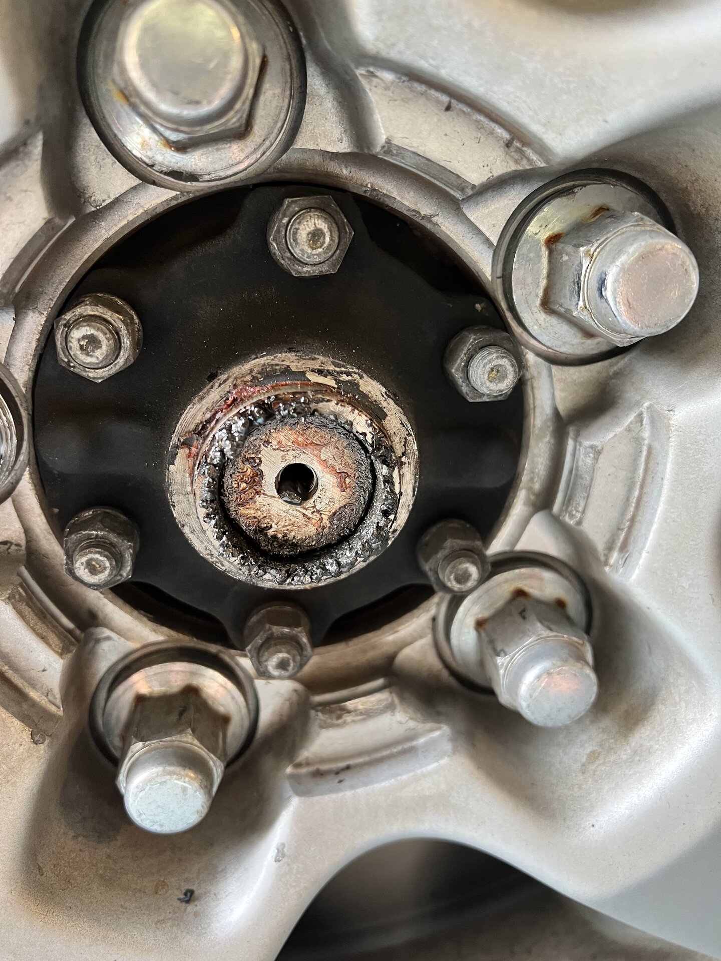

Little bit of work on the 100 series. My son said he was driving and lost power to the wheels. Got the truck home with the center diff locked. Bad flange and CV I guess, retaining ring was in the dust cap. Pulled the driver side today after church and Sunday stuff, time to get some parts on order.
I guess whoever was in here last didn’t have a 54mm socket, nuts looked like they possibly were broke free and tightened with a chisel or flathead.

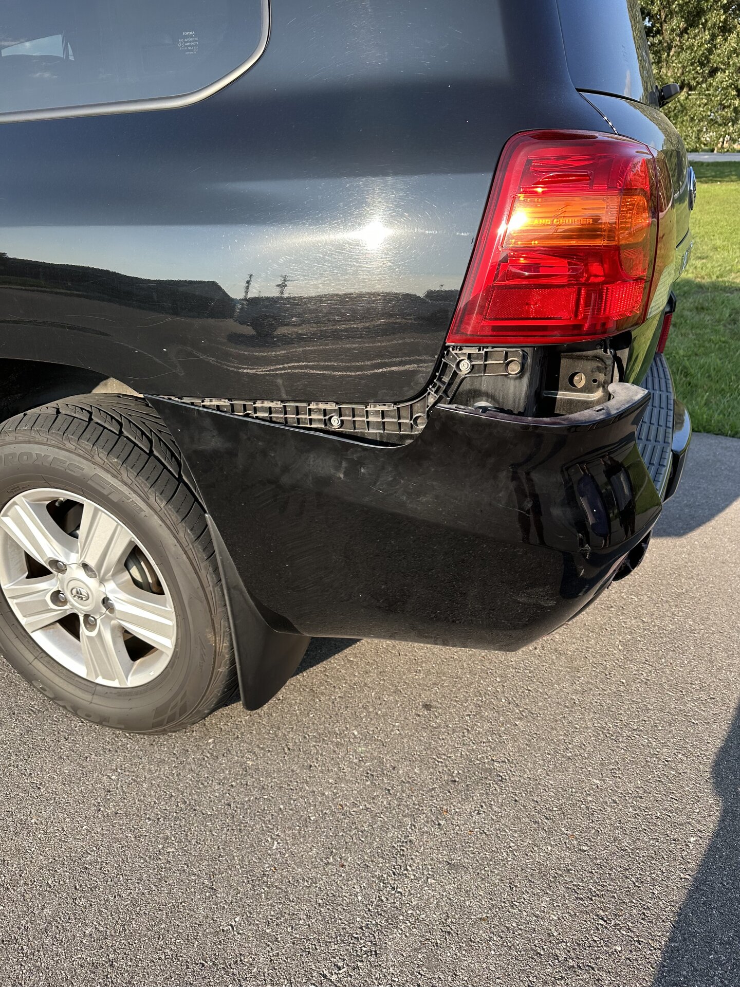

Wife came at me with this on her 200 series.
So I ordered a steel bumper from RLCweldfab.com
The wife isn’t big on the tire carrier, so we asked for it without the carrier. Will pick it up In Louisville, KY when it’s done.

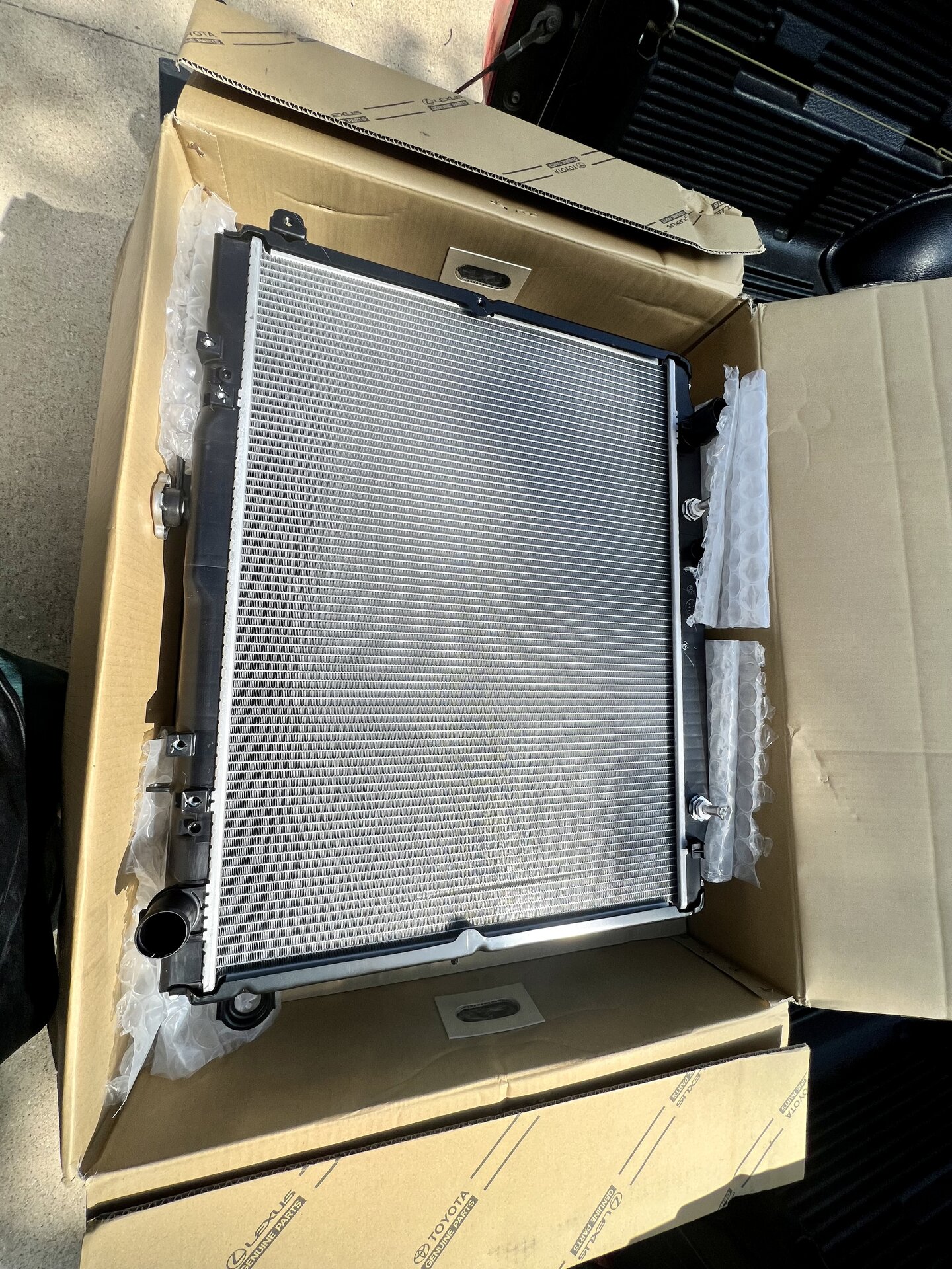

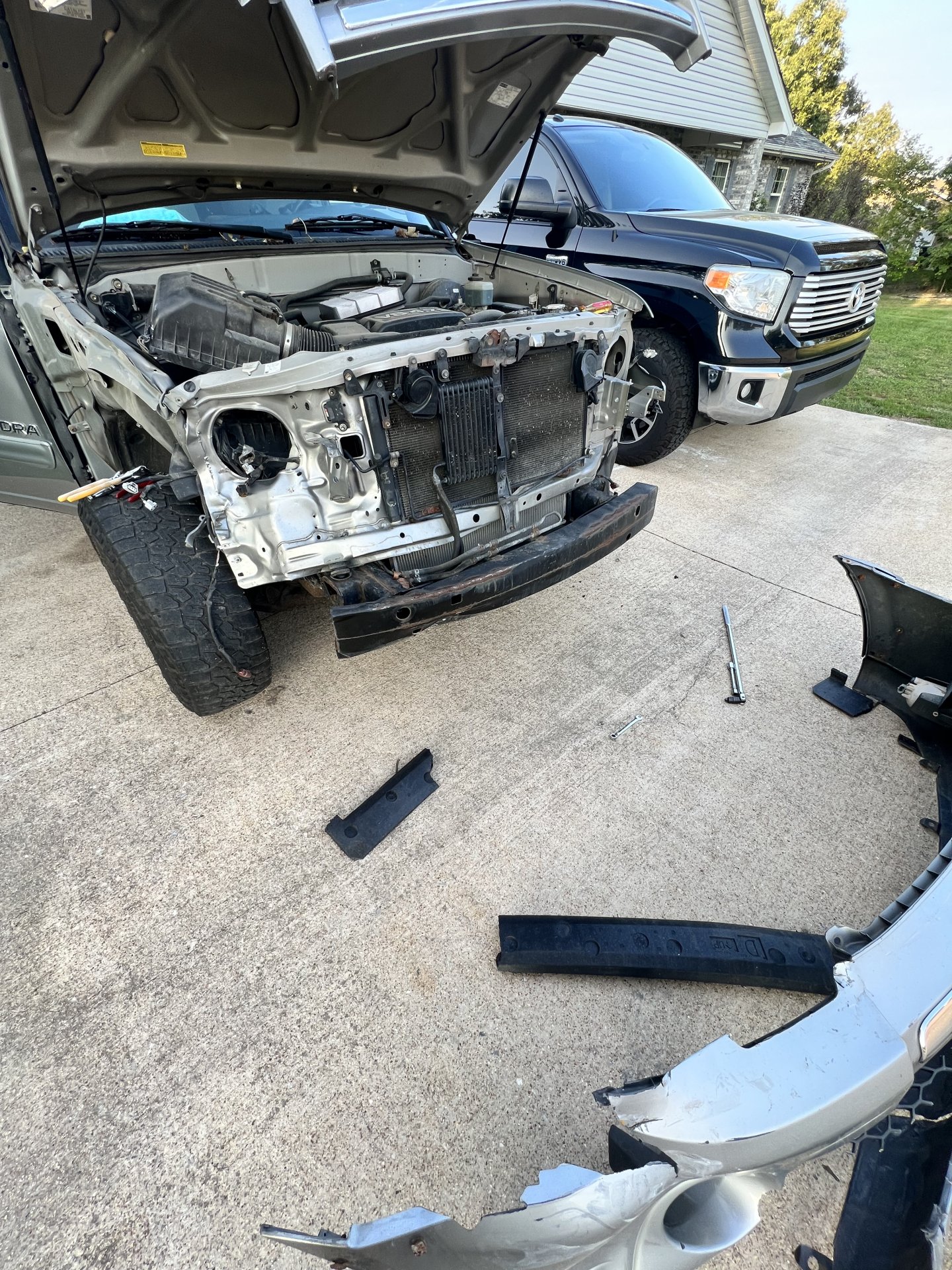

Radiator showed up today, got em swapped out real quick when I got home from work. Got this one on sale a couple weeks ago from the previous Serra Toyota of Decatur sale at 20% off as well. Part number is there in the pics if anyone needs it for reference.Hope everyone is doing good.

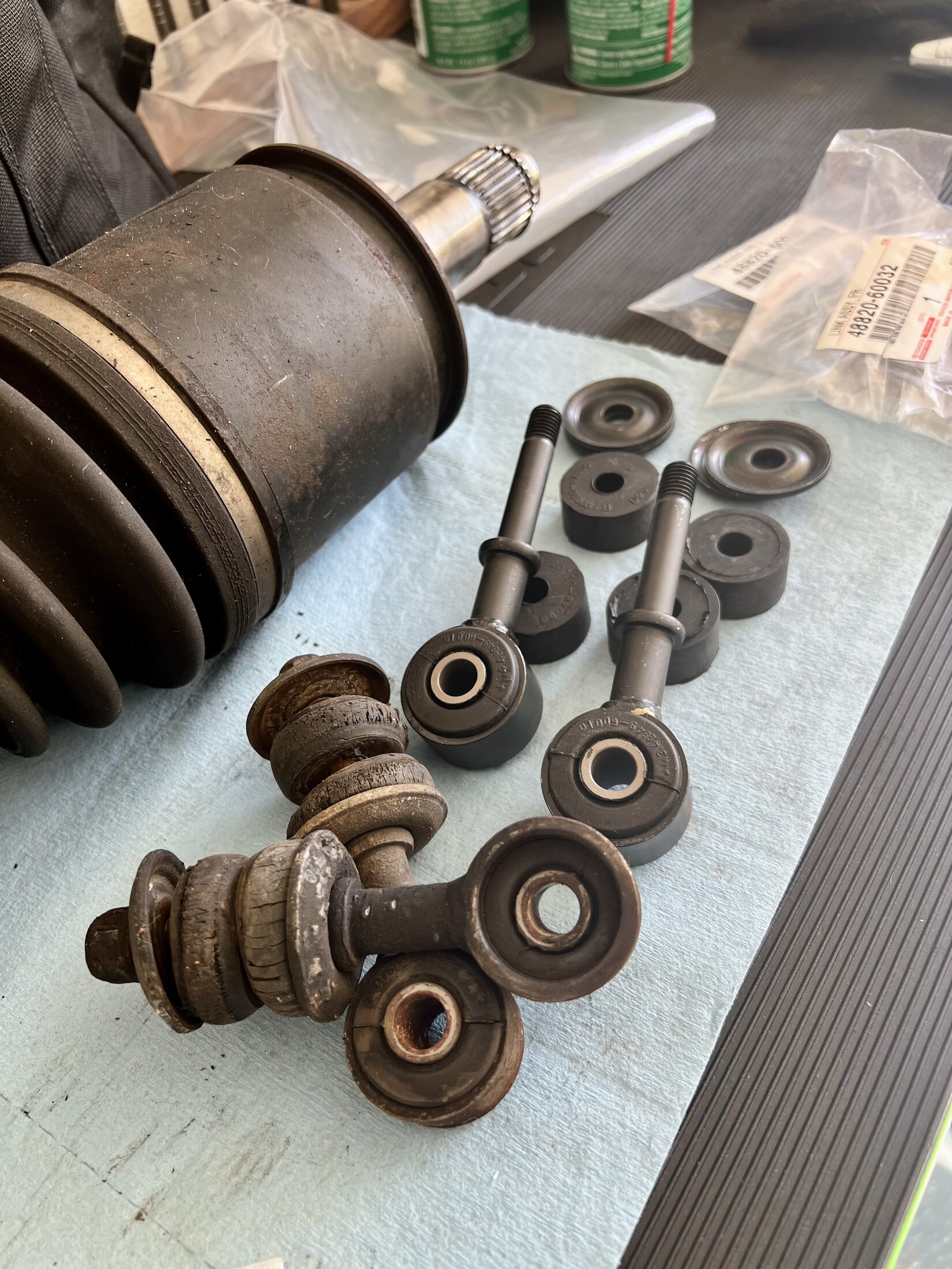

Swapped out some 20 year old front links.
Front Stabilizer Link Assembly
Part Number: 48820-60032
2$41.38
Cushion Retainer
Part Number: 90948-02180
4$27.64
Lock Nut
Part Number: 94184-61001
2$2.26
Shock Absorber Cushion
Part Number: 90948-01003
4$9.28
Bolt with Washer
Part Number: 90119-10765
2$3.28
