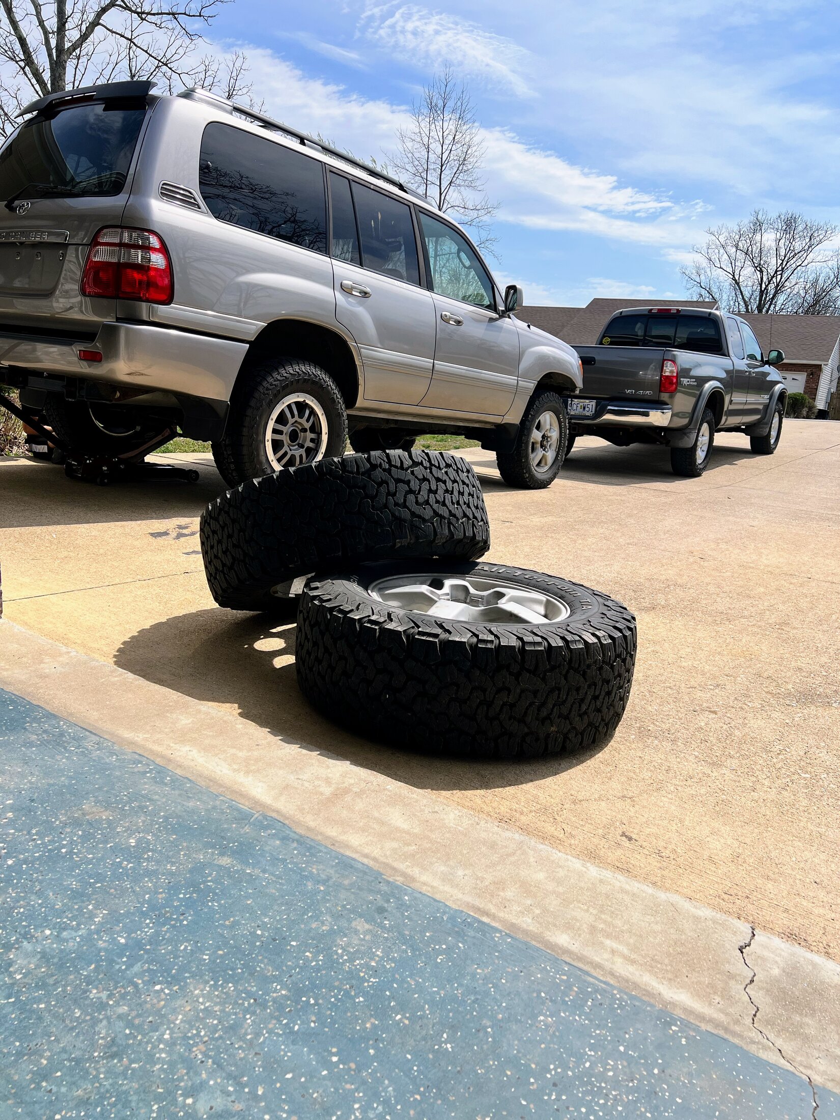

In the spirit of spring cleaning, and wanting to clear out the garage a little bit, decided to make a little room by getting these wheels and tires out of the garage. Had my son get em on the truck for me, since I still cant do much. Rock Warrior Wheels from the wife’s 200 series wrapped in 285/70/17 Falken Rubitreks. Shoutout to @Luke M for squaring me away with the 3/4” spacers.

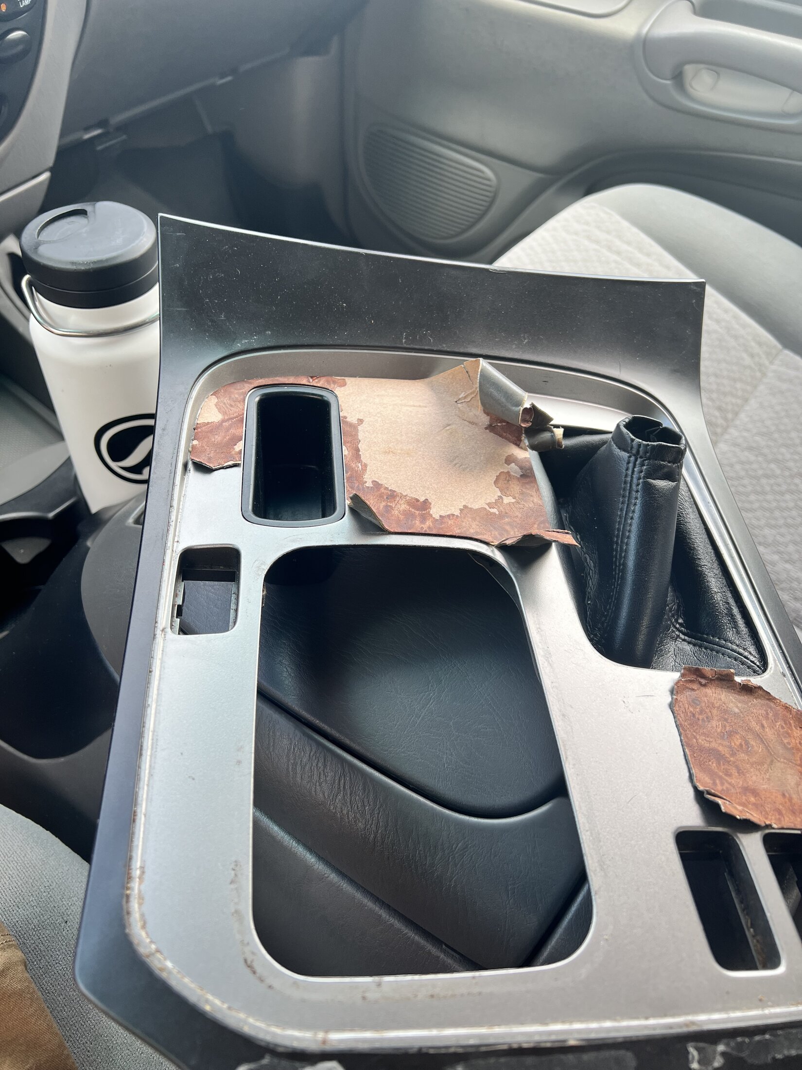

Five minute project. Swapped out the OEM cup holders, in favor of a 3D Printed updated one to hold my 30oz Klean Kanteen. Turns out cheaper eBay products, are not as advertised. It’s just ok, not the best, and will hold my wife’s 40oz Stanley Cup, however I will likely replace later on down the road.
