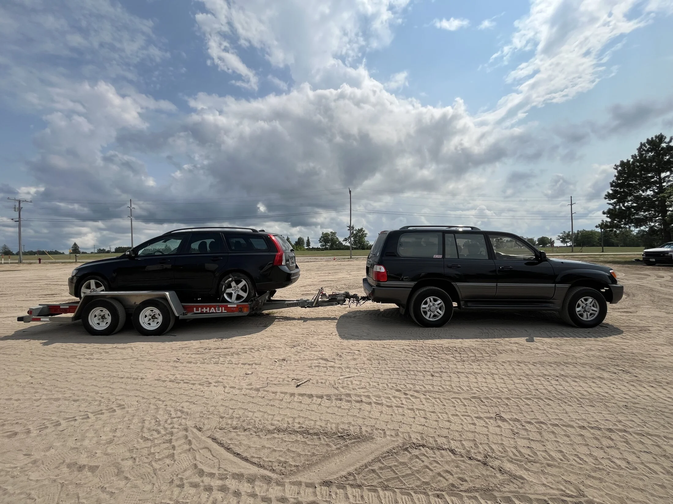

Hi all, everything is fine!! Time for an update/conclusion:
It seems like a bad trailer tire was the culprit. I unhooked the trailer and the vibration stopped. Everything was tight and in proper working order on my LX, but at some point near the start of the trip we believe a belt slipped on one of the trailer tires, or maybe it lost wheel weights? Who knows. That’s U-haul’s problem.
I ended up stopping at a Belle Tire to meet up with one of the technicians there, we got connected through a Michigan off-roading Facebook group. He gave my vehicle a thorough inspection and test drive, then told me his diagnosis (thank you Spencer!!!) Seriously, I can’t thank this guy enough.

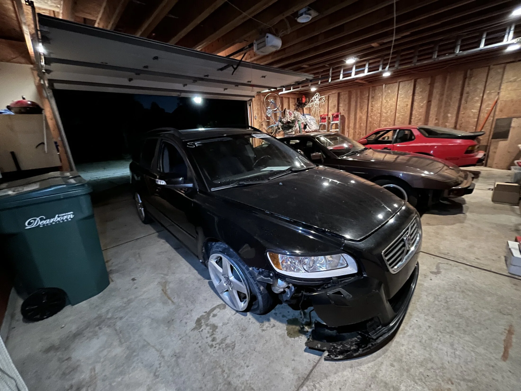

I may have been a bit of an automotive hypochondriac today, but aren’t we all? Better to be safe and cautious than sorry and upside down in a ditch somewhere. Anyways, might as well add some pics of the Volvo project I picked up (the whole reason for this trip) and my first drive across the Mackinaw Bridge! Bonus 944s in the background (those are my girlfriend’s projects)
Lastly, thank you ALL for your comments and input. I’m so happy to be home, with the car unloaded and that stupid U-haul trailer off my hitch. Spencer was a godsend today and definitely earned his good karma. Safe travels and happy mudding!
