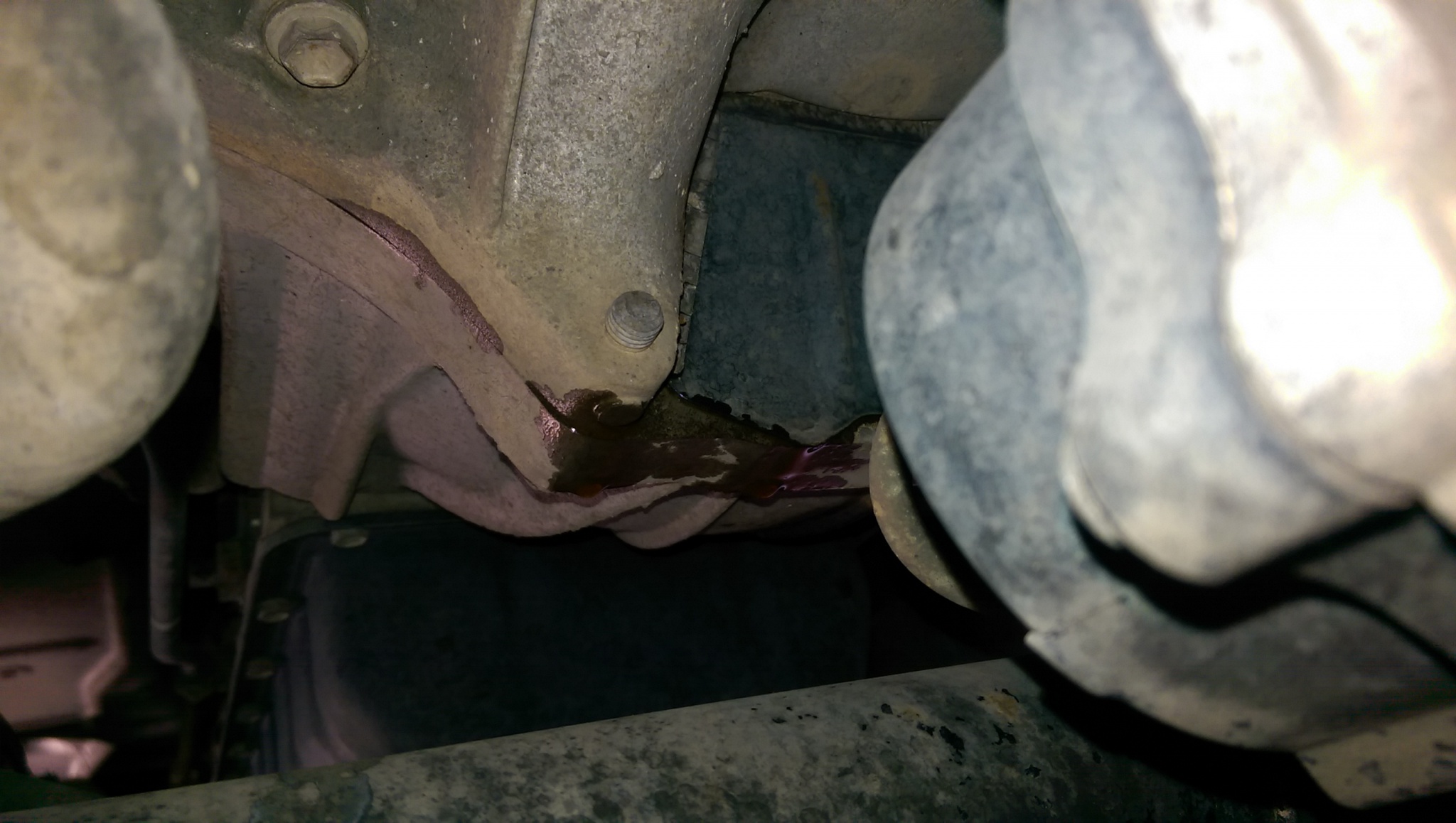

could it be this?
another leak here
could it be this?
another leak here
That is very interesting and could be my problem. Today, I wiped down all the coolant I could find, started the truck and let it get to operating temperature and then let it run for ~20 minutes. I checked for leaks and they only one I could see was at the radiator. I'm going to replace it on Saturday and then pressure test the entire system. If it doesn't pass the test, the intake manifold is coming off. Its much easier than pulling a transmission and checking a freeze plug. I did pull the truck out of the shop and tried 4 high. Does not engage and sounds like two gears rubbing. Very loud and scary. 4 low works fine, pushed hard on the brakes and checked for tranny slippage which I have none. The brakes would not hold back the truck. So my wishful thinking is new radiator and all the coolant that has been dripping from strange places will disappear and the 4 high issue is a simple fix. I will know very soon. Thank you for your helpful suggestions.
A big thank you to fourtrax for finding the above video. That was indeed my coolant leak in addition to the radiator. I removed the intake plenum and there was a pool of antifreeze on top of the engine. The coolant bypass pipe came out with zero resistance. The o-ring was hard and brittle, definitely not replaced when the timing belt and water pump was 50k ago by PO. Decided to replace the contacts and plunger on the starter and was glad I did because they were on their last leg. The removal of the starter is a real PITA. Took me as long to remove the starter as it did to get the intake off, ~ 2 hrs. You need either small hands or long fingers and I have neither. There is a blind bolt that is behind thick wiring harness and zero room to work. I was laying across the engine bay using moving blankets to keep thinks from penetrating my body. I would hate to have to do this out on the trail. Starter rebuilt, new o-ring, new radiator, hoses etc and all is buttoned up and torqued to specs. I removed the TC today and I have it on the bench. 4 low works, center diff works in 4 high and 4 low. 4 high does not engage at all, both front and rear drives spin freely. The linkage was fine externally because I had to remove it and the clip that holds it on. Any idea what I should look for when I dissect it? Do you think it will be obvious? I watched OTRAMM video on youtube twice so I have an idea but he does not go into detail about the shifting and engaging stuff. This is getting fun. Suggestions welcomed.
