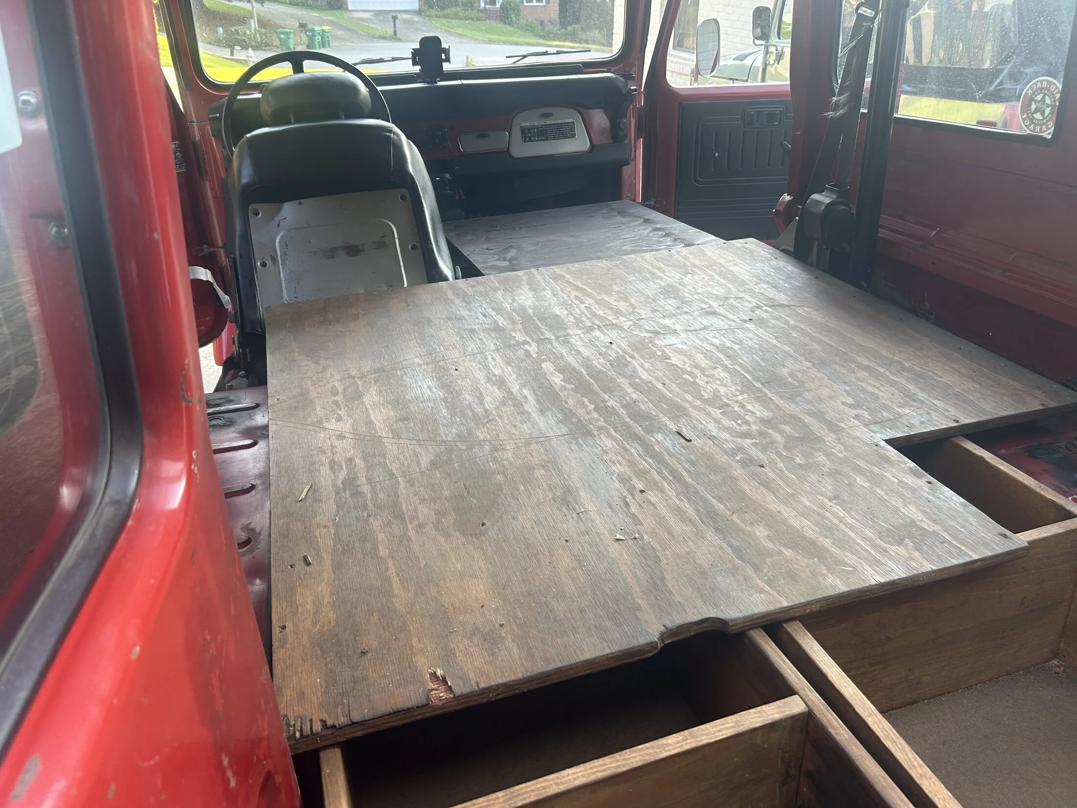

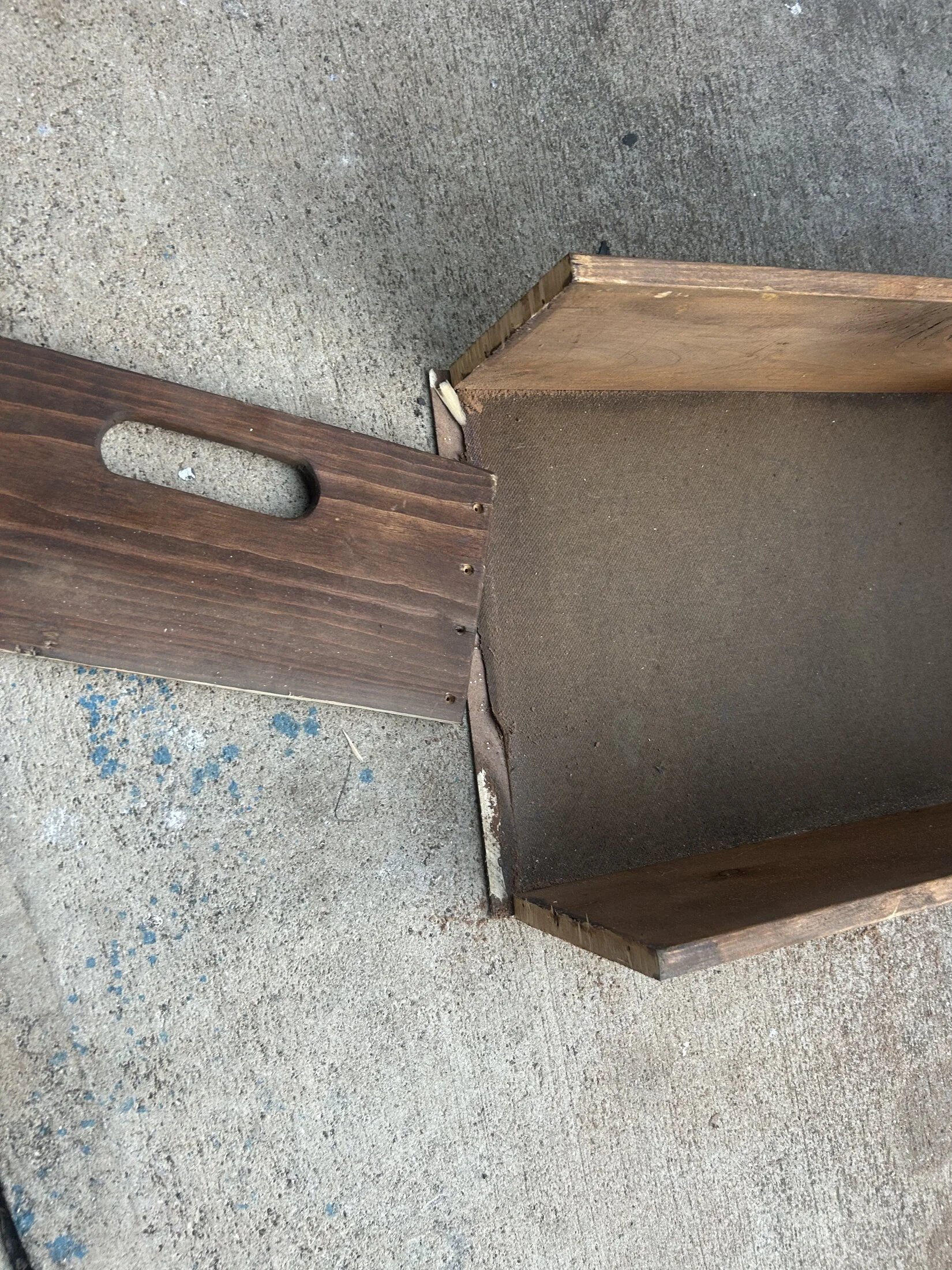

I decided to repurpose the sleeping platform and drawers that I originally built for my dad's Tacoma. He didn’t like them because they raised him too high when he slept in the camper, and he felt claustrophobic, so we removed them. Now, I need to shorten both the height and length to make them fit, and I plan to redesign a few things.
This is not how I would design or build it from scratch if I were creating it specifically for the FJ40, but since I already have all the materials and it’s partially built, I’m going to make it work without incurring any additional costs.
If I find that I like this setup, I may eventually rebuild it from scratch.
I am planning a seven-day trail and camping trip on the Georgia Traverse with our YOTA Atlanta club in October... so I am preparing for that. I’ve removed the back seats to create more space since no one ever sits there. I will fill the drawers with camping supplies, including my stove, spices, utensils, camp chair, and stuff like that.

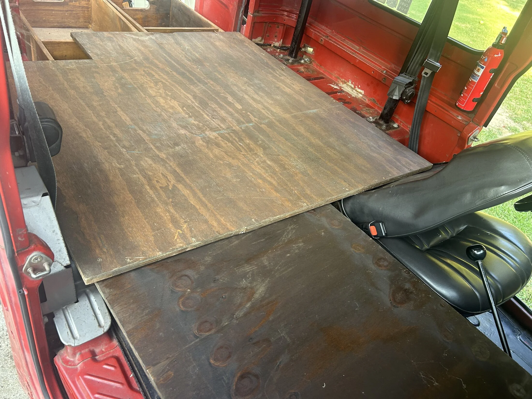

I plan to build a platform covering the back area and will add a removable section that extends the platform forward (see below) for when I take off the passenger seat back for sleeping. It is quick and easy since it is only two nuts. I will take it off, put the extra board in, and I have a camping mattress that will allow me to sleep comfortably in the vehicle. Since I am 6'2", I’ll need the extra room to stretch out. All my camping supplies will fit in the drawers, while my cooler/fridge and Bluetti power station will be stored on the driver’s side. It should be pretty cool!
I'll post more pictures once I finish building it and everything is set up!

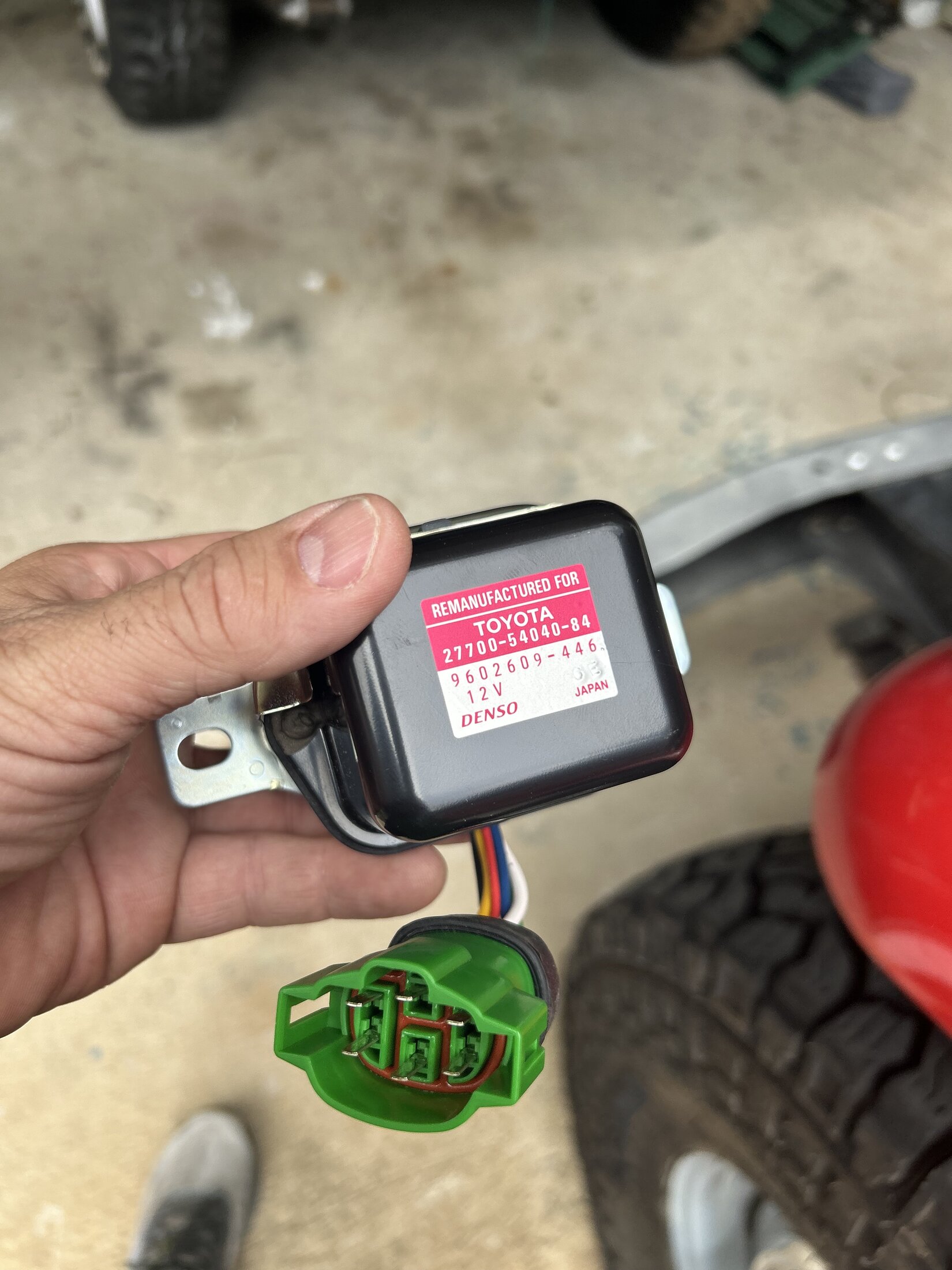

Issue one: My 1978 FJ40 ran great until one day it wouldn’t stay running without the choke on. I was familiar with this symptom and thought it might be the throttle idle solenoid in the carb.
Step one: I checked the fuses under the dash. Sure enough the engine fuse what blown. I replaced it with the correct 15-amp fuse started the car and the fuse blew immediately again and the rough idle continued.
Step two: I unplugged the voltage regulator, replaced the fuse and the 40 ran great so I felt confident that the voltage regulator was bad.
Mistake number one: I made the rookie mistake of ordering a 1978 voltage regulator from the Toyota dealership without confirming the image with the one I had and checking on the month that the 1978 FJ40 was made. Therefore… I ordered the wrong one. I needed the three-prong plug of the earlier models not the five prong one for late 1978 and newer FJ40s.
Mistake number two (sort of): Toyota no longer makes the older three-prong voltage regulator. I probably should have upgraded to a solid-state regulator or even an newer alternator that is internally regulated, but there is something super satisfying about keeping these things as original as possible.

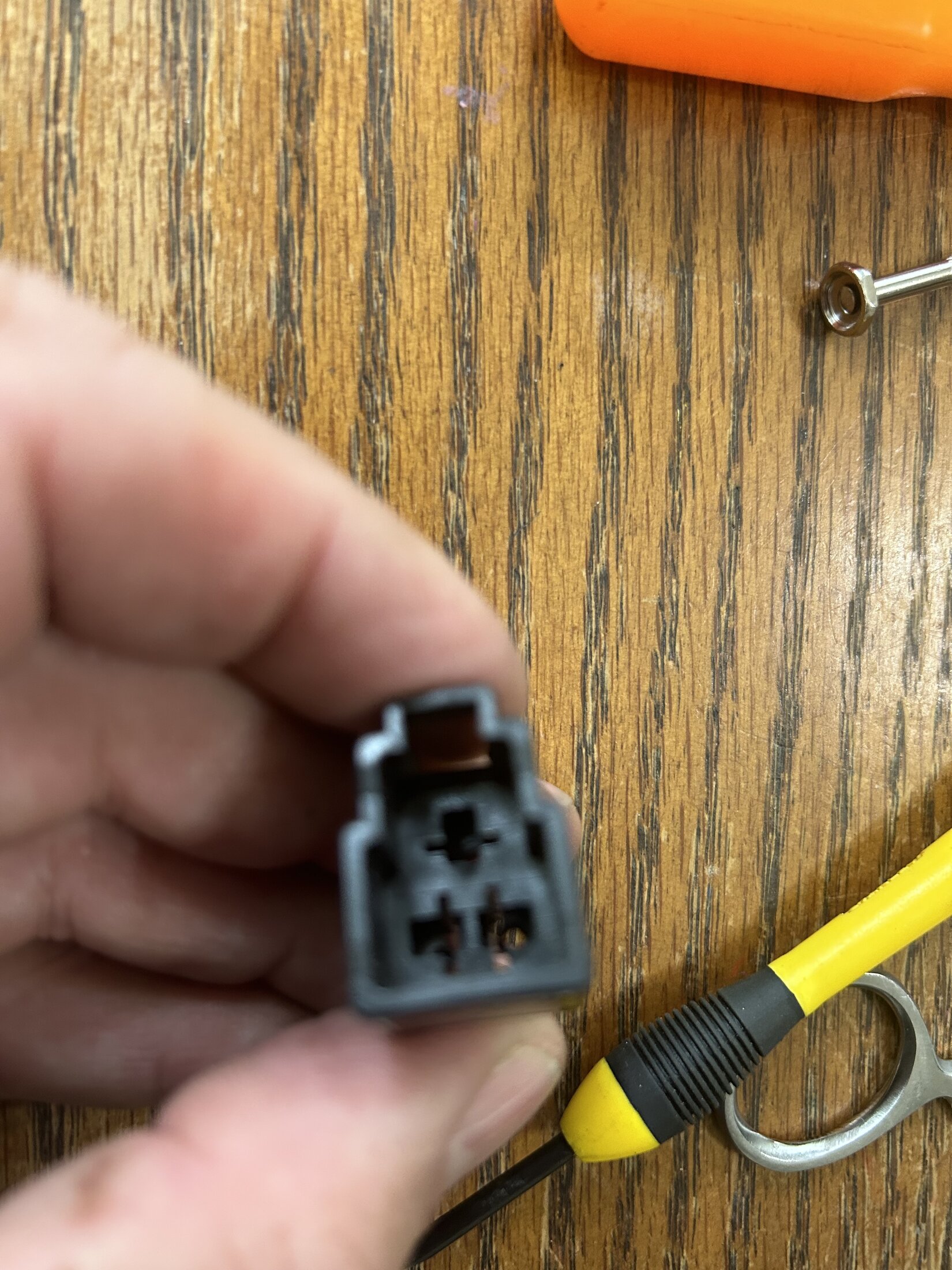

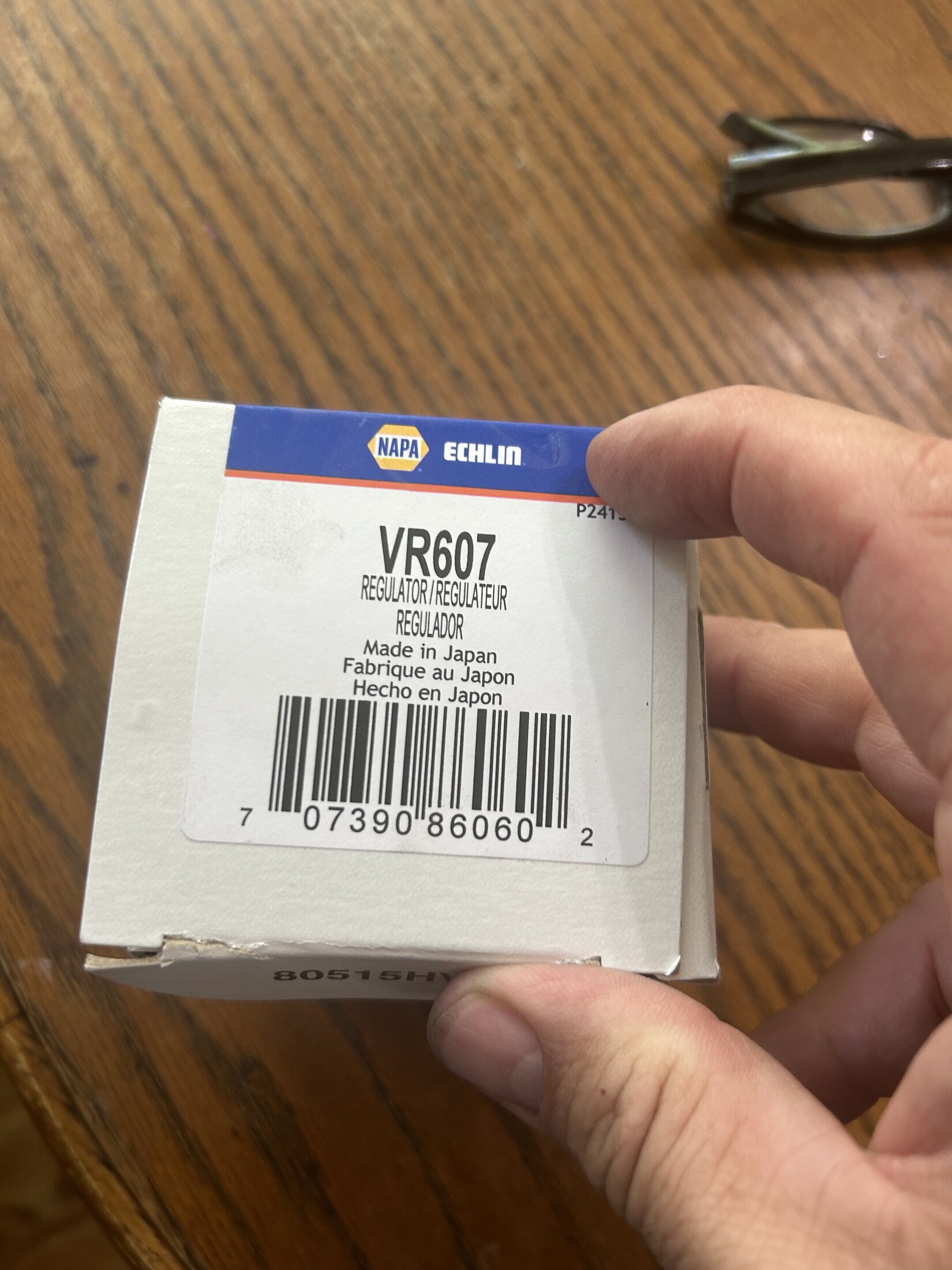

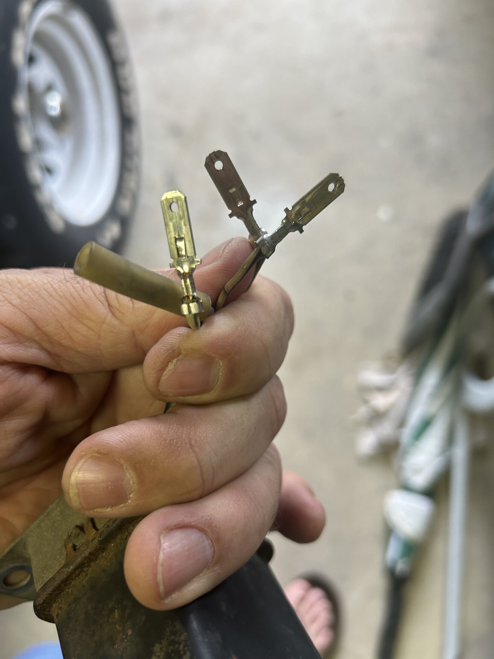

Step three: NAPA has an aftermarket three prong so I ordered it (actually ordered two of them since they were only $25). When I received the new ones, the plug was not 100% correct. Although it was a three-prong the plug did not fit. I probably could have forced it or altered it and make it work but didn’t want to do that.
Step four: I swapped the old plug onto the newer regulator. This is easy. Simply watch a YouTube video if you need help. It takes about 5 mins to do. Just make sure you put the correct wires in the correct spots.

UPDATE ON THE VOLTAGE REGULATOR:
From the pic on City Racer's website, the VR I purchased from NAPA was a NON-US one and that is why the plug was a little different (black and not green). It wasn't that hard to swap out the plug, and the one from NAPA was only $25, so it was definitely worth it since it was a good deal.
I've had it for several months now and it works great!

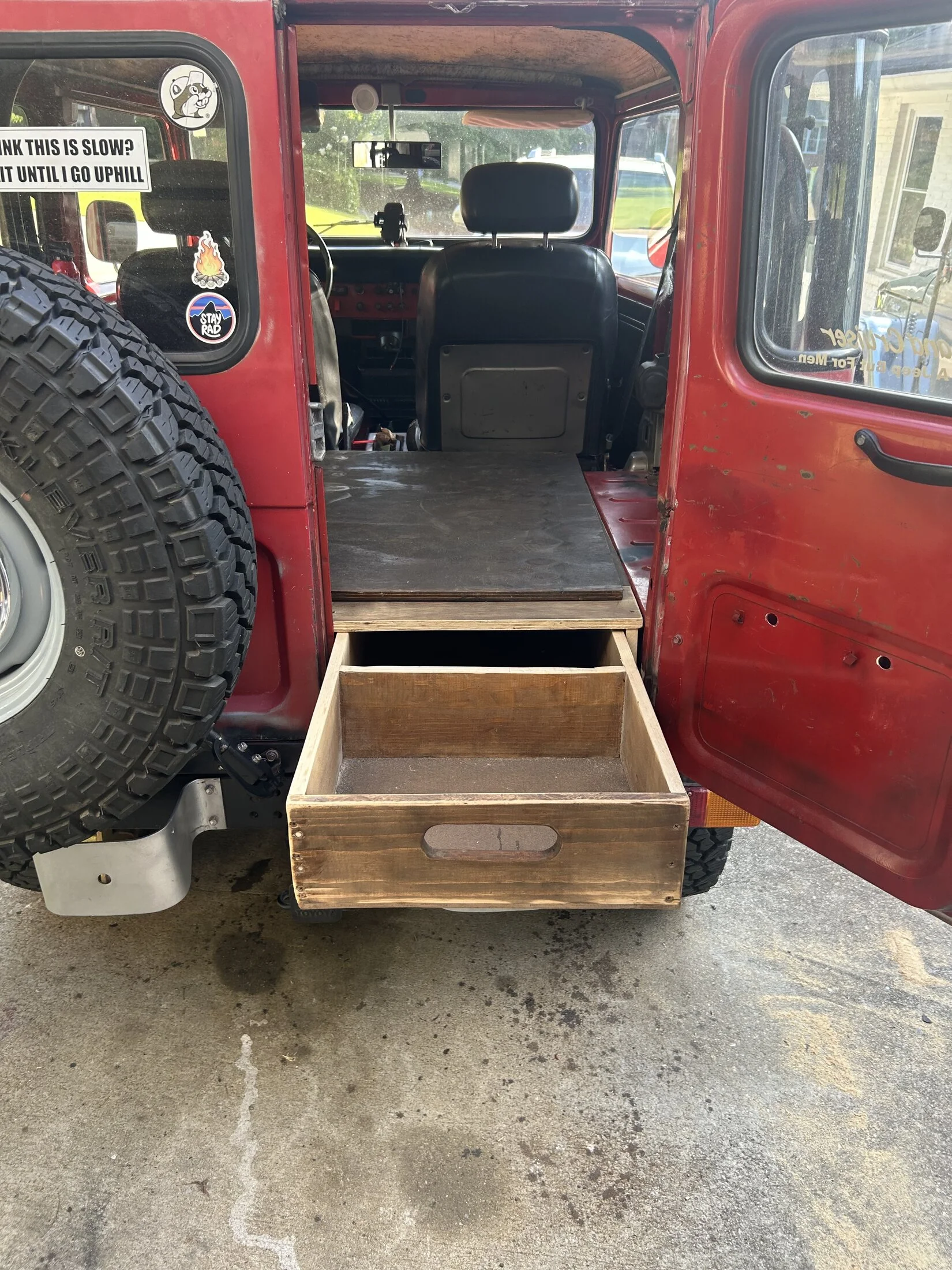

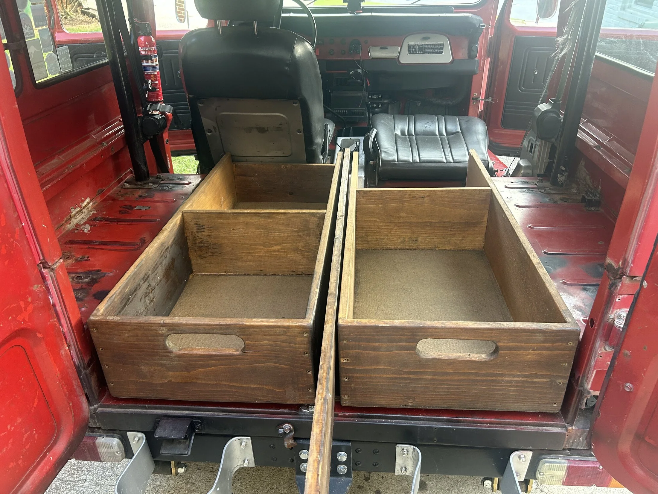

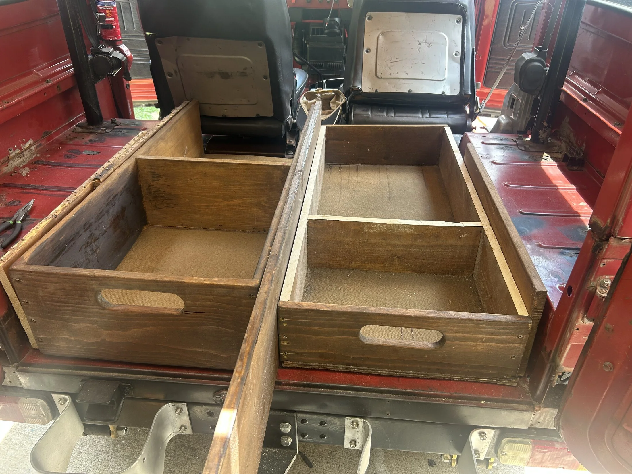

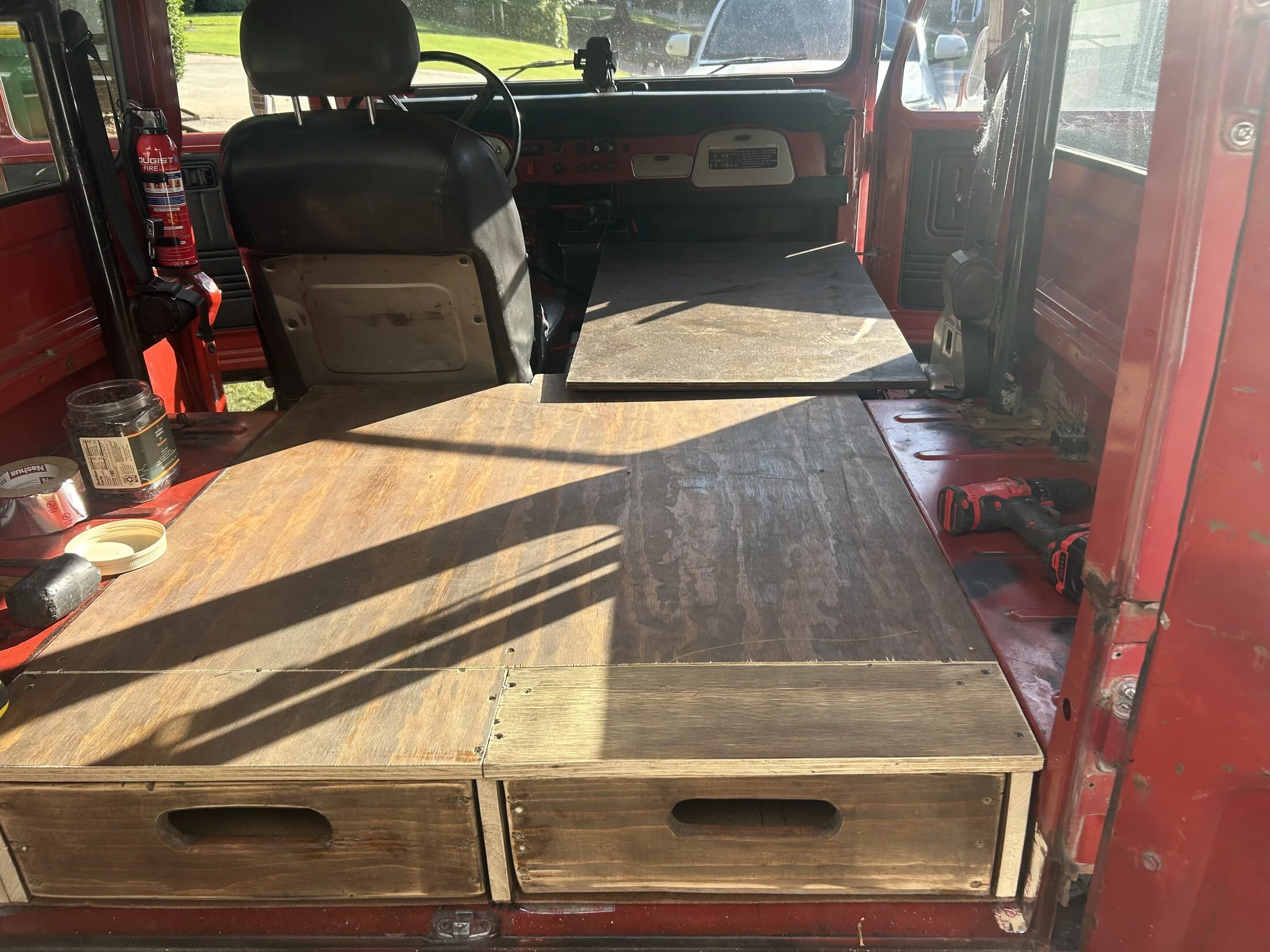

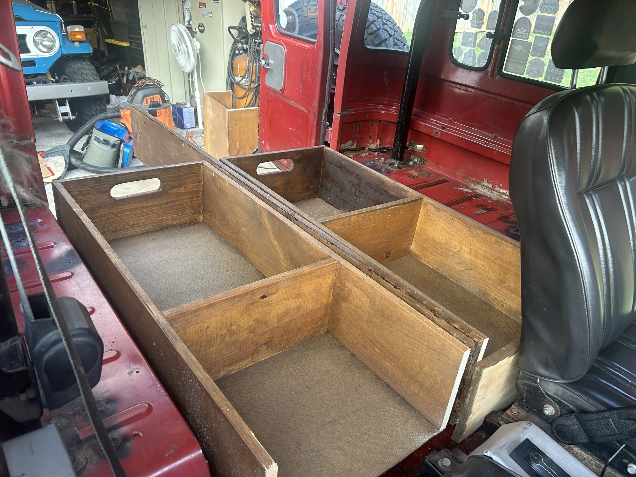

Got the drawer system pretty much finished up today. I say "pretty much" because it is not 100% done, but done enough to use. I plan to camp in it a couple of times to see what I like and don't like about it. I might keep it as is, or maybe modify it after I use it a few times.

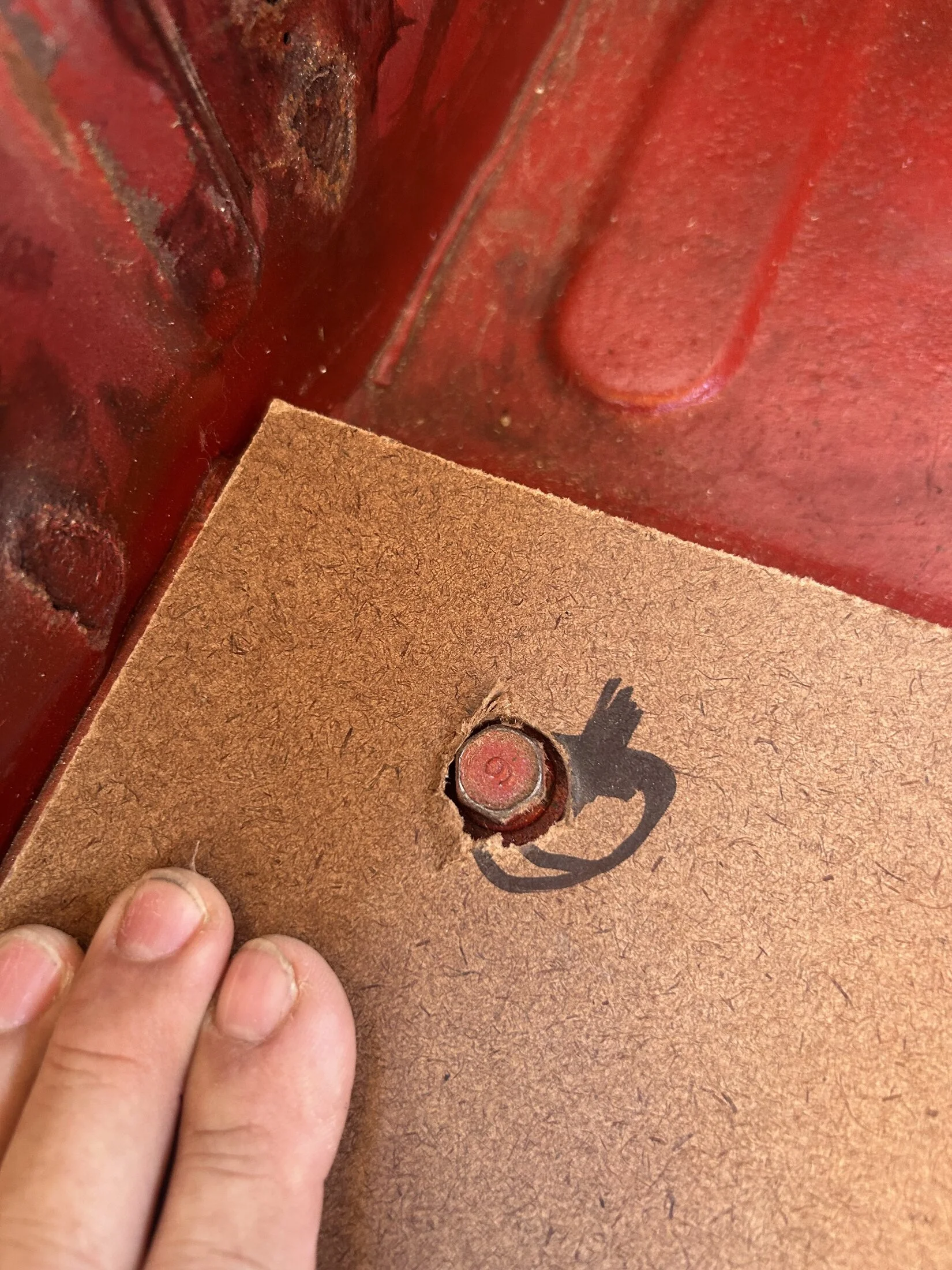

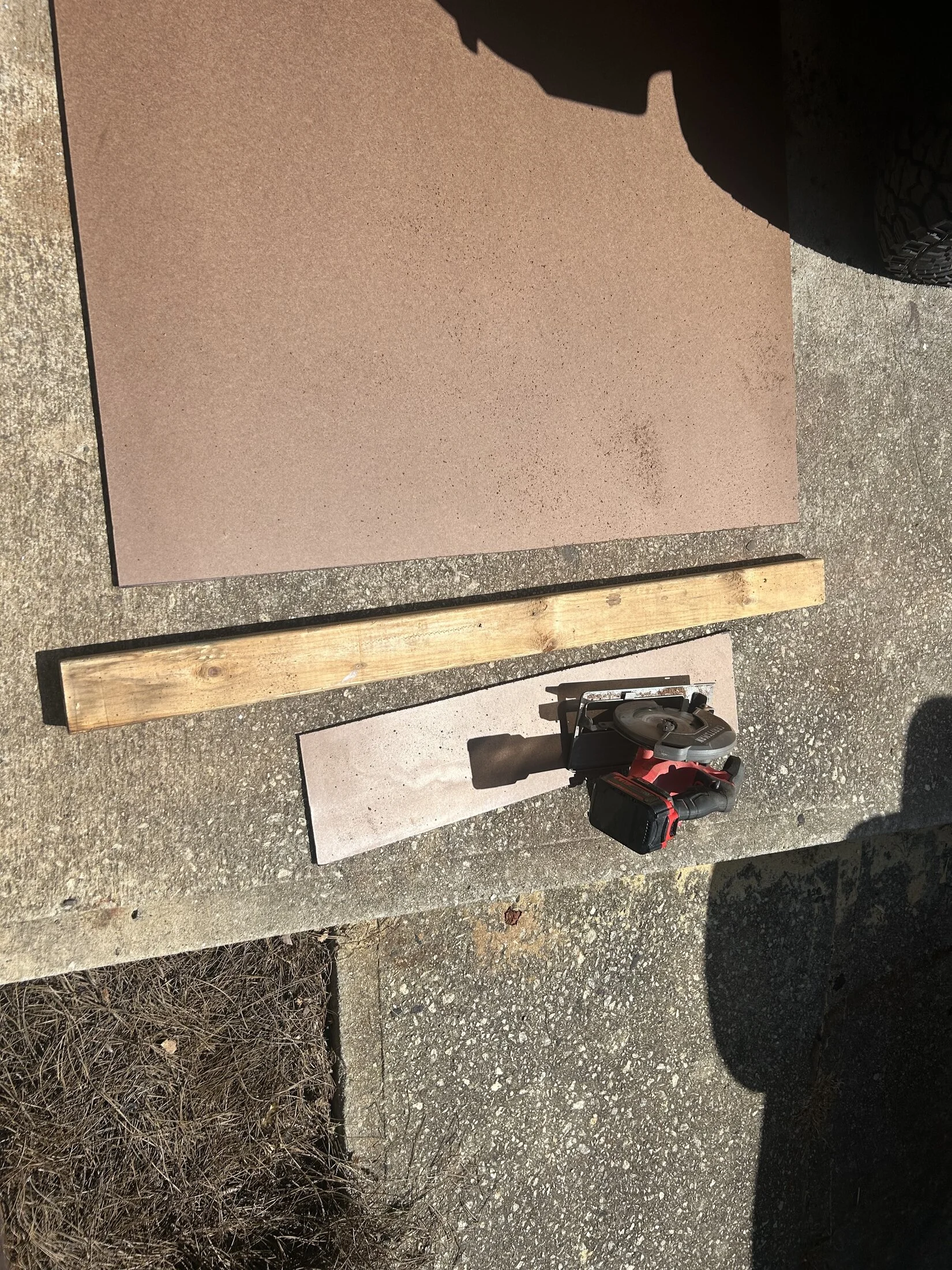

The only thing I had to buy was a 4x8 sheet of eucaboard (hardboard) for the bottom of the box. I did not have a piece big enough left over from the old build, and I really wanted the entire floor covered with the smooth side up so the drawers would slide smoothly. I know some guys would recommend using ball-bearing drawer slides, but this is a "budget build," and this process works. When the drawers were in the Tacoma, they were six feet long, full of camping gear, and they slid in and out with ease. The bottom of the drawers has the smooth side done as well, so a smooth surface on a smooth surface.
By not using heavy ball-bearing drawer slides, it kept my cost and weight down. I want to keep the weight as light as possible, and those things are heavy and expensive!
Here is a Home Depot Tip!!

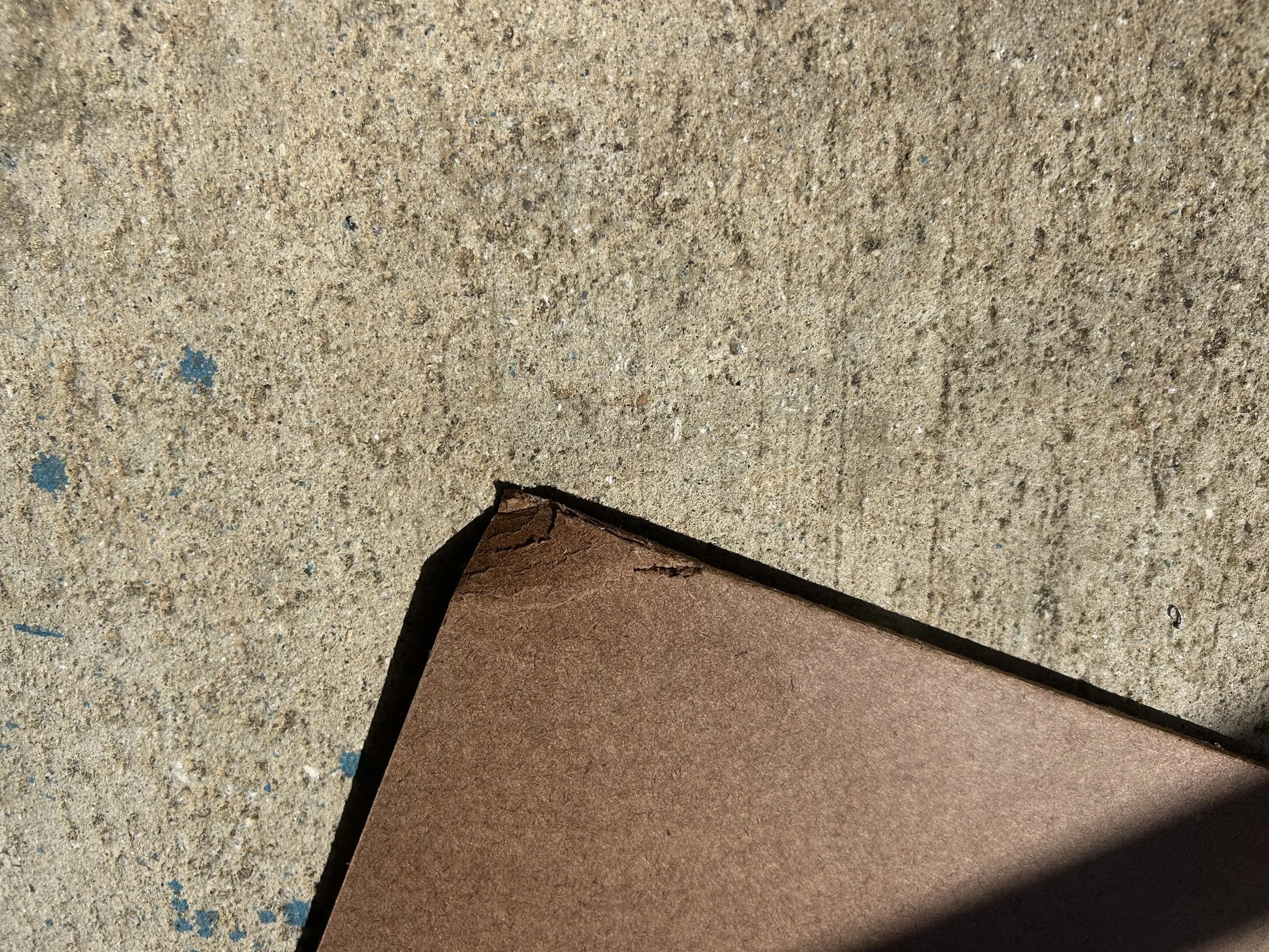

If you are buying anything at HD, look and see (or ask) if there are any damaged materials that you can buy. There were two pieces of eucaboard left on the rack, and both were slightly damaged on the corners. I only needed about 1/3 of the board, so I didn't need the whole thing. I asked the manager if he would discount it, and he gave it to me at half price.

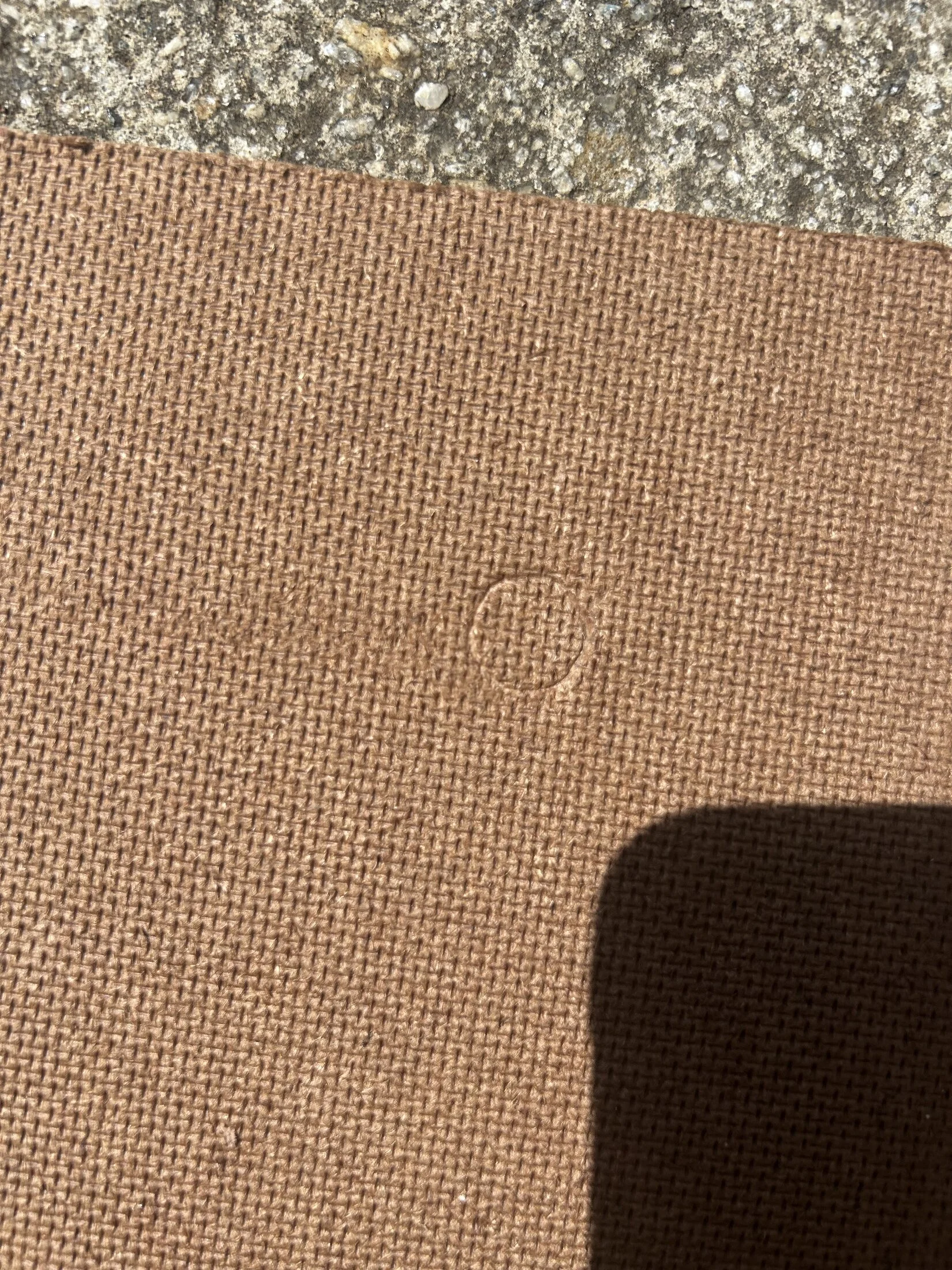

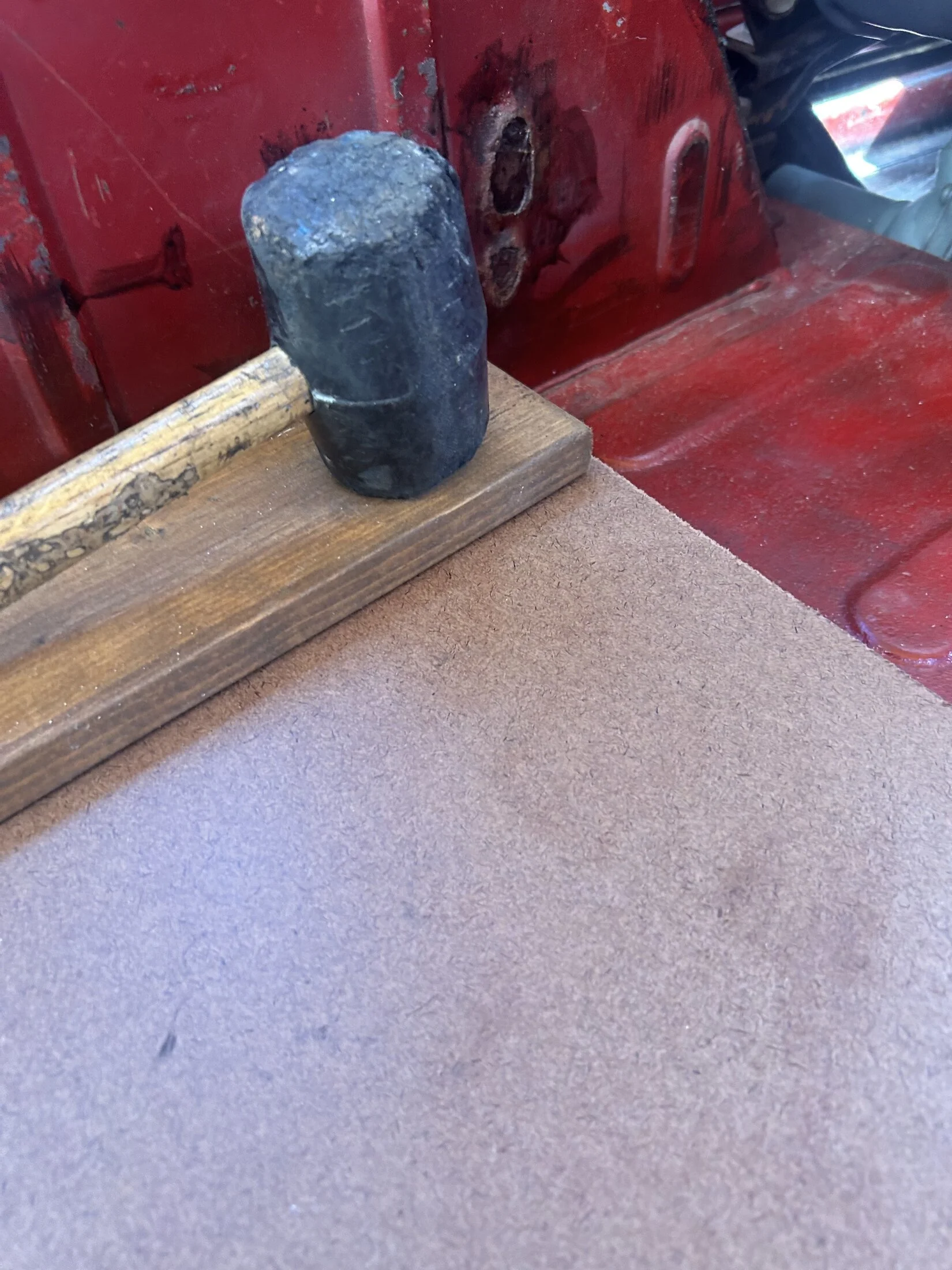

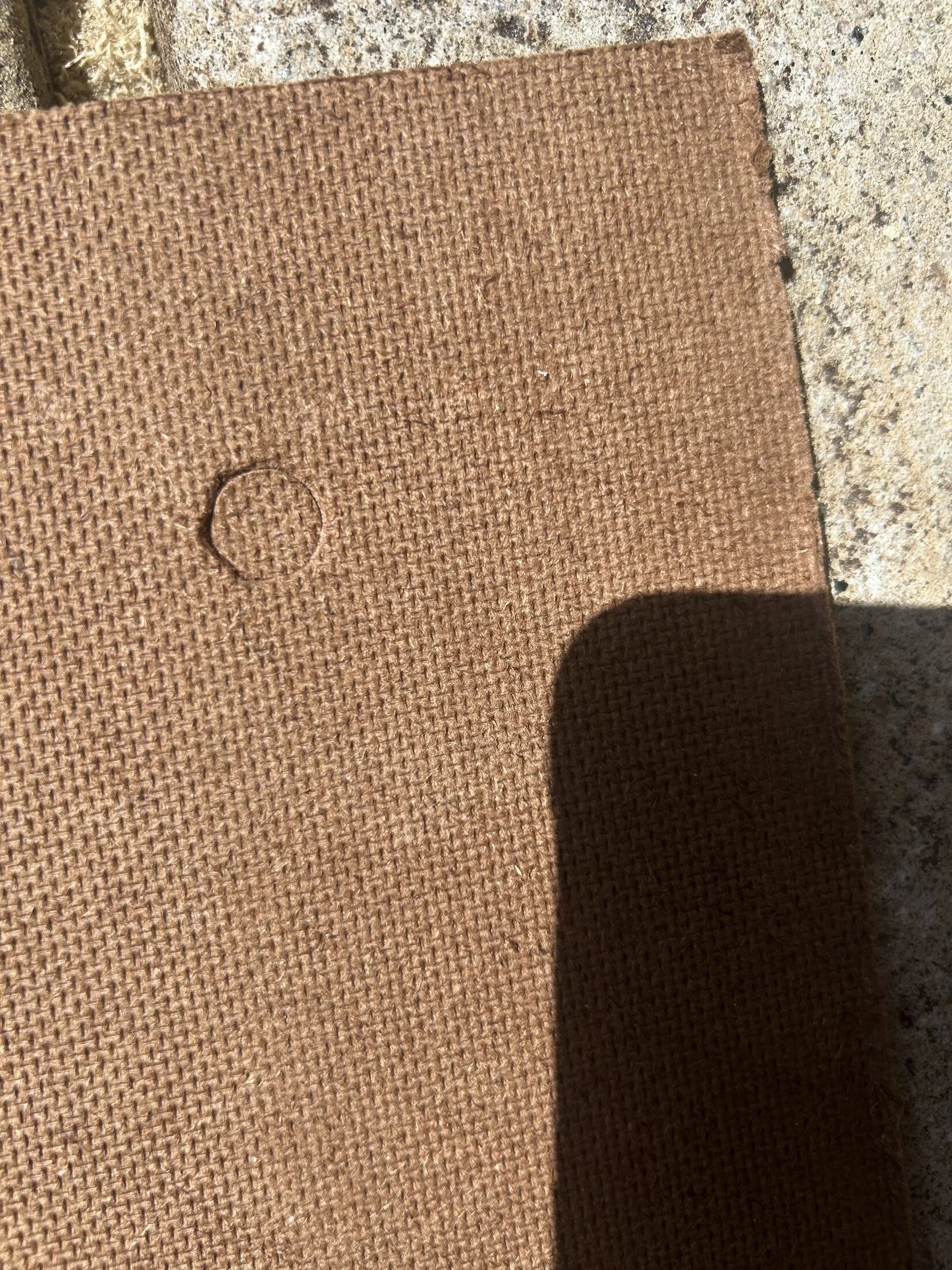

The other reason I use the eucaboard is that the tub bolts stick up and would be in the way of the drawers sliding in and out, so the board helps raise the floor just enough to fix that problem. I used a rubber mallet and a board to smack the eucaboard while it was sitting on the bolt. This made a clear mark where the bolt was, and I drilled out a hole to make room for the bolt. Another benefit is that it serves to help anchor the drawer box and keep it from sliding. The top board will be wedged in tightly, this, along with the weight of the stuff in the drawers and gravity... I am not worried at all about the box moving or coming out inadvertently.

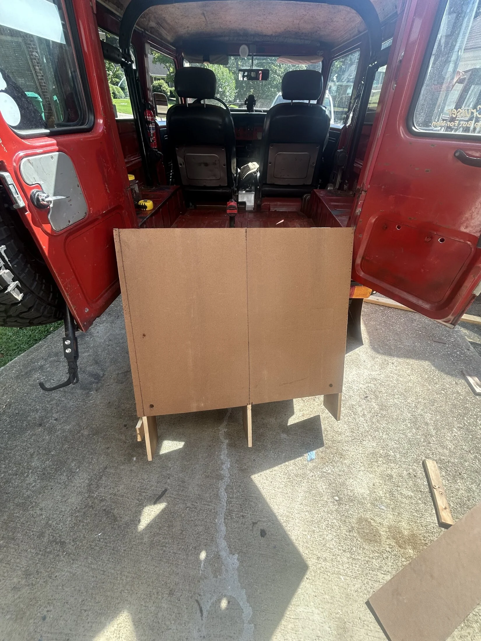

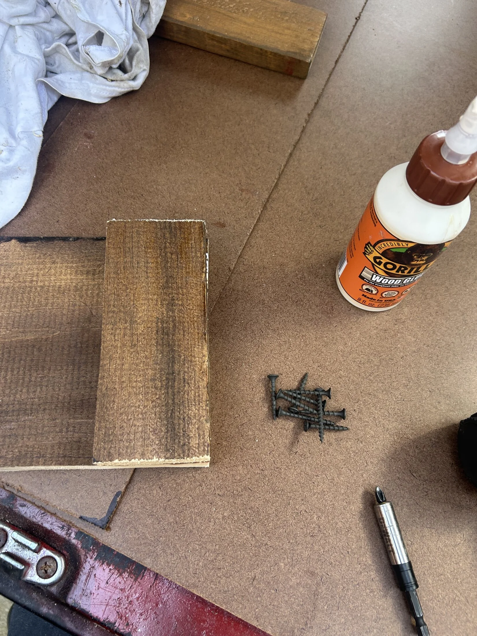

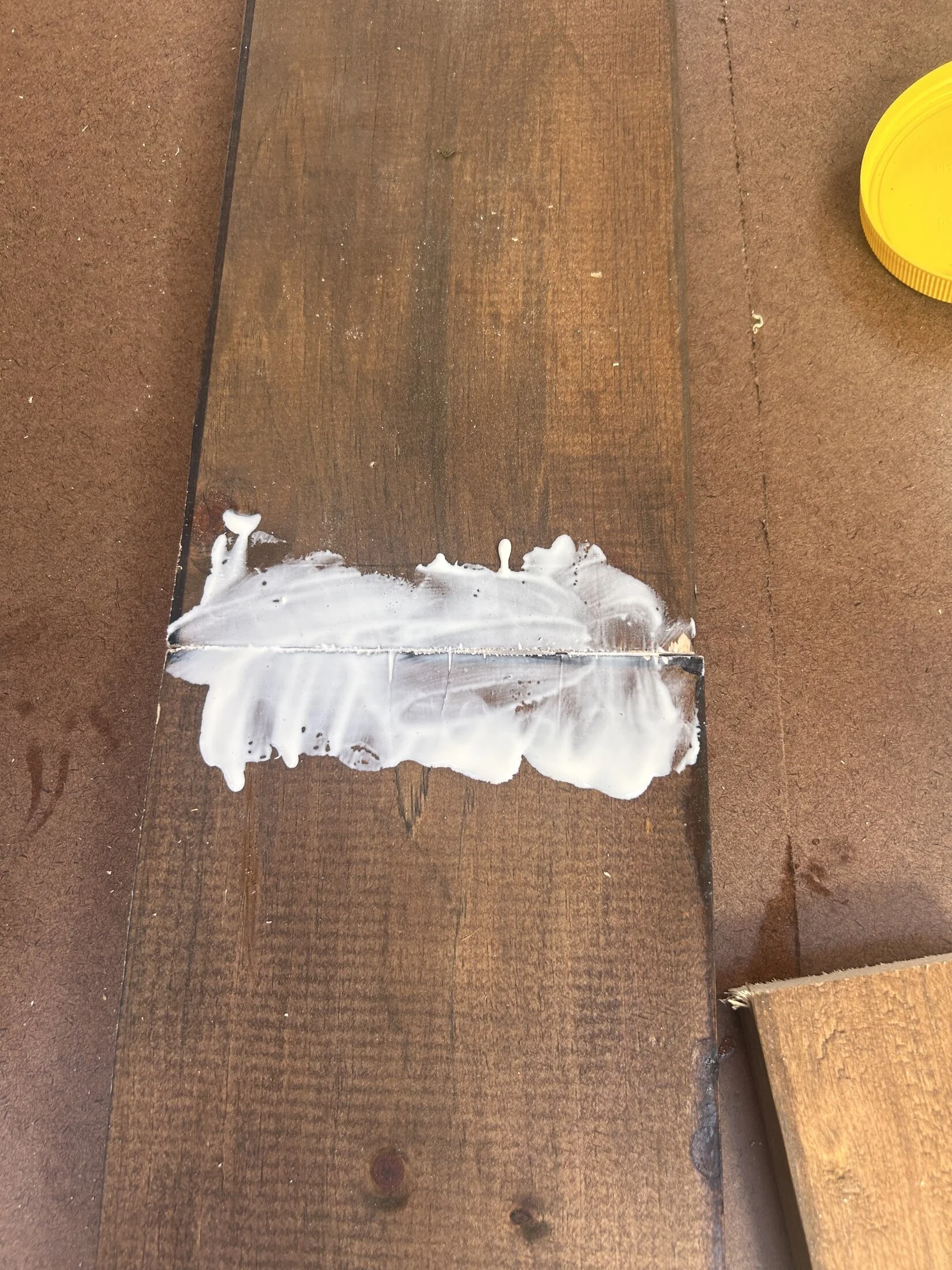

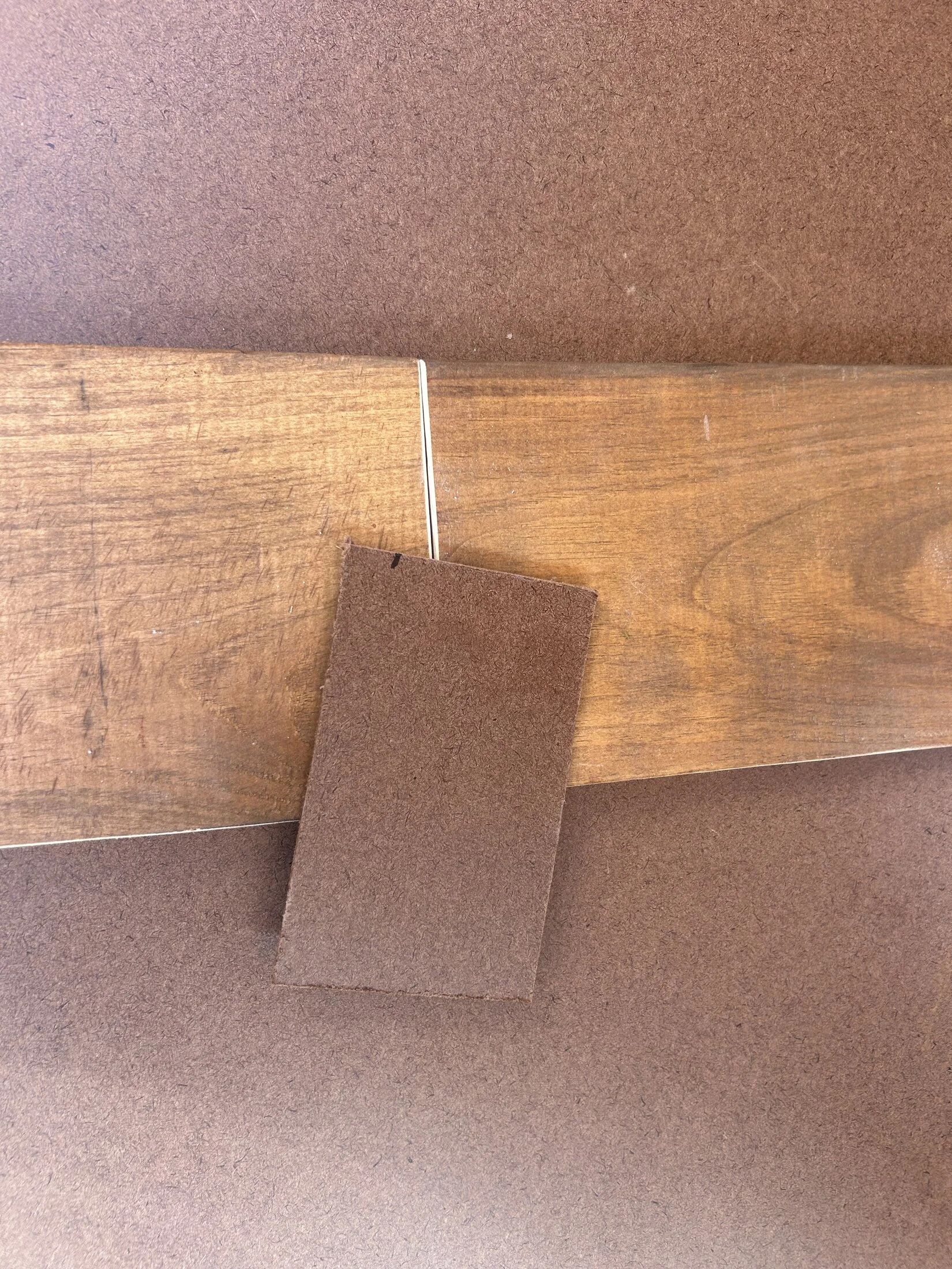

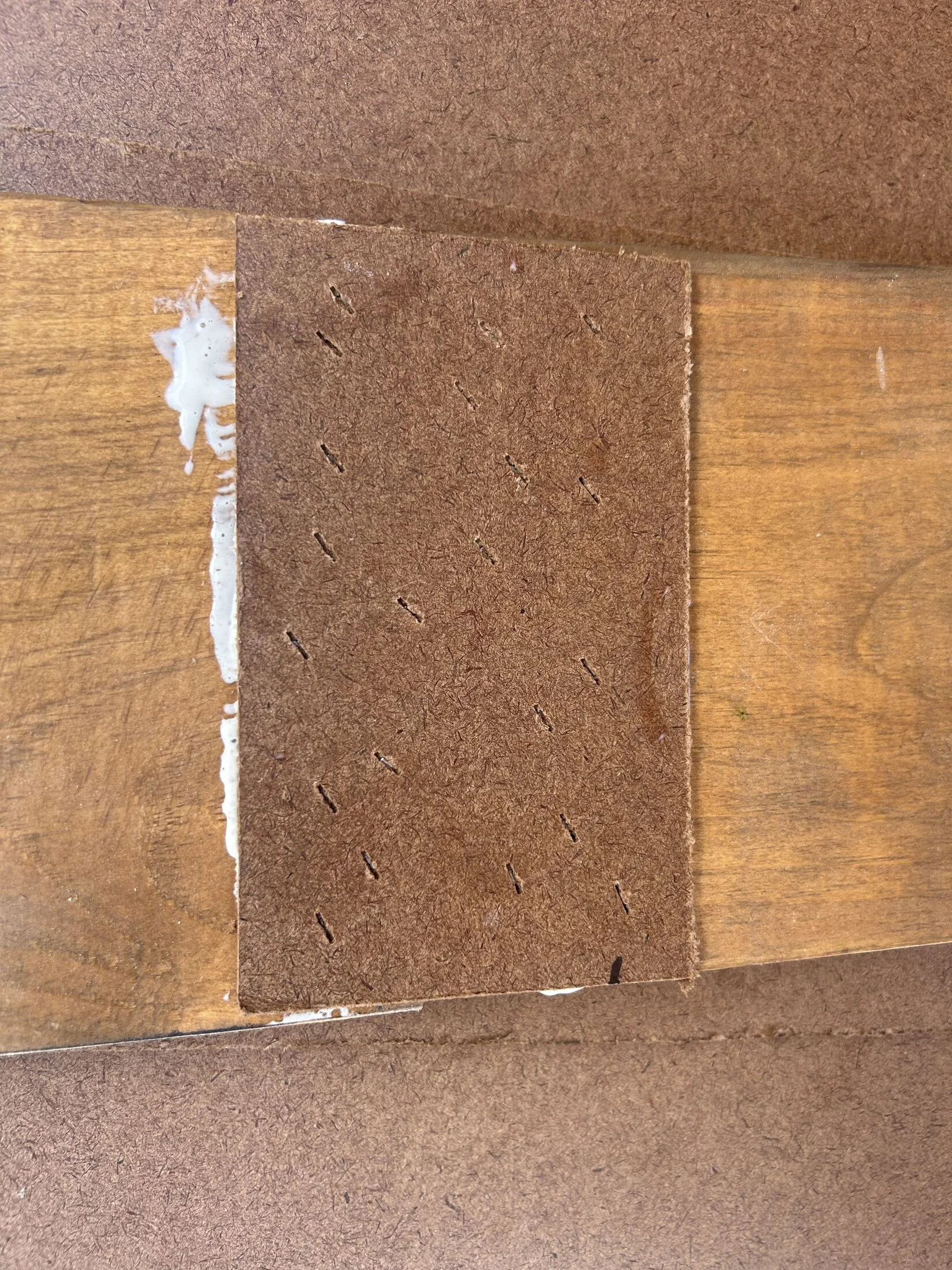

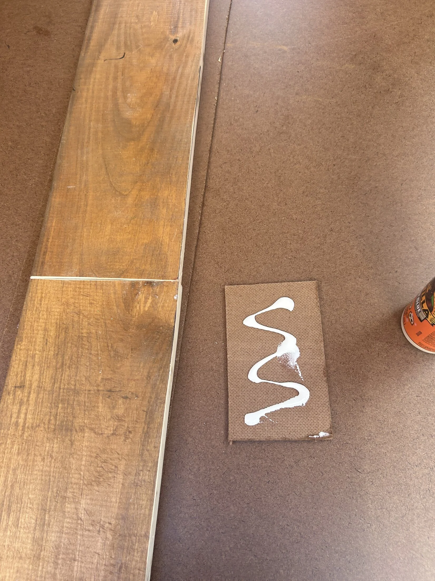

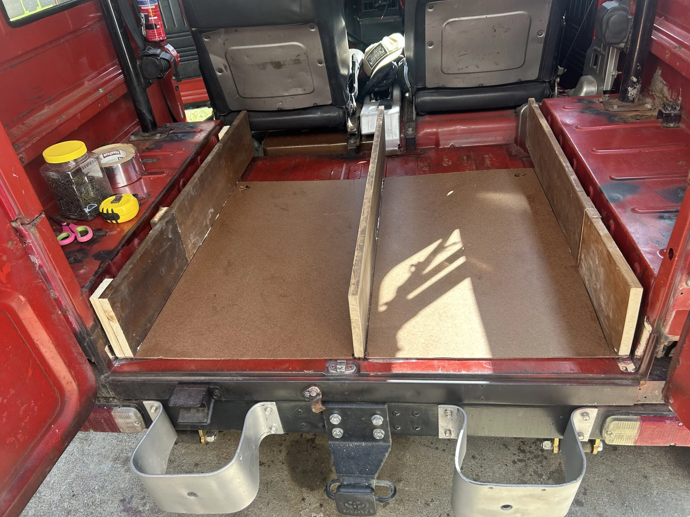

Since I used old materials from the old project, I only had one board long enough to make the inside and sides of the box. I used the long one for the middle piece. For the sides, I used a piece of the eucaboard to attach the two boards to make the sides long enough. It was just the right thickness to go on the outside between the ribs on the wheel well. I attached it with glue and about 20 staples.

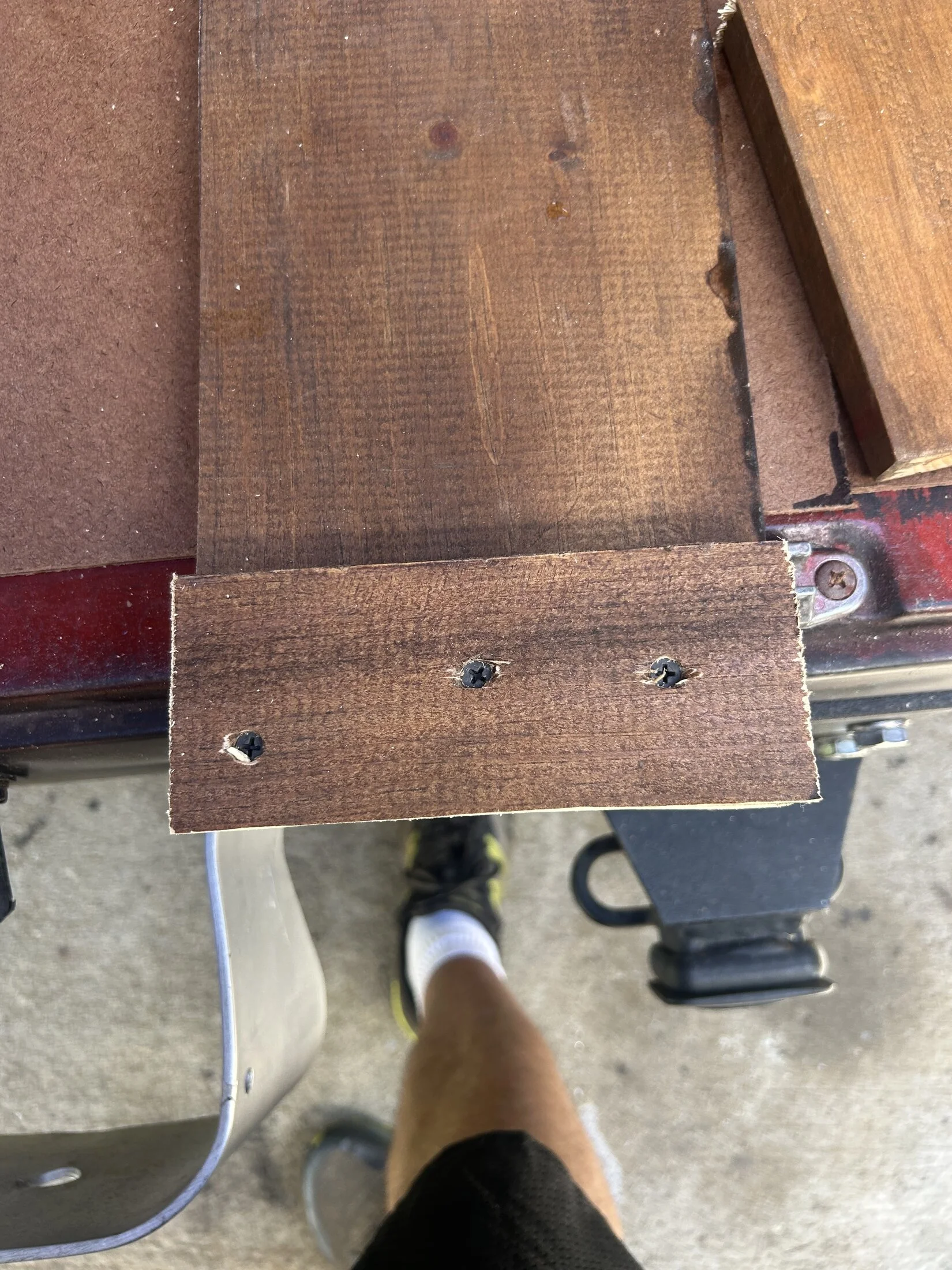

For the driver's side, the back door does not open all the way because of the tire rack. I needed to move the drawer over about two inches to allow it to slide out when the door is open as wide as possible. I used some extra pieces to attach the two boards and fill in the extra space. Again, I used glue and this time screws.

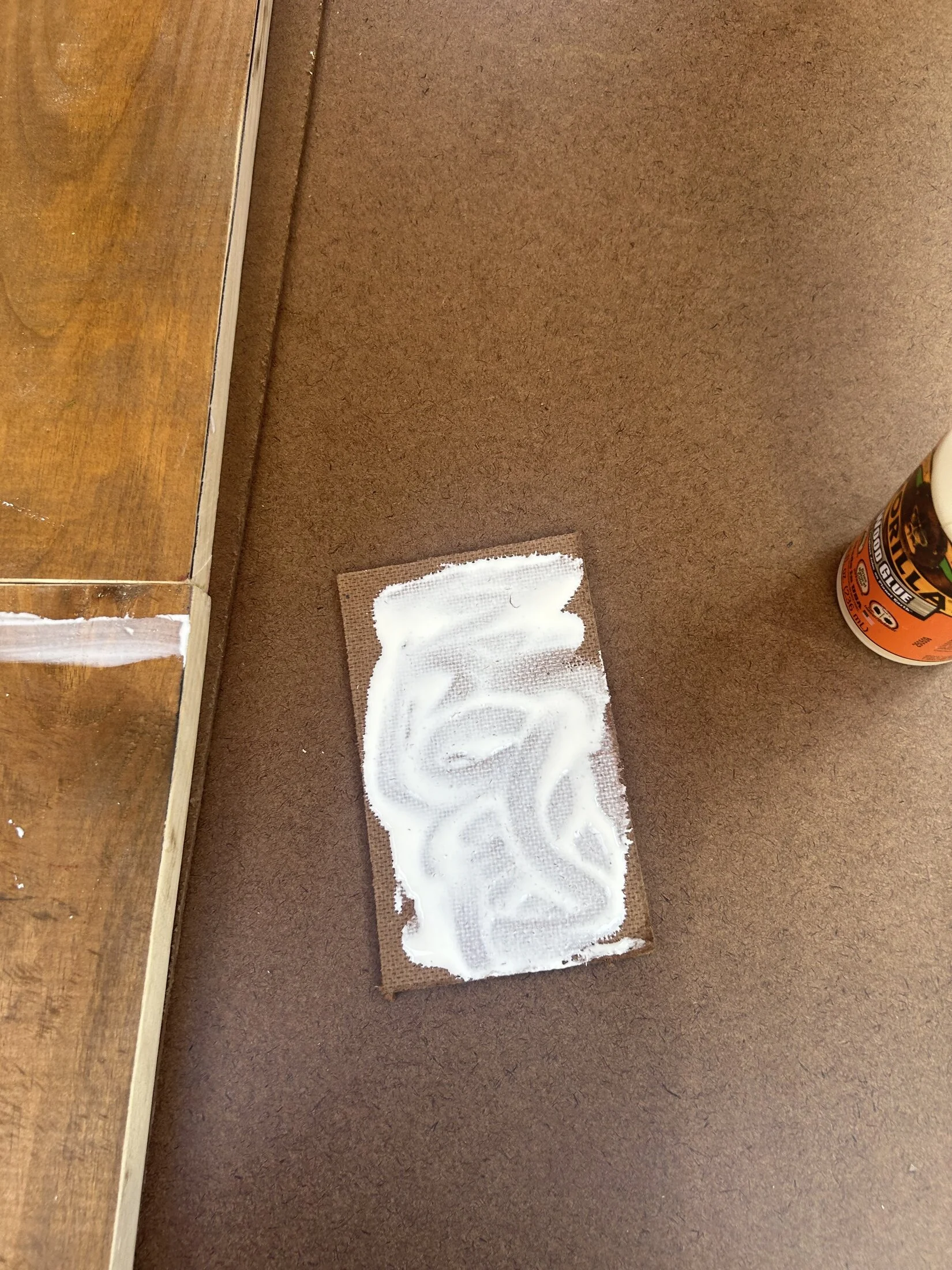

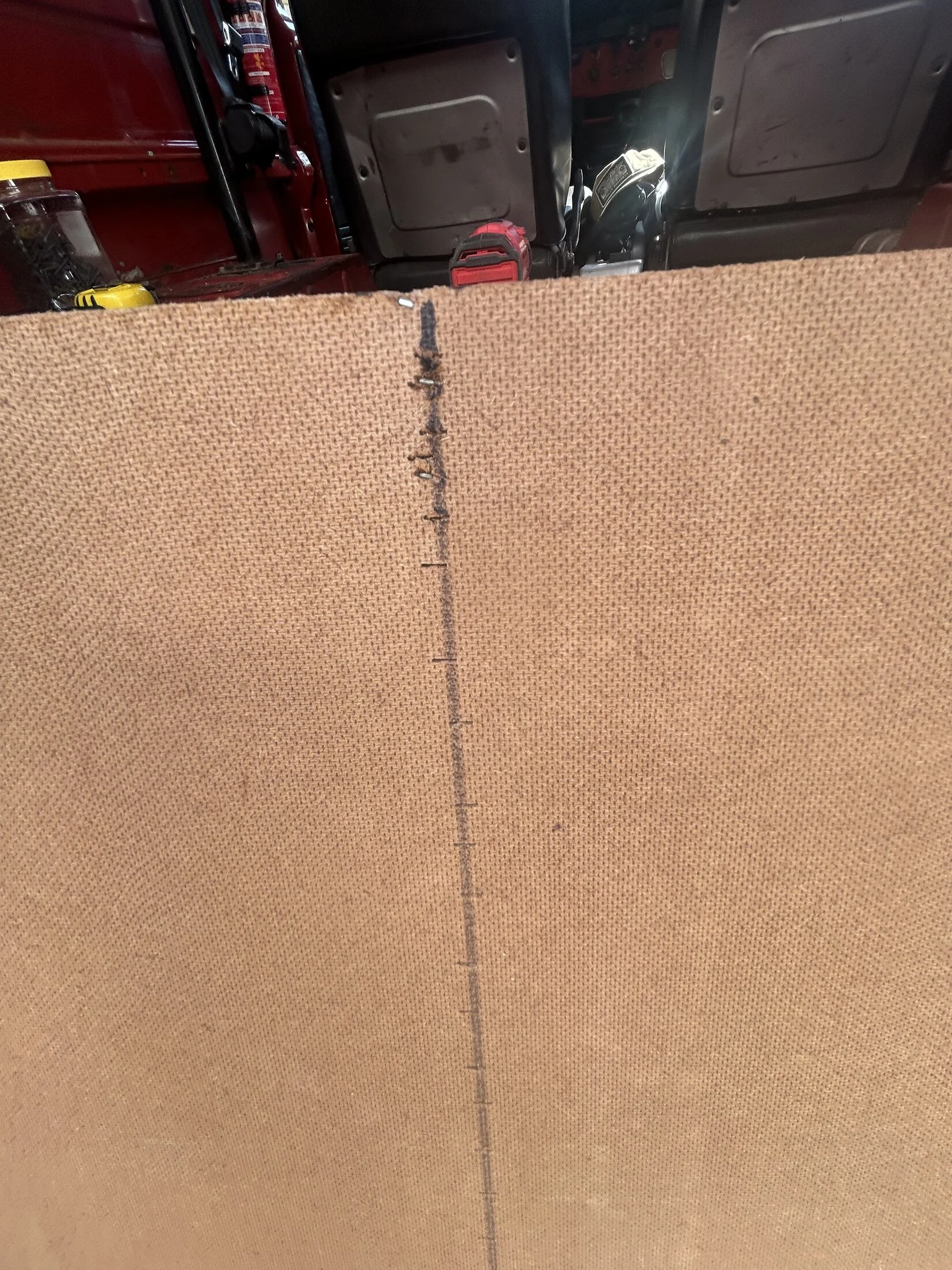

Next, I attached the sides and the middle piece to the eucaboard with glue and about 100 staples :rofl: One staple about every half inch. You can see the boards for the outside of the box and the middle at the bottom.

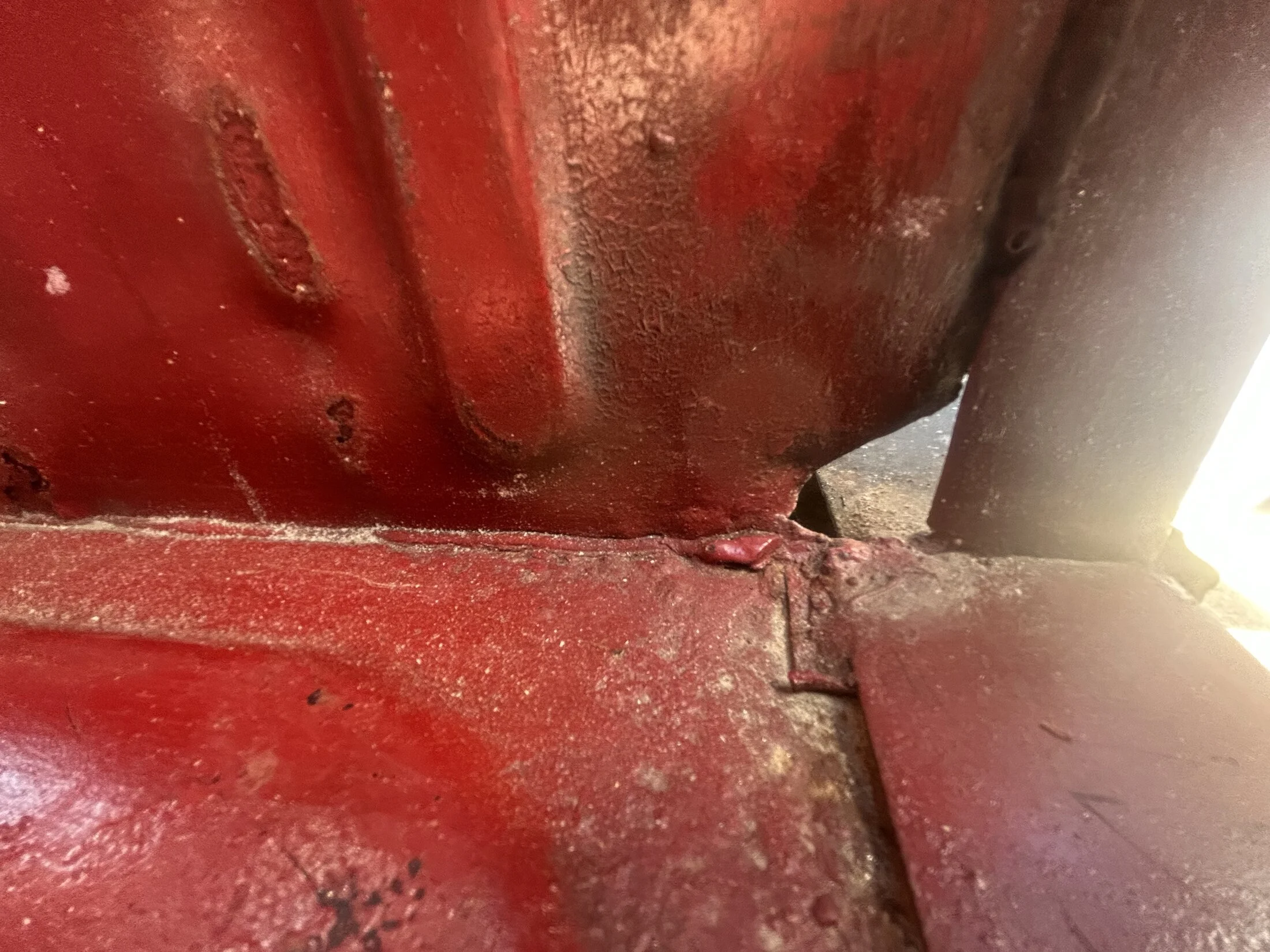

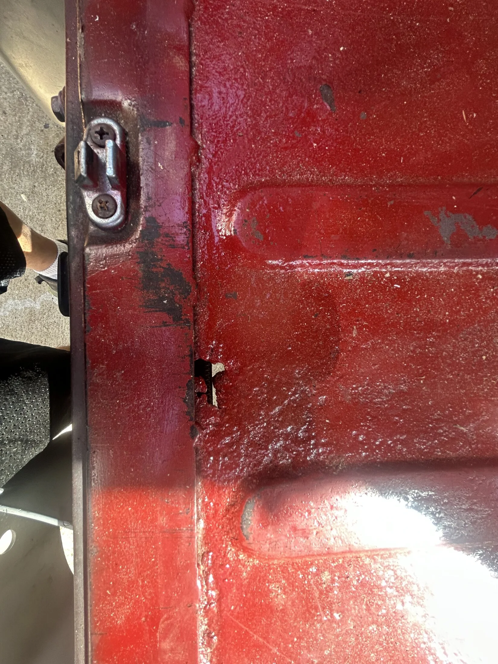

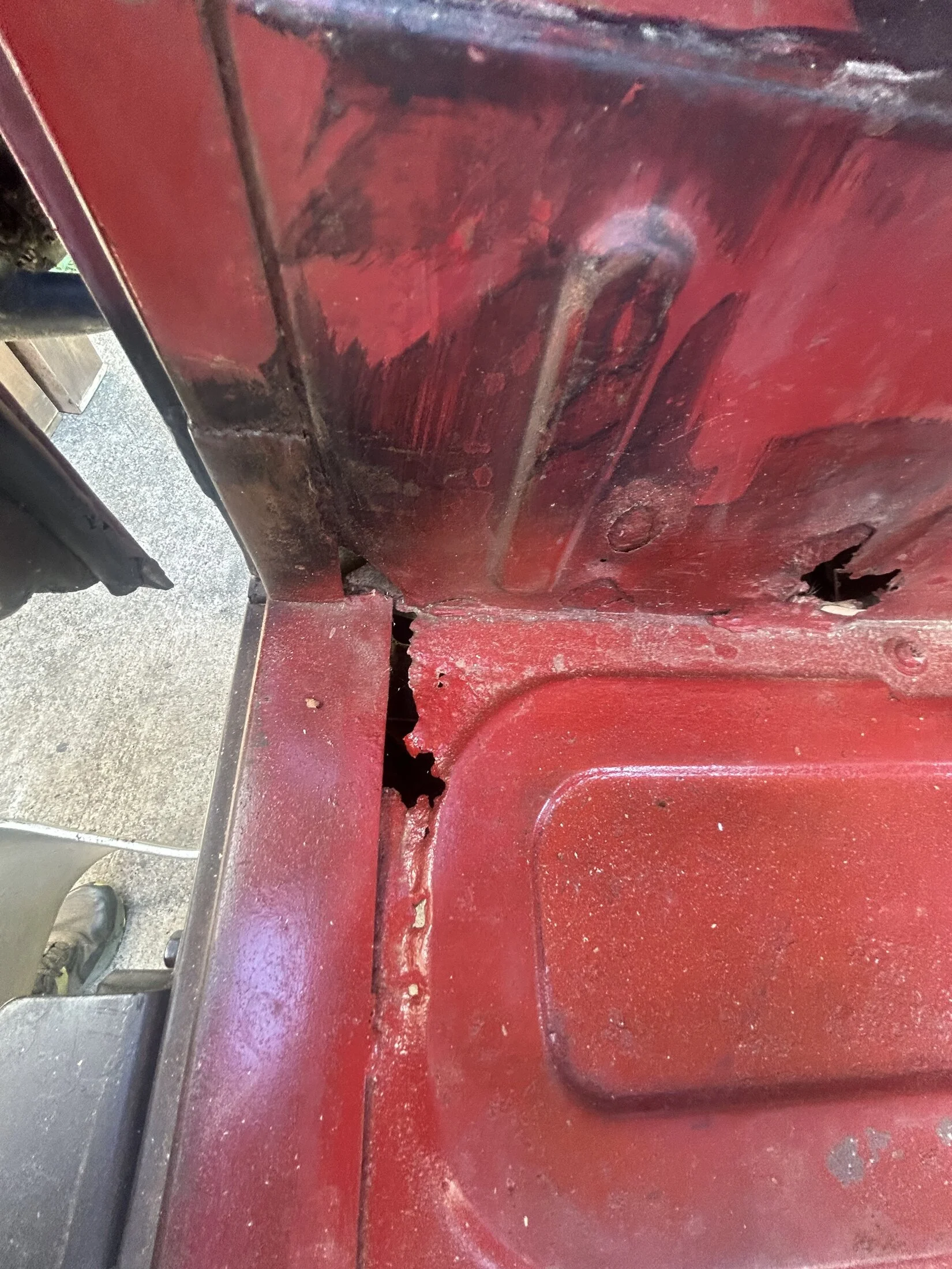

Before I slide the bottom and sides of the box into the 40, I needed to address a few rust holes. A previous owner replaced the rear sill but did not address a few of the rust issues with the bed floor and wheel wells. I know that this is not a long-term fix, but I want to keep water from getting into the bed, and this should deal with the issue for now. Aluminum foil tape from Home Depot. I already had it, so again, zero cost.

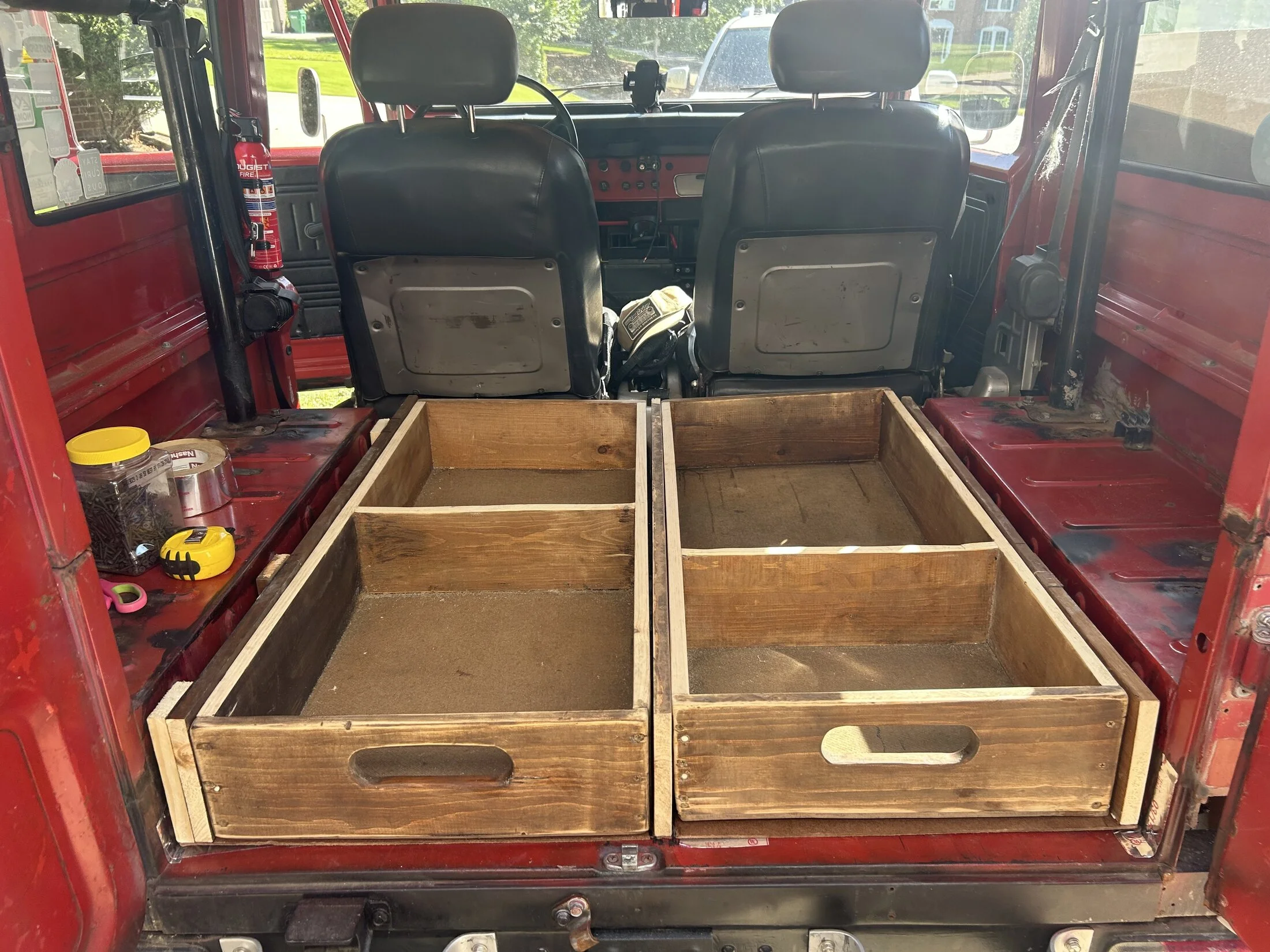

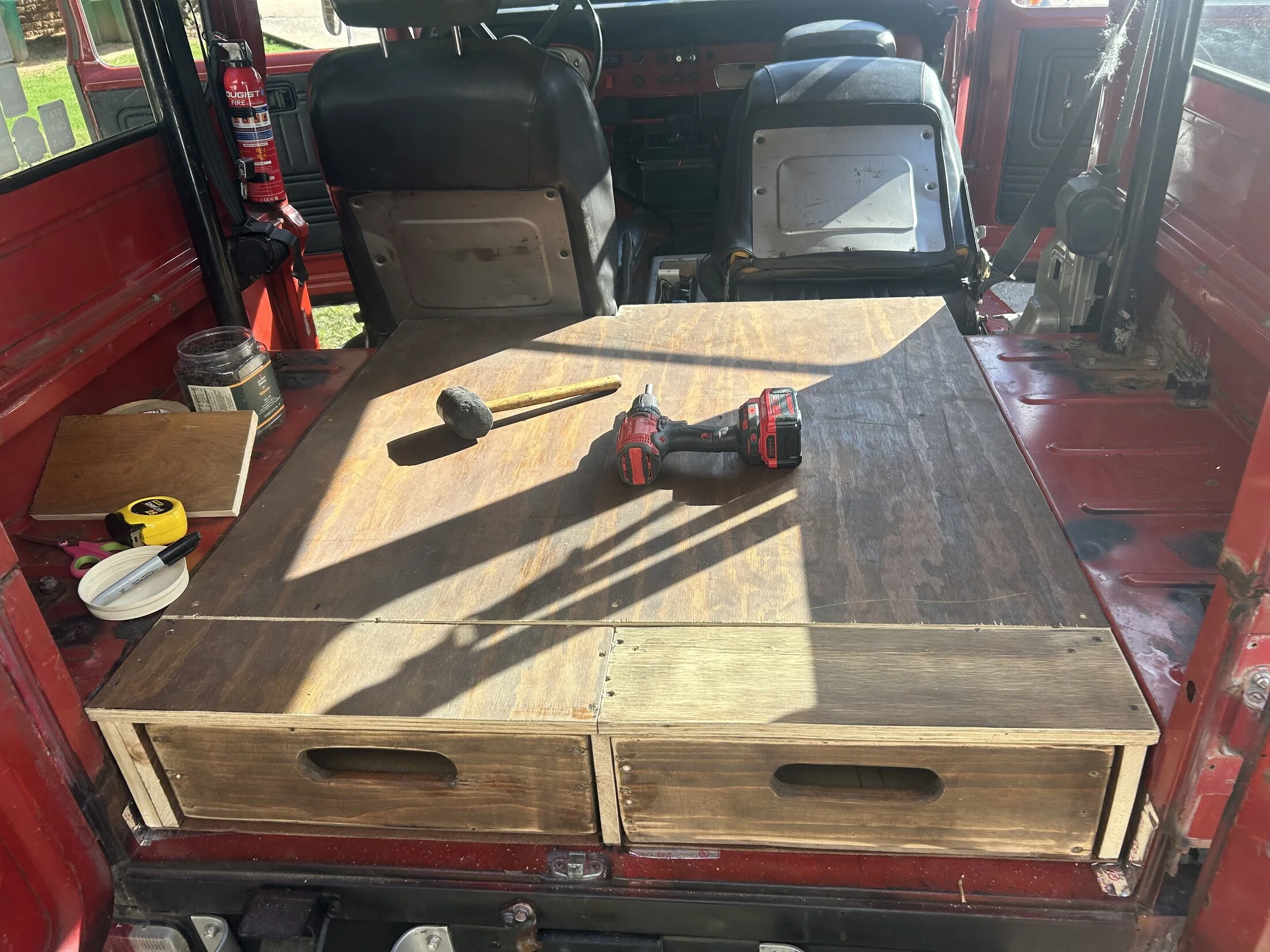

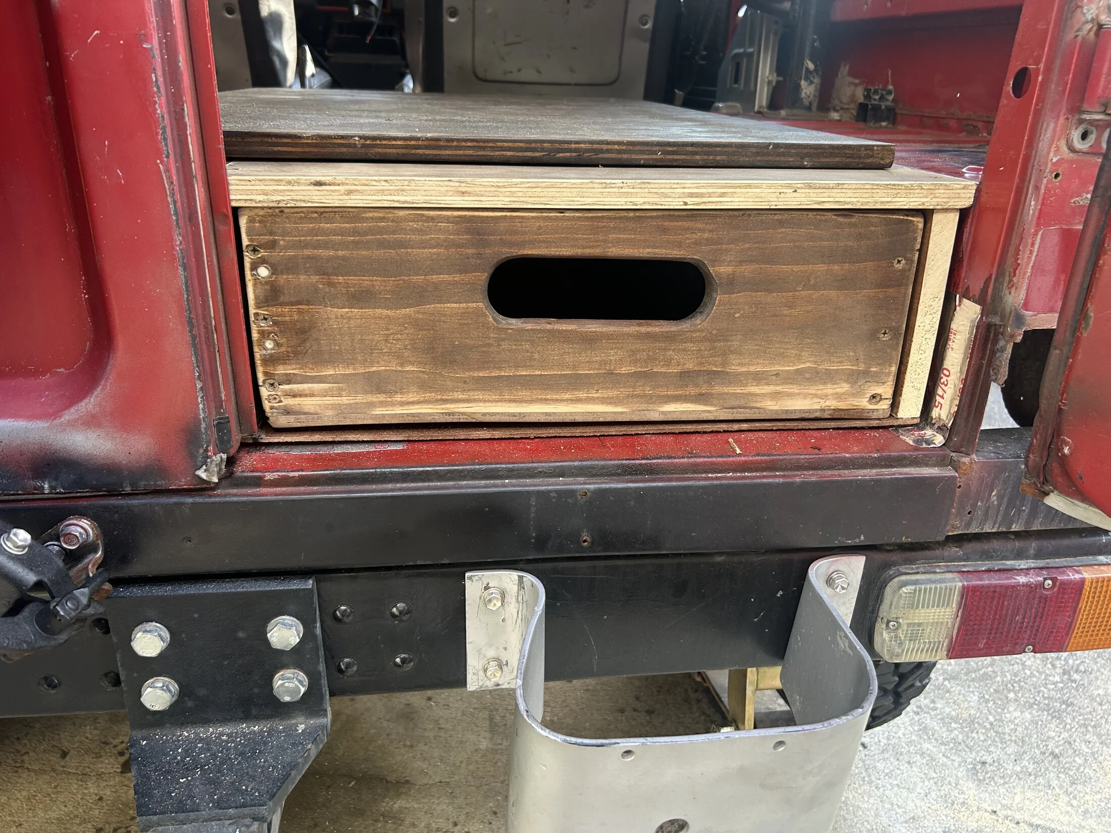

Here is the box with the sides inside the FJ40 before I put the top on it, and also a pic with the top on it.
I intentionally made the top level with the wheel wells and not extending over the top of them to help make it as light as possible and also to make it easy to get out if needed. This might be something that I would do differently next time. The drawers are only six inches in height, and raising the platform an inch or two would allow for more storage. That being said, I need to avoid the temptation to load the drawers up with 300 pounds of junk. The other advantage of this design is that I can put the seats back in if I want to.
I did not glue the top down, but only attached it with a few screws... again, so I can get it out easily if needed.
I didn't intentionally plan this, but I can slide the passenger side drawer out with the driver side door closed. Glad I don't have to unlatch the tire and open both doors every time I want to get in one of the drawers.
