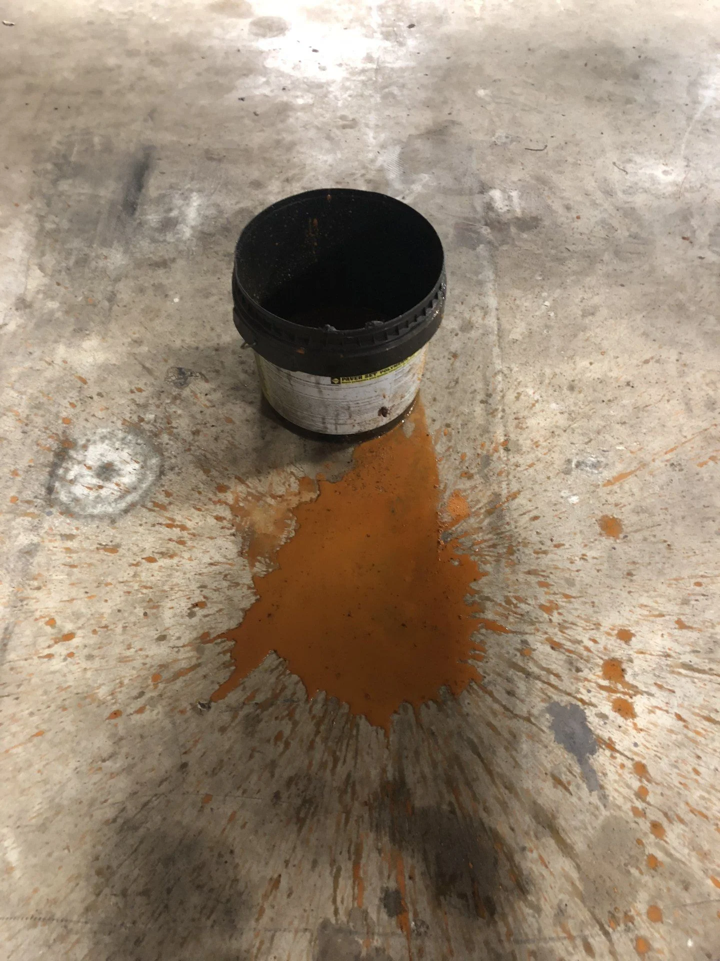

So I dicked with the transmission some more today. It’s frozen up solid. Took the inspection cover off the trans to check the clutch and it’s not even against the flywheel. It also doesn’t have any friction material left on it, so I threw Lucille on the lift.
I pulled the drain plug and quickly figured out why she’s stuck. Both the trans and t-case are full of water.
