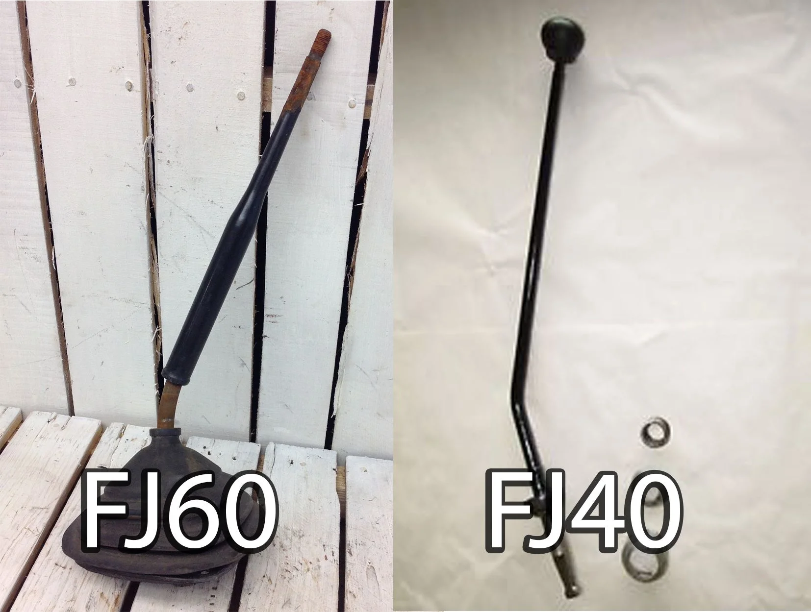

My shifter already hits the driver's seat when in reverse and now that I put in a center console (tuffy) it won't go into 4th at all. Not too big a deal, I was already planning to modify the shifter for a custom shifter I'm working on. I am essentially repositioning the "knob" about 4" forward of where it was by heating and then taking some of the bend out of the stick. FJ60 shifter might also be trickier to bend than that in the FJ40. (See pics)
FJ60 has a more "refined" outer shell. FJ40 is just a bent piece of metal tube. FJ40 shifter is a fair bit longer as well.
