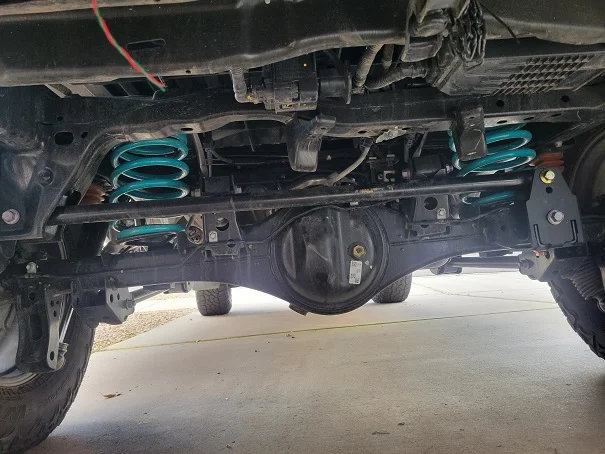

  • Rear Dobinson springs. First (C59-819V) set compensated for the weight, but no lift. Second set (C59-821V) gave me lift, but not enough.

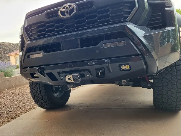

C4 Winch Bumper.

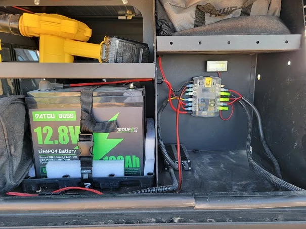

100Ah battery and fuse block in the camper. Plus, my little Dewalt blower.

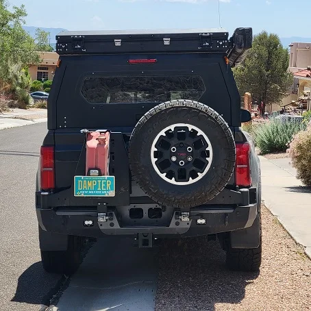

The Victory 4x4 rear bumper. The swing-outs blocked the backup camera mounted to the tailgate handle. I've been messing with how to resolve this issue. I bought another camera, and tailgate harness from Toyota, and teased out the camera cable from the harness. I've been through several iterations, and I'm still working on this solution, but so far I think this will work.
I did a few things on the C4 bumper I figured I would document here. I made two modifications to the bumper before the install. First, I installed a SAE port on the front of the bumper so I could plug in my Zamp Solar suitcase panel without having to pop the hood and connect with alligator clips. Since the winch controller connector was not accessible I bought a Warn extension cable (Warn is proud of that cable ... $$$$$) and mounted that to the front. I also clocked the gearbox housing so the handle was accessible.
SAE solar port on the passenger side of the bumper.
Warn extension port.
Clocked gearbox handle.

you don't think those are going to get smacked?
I'm not really concerned. I don't plan on wheeling this heavy.
A couple of changes. First, I ditched the Dobinson 819V springs and replaced them with the 821V. I still didn't get enough lift for my liking, so I installed a 1/2" spacer too. I can live with this for now.

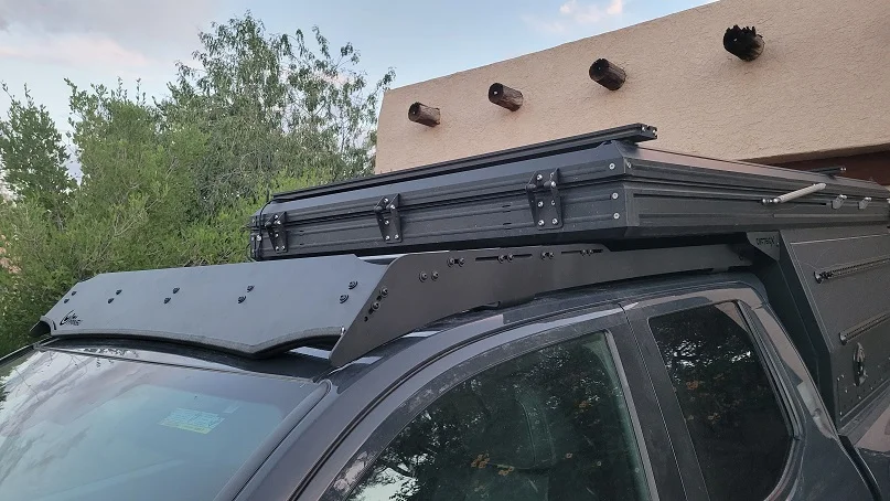

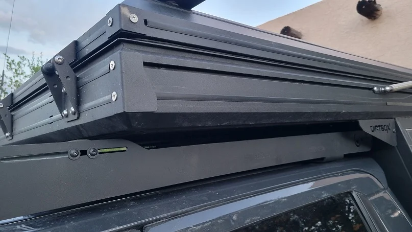

Second, I had a lot of wind noise with the Dirbox camper. Mostly at the back window. I had been looking at options, and decided a roof rack with an air deflector might work. The only two options I could find that were low profile enough to potentially fit between the camper and the top of the cab were Front Runner, and Prinsu. While at Overland Expo in Oregon I paid a visit to both companies. As luck would have it Prinsu had a rack at the booth for Gen4 Tacomas. I bought it ... event discount plus no Oregon sales tax. A camp neighbor helped me install it (kind of a PITA with the camper). Bottom line, it fit, but it was tight. When I came home I cleared the rack under the camper.
Did it help with the wind? Yep, a whole lot. It also appeared to improve gas mileage noticeably.

The other improvement was the trackbar correction kit from Dr. KDSS. With the lift in the rear I had a nice angle on the trackbar. This kit leveled out the bar.

Did you feel the difference with the track bar correction?
I haven't driven it yet. I'm also curious if I notice a difference in handling.
