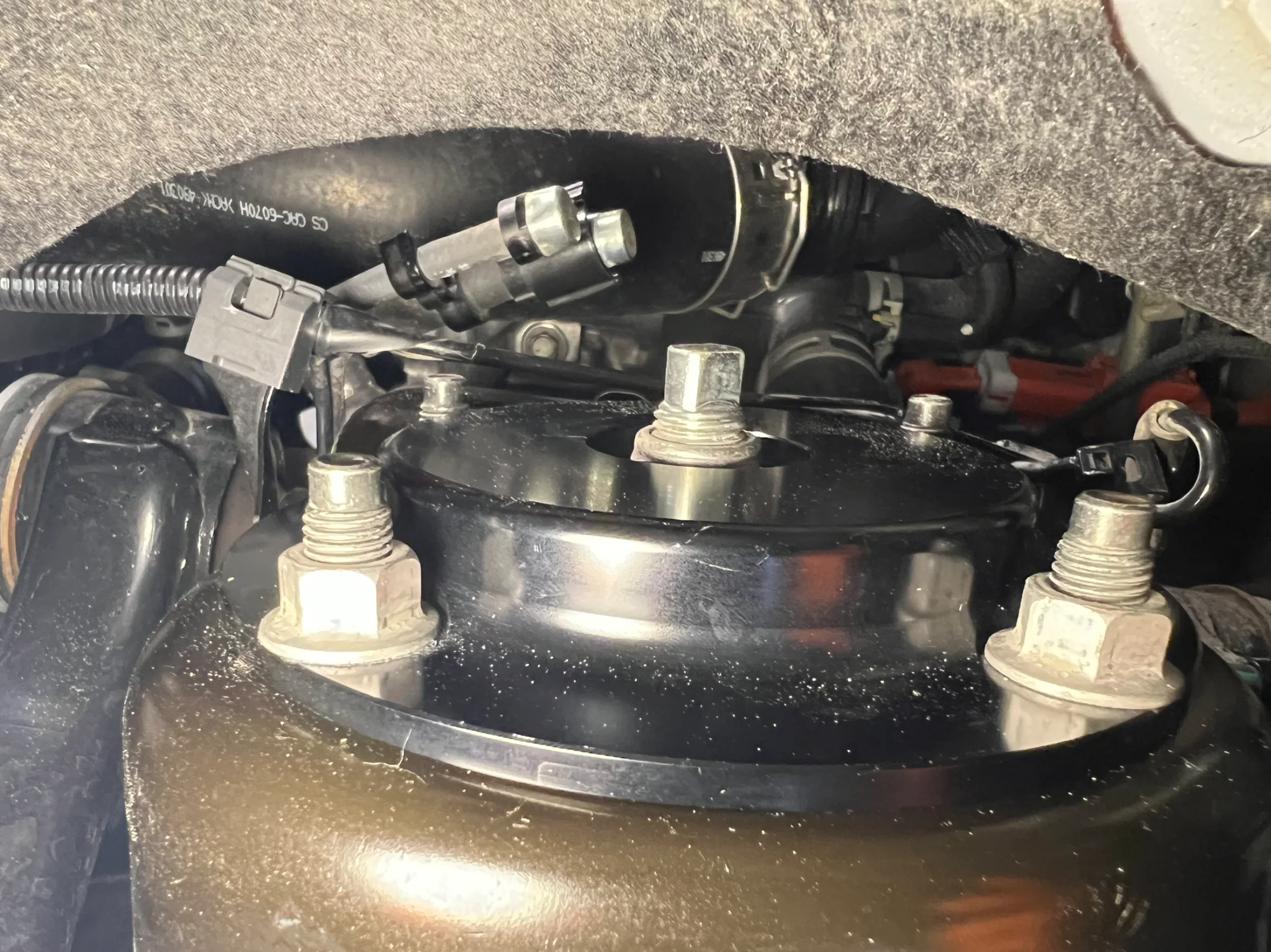

Installed the Icon shock stiffener, or whatever they called it, for the front shock tower.
That job could
Could not be easier. It took me longer to order them than to install.

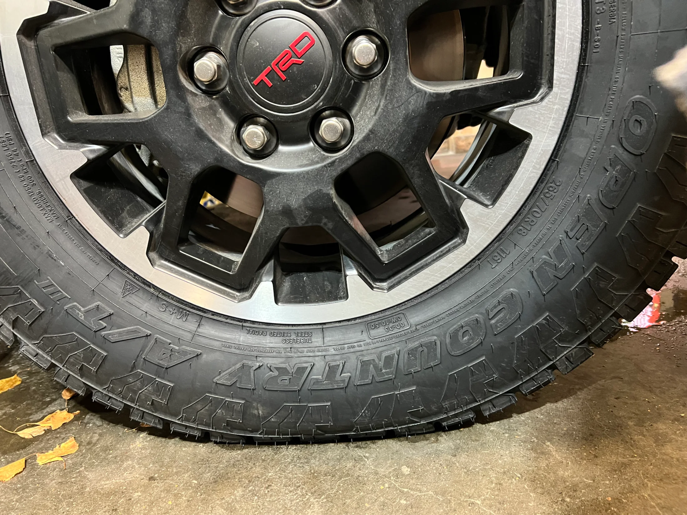

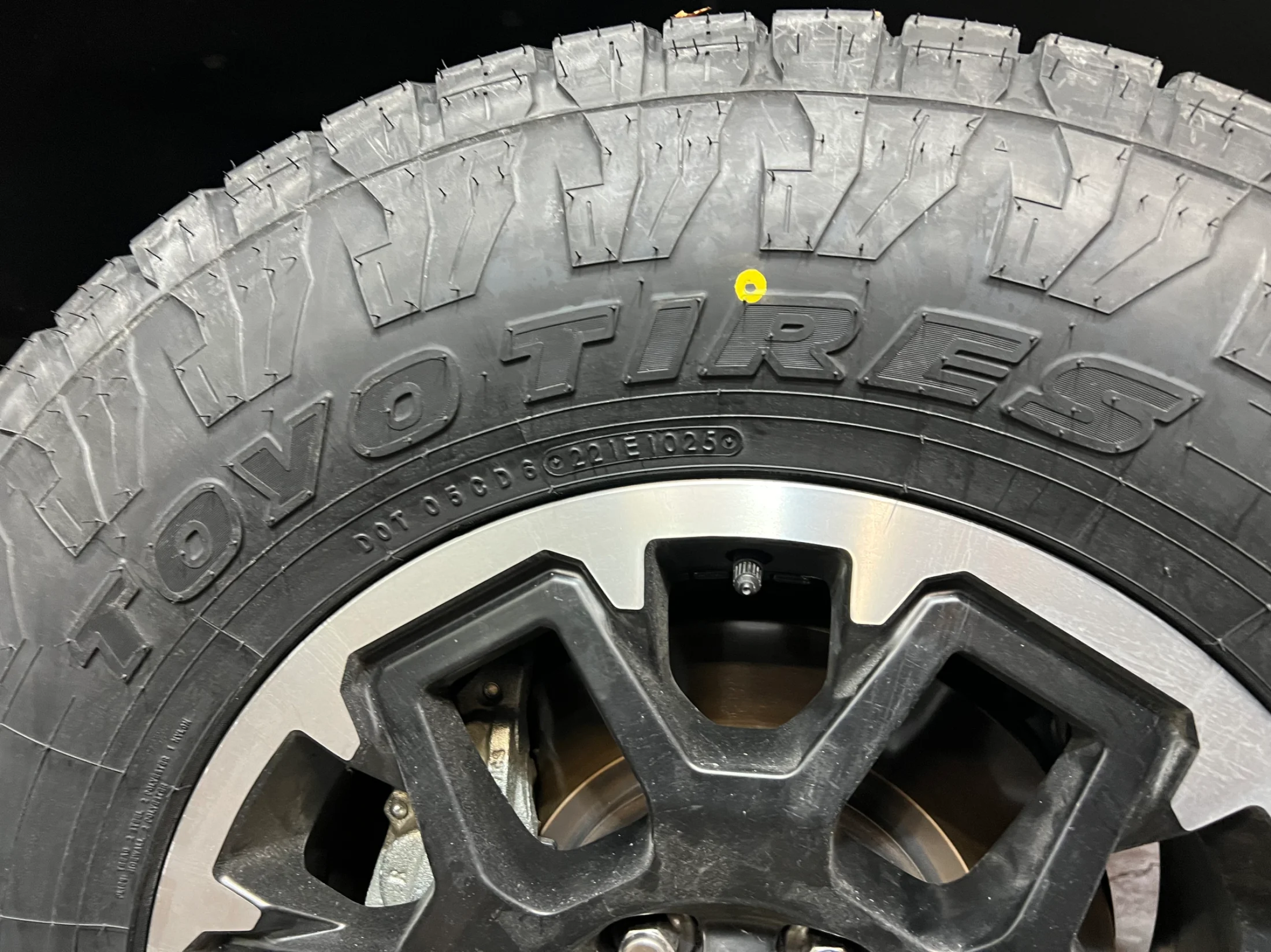

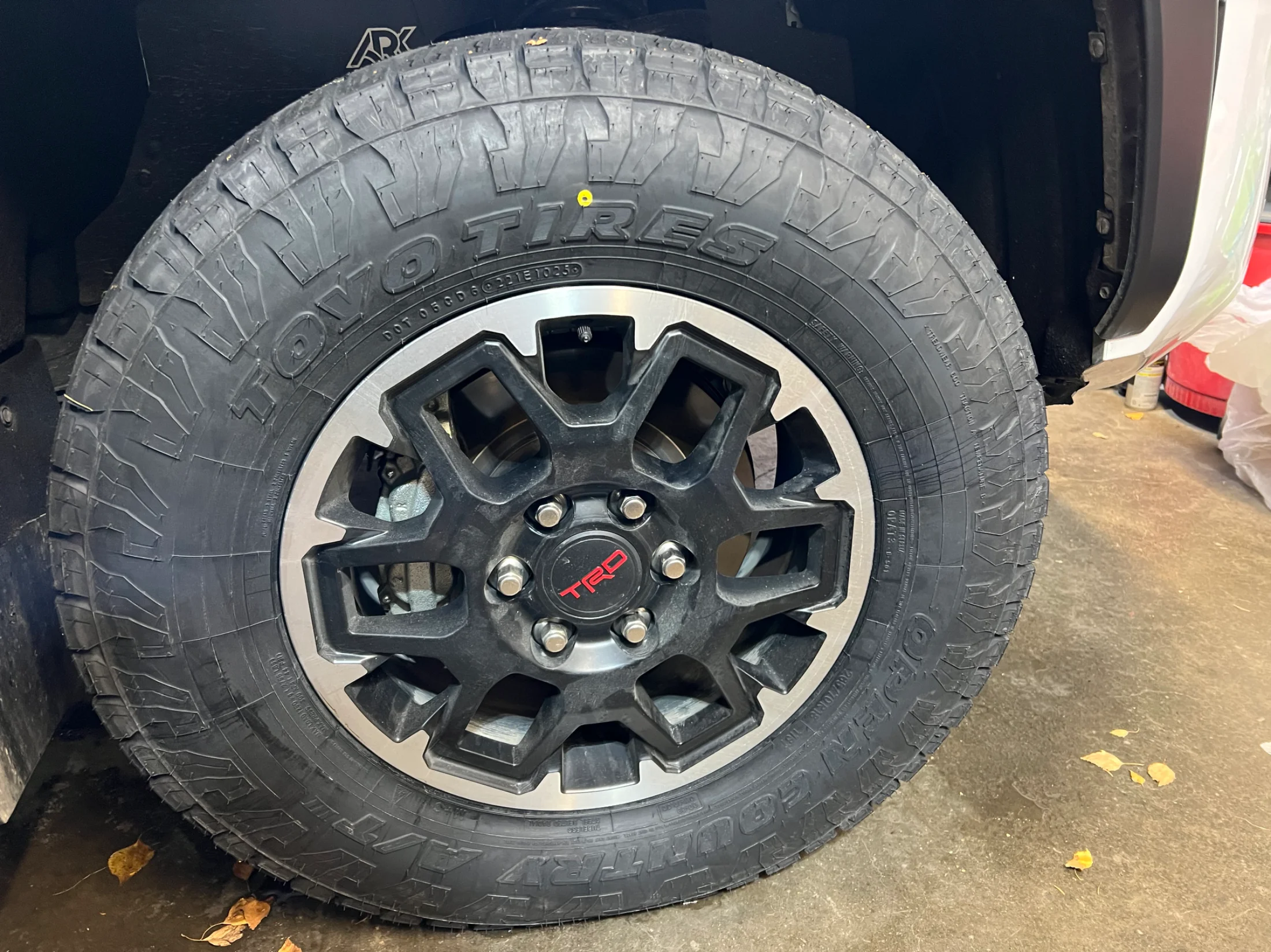

Well, the vibration issue is still there. Dropped it off with the dealer again a few weeks ago. When I picked it up the shop Forman said that they re balanced/road force test all 4 tires and now claim that two of the tires are out of round. So took the truck to the tire shop where I bought these Nokian tires. They checked the tires again and said they are going to replace one tire but have to return the next day since they have to order them in. Went back the next afternoon and they said they replaced two tires. So I took it home. Still same vibration. Went back the next day to the tire shop. They did some testing again and said all 4 tires were within spec. So he asked me if I wanted to try another set of tires/brand? He suggested the Toyo AT3. Asked how much that would cost, $160. So said go ahead. These tires seem to ride a tad smoother than the Nokians did. Still same vibration. Went back to the dealer and told him about getting new tires and no real change, maybe a slight change. He is at a loss. Must some kind of harmonic balance issue going on🤷‍♂️ I can duplicate that vibration now at 35/45/55mph at 1300ish rpm. 4 sets of tires so I don’t think it’s totally tire related but maybe something in the drive train doesn’t like tires🤷‍♂️ Toyota shop Forman hasn’t yet given up so will probably drop it off again when I go to work.

Well, the vibration issue is still there. So took the truck to the tire shop...
I had Discount Tire rebalance my wheels recently. When I left I noticed they were vibrating. I thought crappy balance ... until I noticed they put 40psi in the tires. I dropped them down to 30 and they ride much better.
