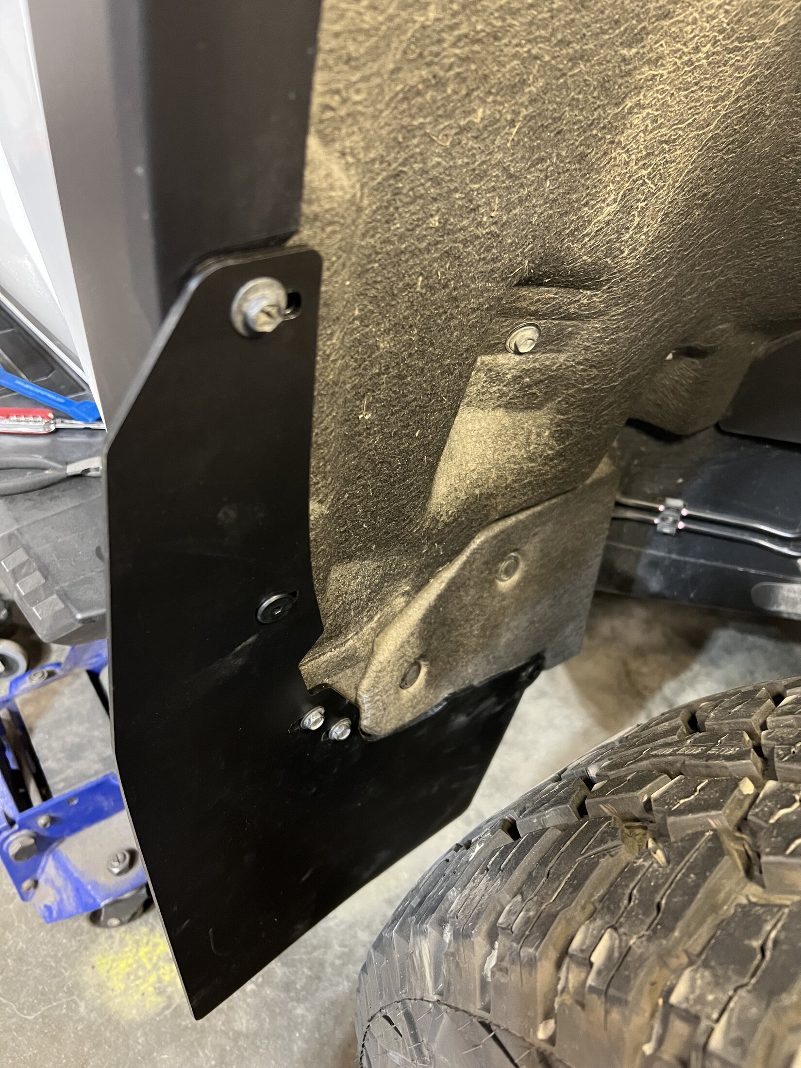

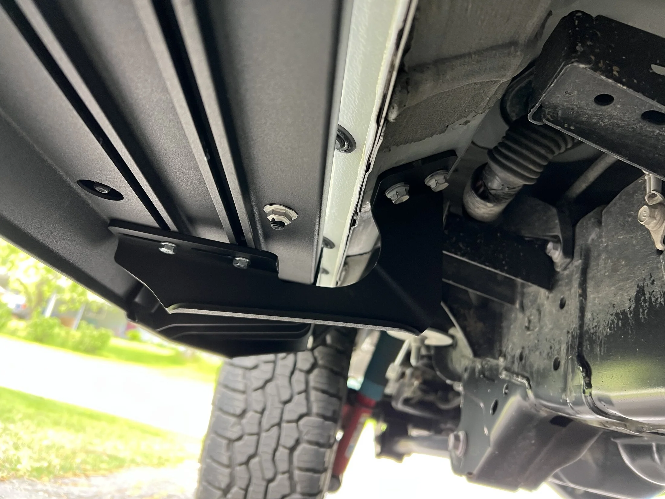

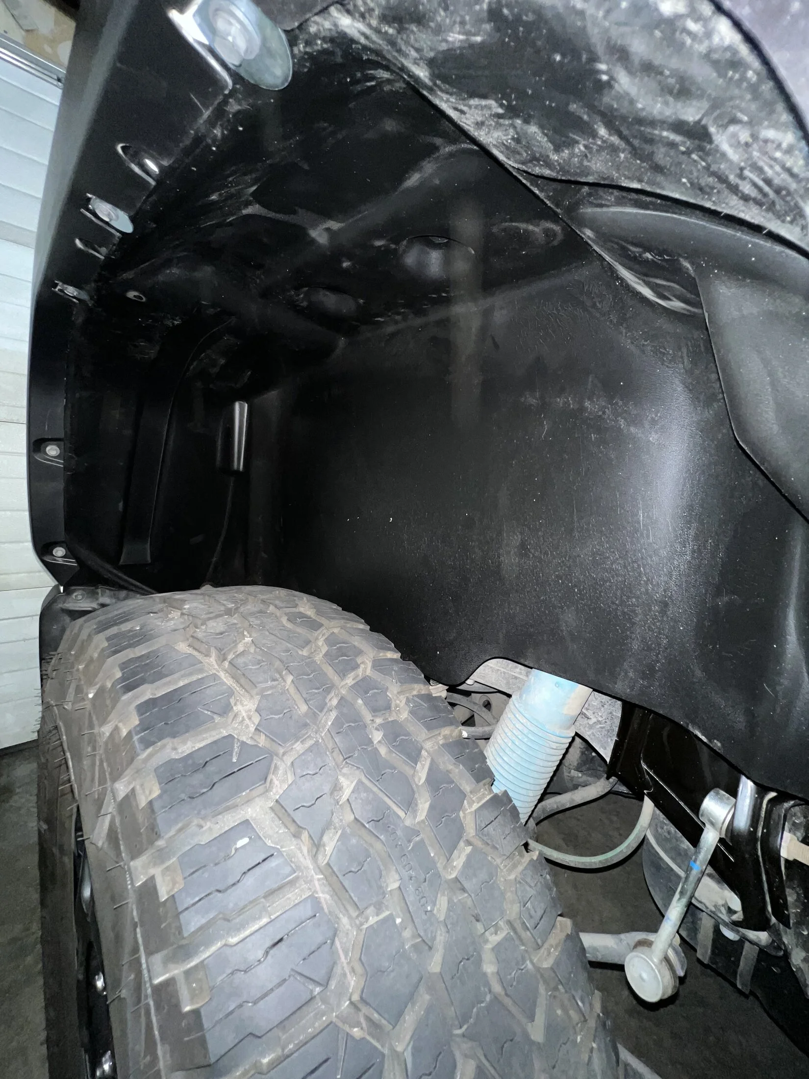

Wanted some running boards to reduce rock abuse on the rocker panels and sides. Decided to try Rough Country HD2. I think for the price they appear to be a good product, if the powder coating on the mounts hold up pretty good. Only bummer was that 2/3 of the mounting hardware was missing. So went to the local hardware store and bought replacements.

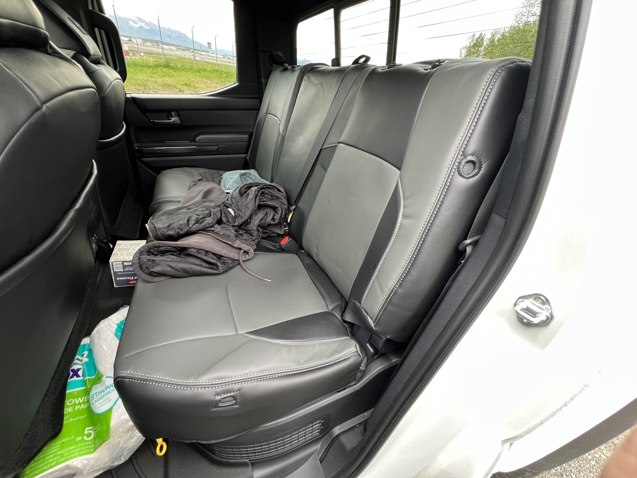

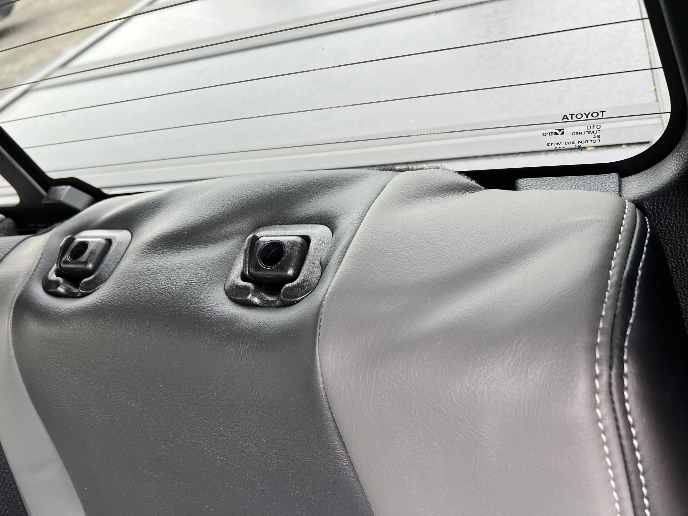

Found an unused set of PRP seat covers for $260.00. Thought that was a good price to try them. Install takes some work. Front seats seem to fit pretty well. On the rears, the back of the back seat didn’t fit well at all. Don’t know if the rear seats are also made for the hybrid Taco’s or not.

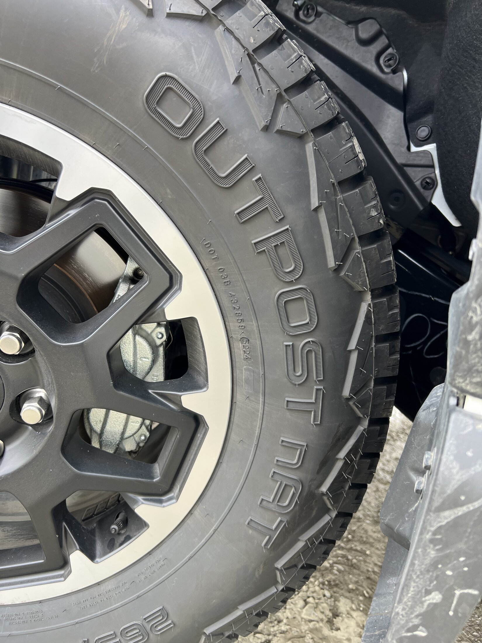

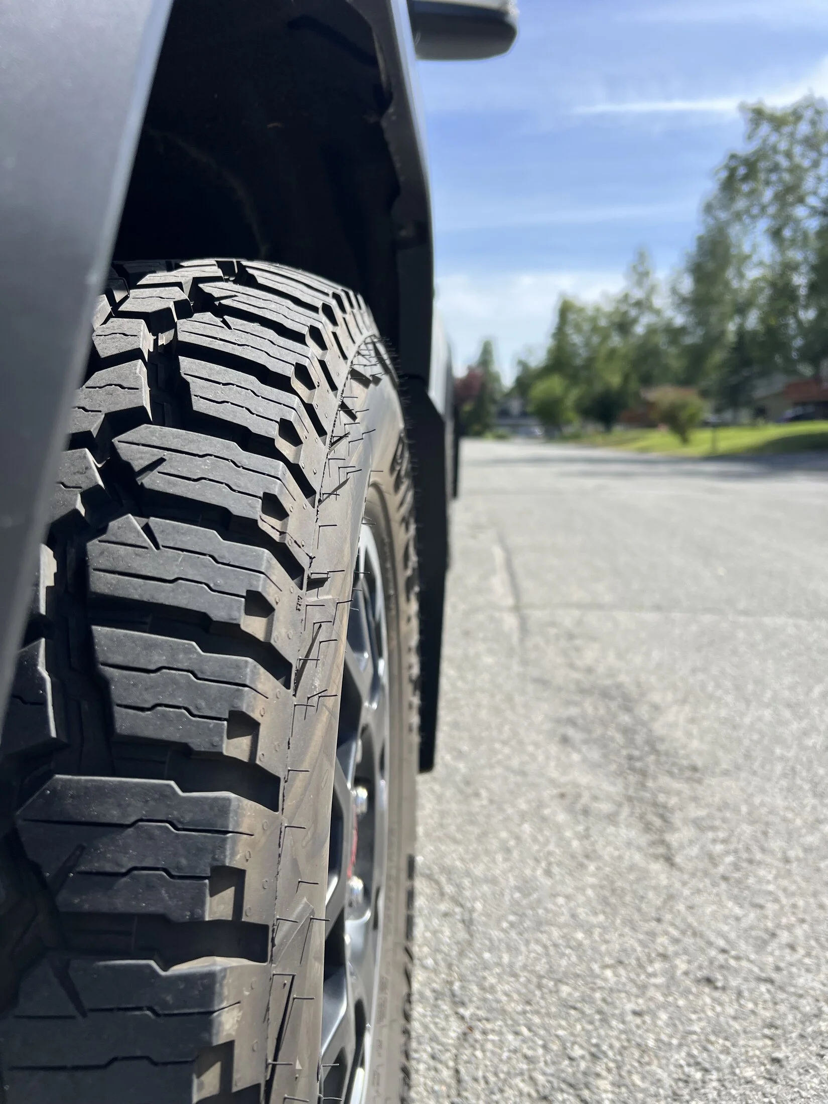

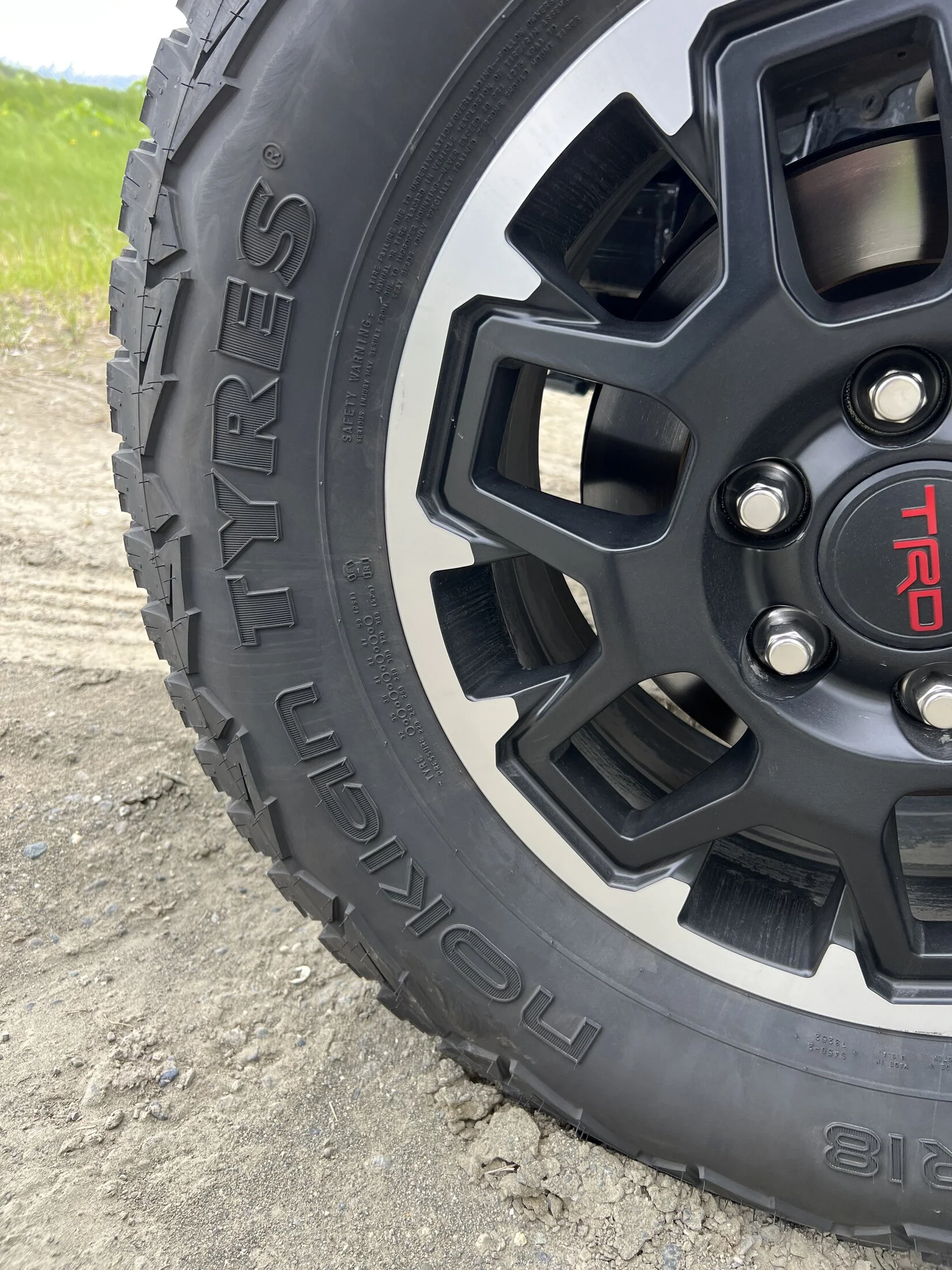

Couple of weeks ago I replaced the BFG KO3 for Nokian Outpost nAT. Hoping these will be a better all year (winter) AT tire. A guy that tests tires on YouTube tested these in the winter with the other Nokian truck tires and according to his testing these AT tires did just about as good on snow and Ice as the all weather tire.

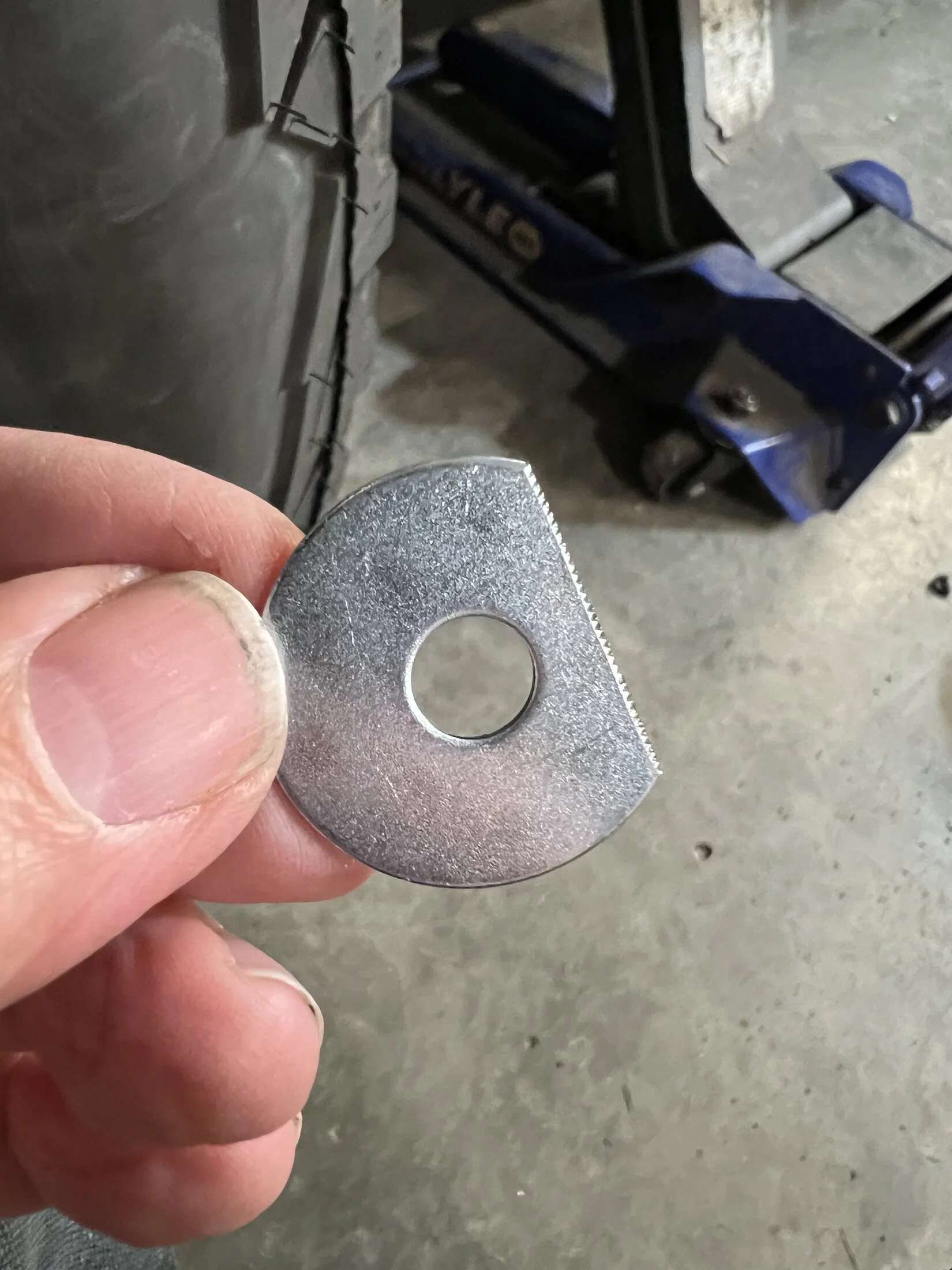

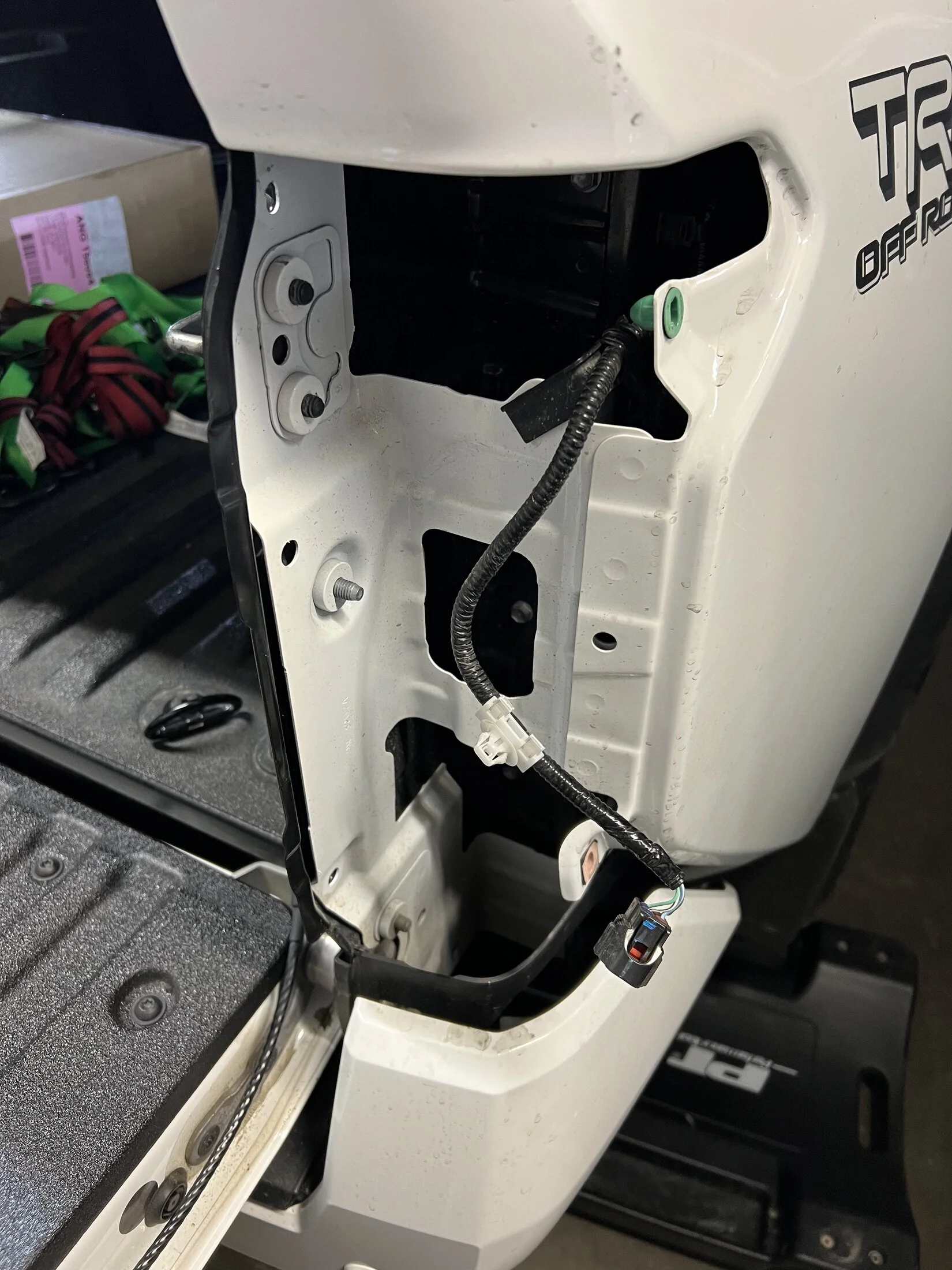

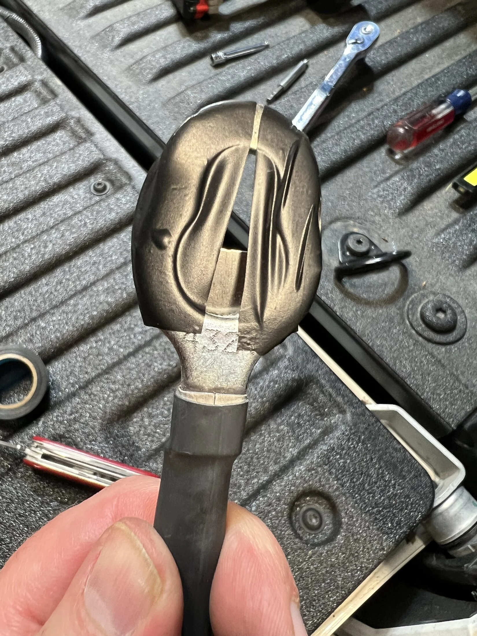

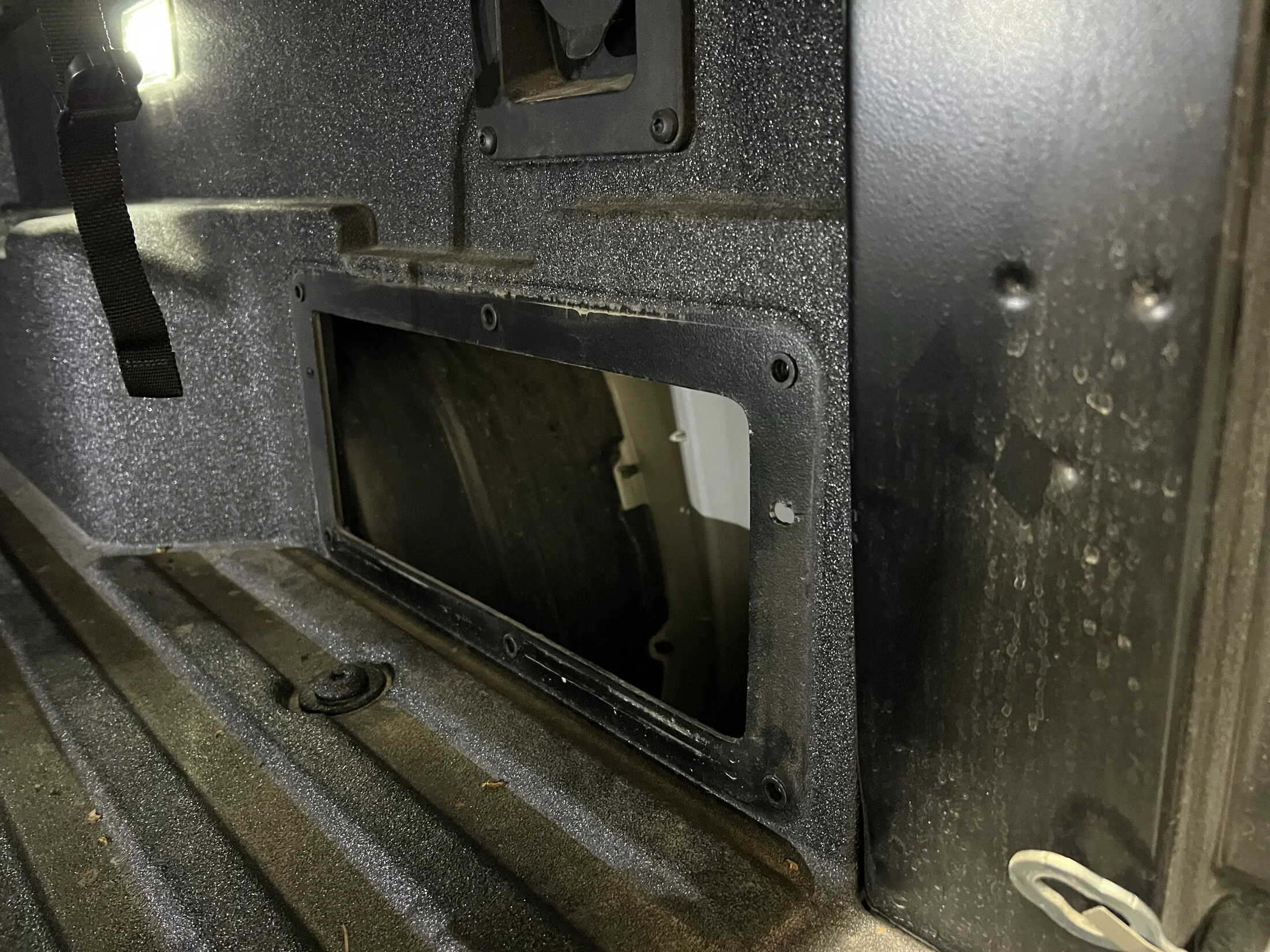

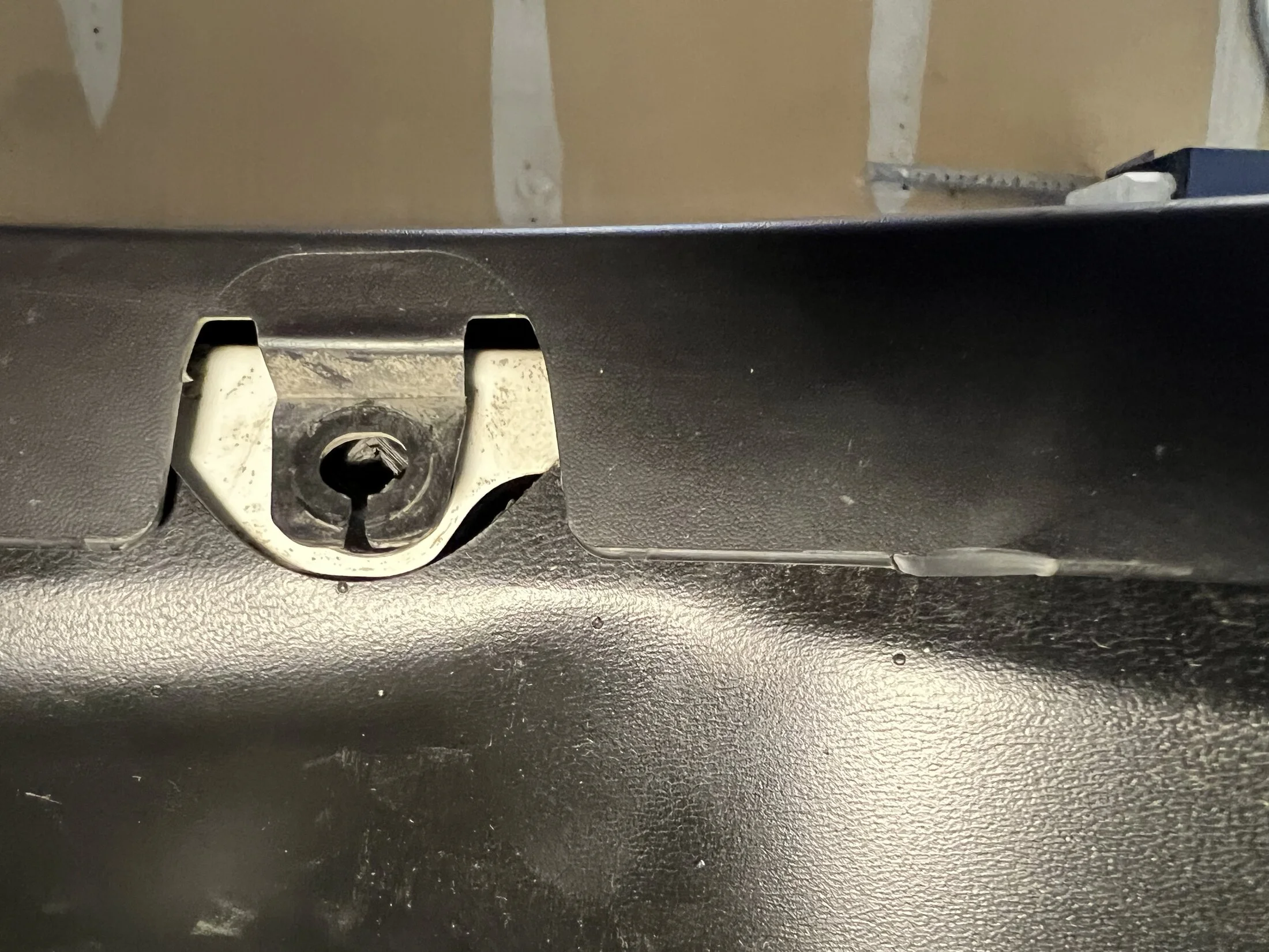

Spent a couple hrs chasing a rattle every time I closed a door. Removed the pass side tail light, the little storage cubby, and then bumped up against the tailgate cable and found the rattle 🙄 tried finding a thin rubber washer but wasn’t able to, so electric tape to the rescue 🤣

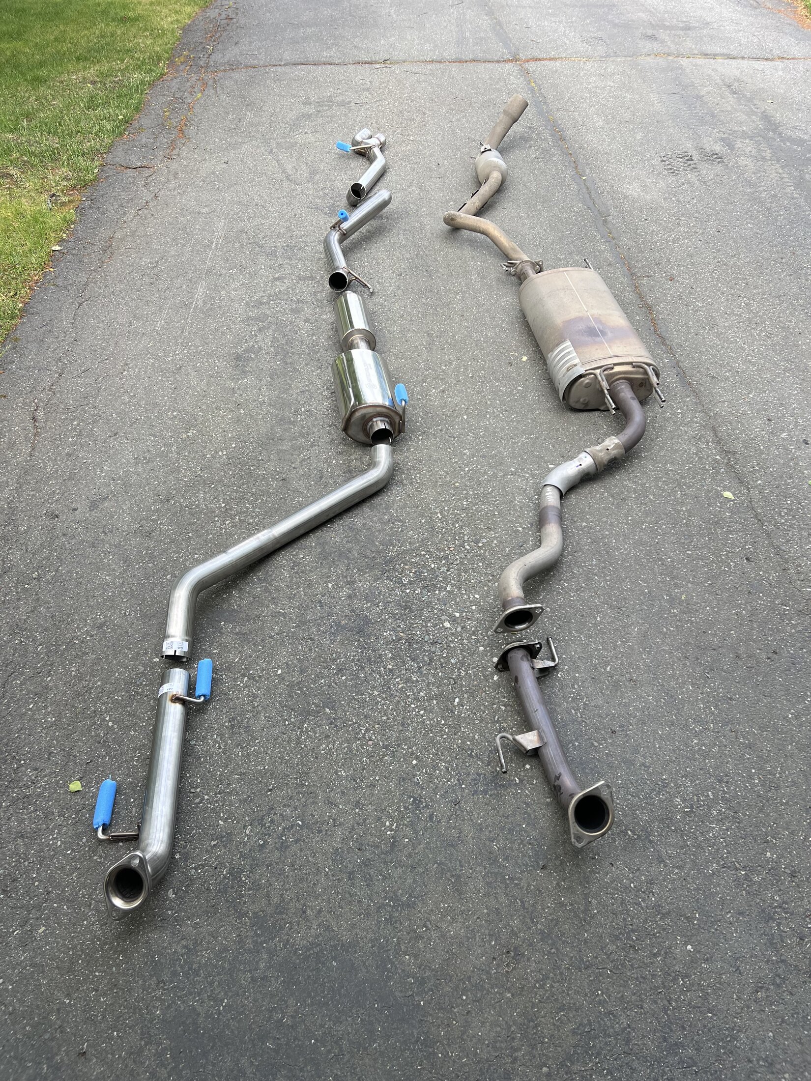

Installed a AWE exhaust. I think it’s the best sounding for what’s available, Stillen second. Would Sound better if it was a manual transmission. Definitely hear it now. If you don’t want to hear the exhaust then leave it stock🤣
Hoping it will help with the mpg. I know, the cost will take a long time to recoup no matter how much/if any it improves the mpg

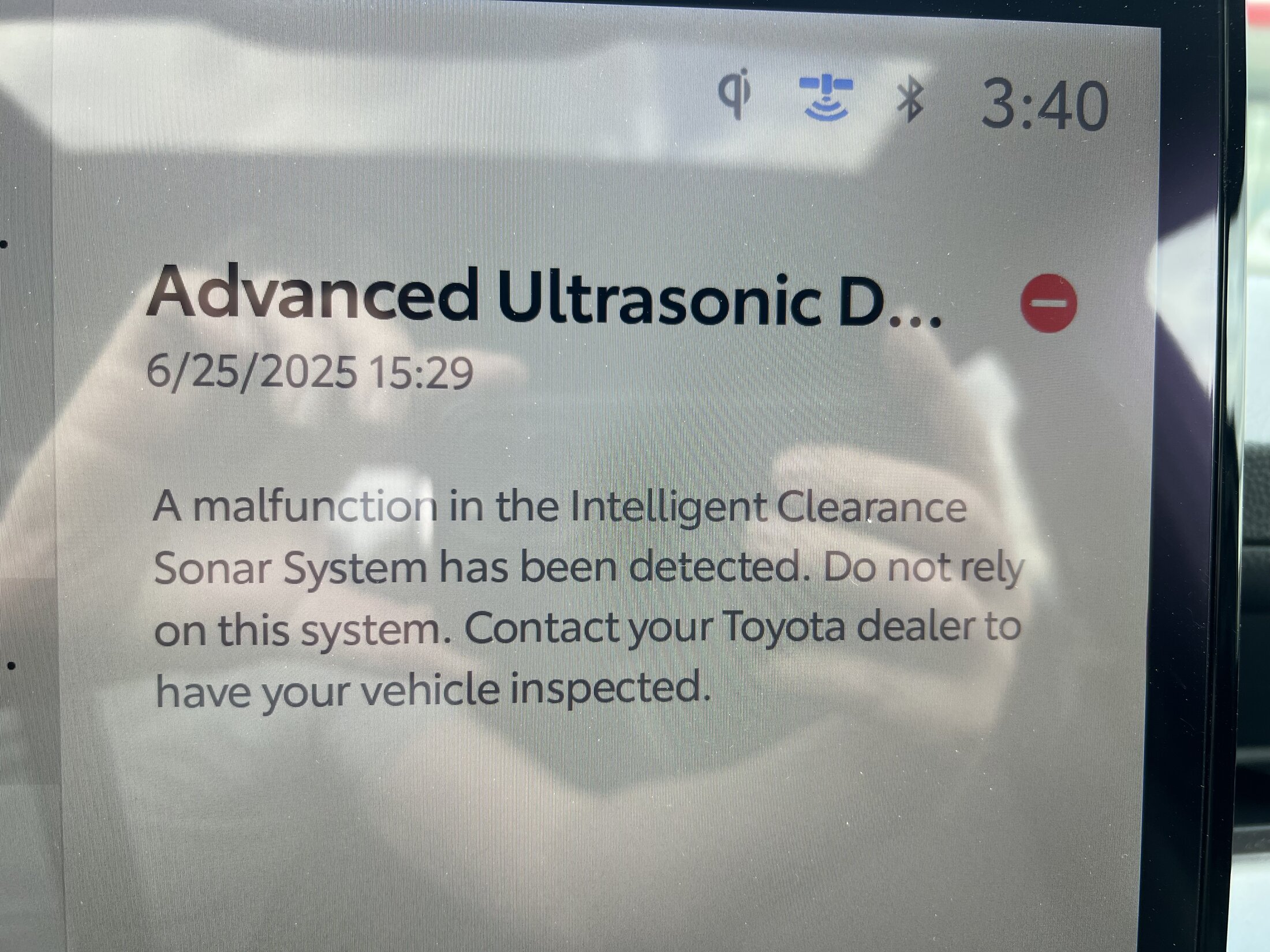

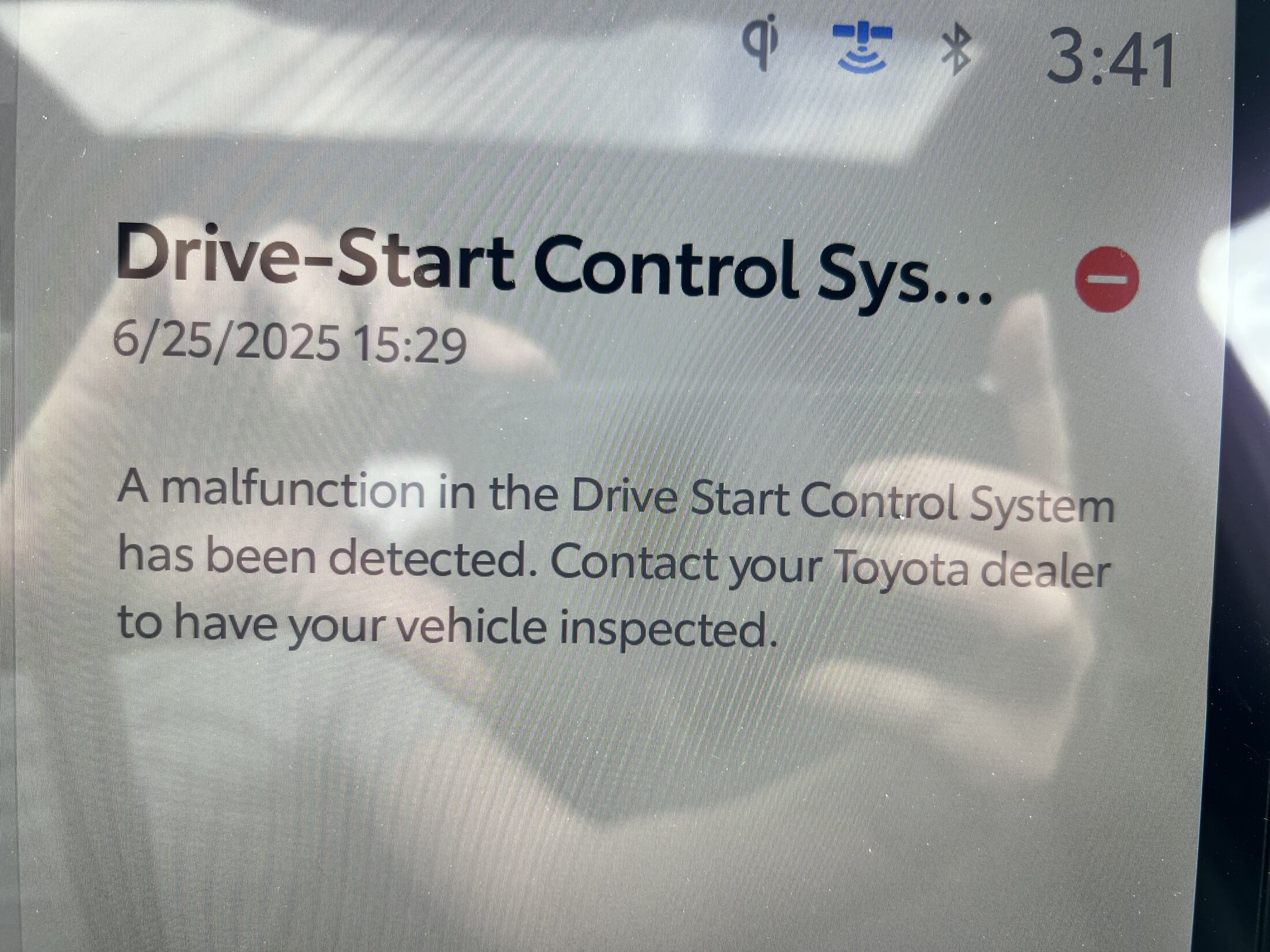

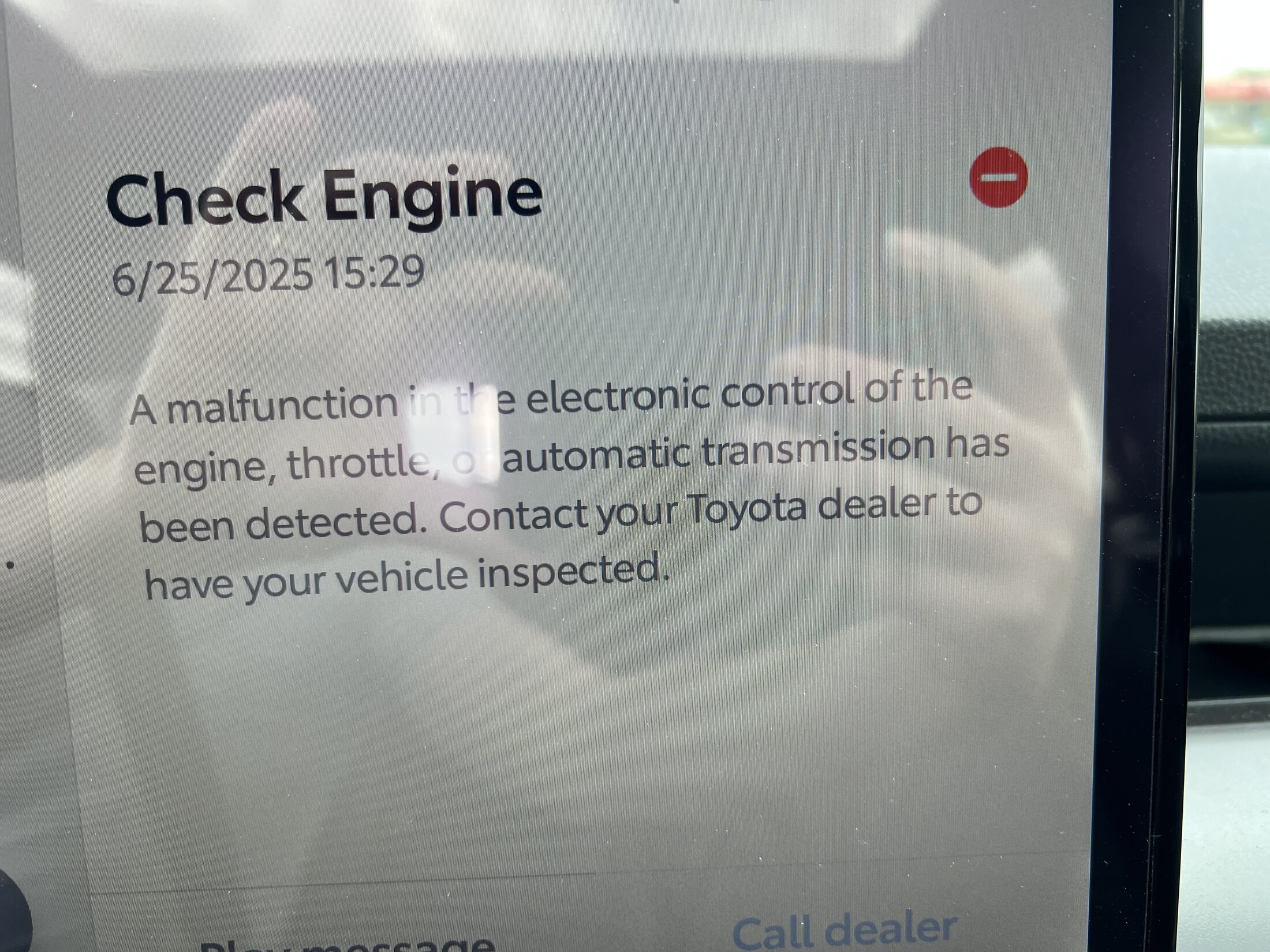

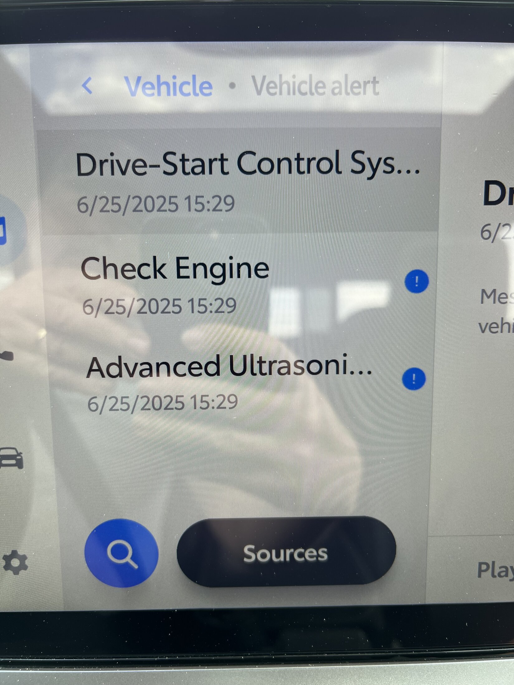

Driving around today got 3 check engine light codes. Stopped by the dealer and had the assistant shop supervisor download the data and clear the codes. Tomorrow I will drop it off at the dealership for the assistant shop supervisor and shop supervisor to play with while I’m at work.
Hopefully they will finally be able to figure out what is going on.
Wow. Intelligent clearance sonar system sounds quite high tech!
