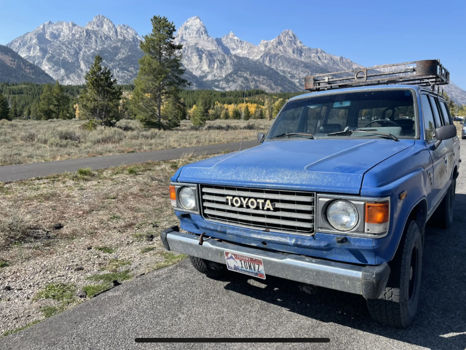

What else should I be checking/watching for (they claimed the wiring all looked fine and miraculously the ignition seems to work). I looked around myself but I’m not the most mechanically savvy and would appreciate any feedback. Thanks in advance - picture of my fj60 “Sheila” just for fun.
