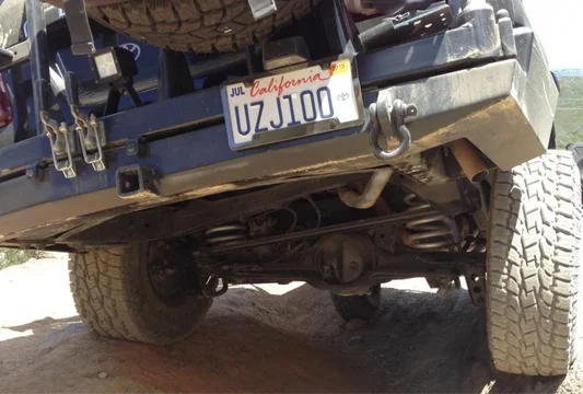

don't get too hung up on shock length or an inch of travel. the rear looks like a great option for stock or near stock, and it will also likely be fine lifted for expedition style use and some wheeling. you will likely get full coil height on the lift and just lose droop/articulation. not many shocks compress coils. the actual lifted ride height will depend on the vehicle weight, coil stiffness and maybe the shock valving but not the overall shock length unless fully extended by the lift! rb says these shocks are good on his heavy truck, and i believe him.
having run an 80 on a j lift with regular ome nitros for years i can affirm that a lift with shocks that are "an inch too short" can be just fine. it gives the same lift as an l shock for clearance, and is adequate for clearance for the trails i choose to take. i have been to moab on it a few times and never missed that inch of droop. otoh, i believe i have gotten years of better road manners out of the shorter travel shock.
I have seen rb's truck on the trail. He has no issues that I have seen and we have done some pretty good wheeling together. I think that Semlin has nailed it with not getting caught up in the numbers that are likely not attainable in normal situations anyways....

The Fox 2.0 for the 100 series dimensions are: front 17.55 extended. 11.45 collapsed. 6.1 travel. Rear 22.95 extended.14.35 collapsed. 8.6 travel. They are also aware that their website is showing a coil over front shock which is incorrect. Front and rear are a 2.0 Performance series without remote reservoir. I'm not positive, but I think they will be offering a reservoir option in the not to distant future.
Concerning the rear shocks not being long enough for some. I run Slee heavies and have quite a bit of extra weight. I also wheel as hard as any 100 series should IMO and have been very impressed with the Fox shocks.
