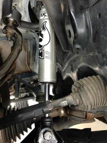

Fox is in the process of releasing a line of pro-series shocks for the 100 series. These are the prototypes that I've had on my Land Cruiser for nearly a year and they have been awesome. They will be at Overland Expo and the shocks should retail at about $130 each.

That is exactly what I've been waiting for. A rebuildable cheap shock made by a reputable company. The aluminum bodied fox have been getting great reviews. Where can I get a set of these??!!!
Do you have a part number on the fox and how's your impression on valving? Also noticed you have the tc uca's. no shock topping out on those? One more, do you have the dimensions if you don't have the part number?

RB4638, What did you run prior to the Fox shocks, and how do they compare?
I'm sure if you contacted them directly they would be able to help you. I know for sure that they will be releasing them to the general public soon and will have a part number. I have had these shocks on for nearly a year and have had no issues. I really think that unless you are running the Baja 500 you don't need a reservoir shock. These have served me well from Moab to Death Valley and the Sierras. As soon as I hear word on a part number I'll post something here.
