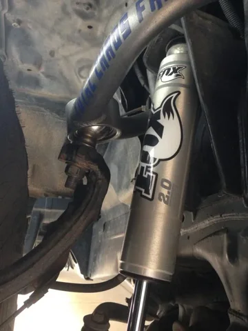

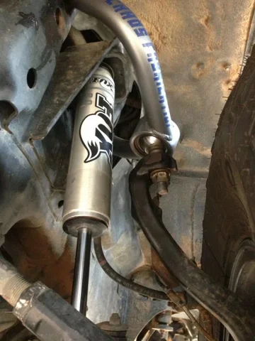

Upon further investigation with the length...they add significant down travel. A bit uneasy with how close everything gets. Less than a 1/4" in there.
Do you happen to have any "before" pictures for comparison?
Looking good! Btw are you running a diff drop? Sorry, don't remember from your prior posts.
Do you have a part number on the fox and how's your impression on valving? Also noticed you have the tc uca's. no shock topping out on those? One more, do you have the dimensions if you don't have the part number?

I ran Old Man Emu prior to the Fox and my impression was that the OME were just too stiff. The Fox, depending on valving gives a ride much more close to stock but more composed. The Fox shocks should be available at ORW and 4Wheel Parts by the end of this month. Part numbers are 985-24-066 and 985-24-067 front/rear. These will fit stock to 1.5 inch lift. My truck weighs in at over 8,000 lbs loaded and I've had no problems.
That sounds like it may be too short for many owners. Are you in touch with them? It would be nice to get another L shock option for those who've already done the mods to run them.
Fox is also working on a 2.5 with reservoir and a compression dampening knob for the people that want to have top of the line bolt on shock. I don't know the exact price point, but I'm pretty sure they will try to keep it south of King's and Slee's. I'm running Slee heavies in the rear with the Fox 2.0 and seem to get the same articulation that I had with the OME shocks. As far as the front goes, you just can't put a long shock with the IFS, even with aftermarket UCA's. There's just not enough travel.
How close are your UCA's to the shock at full droop?
