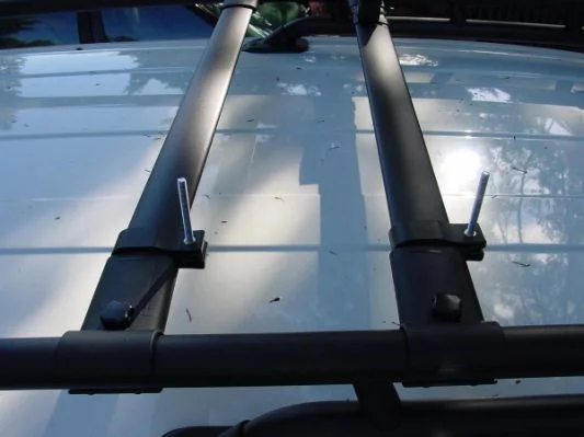

I agree that if you want to use U-Bolts, the Thule or Yakima cross bars are better, but if you want to use your factory crossbars, I would buy a set of the Yakima MightyMounts and then use a longer bolt to extend up to hold the jack. As for the Maxx Trax, I am not sure how those mount up.
Nice. I had not heard of these. You could probably attach Maxx Trax with these too.
